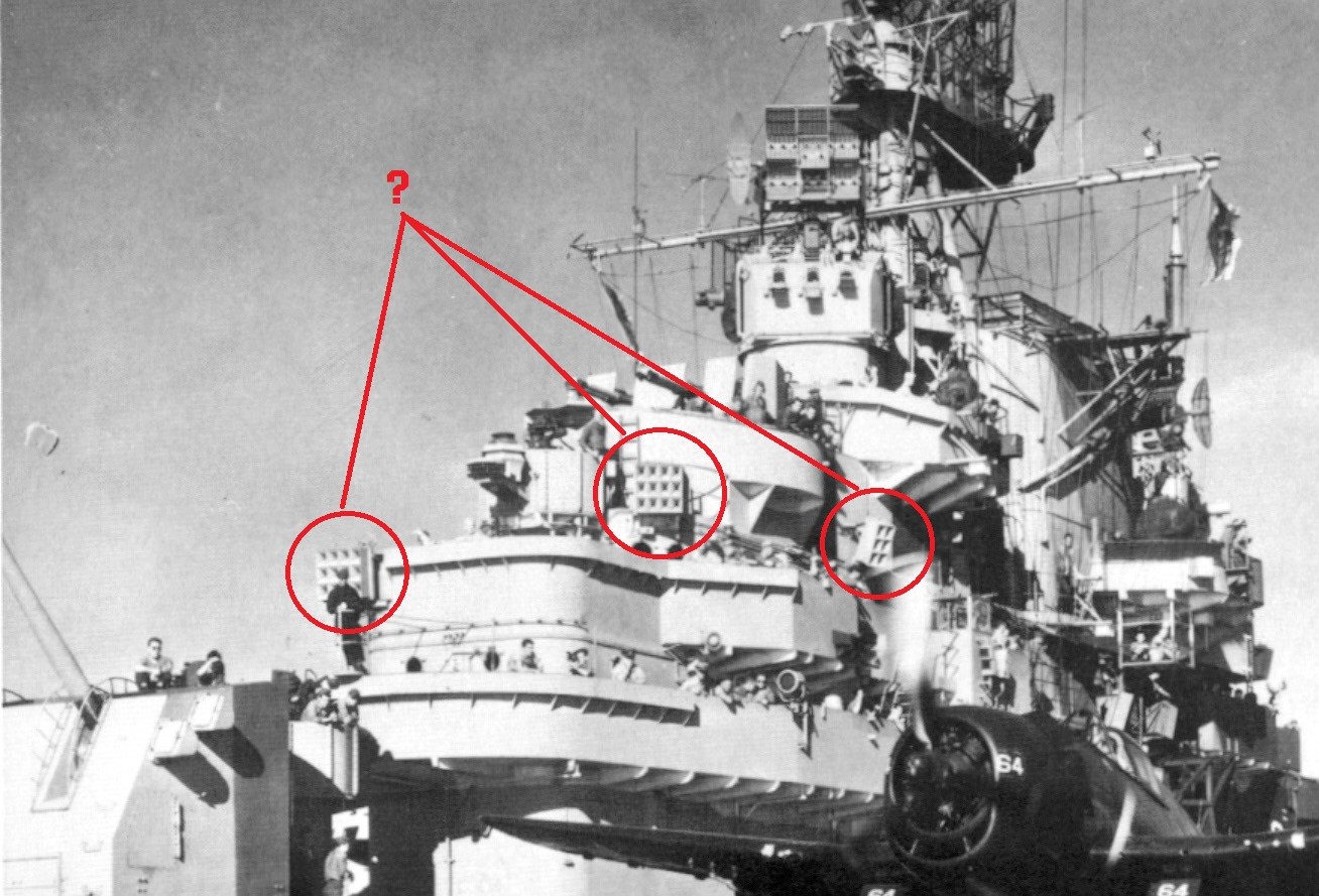

What are the items insdie of the circles? Are they some kind of load speaker or some other device?
Duane
Duane

The nomenclature was "reproducer" and yes, they were speakers. There were a few different styles - if you see a single column this was a reproducer as well. CVEs and CVLs had reproducers that look like a searchlight without glass.

Thank You very much. I will see if I can make these in 1/96 scale for the model that I am working on for a friend.
Duane
