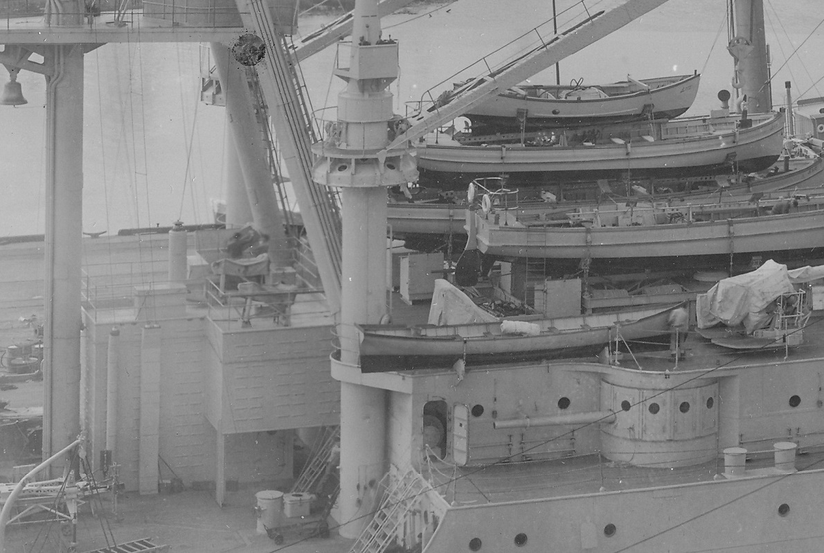

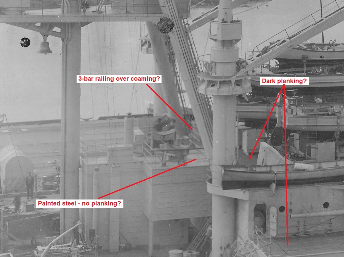

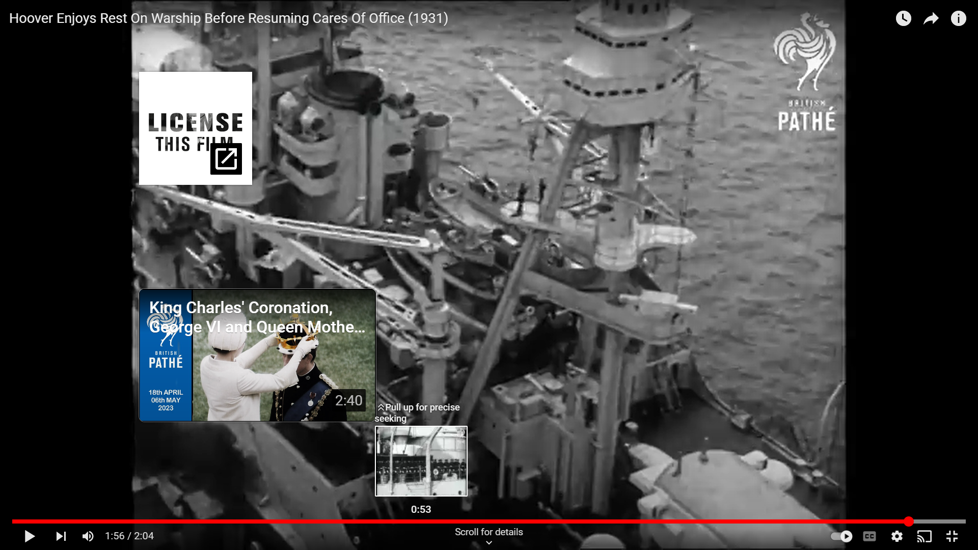

This why I asked for any photographic evidence. 1930s photos show the vegetable locker roof is much lighter than nearby decks known to have been planked. In photos, the lightness and tone of the vegetable locker roof match the gray-painted steel bulkheads nearby. The tone change from light to dark occurs in a sharp line along the rear of the casemate which appears to be a raised coaming.
I am seeking authoritative photographic evidence explaining why the vl. locker roof is much lighter than the planked decks in 1931 post-reconstruction photos and Jon's screen capture.
A reasonable guess at an explanation at this time is that the vegetable locker roof was not planked when the photos were taken. Happy to be proven wrong. If that is true and the v.l. roof was not planked, is there any photographic evidence that shows planking installed by 1941?

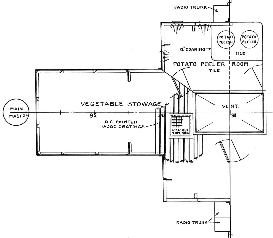

I've compared your posted photos to similar ones of PENNSYLVANIA (BB-38) and the deck over the veg. locker on her is also a lighter gray than the corresponding painted surfaces adjacent to this area. So, I went to my scanned plans of PENNSY and looked at the overhead plan view of her amidships area - here is a close up of this plan - If you notice, there is a callout note regarding the planking over this area. These plans were dated 12-08-31, so relatively during the overhaul similar to AZ. I also do have one overhead photo of PENNSY where it appears that there is decking in place, but this photo, just as yours, is not clear or close enough to make a verifiable determination, etc.
As for the lighter tone of gray in the photo mentioned above, it could possibly be that the metal deck or wood decking was painted either a very light gray or aluminum in order to reflect sunlight - just a wild guess!
Hope this is of some help,

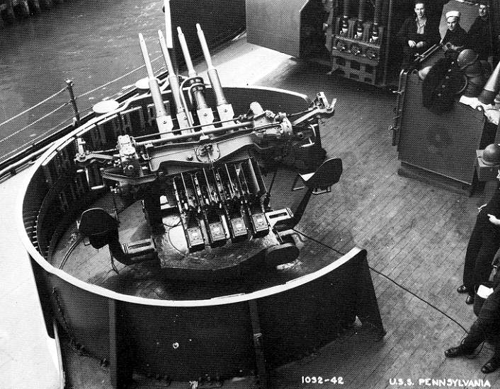

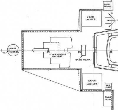

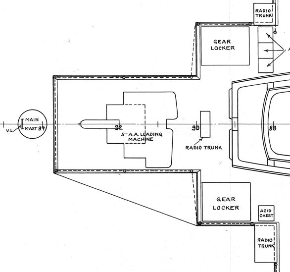

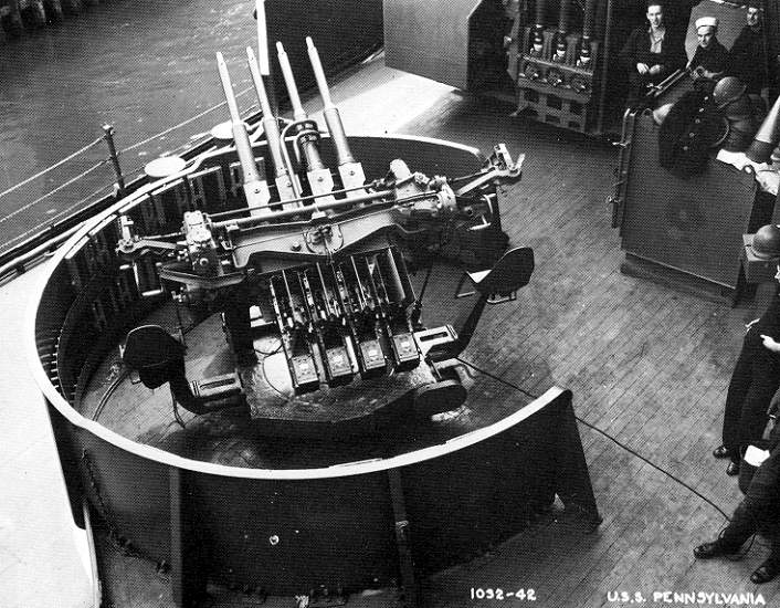

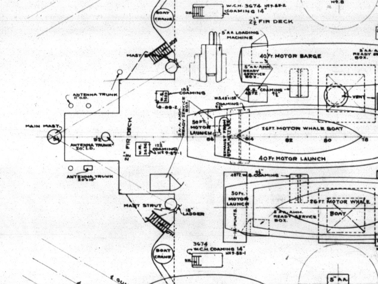

The Pennsy plan in your post appears to be of the inside of the vegetable locker, rather than the roof. Pennsy plans I have show a 5" practice loader on the v.l. roof, oriented fore-aft, with other detail differences compared to Arizona's v.l. roof. Photos of Pennsy don't show the area well enough to tell whether or not the v.l. roof was planked under the practice loader. (AZ's practice loader was located differently, oriented laterally on the boat deck, port side, just aft of the port side boat stack.)
Pennsy's 1942 Mare Island photos show that a large bulkwark, no doubt serving as a splinter shield, was added to the periphery of Pennsy's v.l. roof. The deck under the practice loader isn't visible, unfortunately, obscured behind a Chicago piano tub and the v.l. locker roof bulwark. Here's a close-up: AZ's 1931 general arrangement drawings indicate that the v.l. roof was intended to be planked with 2.5 inch fir (planks 2.5 inches wide or 2.5 inches thick? - the Pennsy photo at the bottom of this post tends to indicate just 2.5 inches wide, very narrow indeed). The problem is that the post-reconstruction photos just don't look like the v.l roof was planked at all, and that the entire periphery of the v.l. roof is enclosed by 3-bar railing over a raised coaming, including a coaming at the front edge of the v.l roof/aft edge of the casemate. The v.l roof appears to be separated from the boat deck by railing over coaming. This is distinctly different than the general arrangement plans. See: G.A. drawings differing from actual construction is not unusual; general arrangement drawings are typically different than what was actually built by the yard. Thus the need for photos. What I don't have is good photos of the v.l. roof about 1941. What did it look like then? Was the v.l. roof planked or painted or both in 1941 or was it just painted steel? Was the 3-bar railing over coaming that appears in 1931 photos still there in 1941? Lots of questions.
David is correct that seeing actual planks in photos is very difficult. All we may have is color to go by. He's an example of Pennsy's planked boat deck as it appeared at Mare Island in 1942. Note that individual planks are very narrow, maybe just 2.5 inches wide judging by the length of the sailor's foot and what is stated on G.A. drawings. On a scale model in most popular scales, planks this narrow would likely be invisible. Construction drawings indicate that the planks were of "fir", not teak, perhaps a Great Depression-era cost-saving measure?
Thanks for your thoughtful consideration!

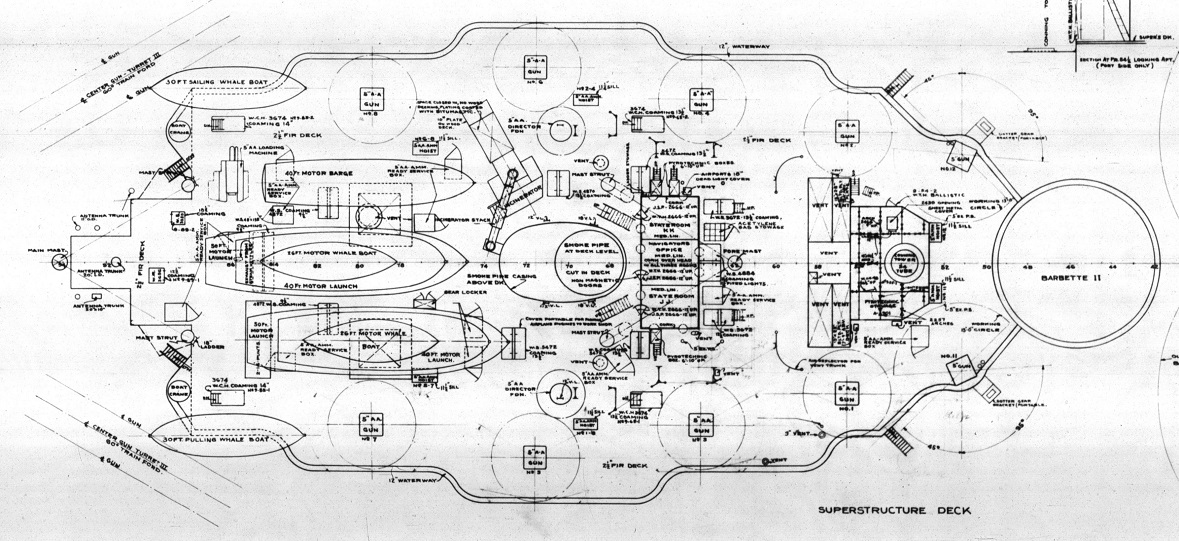

You are entirely correct - the close up plan I posted was of the interior of the veg. locker, not the boat deck level which would be as you described - Here is the correct close up of the boat deck level plan over the veg. locker area. Sorry about that - As for the answer to your question, well....we're back to square 1!!!
The size of the wood decking, the 1931 PENNSYLVANIA Main Deck plan calls out the main deck planking as being 3 1/2" thick; the superstructure deck planking is NOT noted - however, the MISSOURI Plan Book states that her upper level decking was 2" thick (01 Level), 1 1/2" thick 02/03 Levels). I think one could assume that this size would have been std. throughout the Navy, but that is only my assumption and not based on fact for the older battleships/cruisers. Wood plank width for the IOWAs was 5" on main deck & 01 Level. Relating these sizes to the PA class battleship may not be relevant.
Once again, hope this helps...

I'm inclined to believe the area was planked due to the bolt pattern evident in the picture Jim included on this post. I wnet looking to see if I had any better shots but no go.

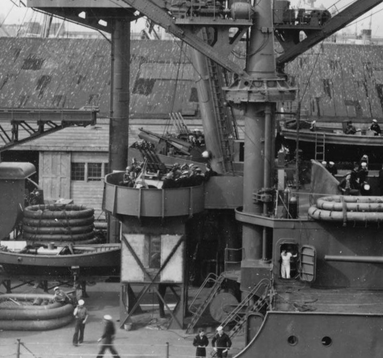

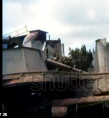

That's the challenge: uncertain shape, uncertain precise dimensions including height, and uncertain details.DavidP wrote:do you know what the shape as in the length & width of the incinerator as I've seen drawings of it but not height?

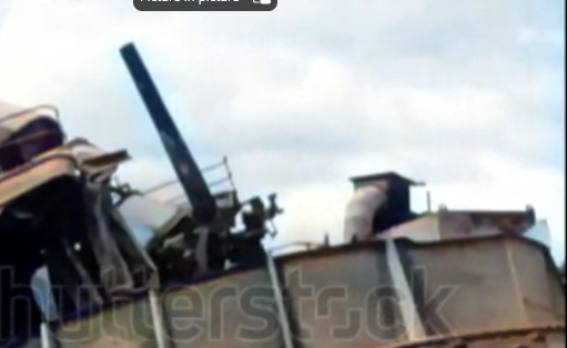

Here's the best photo I have of the incinerator. I am hoping someone will have better photos.
- taskforce48
- Posts: 1616
- Location: The beautiful PNW
Re: At 'Em Arizona Fans!

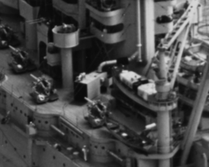

Not much, but gives some references of heightModelMonkey wrote:Here's the best photo I have of the incinerator. I am hoping someone will have better photos.
Taken from a passing boat but camera is just under level with the boat deck, so maybe you can make a educated guess from the splinter shields and the height of the forward superstructure.
