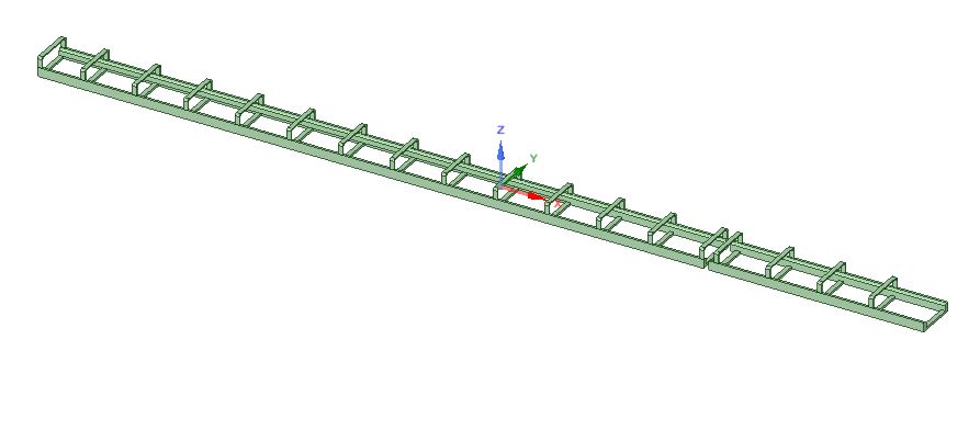

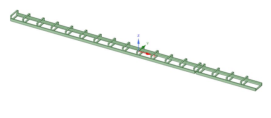

While perusing Willie's JORGE JUAN build log, I decided to go ahead and do a 3D design for my after stack cable tray. It is very much like his, although STODDARD's was centered on the stack, not off on one side as JORGE JUAN's cabling was mounted. Here is a pix of my 3D parts which comprise the upper and lower cable trays:
The front of the after stack has a slight angle to it and is also separated by a circular joint which necessitates creating two parts for this cable tray. I checked photos of the actual stack to make sure this was the correct configuration. It is.
I plan to use very thin dia. styrene rods for my cables, bending where they need to be - this is all conjecture at this point. It may turn out that the old 6 wire telephone cable is better suited for this. One thing is that I will count how many cables are actually in this run (if possible :huh: ) so as not to overdo this whole thing. I've started the 3D design & test printing of the several RADAR units, but have some further work to do on all of them.
Whether or not these parts print out will also be a gamble - it is only 31mm in length (o.a.) and 2mm wide - so, rather tiny!! I am currently in the middle of replacing the LCD Module on my 3D printer - once it has been inspected and approved by NAVSEA I'll run a few test prints of non-naval parts to make sure it works. :heh:
Posts: 5068
Re: 1/144 Scale USS STODDARD (DD-566) - Kitbash, Revell FLET
Post by Fliger747 »
The object is to then feed the wire (or whatever) through the frame ? Be interesting to see what the ( to coin a term) the final solution is. As one gets along in the scratch bits workin through the trials to arrive at a satisfactory end can be a challenge. I am always reminded in theory the results should all be the same without regards to the materials employed.
Cheers. Tom

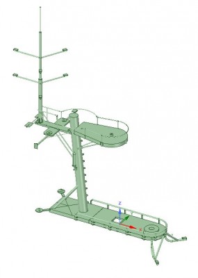

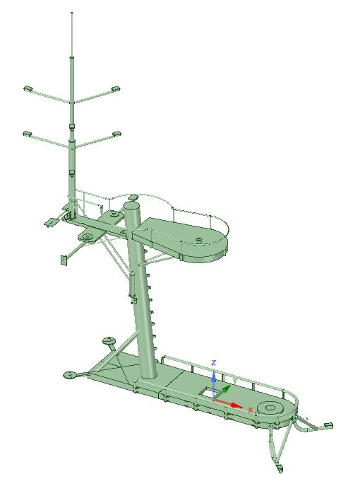

But, I have continued the design drawings for at least one of the parts - the forward tripod mast and it's upper service platforms. I'm now fairly close to running a test print (yes, the printer is back on line and working nicely!!) -
This part will NOT have any of the RADAR antennas or other elec. equipment pieces - those are all separate and will be adhered to the proper locations at the proper time. I'm probably going to continue the tripod mast legs/supports, etc. (everything below the Service Platform level) in the same design file and once drawn up I will move it to a separate file for printing, editing, etc. By doing it this way, I can assure myself that everything fit together properly before being divided for printing.

The mast assembly design looks good! Will be very good looking when complete. I expect that all the fine components will require several iterative improvements to achieve the final item. Will be interesting to see this come out!

Excellent sketch, that has been already added to my own files. Eagerly looking forward to the rest of the mast. I will have to start with it soon too.

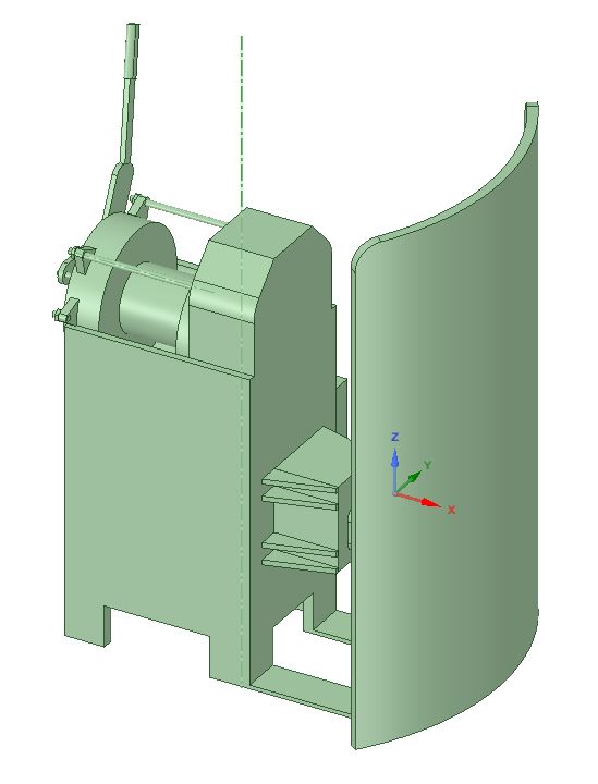

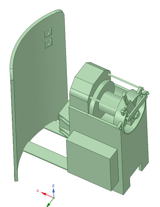

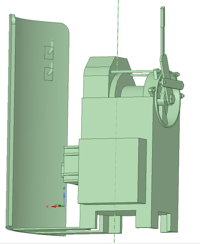

While I wait for another paint order to be shipped for work on the LSM/R-194 project ( I may have to flog the Supply Division - they're getting sloppy and surly; sometimes at the same time :Tirade: !!) I decided to go ahead and design & print the BT Wench. Of course, finding any info on this item today is like hoping the current admin in DC actually accomplishes something other than Total Chaos & Mayhem - which appears to be their ongoing modus operandi. With Nat'l Archives pretty much out of reach there simply isn't a lot of info readily available. But, you do the best you can with what you have to work with.

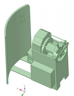

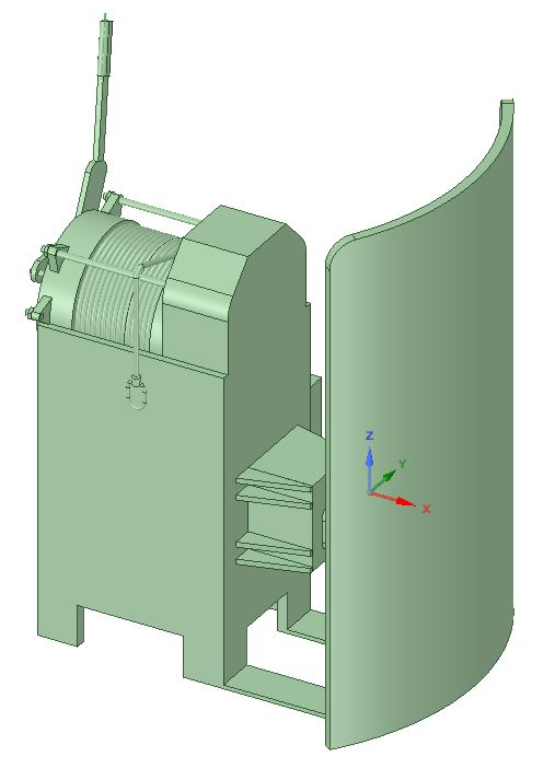

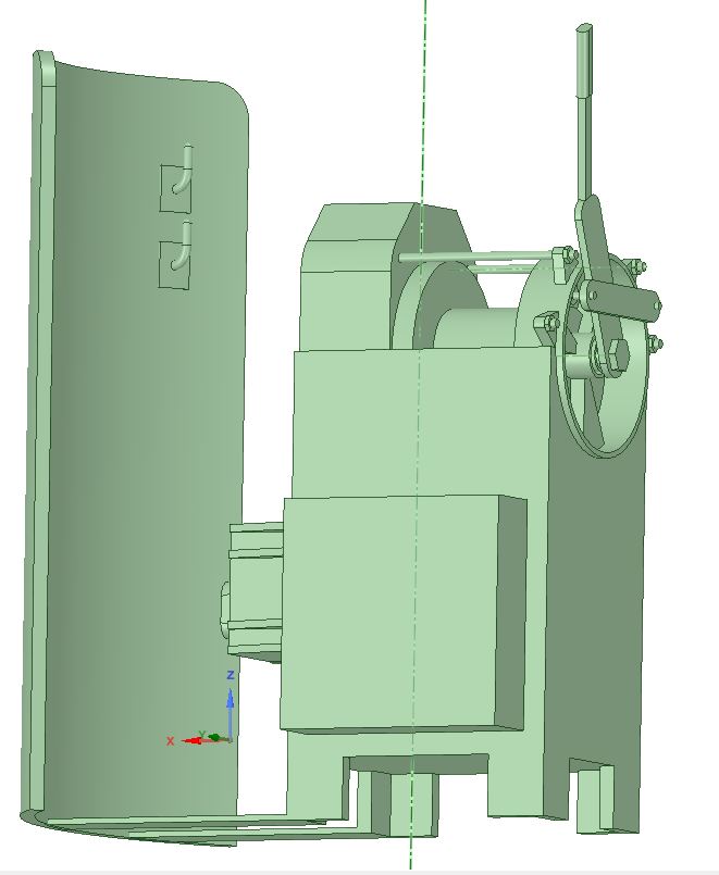

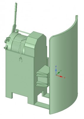

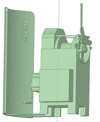

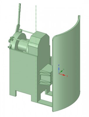

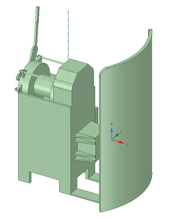

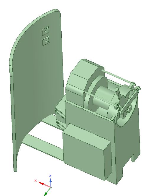

Anyhow, there appears to be 2 different versions of BT wenches used on FLETCHER class DDs - a small compact winch and a larger more robust unit. Judging from my photos of STODDARD, I can only recall that there wasn't a lot to this equipment, so I'm going with the smaller unit - and only one photo that Willie provided on his build. So, here is the design file drawing of that wench:
I will print one at scale and one with 5% as I usually do and see which one prints correctly. I've added those to my exterior 12" portholes so they'll all (hopefully) print out tomorrow.
Posts: 5068
Post by Fliger747 »
hank:
Looks really good, only addition might be some cable texture on the drum? I have had some luck (emphasis on the later) in findingphoios showing such equipment in the background of onboard personnel photos.

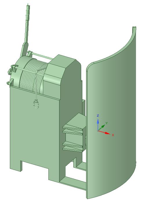

BB62vet
Posts: 3145
Location: Mocksville, NC
Post by BB62vet »
Fliger747 wrote:hank:
Done! Check it out - I've got it and several other parts printing - so we'll see how it looks soon enough!

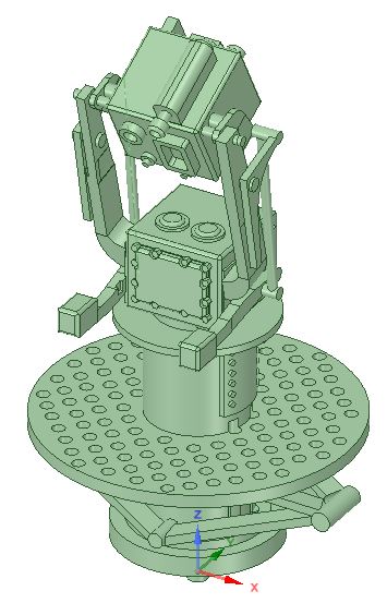

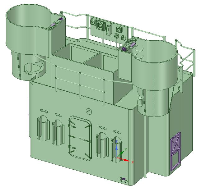

Well, it's been over 6 months since I've posted anything on this build so I figured an update was in order. I've recently been doing a bit of work on this model - I've finished the basic hull work and have now gotten the boot topping painted and am starting to tape off the actual measured black waterline area. Completing the support struts for the shafts is next and then spraying the hull bottom. I am using Mr. Color flat or satin lacquer sprays.

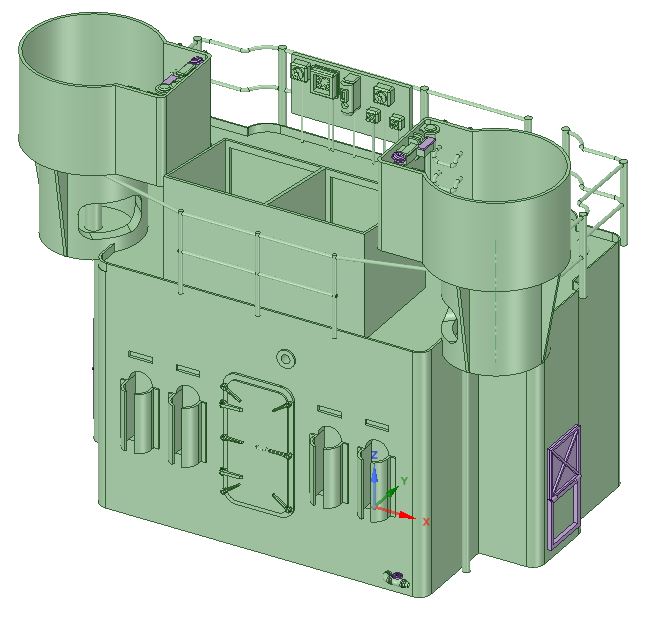

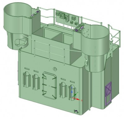

A couple days ago I was looking over my scratch built 01 Level 3"/50 R/S room w/Mk. 63 FC Directors and realized that it was quite substandard in quality and decided to go ahead and design/print this entire unit in 3D. So, over the last couple days I've done just that. Here are the results:
DD566 01 Level 3in50 R/S Room

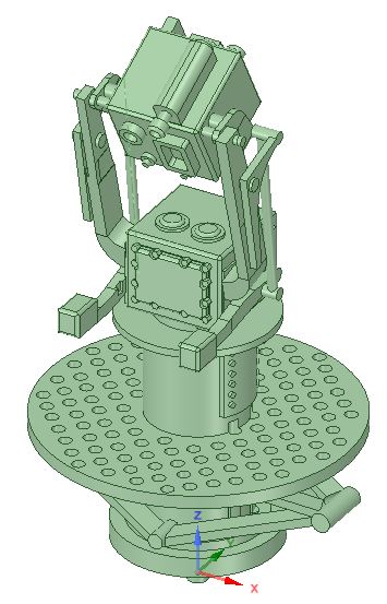

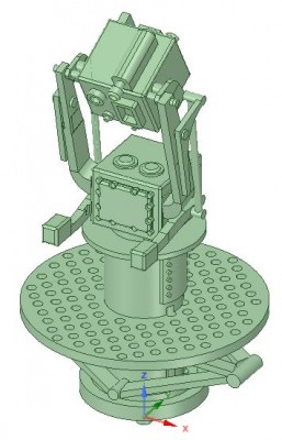

There is also a 3D Pelorus which I also design/printed which will be installed in place of the purchased part from Shapeways. And lastly, the Mk. 63 FC Directors are parts that I've slightly modified from Tom Falley's original design. Here is what these look like:
Mk. 63 FC Director
Mk. 63 FC Director
I had early on purchased two of these parts from Shapeways, but having broken one of them and fixing it was nearly impossible, this has proven to be a good exercise in design and sharing, etc. All of these items will be printed in Rapid Black resin which has a more "giving" or flexible attribute to it than does the older style white resin used in the Shapeways products. I no longer purchase any of this stuff - why should I, I can make my own :doh_1: :doh_1:
Willie
Posts: 690
Location: Vigo, Spain
Post by Willie »
Howdy Hank and all,
Again excellent progress, and if you are able to print all this (very easily, I presume, after seeing what you did with the 3/50 battery), hats off to you sir.
BB62vet wrote:I had early on purchased two of these parts from Shapeways, but having broken one of them and fixing it was nearly impossible, this has proven to be a good exercise in design and sharing, etc.(...) I no longer purchase any of this stuff - why should I, I can make my own.
Absolutely. No need to buy what you can make yourself, letting aside the pleasure of seeing something you have done alone.

Looking forward to seeing the printed superstructure parts! The Mk 63 prints OK in 1:144 using the Rapid Black, the counterbalance arms seeming to be the most fragile part subject to breakage. Yes the increasing quality of what we are able to do often leads to serious modification and replacement of our previous efforts. On the APA I replaced every one of my hand made LCVP's and all of the 20 mm Orlikons and every 40 MM Bofors. Rather laboriously hand constructed!

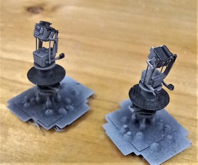

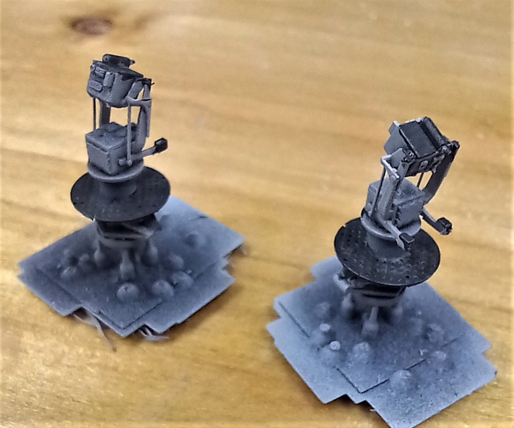

You'll have to wait a bit longer....my first two printings of the R/S Room are OK, but I've made a few redos on small items that didn't print a well as expected - handrail stanchions and the FC Director Tub walls. So, I'll do a 3rd edition sometime today.

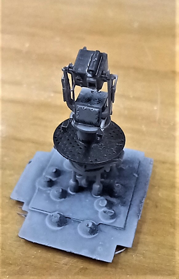

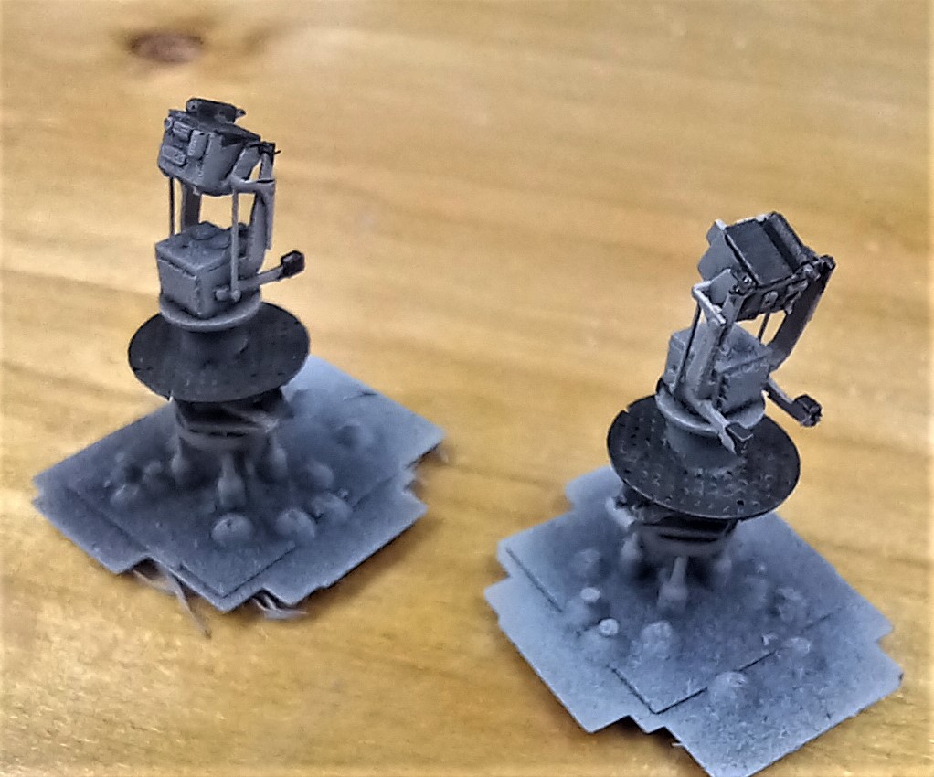

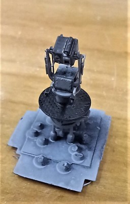

The Mk. 63 FC Directors you provided thru our CONUS Lend-Lease program are now printed & painted:
Mk. 63-3rd Edition_1

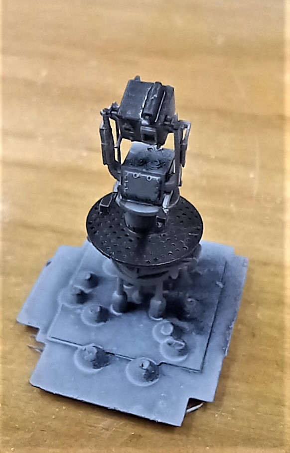

It took 3 printings to get it to the proper size. I made a couple minor mods to the basic part and then begain printing. I now have 5 out of 6 (I broke one in removing supports), so currently have a surplus as I only need two of these. Here's another shot of a couple more of them:
Mk. 63 FC Directors 3rd Edition
I would say that these are quite a bit better than the ones available thru Shapeways that I had already purchased.
So now back to get the R/S room deck house successfully printed, etc.
