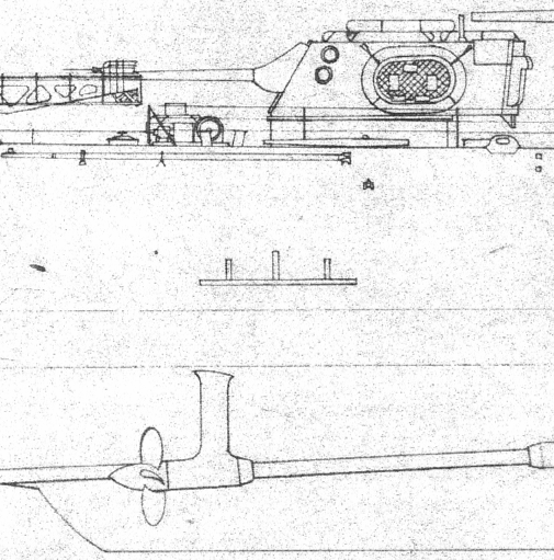

Hi all -
For the life of me, I can't find the earlier discussion that covered the prop guard locations on the ST LOUIS and HELENA vs. the BROOKLYNs and CLEVELANDs. I've searched both CASF threads to no avail.

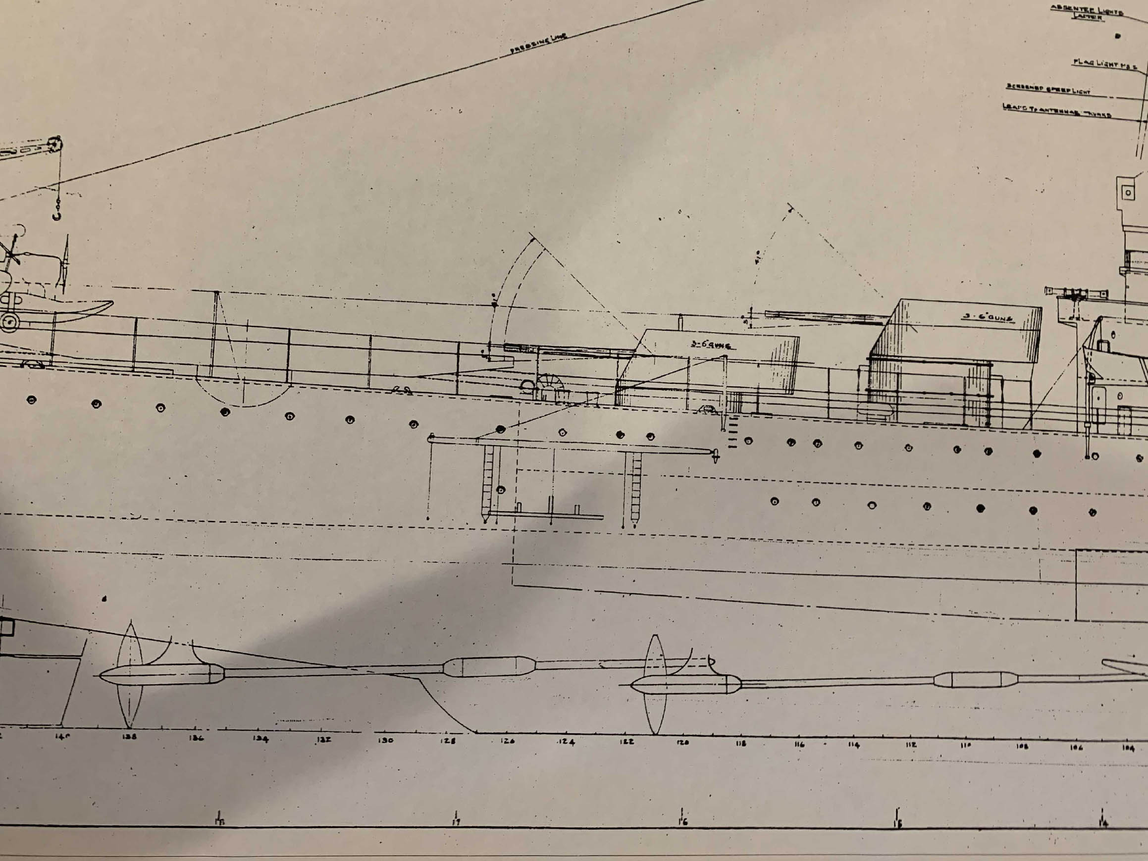

I'm wondering about this because the Alan Chesley drawings of HELENA show the prop guard in the correct location (according to photographs) -- almost abeam the after 6" turret. However, these same drawings show the outboard propeller aft of this position which makes no sense to me. Surely the prop guard would be centered exactly over the outboard propeller?
Here is the drawing in question:

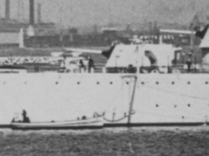

Here's a crop of NH 95816, showing CL-50 off Boston on 6/15/1940:
As you can see the Chesley plans show the prop guard in roughly the correct location and line up nicely with the pre-war photo.
My suspicion is that the underwater hull drawing from Mr. Chesley shows the outboard prop in an incorrect location. For what it's worth, multiple other illustrations of HELENA perpetuate this error (I suspect they were traced from the original Chesley plans of 1979 without consideration for these sorts of details). Is it possible the Chesley plans used the underwater hull of the BROOKLYN class cruisers incorrectly? My assumption then is that the rearranged machinery in ST LOUIS and HELENA resulted in slightly different underwater configurations, but I haven't found any plans of ST LOUIS or HELENA that prove this one way or the other. I've ordered the 1935 "general arrangement" drawings of ST LOUIS available from Floating Drydock hoping they will show the configuration and answer this question...
Thanks all!

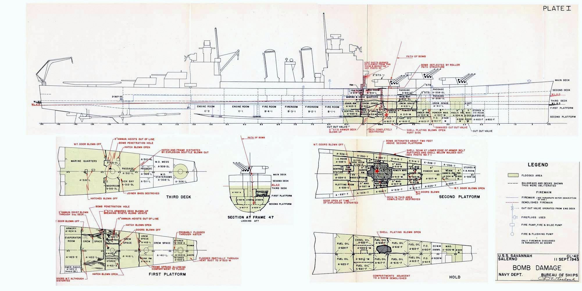

If you compare the Savannah battle damage drawing to the USS Houston CL-81 battle damage plate you will see the forward (outer) props are just forward of frame 125 on the Cleveland class ships, while aft of frame 125 on the Brooklyn class. The Helena and St Louis have the same engineering plants as the Cleveland class not the Brooklyn class. I mean this as both in layout and in steam pressure. By moving the props forward in theses ships you keep from making extremely long outboard shafts with the extra torsional stress on them. The St Louis subclass was the first light cruisers with unit propulsion which had alternating boiler rooms and engine rooms. The extra separation was supposed to help with battle damage mitigation. But if you see what happened to the Houston, the torpedo exploded below the starboard fwd engine room destroying the turbines and reduction gear and flooding both sets of boiler rooms putting her dead in the water.

Here's the deal. Ships that have prop guards will always have the guard right above the propellers. Only change in this could be if one was destroyed and it was quickly repaired and not placed in the correct position. However that shouldn't be the case because in most cases there would be tell-tail signs of where the former guard was on the hull and a new one would be put back in it's place, hopefully. So with this you can count on the plans are draw incorrectly. I've found using Chesley and Wiswesser plans can get you in trouble. I do not say that as a dig toward these two men but a fact is a fact.

The mystery continues. I received the "general arrangement" plans of CL-49/CL-50 from Floating Drydock -- for one, they show an early draft design of the ships that looks more akin to the BROOKLYN than the as-built design. Interestingly, the shaft arrangement and propeller guard seems to be the same as later plans -- with the propeller guard not situated above the outboard propeller.Ian Roberts wrote:Thanks for confirming my suspicionsI guess we will know for sure once I receive the plans of ST LOUIS.
I have found the Chesley plans of HELENA to be fairly accurate (matching photos), with the exception of the propeller guard and the dimensions of the open bridge. Dick J points out earlier in this thread how all existing plans of the ship don't get this area correct -- Chesley and Profile Morskie show the open bridge to be far too wide and this does not match the photos at all.
Unfortunately, these two resources seem to be the only commercially available plans for CL-50 as lost. I wonder what treasures lay buried at NARA
I think only a trip to NARA to review the microfilm for CL-49 or CL-50 will answer this question...

After looking a a bunch of USS Brooklyn CL-40 photos on Navsource I think the propeller guard is positioned correctly with respect to the after turret, about even with the ends of the gun barrels. So the question is whether or not the location of the outboard propeller is correct in the drawing.
There is only one photo showing the ship in the ways before launching from an oblique stern view that shows the underwater configuration. The propeller has not been installed, but it looks like it is closer to the position of the propeller guard than the drawing shows it.
In the USS Savannah CL-42 section I found this war damage report (after being hit by the German Fritz-X glide bomb). Notice that the outboard propeller is shown about even with the ends of the gun barrels on the after turret at about Frame 126 - about where the propeller guard is positioned in your drawing at the aft end of the armor belt.
Broadside photos of the USS Honolulu CL-48, USS Boise CL-47 and USS Phoenix CL-46 appear to show the propeller guard in the position shown in your drawing!
These were all Brooklyn class ships.
Pictures of the USS St. Louis CL-49 appear to show the propeller guard farther forward outboard of the face of aft turret, at about Frame 122 which would place the outboard propeller in about the position shown in your drawing, with the propeller guard in the wrong position.
Drydock photos of the USS HelenaCL-50 show similar positioning of the propeller guard relative to the outboard propeller. The position relative to the aft turret is not shown. Unfortunately the battle damage report for the Helena doesn't show the propellers or propeller guard.
St. Louis and Helena were both "modified Brooklyn class" or St. Louis class.
Drawings in Norman Friedman's "USS Cruisers" page 209 show the Helena outboard propeller position several frames aft of the ends of the gun barrels on the after turret. Pictures of the Brooklyn (page 199) show the outboard propellers farther forward at about the ends of the gun barrels. Both show the propeller quite a but more aft than in your General Arrangement drawing.
All of this is inconclusive, but it looks as if the St. Louis and Helena may have had the outboard propeller farther aft than in the other Brooklyn class ships. Given the drastic rearrangement of the engineering spaces on the St. Louis class it wouldn't be surprising to see a change in position of the propellers.
You have to take the General Arrangement plans with a grain of salt. They were often conceptual drawings made before the ships were actually built, and before modifications had been made to the design. In the case of the drawing you have it might have been drawn up from an early Brooklyn class hull drawing with modification for the St; Louis class.

For my own rendition of HELENA in July 1943, I placed the prop guard in the position verifiable by photos and moved the outboard prop and shaft to match. If I'm ever able to make it to NARA and examine the microfilm for these ships I plan to come back and ensure the shafts are drawn correctly - this is my "best guess".

Ian,
I suspect the prop positions in your drawing are for the early Brooklyns, and St. Louis and Helena had them a bit farther aft - but that is a poorly educated guess!
You could just order the microfilm on DVD from the National Archives and save the cost of a trip (depending upon where you live). I am in Oregon so a trip is just not practical. It was cheaper for me to order all of the Cleveland class microfilms.
Unfortunately, I suspect there will not be a single index reel for the Brooklyn/St. Louis class. The USS Cleveland CL-55 microfilm has an index at the beginning of each reel listing only the blueprints on that reel, so I had to order all 19 reels. Most were door and furniture lists, lists of label plates over doors, wiring, plumbing and ventilation diagrams, etc. of no use for modelling. However, by the time of the modified Cleveland in the early 1940s each collection had a separate index reel that listed all blueprints on all physical reels. This was very useful for determining if a desired blueprint was actually in the collection. Many of the Cleveland blueprints were lost and are not in the microfilm collection.
The drawings are in the same order on the microfilm as the Ship Material Group Codes (attached). If you know the number of reels in the drawing collection (the Archivists can tell you that) you can guess which reel might contain a drawing you need. However some material groups are larger than others, and some may fall across multiple reels.
Fortunately, information about the position of the propellers will likely be on reel 1 in the S1 Design of vessel and S7 Docking (drydock) sections. S1-3 has general plans (but not necessarily accurate) and S5 Molds has hull line plans. Section S11 Hull structural and S12 hull fittings will contain the actual construction blueprints showing individual hull plates, etc. All of these sections should be on reel 1. But if there is a separate index reel (the Archivists can tell you this) the plans will start on reel 2.
S43 Shafting and bearings (S43-2 Bearings) has drawings of the propeller shaft struts and S44 Propellers has the prop drawings. In the Cleveland plans the prop struts were on reel 2 and the propellers on reel 10 along with some shaft details and fairings.
A word of caution: There are reels and there are reels! For some reason the entire collection of drawings for a ship is called a "reel." So the Cleveland drawings are microfilm Reel # 5537. But in this collection there are 19 physical reels of microfilm containing 4630 individual blueprints. But each individual blueprint may have been photographed in as many as six overlapping "frames" or photographs.
I got all of my copies on actual microfilm (before the Archives started offering scanned images on DVDs). I do not know how they organize the images or frames on the DVDs. Each physical reel may be scanned to a separate DVD, or multiple physical reels may be placed on one DVD. You need to ask an Archivist about this.
Hope this helps.

Ian,
I'm pretty sure that wasn't the configuration for USS ST LOUIS in July 1943. More like July 1944 (when she was painted in dazzle) with additional changes like searchlight tower removed.
First image is dated 5 July 1943. Second image was taken after she was torpedoed. I see at least two twin 40-mm mounts per side and no quad 40-mm mounts yet?
