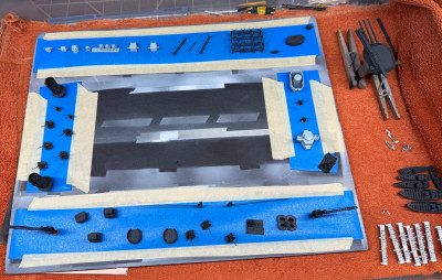

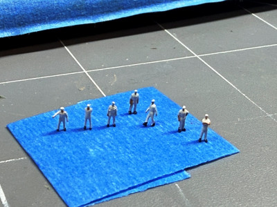

Broke out the airbrush and gave the funnels, cranes and boat stowage another coat of 5D.
Also airbrushed ION figures white in advance of detail painting.
I'll check those for any additional touch-ups, then figure out next steps.

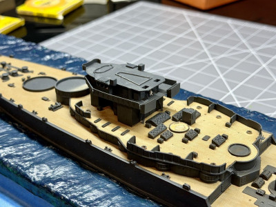

Been a busy couple of months since my last post. Started a new job and my son got married. All that's conspired to limit my time at the bench.

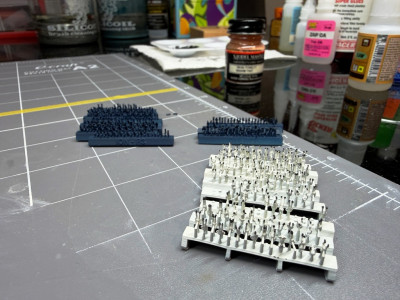

Figures (300+, in both 1/700 and 1/350) are painted. Some of them have been put in place, so I can put the superstructure part over top of them.

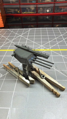

Among other things I was working on was adding while glue to the opening where the barrels protrude from the turret, to replicate blast bags.

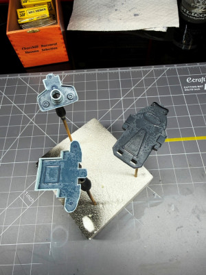

Everything that's been painted got a coat of gloss...
For some reason, the gloss did not self-level on these parts.
That definitely a de-motivator, especially because it happened on some very prominent parts. There were the only three parts that came out like this after glossing. I weathered everything with an oil wash after leaving it all to dry for several days.
Not sure what I'm going to do with these parts, other than say "f*ck it". I've have no interest in trying to strip them and repaint. Nor do I want to buy replacements and start all over again. California might become a "shelf of doom" model until I figure out next steps.

Posted: Sun May 24, 2026 2:35 pm
by Timmy C
No guarantee, but I would just brush the gloss on top and see if that helps. It can't get worse, right?

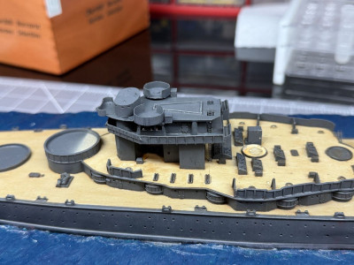

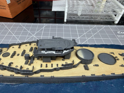

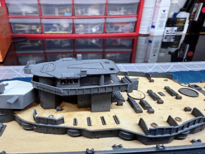

I decided to take the "f*ck it" approach, hoping that directors and other deck gear would hide any offending areas. Having thus decided to give no f*cks, I used slow set CA glue to attach the next level of the superstructure in place.
I then used water soluble putty to fill in the seams. After that dried, I used small Q-tips, dipped in water, to smooth down the excess.
I then touched up the paint, then added the highest level of the conning tower and the 3in gun tubs to this level.
I also added a pair of inclined ladders to the back of the superstructure, and filled in a seam around the back of the water soluble putty.

Looks good. The self leveled area just looks like it sees heavy foot traffic.

Regarding the splotchy painting photo - I get that when I'm spraying parts and the can is about to go bust on paint, or if the can's spray hole is getting clogged. You didn't say that you sprayed the items, but it looks like it to me.
One thing I'm finding out about Tru-Color enamels (lacquers) is that they don't work well when overpainting with a different color - i.e. touching up haze gray items/areas after painting with deck blue - the colors (in spite of drying overnight) tend to bleed into each other. I don't get this problem with Mr. Color lacquers.
But, your overall superstructure looks OK; I don't think those small areas will be visible once the model is complete.

Thanks Hank. Appreciate the comments. I am painting with Colorcoats Enamels. Initial coats are airbrushed, with some touch ups with a hairy stick.
