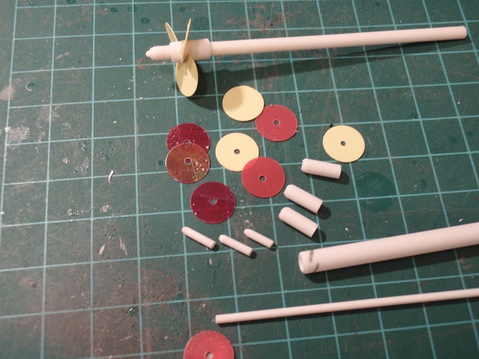

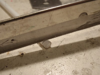

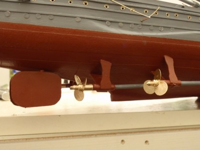

thanks dave.well i built my props,i seached all over the place for something the use as blades,dollar stores,wall mart,but nothing jumped out at me.then i went to a scrapebooking store ,and there they where.perfect circles of all differant sizes.they are made of fairly stiff plastic.about 50 in a package for $1.99 .all i had to do to mount them on the shaft was make three cuts with my razer saw at the correct angle.
the little holes i filled with filler
it  took about three trys to get the correct angle

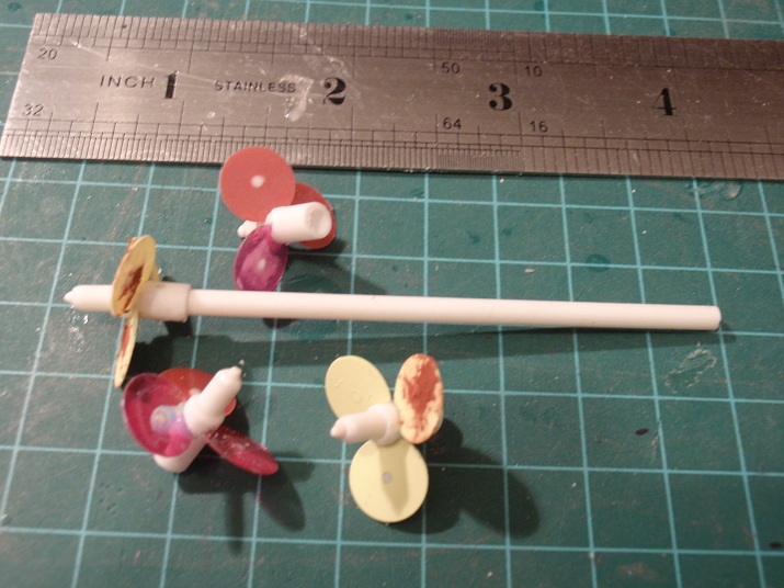

i must have bent the blade on a few, filler fell out of a couple of holes,easy to fix

Hi Russ Making your own props , that is pure scratch building :worship_1: . I have to confess I source mine in from G Sitik , I send him the drawing and back comes the bespoked props . I just can't make them the way I would like. :huh:

Never could see all the to do about brass props. Scratchbuilt and painted look fine to me. Great idea and good job! I really enjoy following this build. :thumbs_up_1:

great job Russ the props are beautifull.
as Dave said about
i am purchase too from comercial vendors.
here have some modellers who make your own props
and very well made done.
very good Russ :wave_1:

thanks les norbert,dave if my ship was not a static model i would have to buy some custom props also,mine would self destruct in no time,the main reason for doing my own is that i could not find the right dia.and blade number in a brass prop,and at a reasonable price

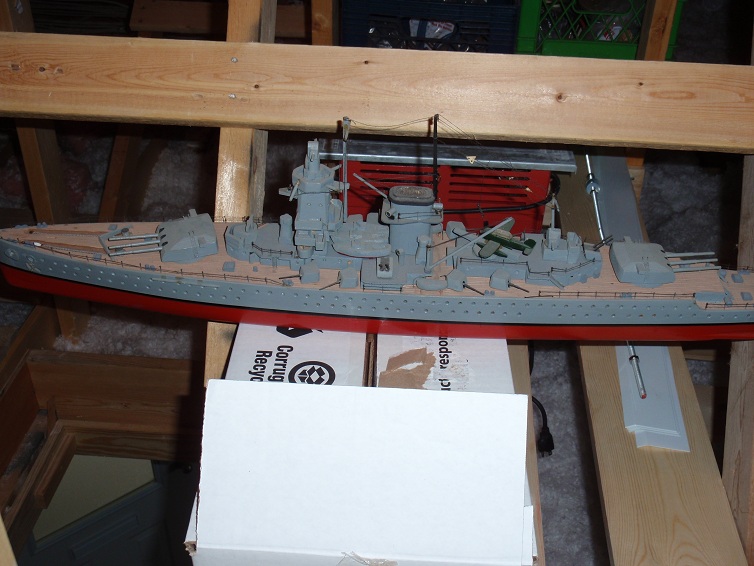

hello all fellow scratch builders.well i should finish nagato in the new year.i will then have a ww2 battleship from every country except germany.i have a fondness for graf spee,having built a curde model of her 35 years ago.she is not a true battleship but she put fear into the allies who treated her as one.she had a very colorful lifespan,and a true gentleman as a captian.i have to decide what scale 1/200 or maybe 1/144.in 1/144 she would be 57.18 in. long .09375*610=57.18 this is to big for my display cabint :heh: in 1/200 she would be .0625*610 =38.12 in. long.but i would like to try a larger scale as my fingers seem to be getting bigger ,and a ship with out a million tiny a.a guns :heh: .my main concern is plans ,is there a good site that has 1/144 plans available,and photo-etch.my other option would be a ww1 battleship in1/200 or a ww1 cruiser in 1/144.heres a pic of the 35 year old graf spree 1/200 scale.

Hi Russ Fond memories of when I was around 8 or 9 years old converting a discarded hull to "look like", at least in my fertile imagination the Graf Spee. I had many a happy hour sailing the waters of my local model boat pond, it was my South Atlantic. This all became more intense after going to see the 1955 movie "Battle of The River Plate�. Even then I found it difficult to reconcile the USS Salem with the Graf Spee but I also grew to appreciate the graceful line of the Salem. No doubt you will find a suitable subject to model , how about the SMS Derflinger

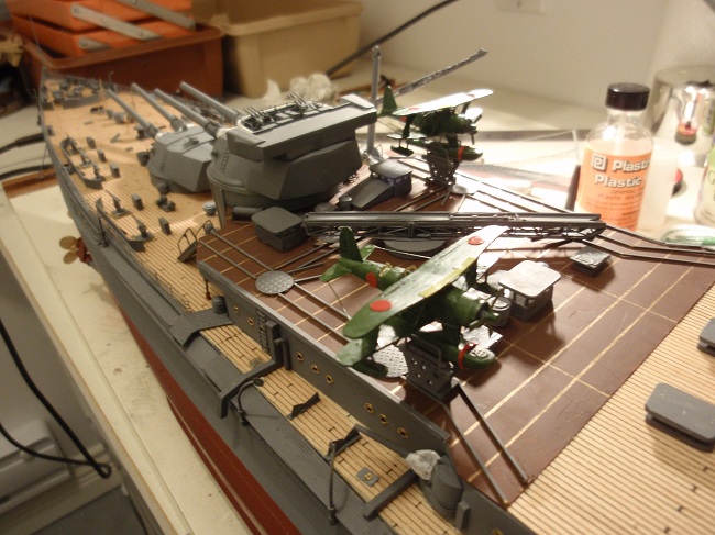

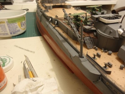

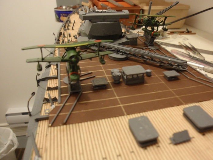

a little more work on the plane deck area,she is starting to come together.this is the time to check and double check before glueing anything.railings and rigging still to do.

Hi Russ A complex track and catapult system and that's just in model form . Nagato is progressing superbly well accomplishing the kind of detail you have shown here with great skill and at 1:200 a scale :cool_2: :thumbs_up_1: :thumbs_up_1: :thumbs_up_1: :thumbs_up_1:

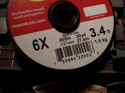

well its time for rigging,i try'd streched spruge,it works fine but,i get a few done and them one will let go :heh: .my main problum is 2 years ago i crushed my left thumb,it now does not bend and has no feeling.and i am left handed.try'd thin thread but it does not look great.i went to a sporting goods store and found a very thin fishing line used for fly fishing leeder,it is about 2 lb.breaking strength and only .127mm thick.i will more than likly use thread for davits and cranes as the fishing line will not hang right when going through blocks and pullys.
this is the line cost only $4.00

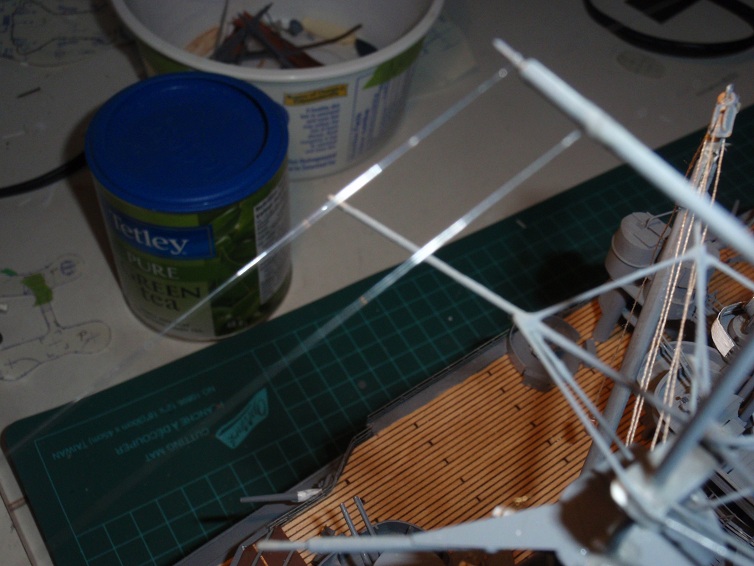

one cannot even see the spot where it is joined to the spar

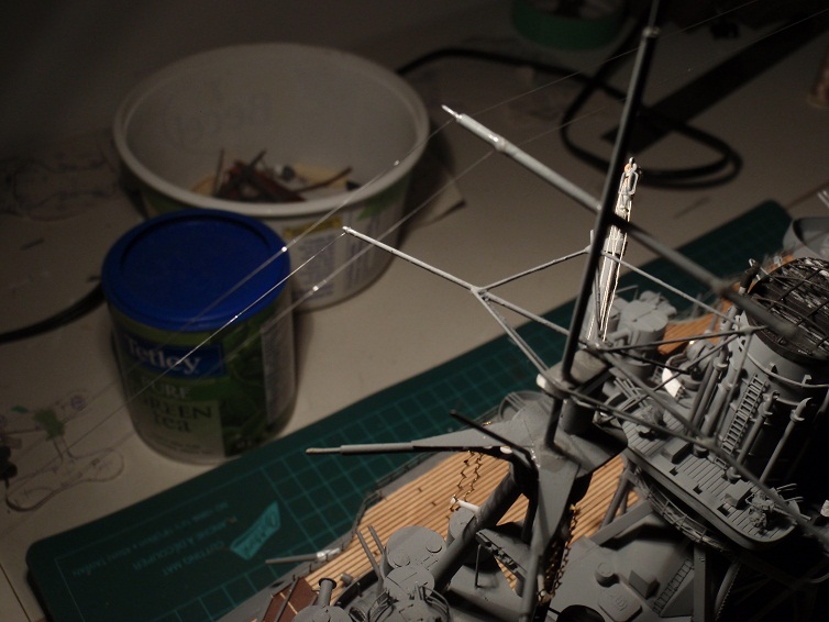

the line is clear but it seems to paint fairly well,closest lines are painted

Post by Dave Wooley »
Hi Russ this looks interesting material .How did you fix the line to the spar ?
