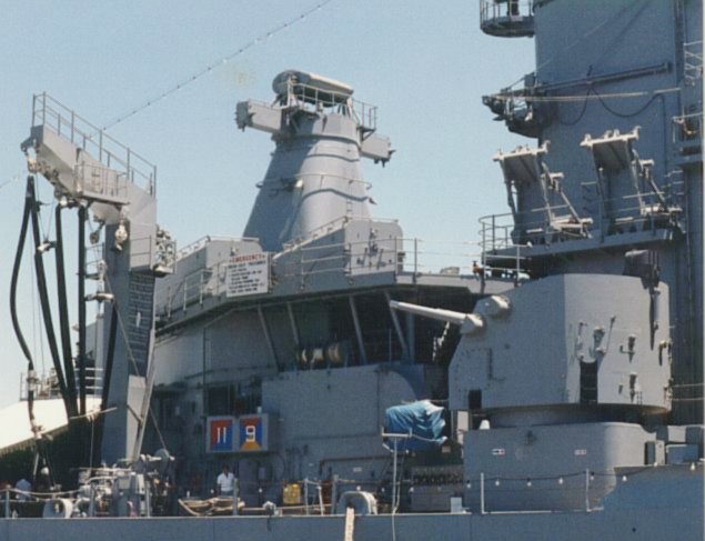

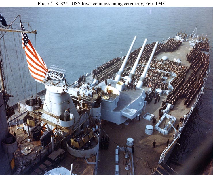

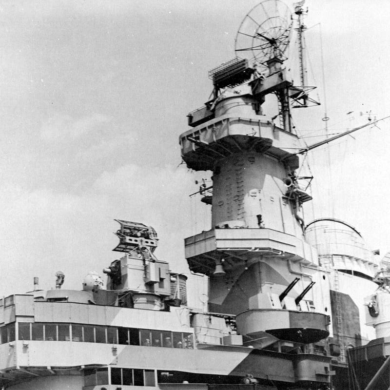

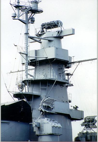

RandyM wrote:Curiously, I've only found two really good photos of WW2-era main gun directors, and I've spent a good amount of time looking around on the 'Net.
Randy, you've probably already seen these but just in case you haven't here are some Mk-38 Director photos for you. Floating Drydock has excellent drawings available as well.
Above: USS Missouri with early radar type
Above: USS Iowa with early radar type
Above: USS New Jersey with late (hooded) radar type

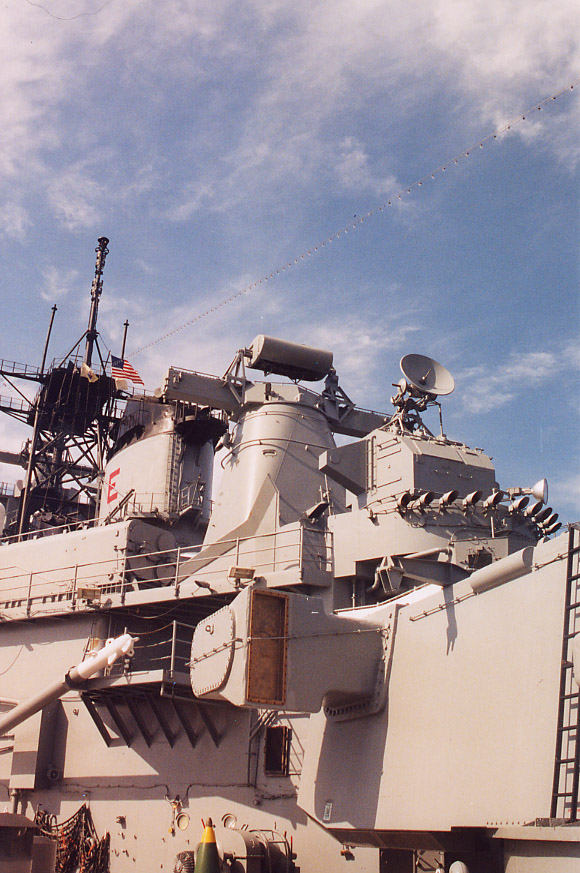

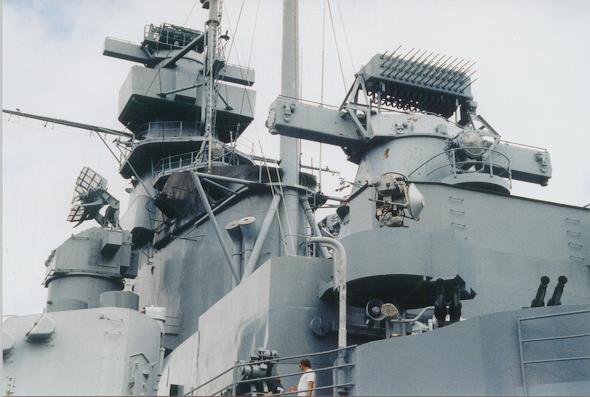

A few more Mk-38 Director photos
Above: USS Missouri with later radar type
Above: USS Massachusetts with early radar type
Above: USS Massachusetts with later radar type

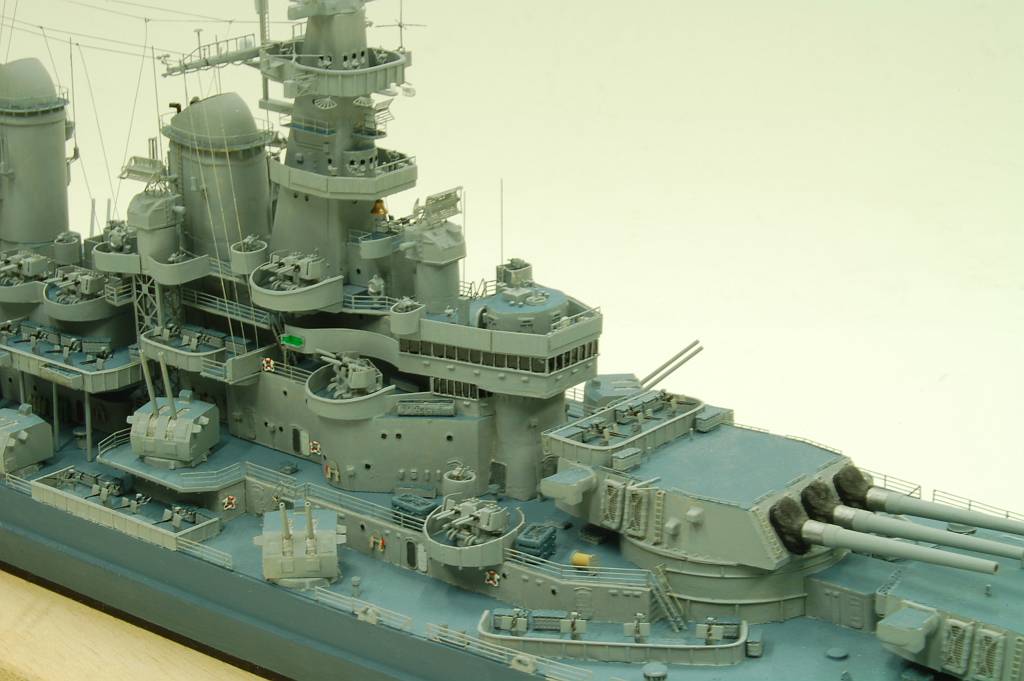

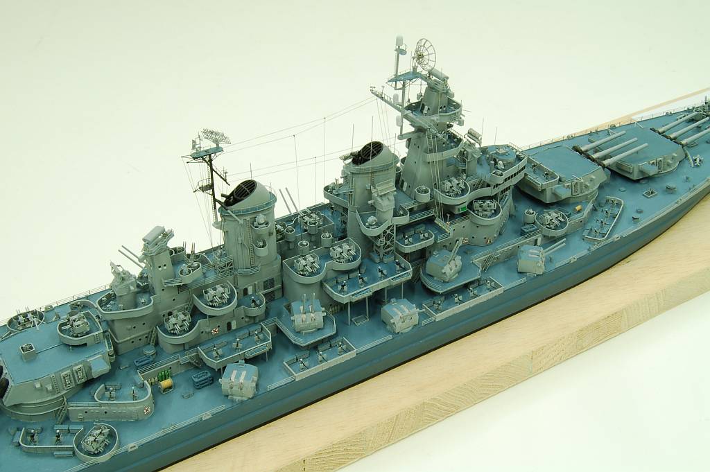

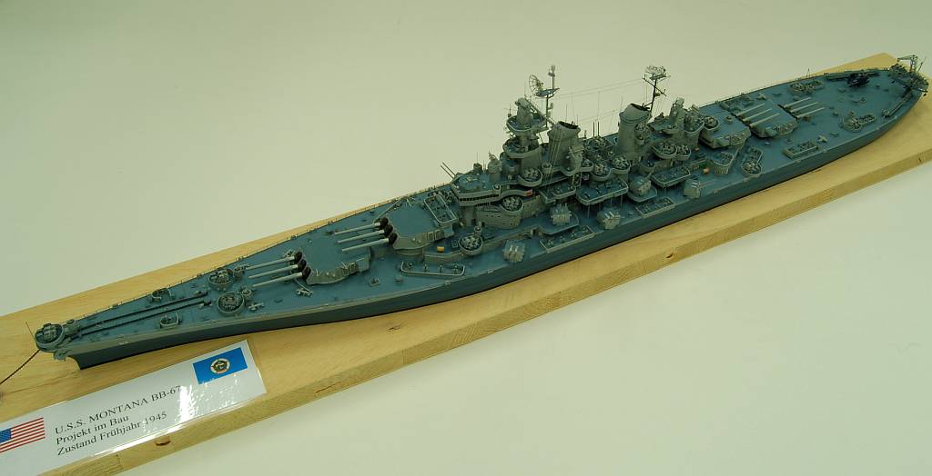

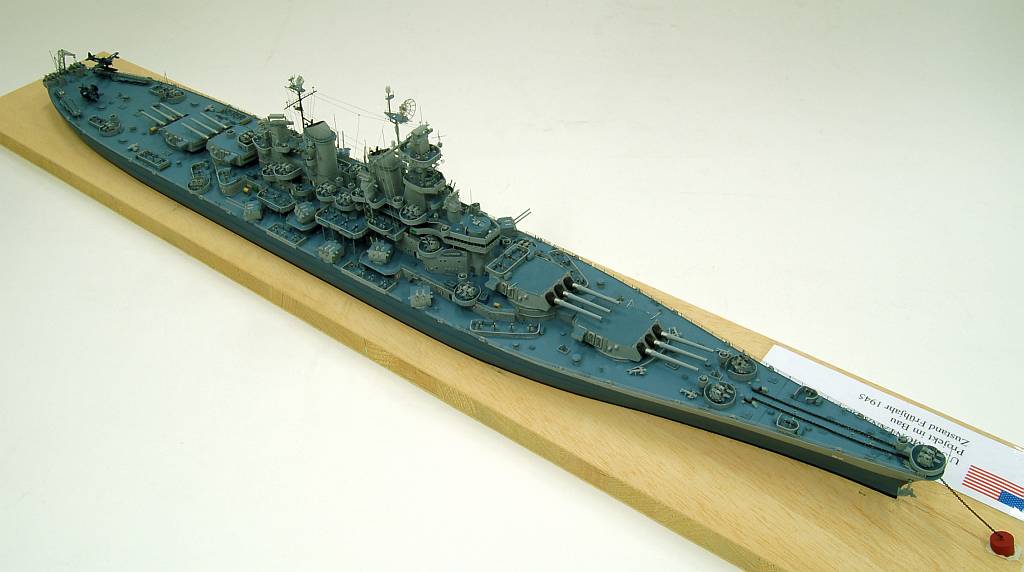

Hello Montana Class Fans,
here are some photos of my interpretation of the USS Montana (BB-67).
The first shows how i "filled" the space between the two funnels with 40 mm Bofors and 20 mm Oerlikon Twins.
The two others show an entire view of the ship.
So far the Montana is about 95% complete, some details will have to be added to 01 and 02 level bulkheads, one
or two whalers stowed on the quarterdeck, the swinging booms on port and starboard and the rigging has to be completed.
I would like to hear some opinions about my interpretation of the Montana Class.
Thanks in advance,
Jan Schulz, IG Waterline, Germany
View from starboard
View from starboard
View from the port side
Midship area viewed from starboard

In a word: gorgeous. I want to see more photos - I like the way you answered many of the questions I have with this ship. Very, very nice!

Jan, your interpretation of a Montana just blows me away. Awesome! :woo_hoo: I like the arrangement of the 40mm between the funnels. Good work!

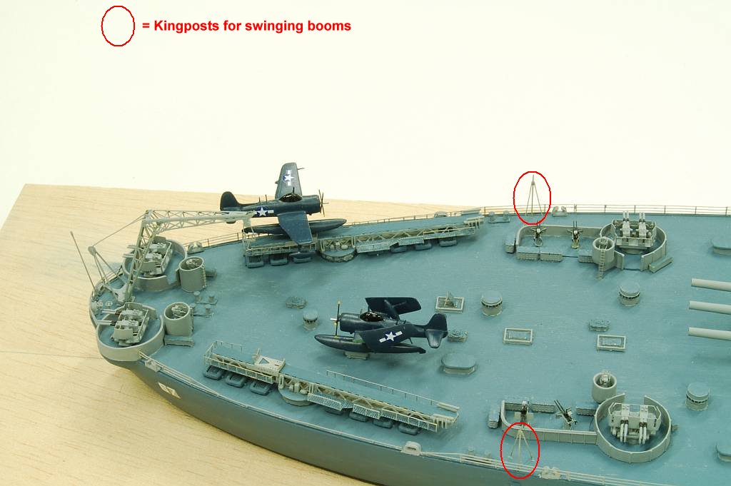

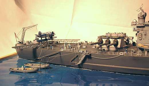

EJM,
the above mentioned swinging booms are equipment parts to accomodate the ship�s boats or other traffic
boats. The boats are fastened here with lines allowing them to swim with the current. This method is used when
the ship at roads when the traffic boats are needed to do the personnel transfer or else. Each boom is attached
to the ship�s hull underneath the kingpost ( marked by circle on photo DSC_0357_1 ). The kingpost must be erected
manually and does stabilize the boom when it is swung out to its working position. In the stowed position the
boom swings forward and is secured to the hull.
P.S. a nice example of a japanese swinging boom can be seen on Peter Van Buren�s beautiful Nagato in the battle-
ship section of the picture gallery ( photos "nagato-21" and "nagato-27" ).
I hope that helps.

Example of swinging booms (Ship: 1/350 Iron Shipwright USS Washington build by Bernd Villhauer)
