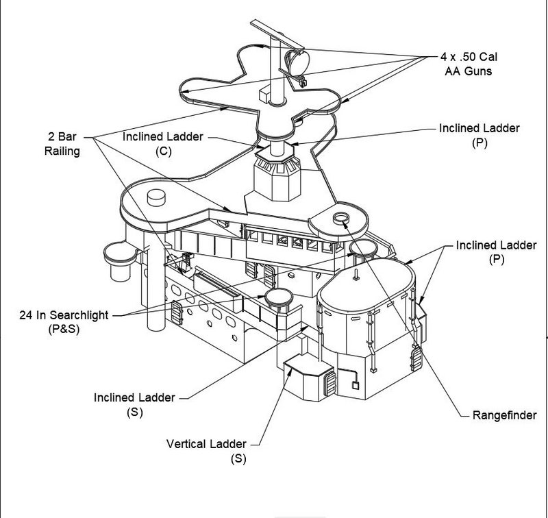

Would like to solicit the advice of the board on the following schematic. Looking at all of the available images of the Nevada just after the attack, I have developed this design of the bridge. Do I have the fittings called out correctly? I used the GP's of the Oklahoma, but used photographs and the Nevada's Damage report to model the differences between the sisters.
Thoughts?

Hi Matt,
Looks very nice. Notice the rounded edges on the backside of Nevada�s MG platform around the searchlights.

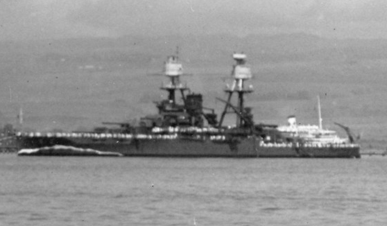

Came across this beautiful picture of the Nevada on a Facebook group. Did not markdown the origin before it disappeared into social media oblivion. Very rare and fairly decent resolution shot looking down.
DougC
Re: Calling all USS Nevada class (BB-36) fans
Post by DougC »
Appears orthochromatic film was used.
Jeff Sharp
Posts: 1056
Post by Jeff Sharp »
Hi Matt,
That is a beautiful pic! Thanks for posting it. Notice also the different deck colors on the superstructure compared to the main mast decks.
