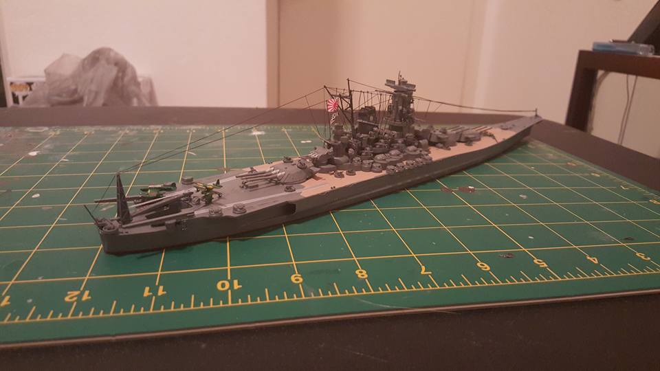

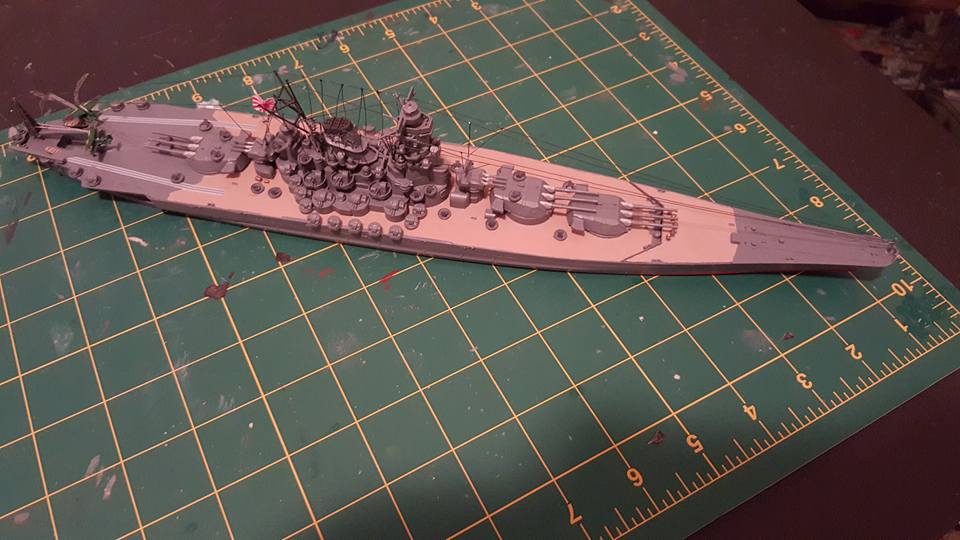

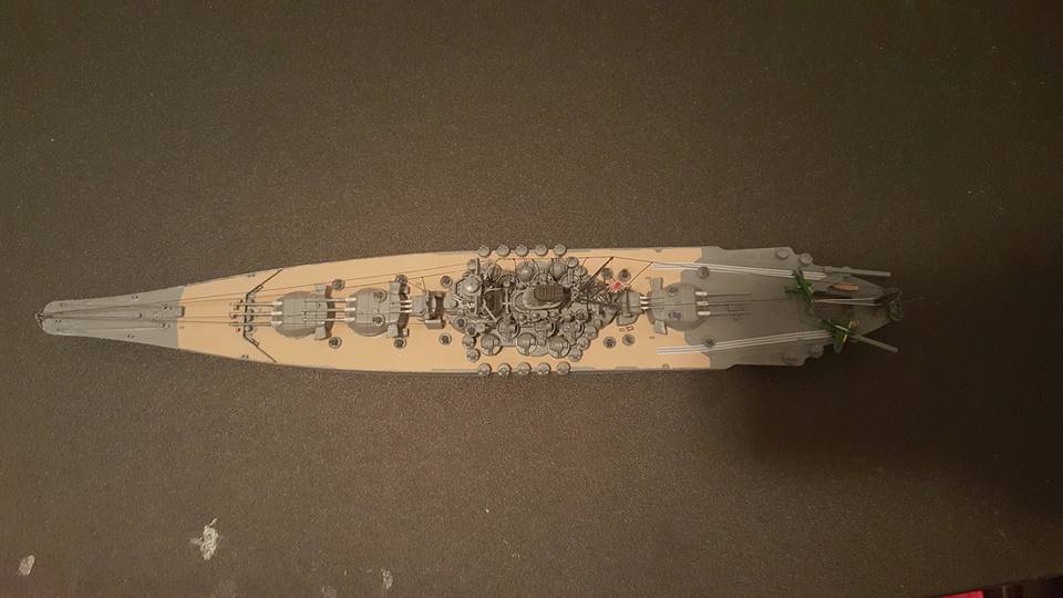

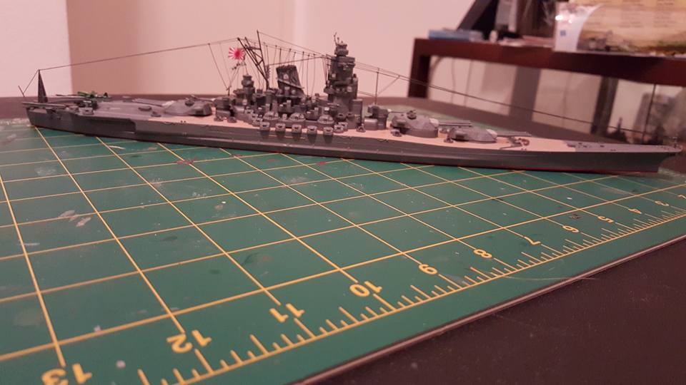

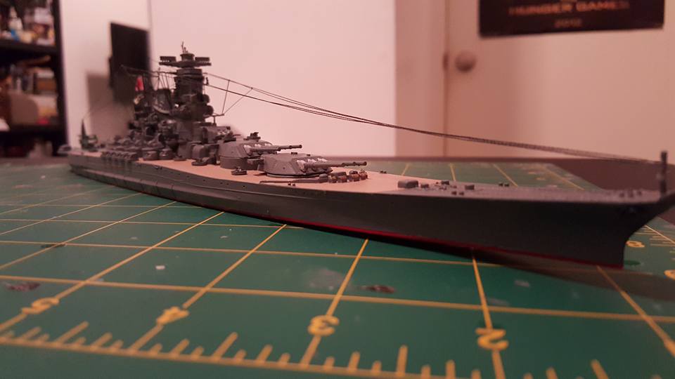

I'm not an uber modeler lol but I have been experimenting with rigging. The 1/700 Tamiya Yamato is my 4rd attempt at rigging (first was Uss Arizona, Slava class cruiser Moskva, and the Titanic). I attached some pictures of her below to show what I did for the rigging.
I did a combination of thin string and stretched sprue. For the stretched sprue, would heat one end till it was really soft and starting to melt, placed that end on a solid surface and would slowly drag it across the surface and when I had a decent length, I would press or grab snips and cut the end. Measured the desired length and would cut that length from the stretched sprue. Dabbed one end in glue, placed at desired location, then dab a little glue where the other end was anchored. For the string, would measure out the appropriate length, dab one end in glue, place it in the position and location desired (would have it a little longer then needed as some times the length was to short to really mess with easily), then glued the other end down.
I did notice, it is easier to use stretched sprue on small, short lengths ( masts, cross rigging, crane rigging, etc.) while it was easier to use string with longer lengths (pole on the bow to forward superstructure, masts to deck, and aft mast to stern pole/ crane)
