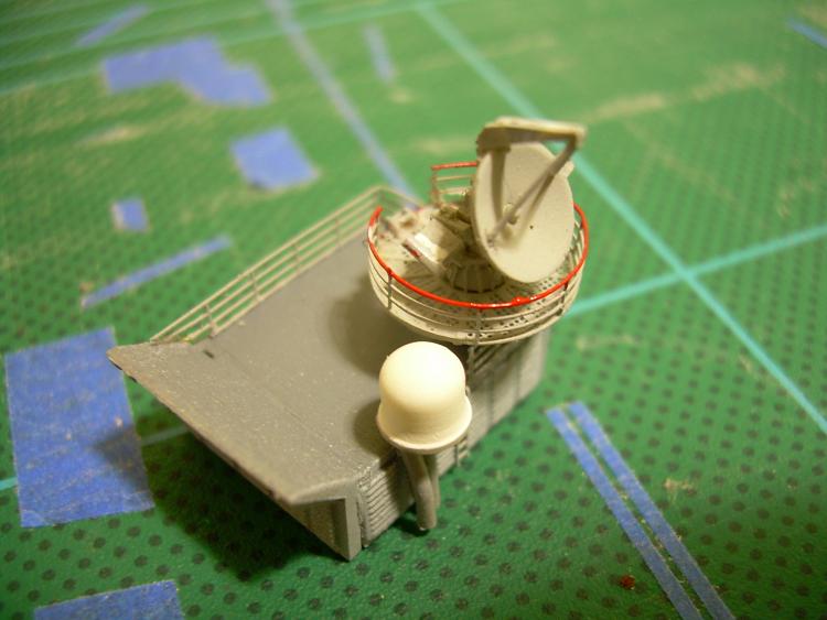

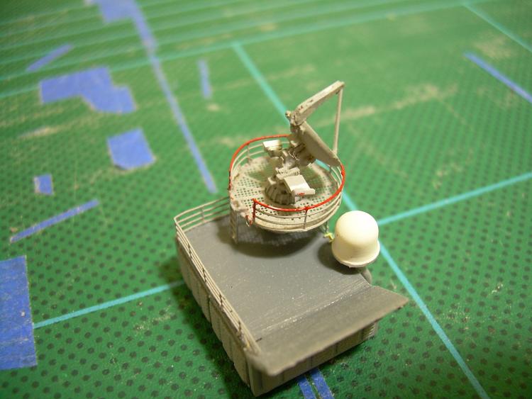

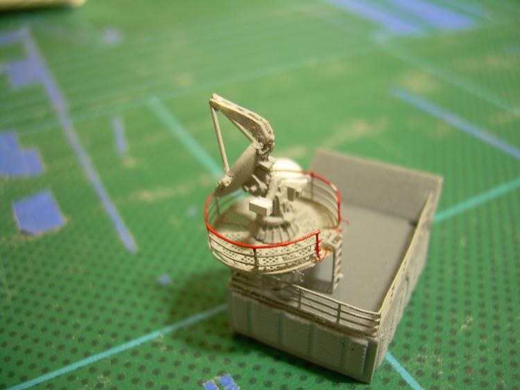

I took Spruance down to the local Hobby Town USA competition, and it was well received. Railings are the only thing left. Now that I'm back, time to finish this pig up!!!
Here is SPG-51 #3. All that back and forth with the Mk-91 director and sea sparrow and all that BS, it goes right back to the SPG-51 again. This is the aft A/C unit where the Sea Sparrow directors Mk-91/92s were on the Sprucans. This position is also where a SPG-51 was originally supposed to go in a "DDG conversion" of the Spruance-class. This conversion was supposed to turn them from just ASW ships to AAW ships as well, and it was supposed to happen approximately 10 years into their service lives. So naturally, this is a great place for the director.
Before long, pictures of the finished beauty.

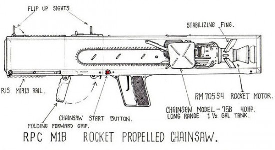

Can you say, "all you can eat buffet?" When the inevitable zombie war comes...oh boy! Tokyo is going to be in baaaaaad shape.

Rocket propelled chainsaw?!! That's awesome. :lol_pound:
Careful, though. One of those could sink an LCS!

carr wrote:Rocket propelled chainsaw?!! That's awesome. :lol_pound: Careful, though. One of those could sink an LCS!
Preparation is key.

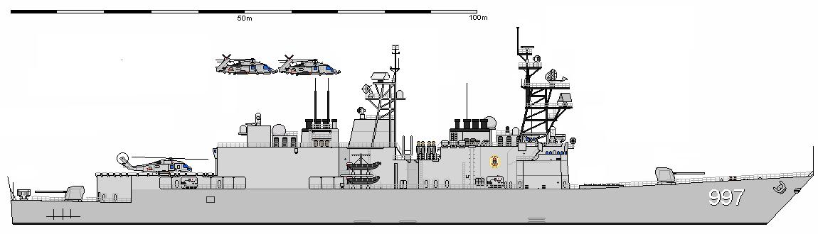

My modernized Spruance will be replaced. I have continued to refine the ideas taking into account some of the inputs other have made in this thread. Specifically Seasick made a few good points. I have figured there could be 2 versions based on the (former) configurations of the ships capable of either just ASW or an AAW.
The missions would stay the same as before:
- Filling the NSFS gap
- Filling the ASW gap
- Filling the numerical ship gap for 15-20 years
- Providing a highly effective AAW capability without the prohibitive cost of 20-30 more Aegis systems over the short-term of fleet growth
- Providing an independent SOF basing and support platform
The modernization of Phalanx CIWS, RAM, radomes, and mast upgrades in the previous build would be similar if not the same as before. Instead of upgrading the aft mast to simply �look like� the Kidd-class mast, it was made clear by CAPT Potter, a Spruance-class subject matter expert, that a smaller, lighter aft mast like that of the Kidds was preferable due to weight concerns.
Regardless of which, both would have the standard modernization of:
Flight II (upper limit of the ASW but a starting point for AAW)
- SPS-49E (v)5
- SPQ-9B
- Mk160 Mod5 GFCS
- 2x Phalanx Block 1B
- 2x RAM
- 2x Mk38 Mod2
- 2x Mk95 ESSM illuminators
- NULKA w/SRBOC
- NTU electronics without the Mk74 Tartar WDS
- SQQ-89 (v)15
- Outboard (equivalent SIGNIT)
- Mk45 up gunned to Mod4 aft (ASW with both forward and aft Mod4)
- Duel RHIBs on the starboard side
- Remote mine hunting drone on the port side
ASW Unique:
- 64-cell VLS forward (TLAM, ASROC, ESSM)
- UAV communications [L-3 Communications tactical common datalink (TCDL) and/or AN/ARC-210 link]
- PCMS/radar absorbant material layered all over the ship's vertical surfaces
The ASW version was the majority of the Spruances. They had a 61-cell VLS arrangement forward. There were several (7?) that did not get the VLS modernization. Those that did not receive the upgrade still had the reserve space forward for the Mk71 MCLWG that the entire Spruance-class was intended to carry in the forward mount. The ones with the 61-cell VLS ate up some of the 8" gun's weight margin questioning its ability to carry the 8" gun forward. With the 61-cell module not in place, those 7 ships could mount the gun and be upgraded with the smaller 32-cell VLS forward with the following configuration:
Spruance FlightIIa (AAW):
- all previous in addition to:
- Mk71 Mod2 in place of Mt51 (making it Mt81)
- 32-cell Mk41 strike length VLS (in place of the ASROC magazine capable of firing TLAM, ASROC, SM-2, ESSM)
- TRS-3D radar on the aft mast if SPS-48 is weight or cost-prohibitive
- 32/48/or 64 cell Mk41 tactical length VLS aft in place of Sea Sparrow launcher (SM-2, ESSM)
- 64-128 Mk41 VLS total
- Full Tartar NTU (Mk74) WDS suite
- SPG-51D (possibly in place of Mk95)
[edit: - SQQ-89? I am not sure about this. It is an excellent ASW sonar, and the ship has the available space internally. Should the AAW version keep it just because it's there? If not, should a different sonar take its place? Should the sonar dome be removed from the ship if the sonar is deleted or would there be a hydrodynamic issue be created with its removal?]
This ship, especially the ones armed with the Mk71 and the extensive communications ability of the Spruance-class, would provide naval special forces with an excellent platform from which to operate and rely upon. The two HH-60s would be able to deliver and extract the SOF where and when needed, and with an 8"/60 forward and a 5"/62 aft, the SOF would be able to call in naval gun strikes or gunfire support when needed. With the Outboard SIGNIT system the ship could collect intelligence upon the enemy from on or over the horizon.
The only reason why all 31 ships "would" not necessarily all be converted to the heavier more formitable version is because a lot of them already had hard structual changes made to accommodate an 8 module (61/64-cell VLS) arrangement forward. Reverting back to a 32-cell would be difficult. In addition to that, the lack of a major AAW system like NTU or Aegis would focus the ship's mission on its next biggest and central mission: anti-submarine warfare. Such focus would enable refinement of the ASW skills, greatly benefiting the ASW capability.
My next iteration of this class of ship will reflect these modernizations. Does anyone have any suggestions or comments?
-navydave

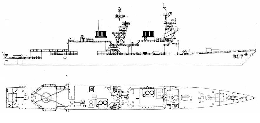

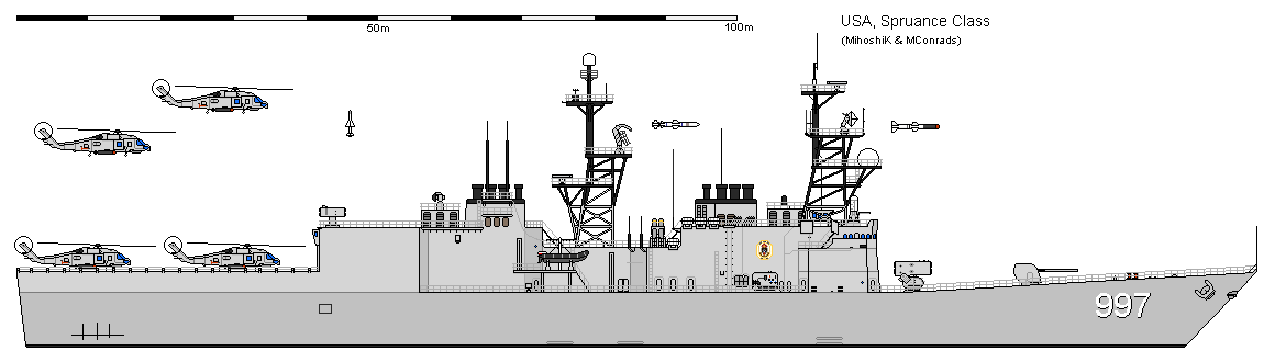

There was a, using modern teminology, Flight II variant of the Spruance ASW designed. The USS Hayler was supposed to be fitted as this ship. The design was to carry "no few than 4 SH-60 ASW helicopters". As referenced from CAPT Potter's book: Electronic Greyhounds: The Spruance-class Destroyers, these bad boys would have been a formitable ASW ship.
So, with this in mind, a question is: If the majority of if not all of the 31 Spruance-class DDs were still around and ready for reactivation would it be desirable...or possible (calling CAPT Potter :big_grin: ) to convert a certain number of them to this DDH configuration?
Flight II
- SPS-49E(v)5
- TRS-3D
- SPQ-9B
- Mk160 Mod5 GFCS
- 2x Mk45 upgunned to Mod4
- 2x RAM
- 2x Mk38 Mod2
- NULKA w/SRBOC
- SPG-60
- NTU electronics without the Mk74 Tartar WDS [AN/SYS-2(v)1, IADTS(v)2, (A)CDS, AN/SYR-1 Communications Tracking Set[3], and RESS - Radar Environmental Simulator System]
- SQQ-89 (v)15
As stated in a few posts before, by nearly perminant alteration (the 61-cell Mk41 VLS) the Spruance-class was primarily an ASW ship. Situated as an ASW ship, the addition of an enlarged hanger and 4 SH-60 ASW helicopters would benefit the mission of the ship. The Navy would benefit from extremely capable ASW ships with a further life span of 15-20 years (a plenty good long life). They would only need marginal electronic upgrades to be "on par" with the rest of the fleet.
So, what do you think about a certain number of the ASW versions being "upgunned" to a full fledged DDH with 4 helos?

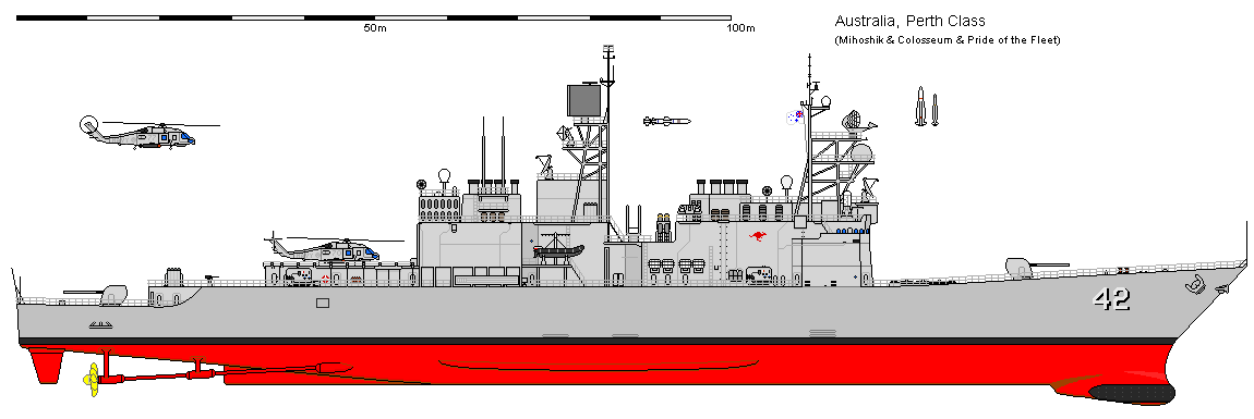

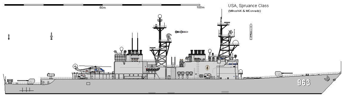

Perhaps a little like this?
HAHA!!! This shipbucket thing is so cool! It keeps me from having to draw ships over and over! :thumbs_up_1:

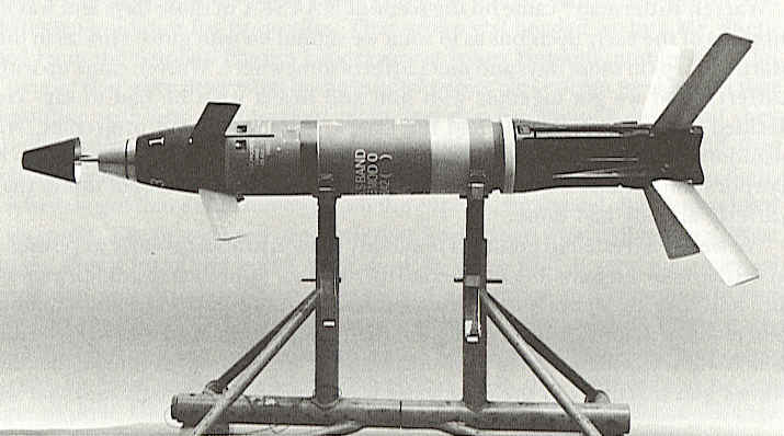

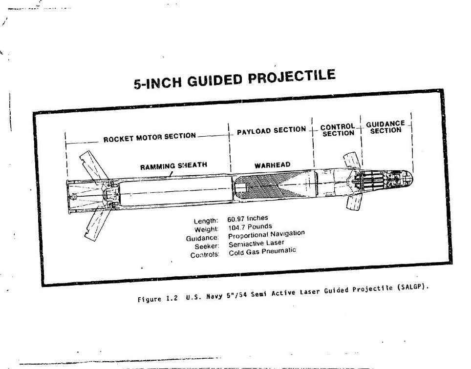

The Ticonderoga HM&E modernized Spruances would have seen improvements of a Mk71 MCLWG and a Mk54 Mod4 guns. In this case they would have had an 8"/60 caliber gun forward and a Mk45 5"/62caliber gun aft. Both would have fired semi laser guided projectiles (SALGP).
The 8" round would have provided a laser guided round with a 30nm range. In this day and age of NSFS to SOF personnel, 8-inch rounds reaching as far as 30nm without rocket assistance it would be invaluable.
With a greater than 82% chance of first time acquisition, and a 2 meter(6.56 feet) accuracy, the 5" semi active laser guided projectile (SALGP) would provide the 5"/62 caliber guns an immediate ability to fire existing precision guided rounds up to 20nm. No ERGM necessary. If such a round were combined with the ERGM booster developed for the ERGM, the range would be extended quite a bit with existing technolgoy.
With such equipment, the Spruance-class would have been able to provide a reliable, accurate, and sustainable fire support capability in addition to all of the other missions in its responsibility.
Both the AAW and ASW ships would have been valuable SOF platforms.
