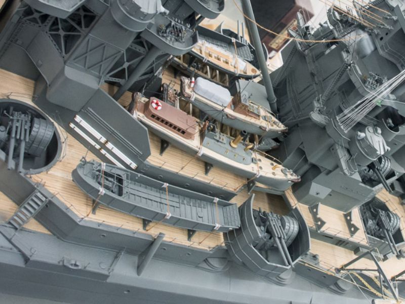

[quote="Mike C"]

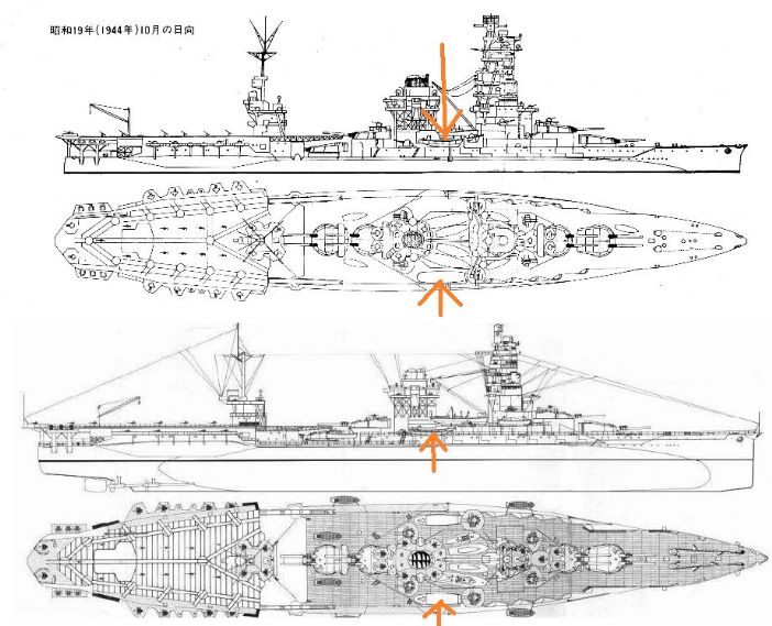

Is the 1/350 ISE kit really that inaccurate?
I have a set of plans from "Detailed Drawings of the Imperial Japanese Navy" and, from what I can tell, they pretty much agree with the kit. (Mike C)
Yes, I agree, general outlines,angles and frameworks of Ise kit model are in conformity with official drawings.(Mutsuo) However, those "detailed" official drawings are the first version design drawing,
(1)details are totally missing. (2)It�s plan view drawing has more details, though.
(3) After they made the first version drawing,they made alternations here and there.
( I have an impression that IJN don�t make it a pracice to make full fredged alternations drawinngs; they just put remarks on seperate sheet of circular papers or in the form of partial drawings where alternatiolns are to be mentioned) The fleet operative officers cared for alternations annd during constuctions at the yard. They are the end users,actually. Not the constuctors.
One exception is the lower, large boat on the starboard side near the funnel is a Daihatsu type and it faces forward.
(Mike)
I don�t see any Taihatsu on the ISE model you have introuced.Truly daihatsu is drawn on thhe official Ise drawing and on Hyuga drwaing, too. I am regarding this as a personal chocie whether one puts daihoatsu aboard or not. You might omit daihatsu, if you think daihatsu does not look beautiful to the 18. Kai Senkan ISE model (Mutsuo)
I'm particularly interested in what are the major problem with the three high angle AA guns or their tubs as well as the funnel platform supports. (Mike)
I�ve already shown it in another post of min,some without images,though.(Mutsuo)
maybe it would be better to scrap the whole thing a8nd build one of these: http://www.shipbucket.com/forums/viewto ... e+hybrid[i] -[/i](Mike)
It will be totally up to you, your decision as a hobby modelship builder. (Mutsuo)

Do you consider the Miyukikai plans for ISE (1945) to be accurate?poste by Mike C.
hi, Mike,
I�m not in a postion to say lots of things about it�s accuracy. However, I can feel the Miyuki-kai is obviously burning his fingers in order to revise the plan. I suppose the company will not be able to anything before a new Gakken Hyuga/Ise book is issued. Not vice versa. Gakken has utmost priority.
This new one(Gakken), if it should come out, will be totally different from the conventionals in many points. Then Miyuii-Kai can use Gakken info as a springboard.The Miyuki-kai owner is in possesion of most of the newer info.However,authorization to use the info(which should go to Gakken first) will have to be asked for,and be granted to the Miyukikai company.I must say this rule and mora codel shouldn�t be broken.
/Mutsuo Sasaki

Mr. Sasaki,
The Daihatsu was on the drawing that I cited.
The Miyuki-kai site states that their last revision to the ISE drawings was in 2007, so I get the impression now that almost all existing references for a hybrid ISE are basically obsolete pending the release of the new book. May I ask you to post something here when the book is released in Japan so we know where to get it before it sells out? The new publisher may not have the same outlets as Gakken did. I am familiar with the deep Japanese sense of honor and propriety.
I was only joking about scrapping the whole thing to do the other concept, but I thought the drawings were interesting.
Best regards,
Mike

[quote="Mike C"]Mr. Sasaki,
for Mike,
??Now i had time to look into the above drawing. I can recall back in 70�es -80�es; official drawings were not available(there was a secret story concerning this,but i spring it over). They had no other choices but to use the same one in order to draw the sistership. Hyuga�s daihatsu most apparently was borrowed from Ise�s . (When I rechecked ,there�s no daihatsu on kure official drawing of Hyuga,1943.
??About this 14 meter daihatsu I can see both facing-forward and the reversed are drawn on the official Kure drawing of Ise June,1944 As there is no explanation/remarks concerning this,i�m not in a position to say anything about the difference in bewteen the two methods.
??yea, you�re right about the above. He will be very anxious for getting the drawing improved,he had told this to me indirectly.
Mike
??I definitely believe it will be announced or informed of. As a matter of fact the new publisher can be the former ijn tech adviser of the Gakken,so knowledgeable and competant in overall researches,they can be cordinating well,rest assured.
BR

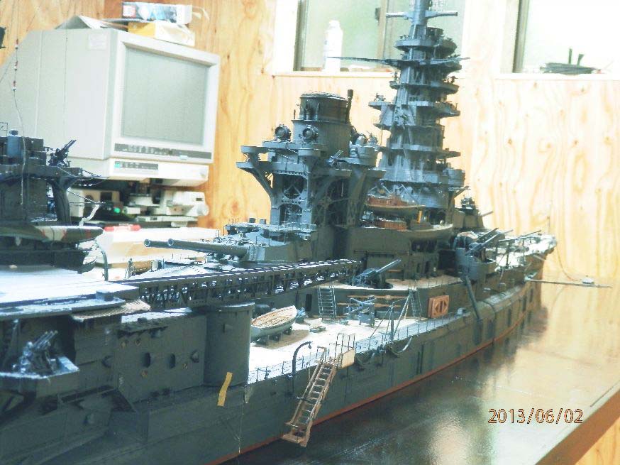

hi, all,
A modeller/owner of a hobby shop in south-western part of Japan built a good model of 1944 Hyuga on 1/100. I suppose he hasn�t had access to Hyuga drawing then,so he had to reply on 1944 Ise drawings where 2 x daihatsu are clearly drawn on it.
If one bases one�s info on existing drawings pr a.d. 2013, Hyuga is not supposed to have these daihatsu aboard as of Sept-Oct.1944. However, when Hyuga was the base of Fukyryuu and Shinyo command unit,carrying and educating for the crews,most probably some type of daihatssu and Shinyo tokko boats must have been aboard for a certain training period. photo sources; check-out-the-most-amazing-war-ship-models-youll-ever-see/ site
The model by mr. TamTam,Aichi(mr.Nakamura) cheers, Mutsuo Sasaki,

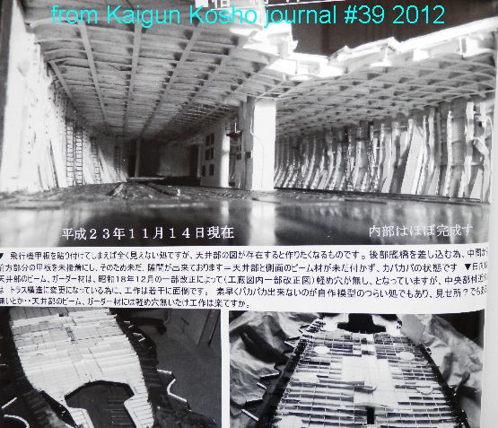

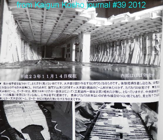

Opening the hangar with the elevator lowered is one of the things I want to do with the 1/350 kit that I have. I'll be looking forward to the release of the new book, unless anyone can post additional details of the elevator guide rails before the book is published.
I see a row of dark boxes along the upper edge of the elevator pit bulkheads. Are those supposed to be the counter weights for the elevator?

------------Mike C wrote:Opening the hangar with the elevator lowered is one of the things I want to do with the 1/350 kit that I have. I'll be looking forward to the release of the new book, unless anyone can post additional details of the elevator guide rails before the book is published.
for Mike C, I can safely say those couterweights are absolutely necessary. All the ijn carriers have �em.One of Gakken IJN ship researchers made a little booklet where he tried to express how the intrior of the hangar deck would look like. In there he made a stress on showing the method of parking the Zuiun floatplanes and Suisei bombers and future type of bombers.Though,he seems to have omitted putting details on the trolleys,the hangar wall and the elevator side wall,too,since these are ot not his main themes in his booklet,understood. cheers, Mutsuo S.,
(one image as deleted for place saving)

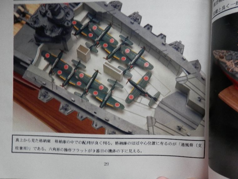

Thank you, Mutsuo! That looks pretty simple, but I suppose you can't see much when the flight deck is in place. The elevator definitely needs guide rails and counterweights.
Those look to be all Suisei bombers. I'm sure the Zuiun floatplanes would have had their wings folded and they'd be sitting on handling trolleys, too.
Did the floatplane handling trolleys double as catapult cradles? Do you know if there was a special catapult cradle for the Suisei bombers? I can't imagine them using the same ones as for the floatplanes. I'm wondering what they had to do to load them on the catapults and I'm assuming that all the bombers had air-cooled radial engines, rather than the water-cooled inline engines used on the D4Y1/2.
Thank you again for sharing your insight.
Mike C

The model of Fujimi 1/350 is to illustrate how the planes are to be stored inside the hangar. It so happened the modeller had chosen Ise. As you might notice from my previous posting,3 types of aircrafts are to be stored;Mike C wrote:Thank you, Mutsuo! That looks pretty simple, but I suppose you can't see much when the flight deck is in place. The elevator definitely needs guide rails and counterweights.
Mike C
Zuiun,
Suisei
Ryusei.
I can see inside on another page of the booklet,since he altered the kit model a bit so the flight deck is removable,smart.
Mutsuo S.

Mutsuo Sasaki wrote:The model of Fujimi 1/350 in his booklet is to illustrate how the planes are to be stored inside the hangar. It so happened the modeller had chosen Ise. As you might notice from my previous posting,3 types of aircrafts are to be stored;Mike C wrote:Thank you, Mutsuo! That looks pretty simple, but I suppose you can't see much when the flight deck is in place. The elevator definitely needs guide rails and counterweights. Those look to be all Suisei bombers. I'm sure the Zuiun floatplanes would have had their wings folded and they'd be sitting on handling trolleys, too.
Mike C
Zuiun,
Suisei
Ryusei.
I can see inside on another page of the booklet,since he altered the kit model a bit so the flight deck is removable,smart. Mutsuo S.
