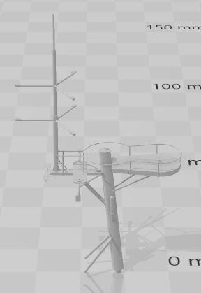

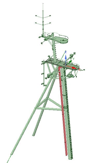

I did design the front leg as hollow, the back two legs are solid. Different diameters involved. I've finished the design and have a Chitu print file set up - 13 1/2 hours print time. Here's a few shots of this effort so far:
Design file shot of the entire tripod structure (minus all the various RADAR antenna and other instruments, etc.) -
Next, here is how the structure is broken down for printing:
Lower tripod mast -
Upper RADAR Service Mast & Platform -
All the individual antennae & so forth are already printed as separate pieces to be added later.
So, tomorrow we'll see if this prints, and if so - does it print complete or a dismal failure..... :doh_1:

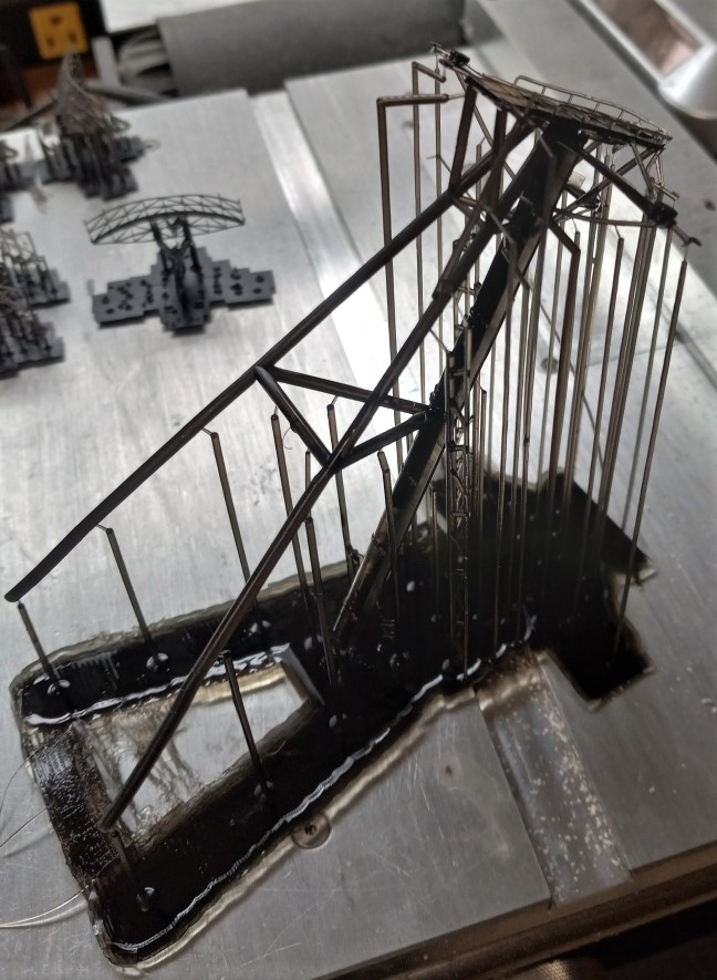

I just removed the 2nd edition Lower Mast from the printer. At this point all seems to be in order!!! :thumbs_up_1: Nothing out of wack that can't be fixed with a bit of careful trimming with the scalpel! So, here is a shot of the 2nd edition lower tripod at the drying stage:
Angling the part and also creating a "raft" for it to sit on were two important things to do. The raft keeps all the individual support legs on one baseplate rather than a separate item (this is an option in the program for setting up the print). Angling the part also slightly reduced the printing time but also made sure there wasn't another jog in the printing process. So, the upper part is now printing (2nd edition) and should be finished around mess call this evening.

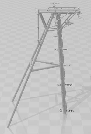

I've been working on design/printing of the fore tripod mast and have evolved thru 3 editions and various prints. All of these have taken a minimum of 10 hours at least and have, to a varying degree, come out quite well although not 100%. My last attempt is currently printing and will run somewhere around 16 hours due to the orientation of the part on the building platform. I don't know whether it will come out complete or run out of height before finishing. My fingers are crossed that this will be a complete part as from what I can see so far, it's printed well on both of the lower rear legs which is the area I'm concerned about.
Here is a shot of the design part to illustrate what the overall part should look like:
So far, I've had the upper portion print very well on 2 of the 3 prints I've made so far, but the lower leg portiions seem to have issues, therefore the additional time, resin, frustration with trying to get these correct. :lol_3:
