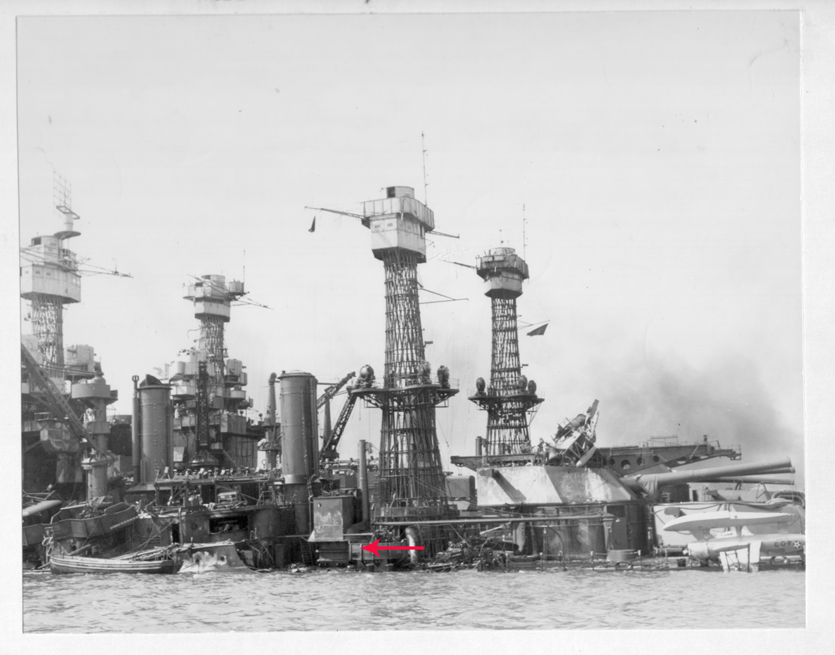

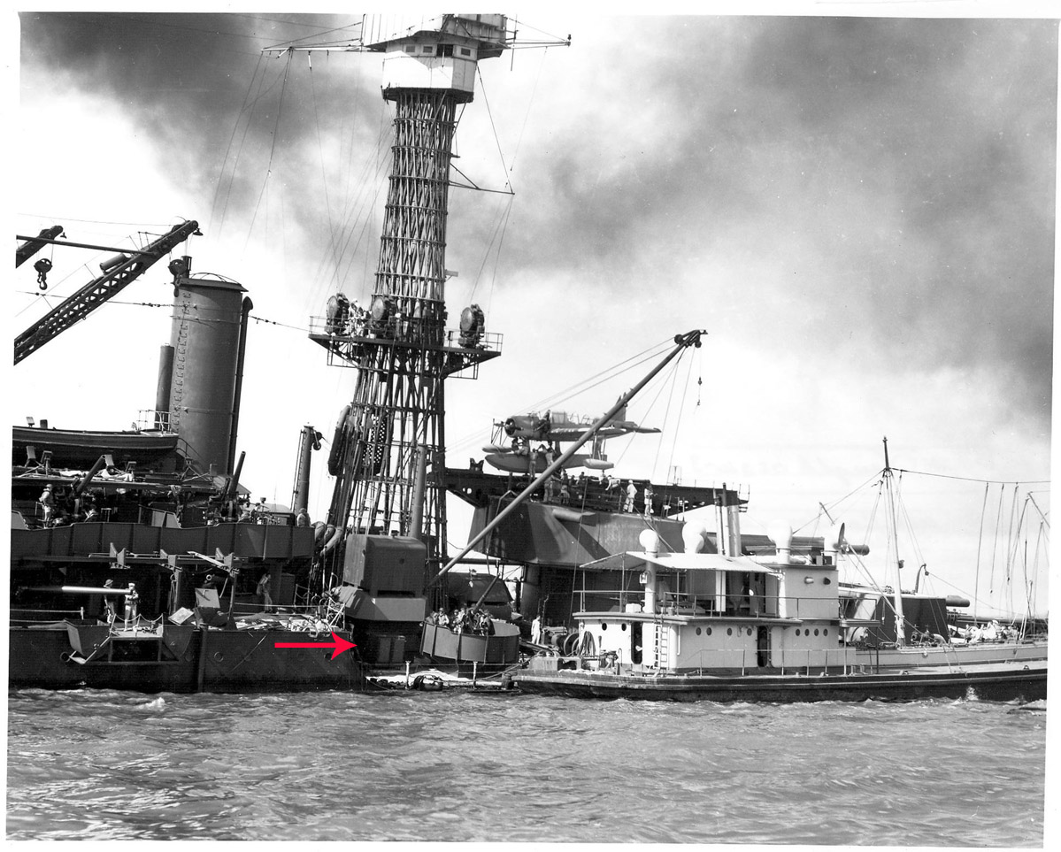

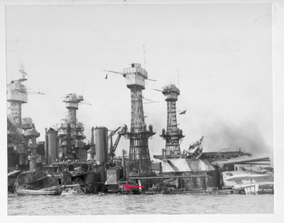

New question:
California (and Tennesse) have readily apparent 3" ready ammo lockers in the vicinity of the aft 3"AA tub. It's not so apparent for West Virginia. The few photos of this area are all post December7th, and no locker is apparent in the same location, nor anywhere else.
Does anyone have better information, thoughts, conjecture? I do wonder if the force of two torpedo hits under WeeVee's 3" tub might have dislocated the locker, or it was removed post attack to aid in clean-up.

That's a great question. Been looking through my archives and going through the salvage report, but alas nothing definitive. I used my high res copy of the image you posted to zoom in-
The lockers if in the same location as TN and CA should show above water still if they were there. What is interesting is there does indeed seem to be something mounted there or at least had been. Your theory about them being dislodged, while possible I do not feel that there was enough devastation to completely remove evidence of them from the area. Even if they had "Cooked Off" from the oil fires or the fires atop Turret 3, we would see more damage then just a couple of missing lockers.
This image of her refloated shows the area, but the gun tub is obstructing the base of the Projection Booth and obscuring any sight of the lockers. Does show the tub has being open backed however.
My theory is that they are mounted on the Stern facing side of the Projection booth and just obscured by the tub in all the available images.
My $.02 before taxes...

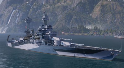

Daytona675R
Posts: 295
Joined: Tue Dec 08, 2015 10:37 am
Location: Prague, Czech Republic
Re: Calling all Pre-war "Big 5" (TN/CO class) fans
Post by Daytona675R »
Forgive me this little silly question...but the '41 Wee Vee in the MEAS 32/7D... do you like or dislike?
I actually consider building it in this what-if look. I know it's my model but still want to know the opinions of other peers.

Daytona675R
Posts: 295
Just not to get it wrong and avoid any confusion - the renderings are not mine, they are results of the Wargaming's art department, she is presented in World of Warships as such.
- David
Posts: 9091
Post by Dan K »
That is very cool, and unique!
taskforce48
Posts: 1616
Location: The beautiful PNW
Post by taskforce48 »
Build a 41' and paint it like 44', build a 44' and paint it in MS1. Love it!
Posts: 8593
Hey - it's your model. Build it however you want to. That being said, she looks cool in that fit with that camo.
Daytona675R
Posts: 295
OK, thank you all. I really like her in that camo, will make both the Measure 1 and this.
- David

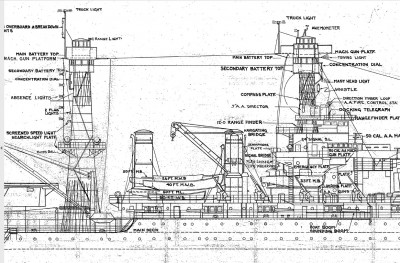

Post by Dan K »

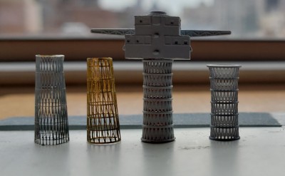

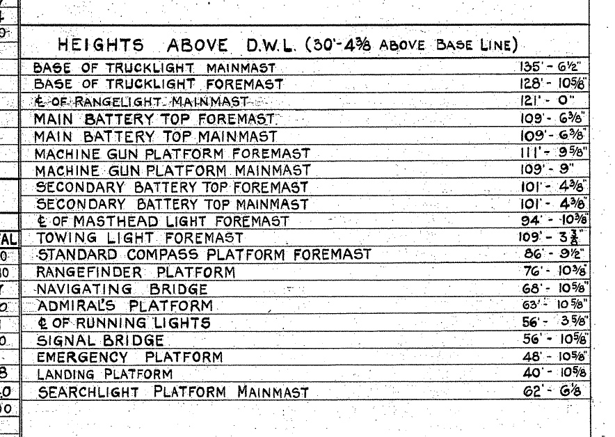

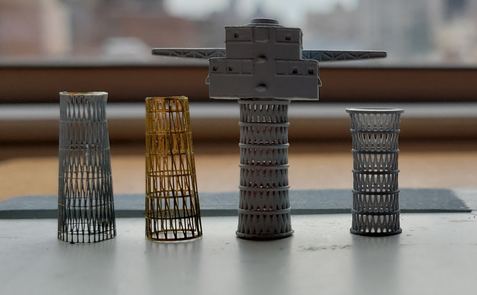

Does anyone have the actual measurements for the cage foremast itself? Looking at the general plans for West Virginia, and using the heights above DWL, I come up with approximately 32+ feet. Do I have that right?
If so, it would seem that kit PE and all the aftermarket alternatives are slightly short.
Posts: 9091
Post by Dan K »

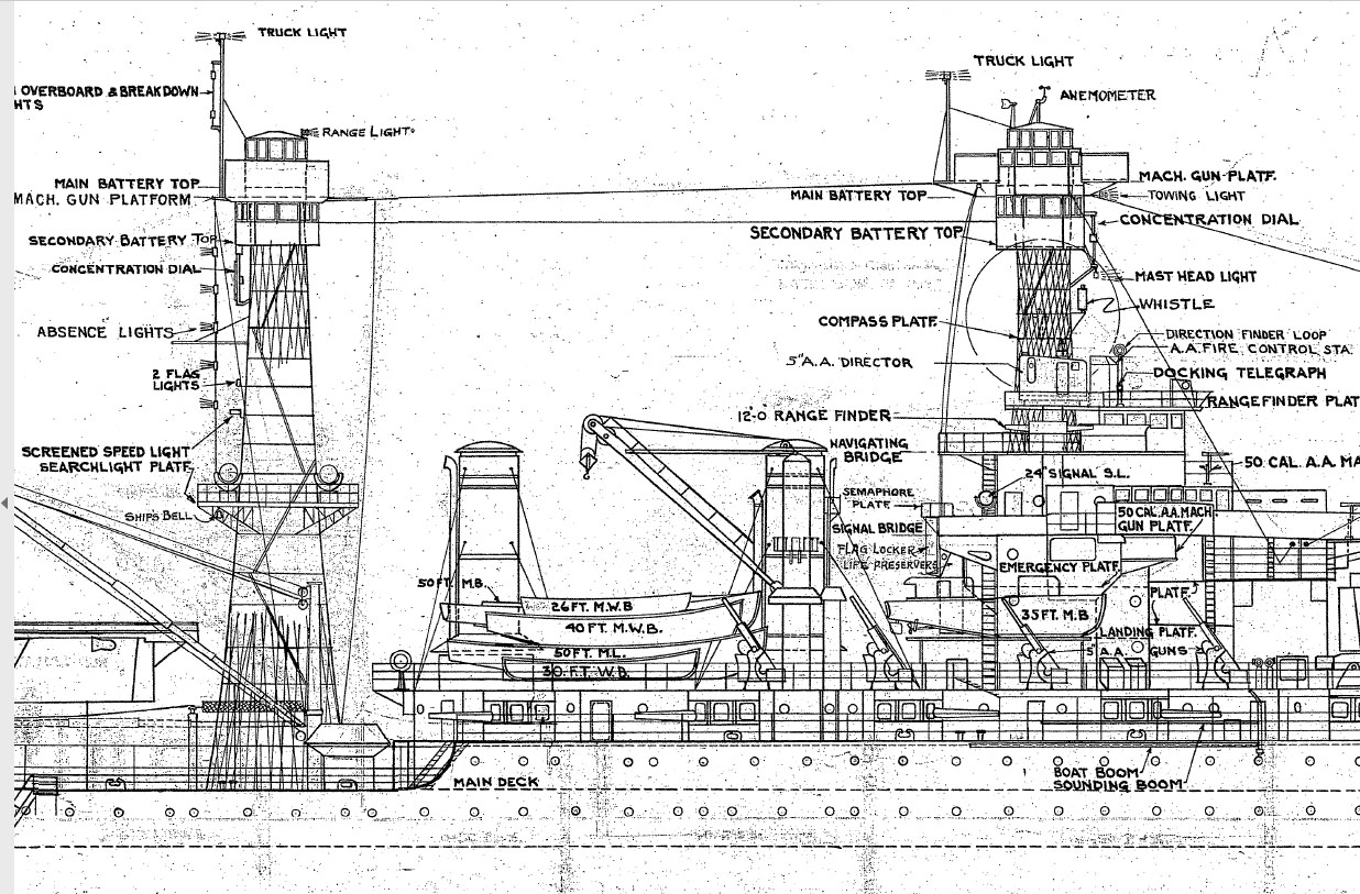

Great illustration and thank you for posting it, David. By any chance, would you happen to have the foremast as well?
I agree that both mast tops seem to be of the same height, and the West Virginia BoGP that you linked indicates the same. However, the dimensions to the top of the mast that I read/take from those same BoGP appear to be different, at 101+', assuming I am reading them correctly. The plan seems indicate this height is the deck of the secondary battery top, which also the top of the cage mast itself.
Do I have that right and, if so, maybe this discrepancy between sources is the reason the parts are off?

This helps illustrate the dilemma, though not earth shaking by any means. I might have the Blue Ridge version upside down. Not easy to tell with that piece.
Posts: 8593
Dan K wrote:I might have the Blue Ridge version upside down
I think you may.
Doesn't the cage mast actually continue up INTO the spotting tops? The real spotting top - unlike the kit parts - doesn't actually SIT on top of the top ring. I wonder if that adds to the confusion.
