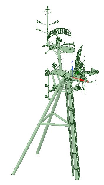

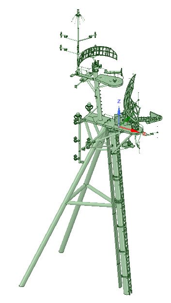

OK, so here is a design picture of the complete forward tripod mast and components, although I've got to compare my 1968 BoGP and a few photos I have from the same time period to make sure I haven't left something off -
Willie, I hope this is what you were expecting; at the present time it's all I can provide :huh:
The entire unit is 3D designed/printed - that's my story and I'm stickin' to it!!! :faint:

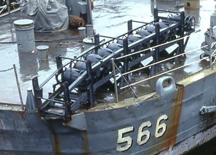

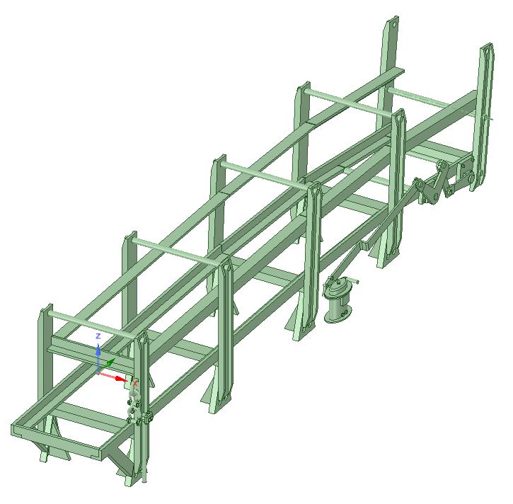

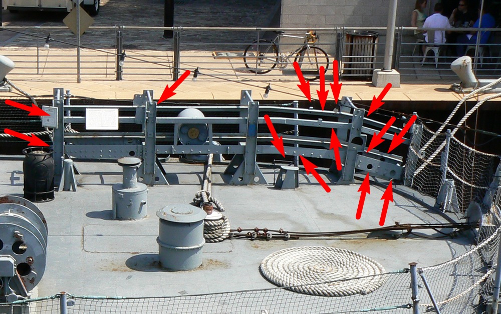

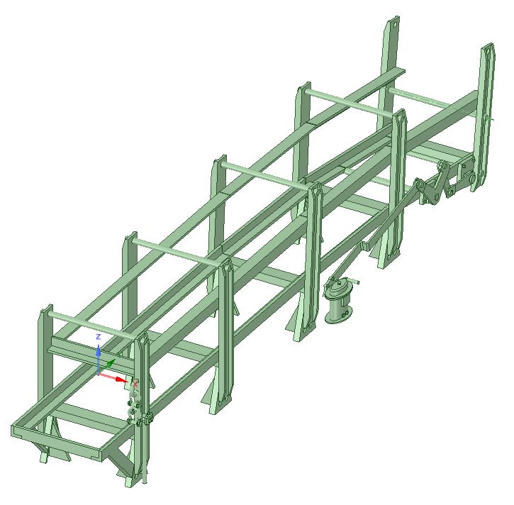

Thanks, Tom!!! Yes, these small details are still coming to light as I pore over a few photos I had taken back then. With your design/printing of the DMS depth charges/racks I've found that this will be a small mini-project for me as well - I thought the purchased 3D parts for the depth charge rack would suffice but after closer inspection I realized that this part is incorrect - too many frames although the size is correct. In addition, the kit supplied DC rack is incorrect for this era (1960s) so those parts won't be used.

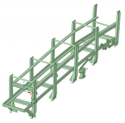

So, with your DMS rack as a start, I began working on creating a rack that resembles the one on STODDARD. Luckily, I have a couple photos of this rack, although none showing the inside view of the rack which includes the release mechanism - so, I'm sort of relying on the Mk. 9 rack illustrations from a U.S. Naval manual and photos from THE SULLIVANS of her rack. At this point I have this unit almost ready to print -

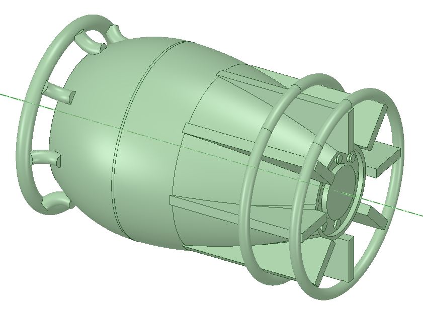

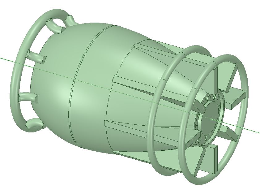

There is a depth charge in the rack, I have it turned off as my first print will be the rack empty, and a second version with the rack loaded. Here's a picture of the Mk. 9 depth charge as modified from your version -
I have to add the end of rack overhang supports to the last frame feet and then add & position the depth charges; maybe get done sometime today/tonight.
Note: There are a few items that I added that are unique to the rack on STODDARD that may or may not have been on other ships racks. These items are based on my own photos of the rack, so I know they existed.

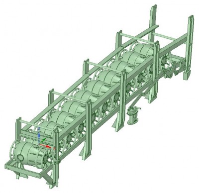

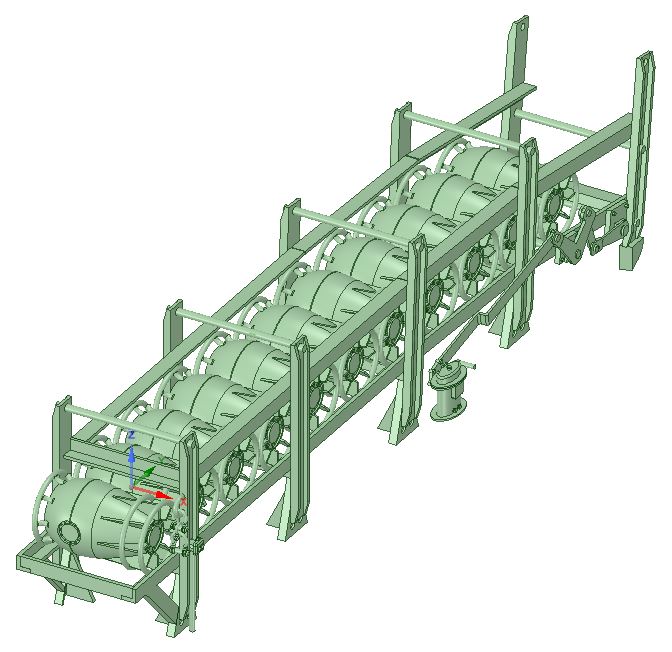

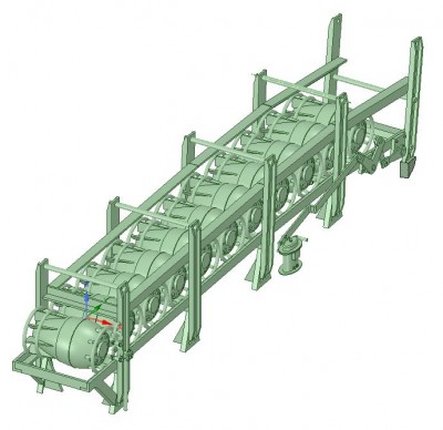

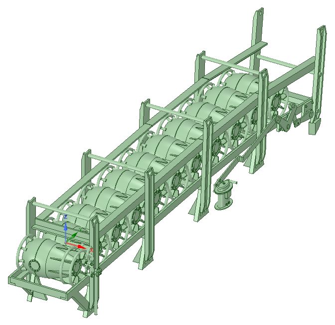

And here the DC rack is completed with 11 Mk. 9 Depth Charges -
I will attempt a print of both versions (empty/full) along with a few other items and see what happens!

Hank:
I think the depth charges need to be turned around such that the setting mechanism is facing inboard? Stoddard's single rack was located on the starboard side? For the DMS I designed the Port track and mirrored it in Chitubox for the starboard unit. Anyway check the orientation if you have Stoddard photos with the track loaded. I had to reverse all the charges on my K gun rack!

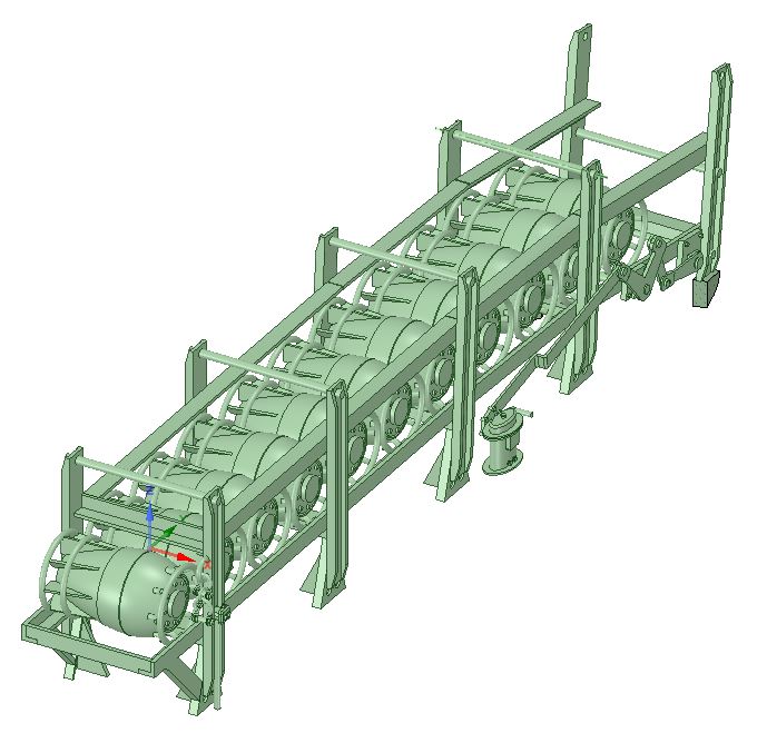

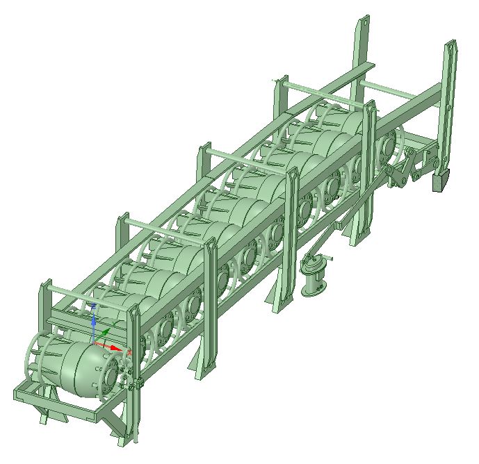

Wah Hail!!! You are right!!! I had left the one DC from your original design in place and forgot to check that - good catch. Well, I'll use the 1st print as a test to see whether it prints, etc. - I really appreciate it - must have a case of the DA's today!!
12:40pm - OK, this wasn't as difficult as I imagined! Here is the correct orientation of the depth charges in the rack:
Later this afternoon I'll get a new print file set up after I see how the first test examples came out.

Hank:
The good news is that most of the DC's are separate items. In my K gun rack, they had merged with the frame and I had to go in and cut them out and replace.

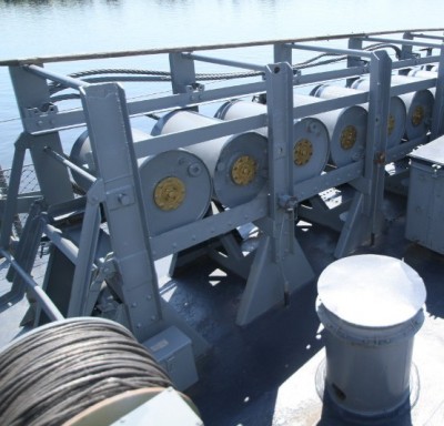

For anyone interested in the subtleties of the MK 9 series DC's https://maritime.org/doc/depthcharge9/index.htm
On the museum ships the photos show the pistols as being painted sort of a yellow-brassish color. Whether this was done in WWII practice, I have no idea. Interesting that the pistols came separately from the depth charges, the pistols sealed in a tin can with an opening sort of like a bully beef can, grab the tab with pliers and pull the soldered seam apart. Tin can sailors eh?

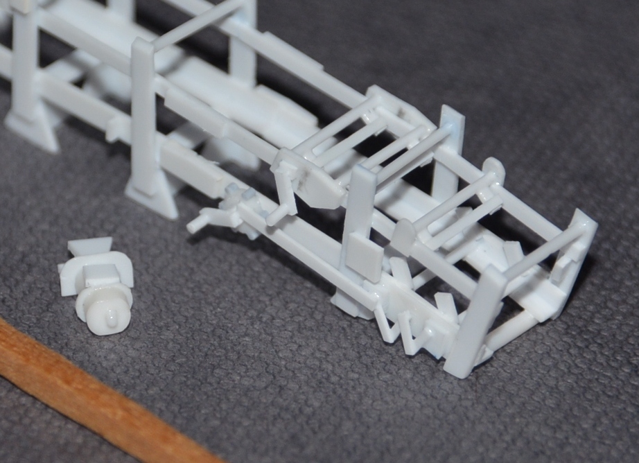

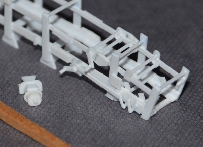

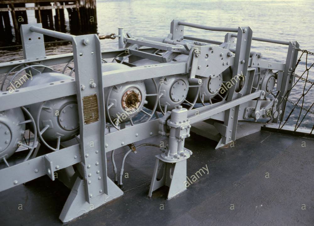

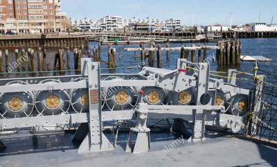

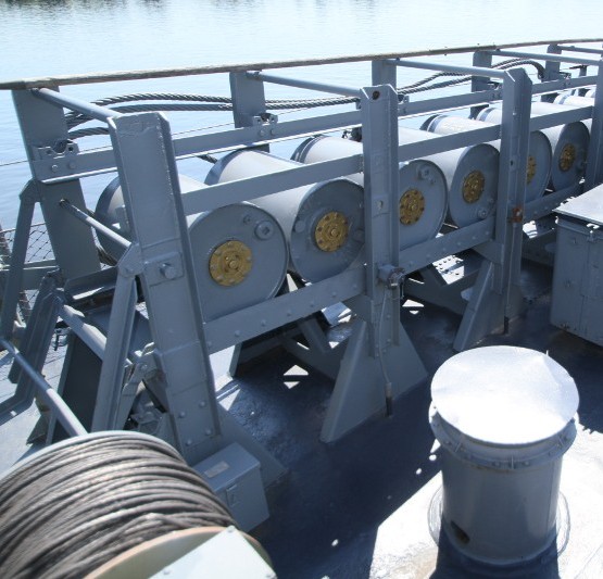

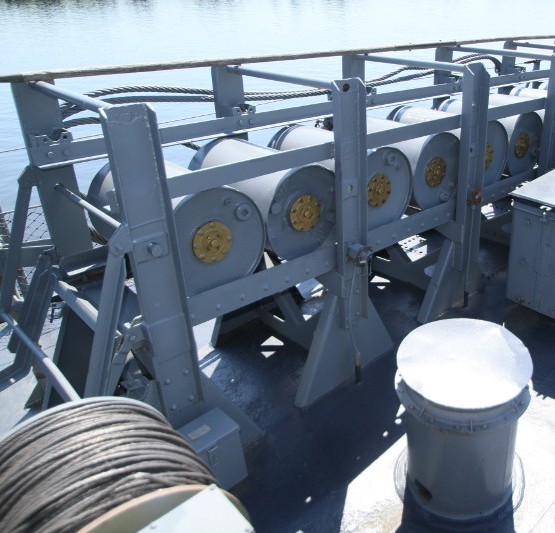

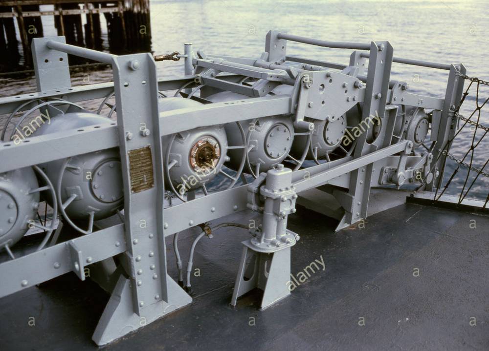

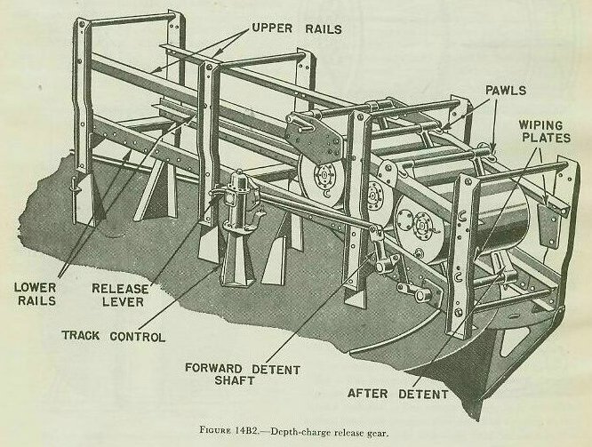

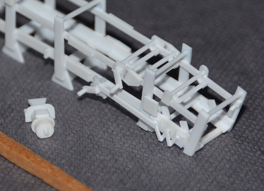

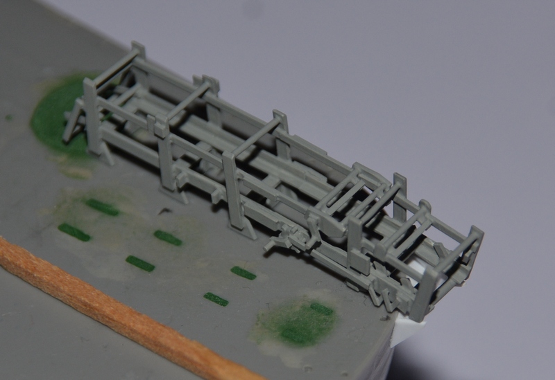

Howdy Hank and all,

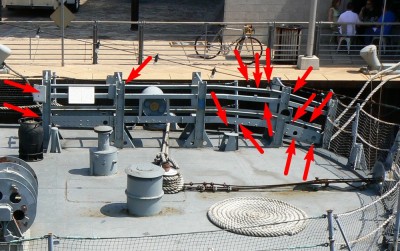

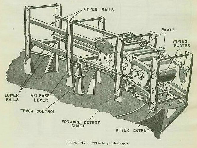

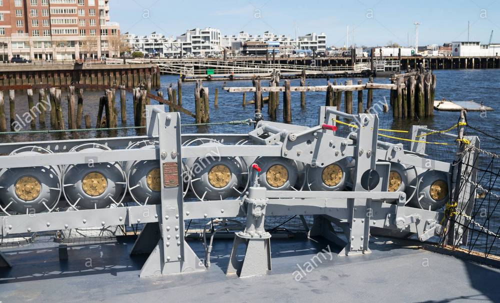

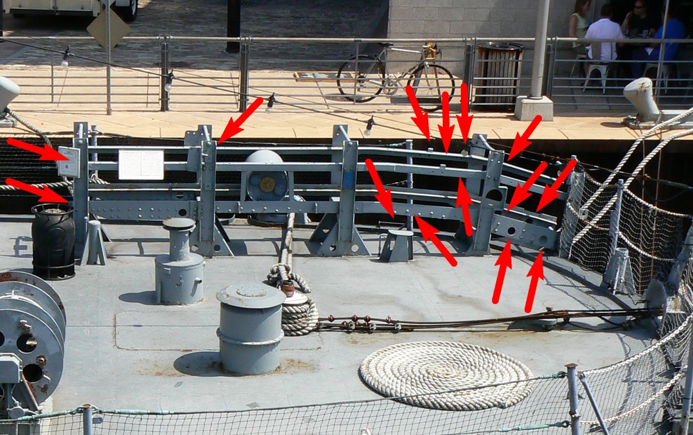

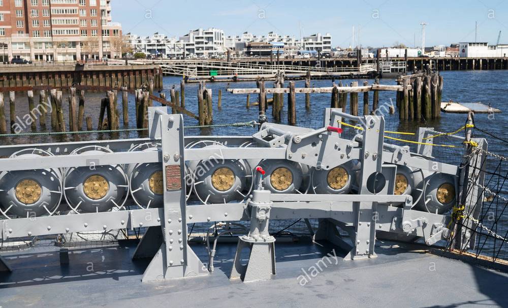

The inner parts of the relase mechanism were not easy to find, but somehow I managed to gather some pictures that were useful for my own construction.
Here you are :
This graphic is also excellent :

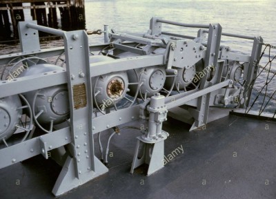

The DC track of USS The Sullivans was on very little help for me; as you can see, it was stripped of virtually everything but the bare structure:

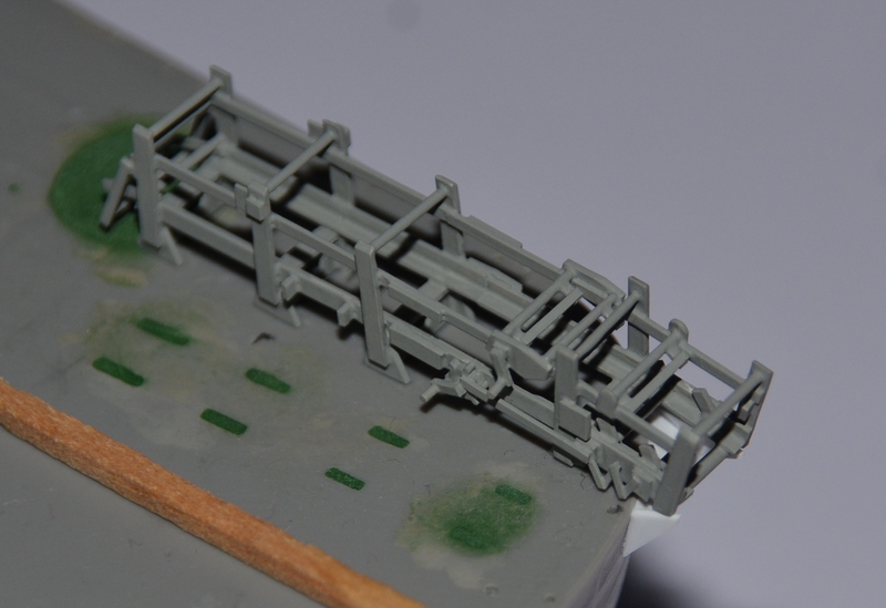

With all this, this is what I was able to produce. It could be useful as an orientation, although I am positive you will produce something way better:
These are old pictures. Since then the track has been repainted and completely dry-brushed, so the small stuff has now more depth.
I hope this can be of some help, and that you dont have to redo the whole track. Oh, the redo's...

Thanks for the input & photos!!! At this stage, I've got things pretty well in hand now. Just finished revising a bit in thicknesses, etc. and also got the "ash cans" in the correct orientation so ready to print.
Your first photo shows the old WWII vintage depth charges, which are way out of date for our use; the other photos are obviously newer showing the Mk. 9 DCs. Your model pix are really good for reference - thanks!
Once again, I've noted in researching these weapons that the FLETCHERs did not all retain the same rack - differences abound and I've patterned mine after the photos I took while on board STODDARD (66-68). As time went on, I think the shipyards minimized the racks as this type of weapons system was not exactly front & center of attention when it came to maintenance & upgrades; just my personal opinion on this!

Something I noticed, many of the DC's on the museum ships have the pistols (and hopefully the explosive as well) removed and a blanking plate installed. The Pistols have a dial depth setting lever usually turned with a special T wrench. Willie! Nice job on the pawls!

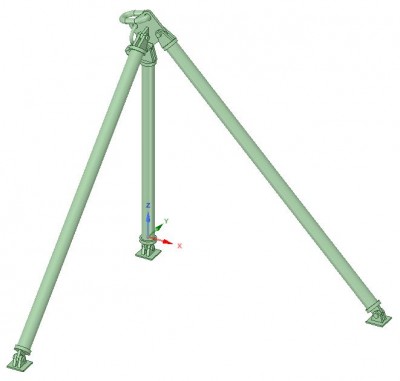

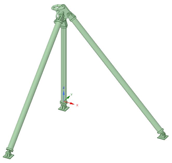

All our DCs were black w/o any variations of painted parts. I've just printed 3 of my 3rd edition DC racks with DCs loaded - these are beefed up framework and ary currently drying. About to go out to cure. I've also designed a Replenishment @ Sea Tripod for the top of Mount 52 -
I've since revised and have the 2nd edition ready to print tonight. The first versions did not sit on a raft and consequently didn't print well. This version is on a raft and damn well better print well!!! :Mad_6: :Tirade:

Was the tripod left "triped" or was it stowed when not win use?

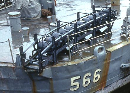

Normally, the R.A.S. tripod was stowed elsewhere and assembled on the mount top when needed. The IOWA class tripods were stowed in place on the turret top, but lowered flat and secured. As for the DC rack - here's a picture of STODDARD's rack in 1967 -
I will paint the DCs black and the rack itself with the Mr. Color gray/black flat lacquer. In this photo the deck is pretty well faded and appears much lighter than would be if it had fresh paint. This photo is also taken in the rain and that makes these items look lighter than they actually were.
