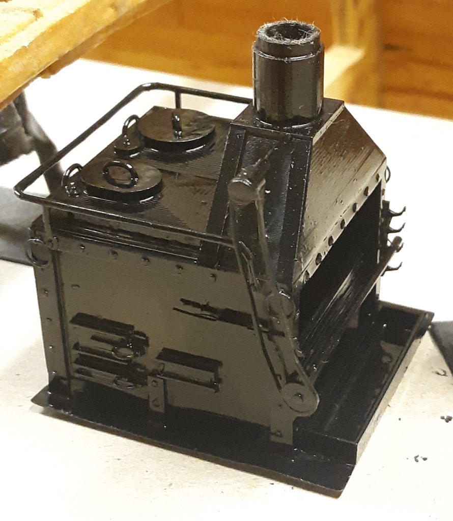

A stove for Macedonian
1:36 scale Brodie stove for a 38 gun ship
Stove with a coat of paint

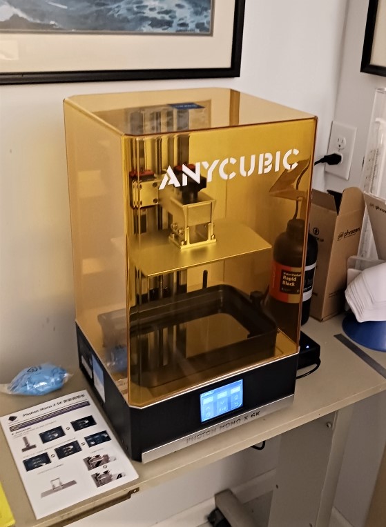

Well, I've discovered that buying cheap is not always buying "Smart". To wit - I thought that I'd save some money by using "cheapo" no-name paper towels from Wally World rather than the rather expensive brand of towel (Bounty). Turns out that this was a BIG mistake - the cheapos don't absorb anything nearly as well as the expensive brand and as a result, there is no savings in cost, but a large expense in the usage to clean up the same amount of printer parts that is required after each print run.
Normally, I always clean the build platform completely and then the area around the printer that may have had resin spill on it while removing the build platform & parts from the printer. Of course, if you're detanking the vat that will also require quite a few paper towels, so the entire effort can get somewhat "towelly"!! I still have two rolls of the cheap stuff, so will suffer thru that and then go back to buying a bundle of Bounty as those towels really work the best.
Hope this resonates with others doing 3D printing and gives some practical guidence.
