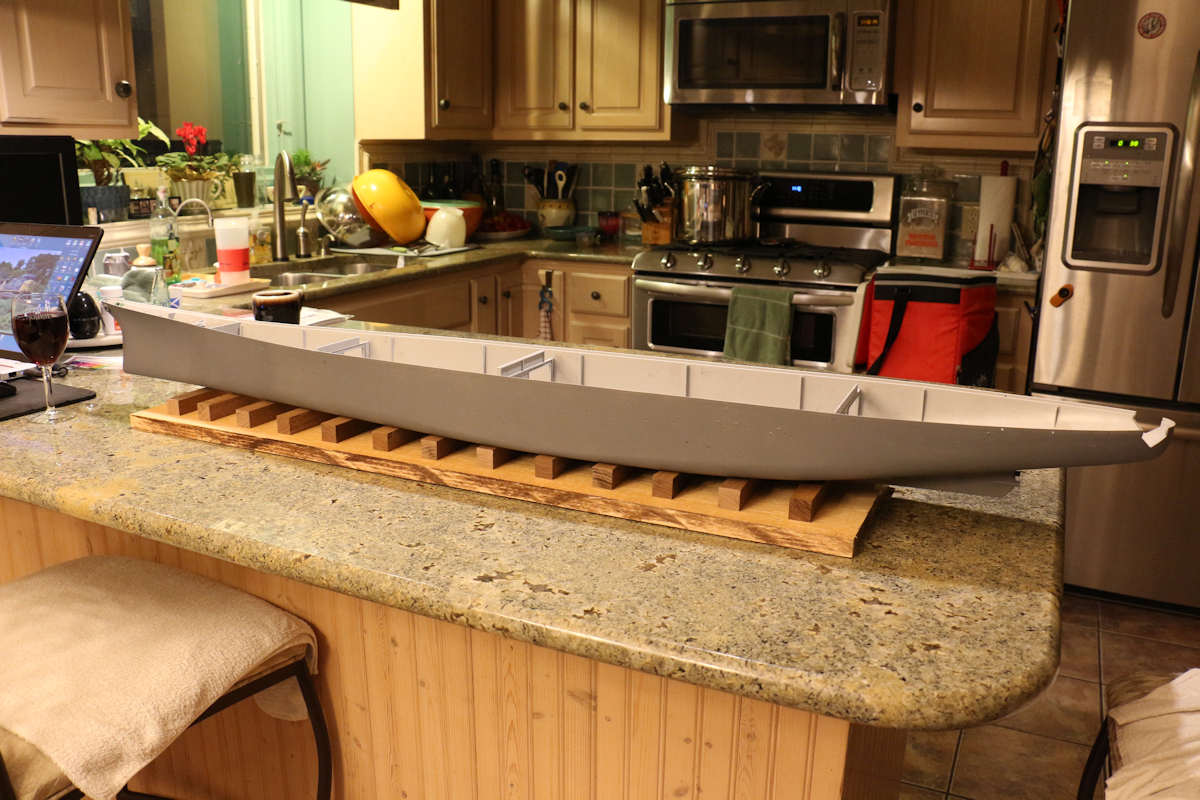

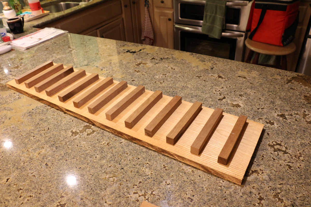

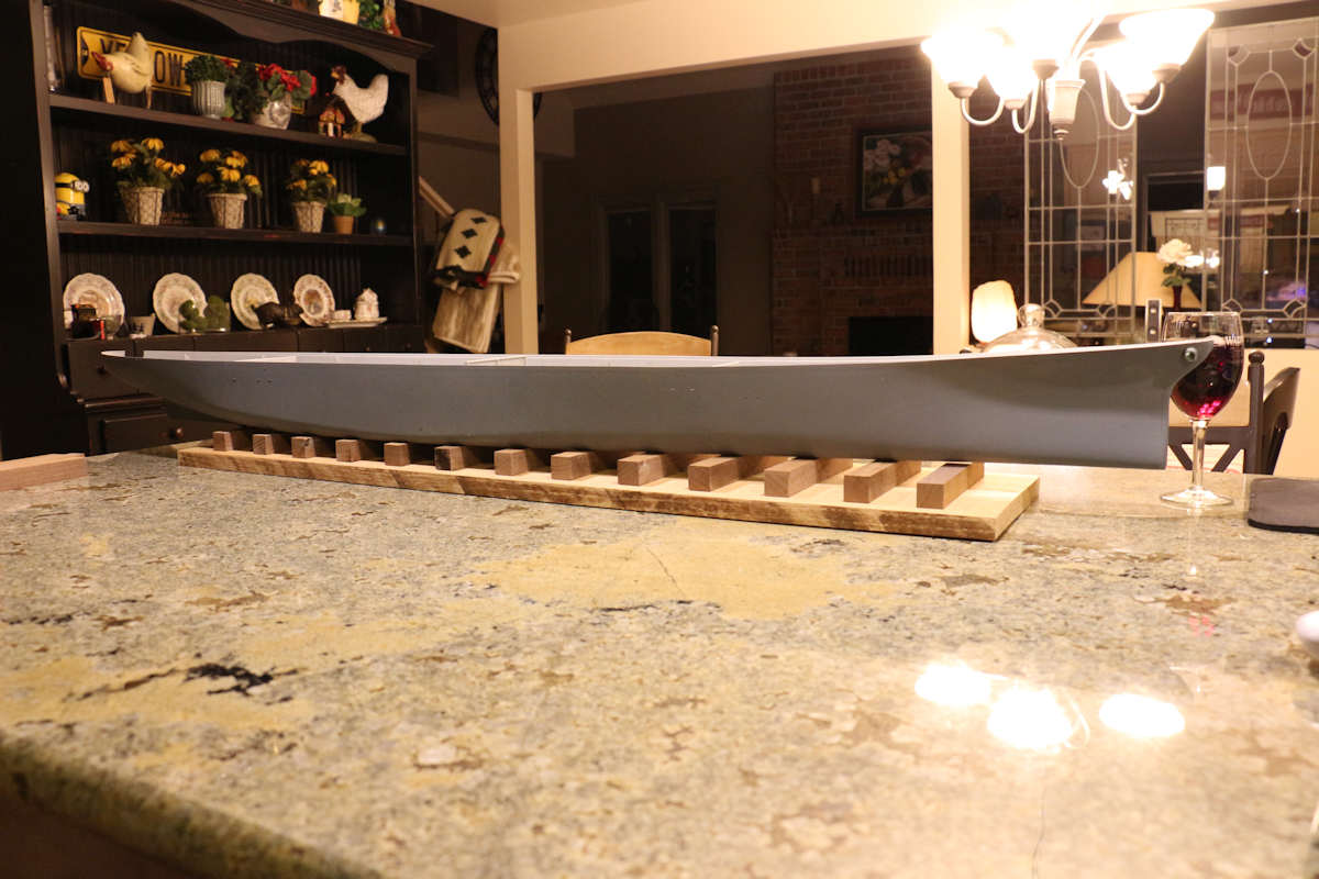

I'll take your advice and bolt her down. Only, Bob, I'm not going to use pedestals. Bear in mind that I just cut the pieces of wood out today and they are not routed, sanded, stained or anything - this is just the raw wood. Here is what my stand will look like:
The base is oak, 8-1/2" wide by 36" long by 7/8" thick. The ways are made of black walnut, 7/8" square by 7" long. I haven't decided how many I want yet - somewhere between 2 - 2.5 inches apart?? I'll have it on a felt base on the bottom and will locate 2 or 3 bras rods up through the ways and secure the ship with flat washers, and locknuts. I was just going to set the ship on the ways, but you guys talked me into bolting her down. What do you think? Think it will look OK?
Larry Steiner

Thanks Bob, but in looking at these pictures, I realized that the ways are too big. I'm going to cut them down to 3/4" square and possibly even 5/8. They are way too big for even this hull. Going to get the router out today and make some more sawdust.
Larry Steiner

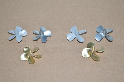

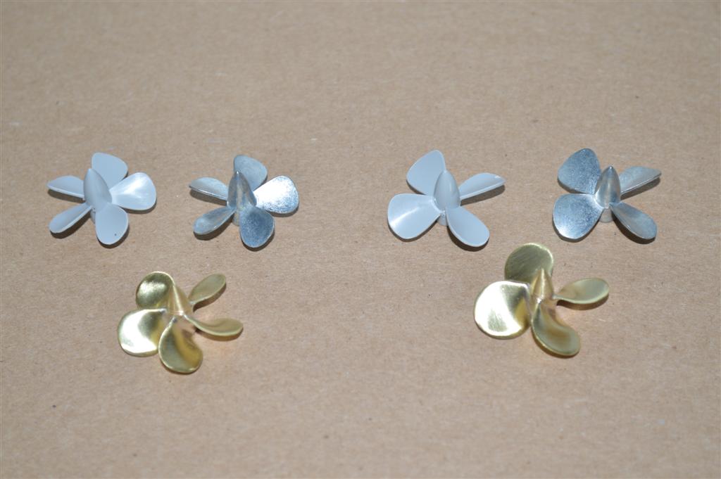

Larry wrote:
The Advanced Detail Set by Pontos that I've ordered has replacement brass screws.
Well, I don't know what Pontos offers in their advanced set, but here is a comparison of the Trumpeter kit plastic props vs Trumpeter metal props vs the brass ones I bought from Keith Bender:
There is another 3rd party prop maker out there (G Force??) - but, Keith's props are as close to the originals as I've seen yet. They can be purchased in either high polish or satin finish. Expensive, Yes! But, IMHO, well worth it.
