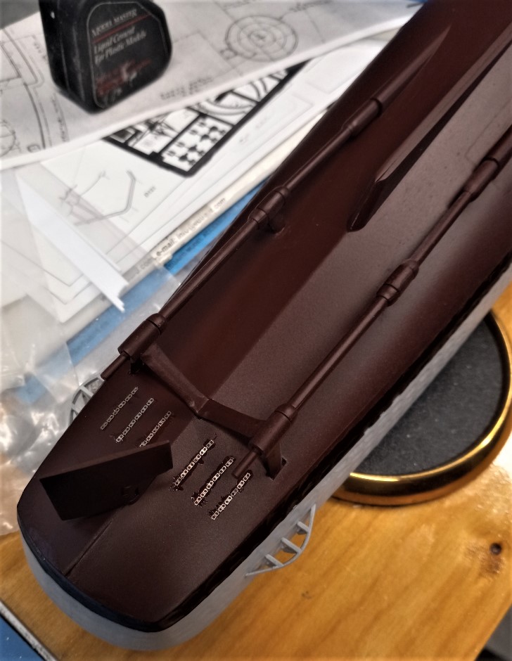

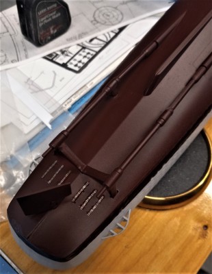

Got a bit of hull work done tonight - installed the corrosion coupons underneath adjacent to the screw shaft supports. These differ from Willie's JORGE JUAN in that there are only 3 rows per side and all in one line (per my photos of the ship in drydock in 1967): Once they've been given a touch-up of lt. gray paint and the bottom of the hull oversprayed with clear flat lacquer, the small amt. of glue seepage along the edges will disappear. I'm expecting an order of gloss clear spray lacquer and then I'll be able to prepare the hull for decals. Once that's done I can then call the bottom complete and move on to getting the display board completed as far as the keel blocks are concerned.

Excellent update. Once painted, a hull looks completely different. I have compared your paintwork with the picture of USS Stoddard in dry dock, and your choice of color matches the pic perfectly. It is a way darker color than the one I will be using in my own hull, that is much more red than brown, but the satin finish you have achieved is the tone I have always seen in ships in (or freshly out of) dry dock.

Thanks, I appreciate your comments!! Actually, the color in the photo is quite a bit darker than the ship was painted after they finished the shaft work - but it was a quick overnight spray paint over just about everything on the hull (barnacles, dirt, sand, etc.) - that red was almost "bright" red and simply didn't look correct to me. Usually, the yard sandblasts the hull over a 1�3-day period (depending on size of ship) and then primes and sprays the final red paint as a last step. This was not done at the drydock period in which I referenced. It was also not done when we sustained battle damage in March 1967 and had an emergency yard visit in Sasebo, JN where my last photo of the depth charge rack was taken. That was also a quick & dirty paint job. It doesn't take long for a ship's hull to show the effects of sea water, salt air, and all the other climatic elements to ruin a new paint job!! Harbors are notorious for being nasty, dirty places where anything and everything floats around and can get caked on the ship's sides/bottom.
With new gloss clear lacquer spray in hand, I should be able to get some decal prep done on the hull.

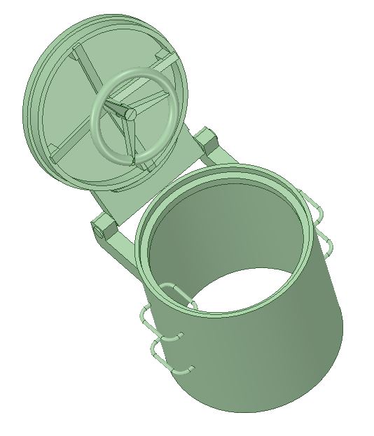

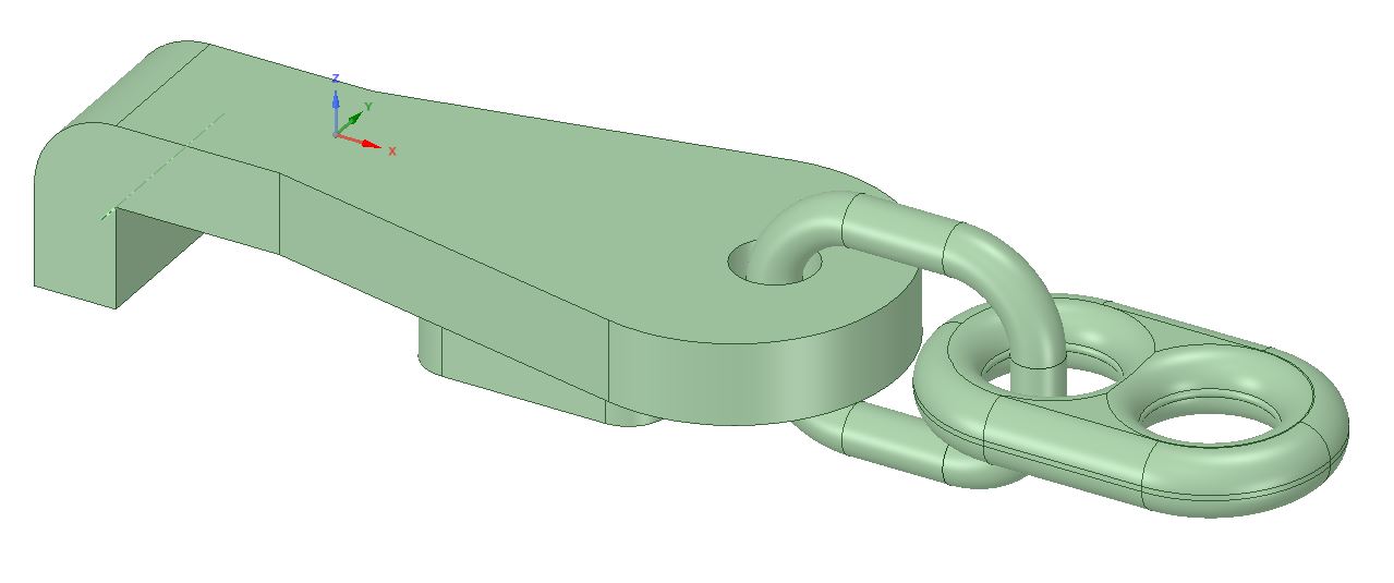

Today I've cranked up the printer once again to produce some odds/ends of small items that I had overlooked or had previously printed in a different resin and wanted to get a higher degree of detail using the Rapid Black resin. Last night I did get the hull spot sprayed with clear gloss lacquer in prep for adding the various decals. Last night I designed the foc'sle tow pads and a windless handwheel which I had somehow overlooked -
In addition, I redid the stern escape scuttle somewhat and have that printing, as well -

Re: 1/144 Scale USS STODDARD (DD-566) - Kitbash, Revell FLET
Someday the printing will be good enough for the hatch hinge and wheel to work!
- BB62vet
- Posts: 3145
- Location: Mocksville, NC

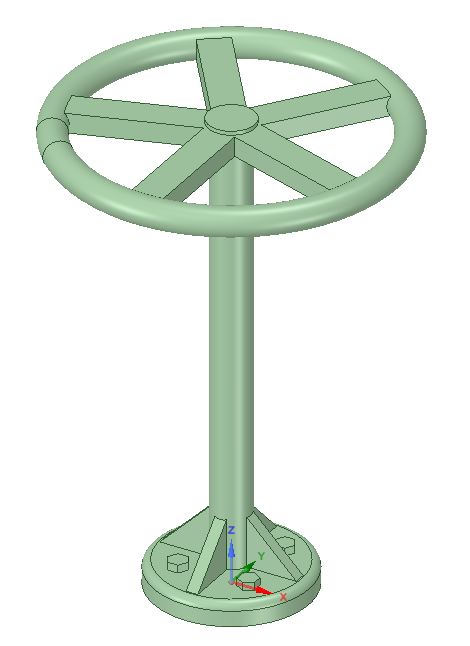

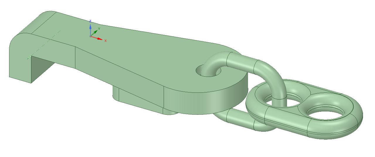

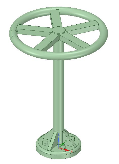

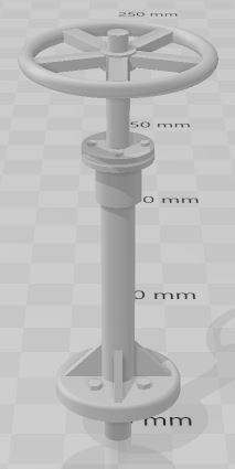

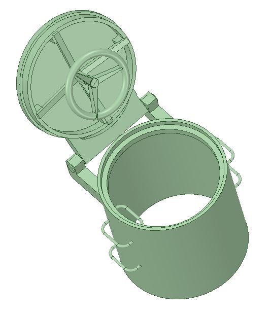

Yes, the technology never ceases to advance - quite possible that these parts (in 1/144) will perhaps "work" some day!

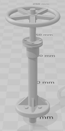

While researching a couple other items I discovered in a foc'sle photo I had taken, I came across DD-687 that showed the windless control handwheel completely and I've redone that part and have a new print file ready for the morning. Also, reprinted a smaller deck escape scuttle as the ones I printed were a bit too large. So, this in addition to the discovery in the photo of a central steel plate (I call it a tow wire chaffing plate) that extends up from the base of the capstan to the deck edge at the prow - I will fashion this piece out of 1/64" thk. styrene sheet plastic and it will be sprayed "dirty steel" as it wasn't painted and there was rust or discoloration obvious in the photo. This chaffing plate is NOT common to the FLETCHERs as a class and I've only found it on one other ship - DD-687, although it may have been present on some other ships that I haven't verified.
Here's my new handwheel control - I've printed probably a dozen of these in various sizes prior to this version - no problem as it's all a learning experience....
- Posts: 5068
Nice part Hank!
Isn't it amazing that at this point you are still finding changes to make? Something that has always surprised me a great deal. The most accurate ship model will be the one that is never finished.

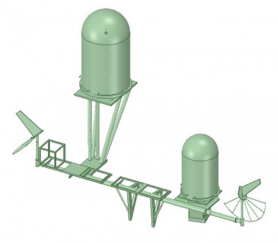

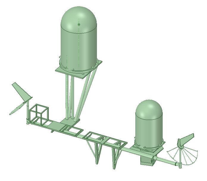

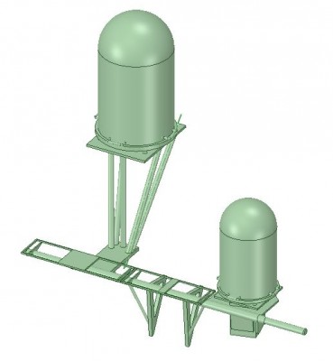

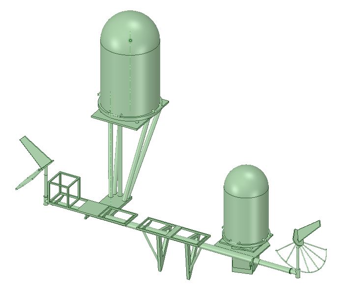

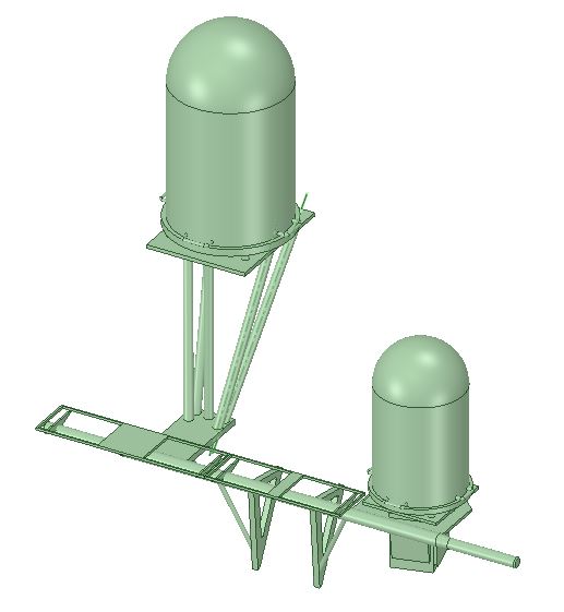

The last few evenings I've been working on designing the after stack yardarms - without any dimensioned drawings in plan view to go by, it's a total guesstimate as to how long these arms actually are. So, I "emailed a friend"
to see what his take on this situation could be. In the meantime, I've done a fairly complete composite of the fwd. yardarm with its associated RADOMEs and other components -
I'll probably use some leftover PE from another kit for the diamond plate that is the deck plating on those various platform frames as I seriously doubt that printing those at 1/144 scale will give anything more than a blob. For the picture, I turned off those plates which I have drawn up. I've gotten a bit further with the design, but this pic gives a good idea as to what's involved. The small instruments/electronics components are already printed and will only need to be added once this yardarm affair has been printed (much like I did the tripod main mast).
I've also been slowly working on adding various deck components to the foc'sle and hope to get started on the hull decals soon as I've already prepped the hull sides/stern with gloss clear lacquer.
Thanks - she was...received the People's Choice Award (will update the posting about the show in the Main Forum soon)!!
- Posts: 5068
Hank:
That's a fairly involved unit, I hope that you are able to get sufficient strength in the spindly supports. It might help to hollow the domes to keep the weight down. Using your Rapid Black resin, possibly you could thicken the support a fair bit as they will probably shrink down considerably. A typical on the edge construction that will take some experimentation.
Glad that NJ got a well deserved award, you certainly went to the mat, especially with regards to the needed hull modifications!

Thanks Tom and yes! it is fairly complicated. I got the information I needed from another modeler (our own Willie in Spain!!) and now have the yardarm lengths corrected - I do trust his ability to eyeball & determine relatively good info when it comes to modeling - also, he's been aboard THE SULLIVANS so he knows what these components look like, etc.Fliger747 wrote:Hank:
Before creating a print file, I will check the RADOMEs and see how I constructed them. I may need to copy and revise & replace as needed.
Yes, all experimentation at this point!

My pleasure if I have been of some help. As long as we have good plans or good pictures, the process is fairly easy. I simply measure the element in relationship to the overall length of the ship if it is a big thing (masts, for example, or big structures) or to some other structure, increasing the size of the picture in my screen, if it is a smaller thing. Then, using calculator, I find the measures for my 1/144 scale, or any other scale, of course. I repeat the process twice or three times using different pictures, to double check, and that's it. Very easy, as I say.BB62vet wrote: I got the information I needed from another modeler (our own Willie in Spain!!) and now have the yardarm lengths corrected - I do trust his ability to eyeball & determine relatively good info when it comes to modeling - also, he's been aboard THE SULLIVANS so he knows what these components look like, etc.
Nice going in NC, and very best regards from this side,
Willie.

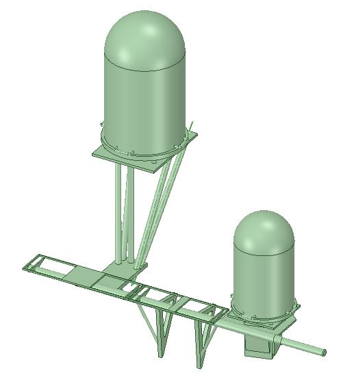

Once again, thanks for your assistance!! I am currently printing the 2nd edition of my Aft Stack Fwd. Yardarm & components - the 1st edition printed but with some very fragile elements so I took that as a need to beef up some areas and also added the NT 66132 antennas on either end - I've also printed the TED mast which mounts on the front of the after stack on centerline - This printed out well the first time including the elec. cable that I've shown - I was surprised at that!!
So, things are moving along in a straight, albeit slow, line forward!

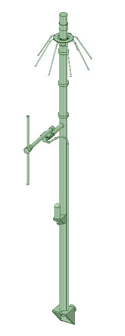

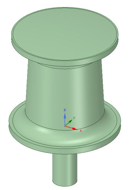

Thanks, Tom!! Yes, these small items are what make the model "sparkle", so to speak. I've just finished with the 2nd edition of the TED mast & antennas -
Maybe get this printed later in the afternoon as the printer is busy right now with the 2nd edition of the yardarm affair & RADOMEs, etc.
I did print most of these items prior but have made a few minor adjustments before reprinting now in R.B. resin.

As for the after stack yardarm, etc. - I've printed 6 editions, and none have come out completely correct, so I've copied the platform framework to a separate file and will print it as a separate part (hopefully!) - and use #4 of the printed yardarms for the rest of the assembly as that particular item has all the components except for the platform framework.
