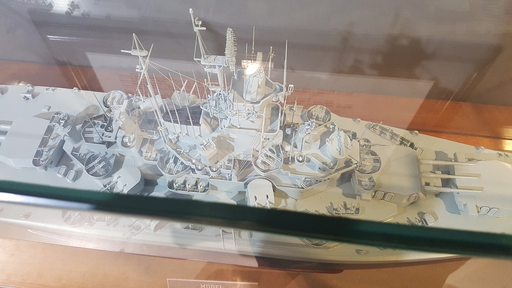

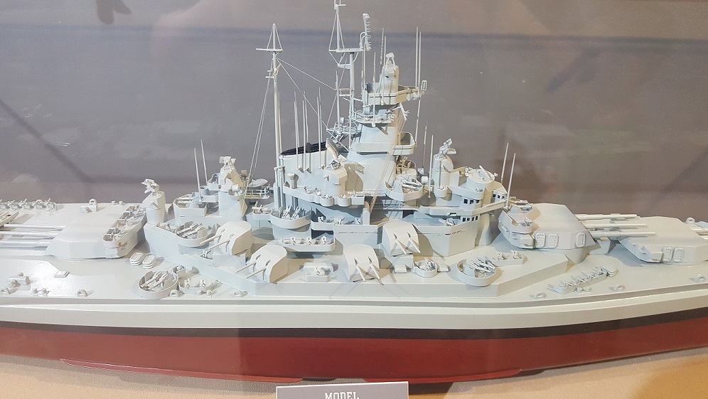

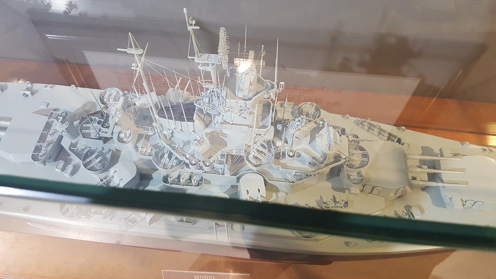

Here are some photos that I took when I visited the Battleship Memorial of the South Dakota when I visited back in June. Looks like its a platform of optics. Don't know how I missed it either and I have been using these images as references. But also the navy model is inaccurate as it has turret B and C swapped...
Edit: I have more if needed. Also have images of the large display demonstration model for how the ship was to look when commissioned if needed as well.

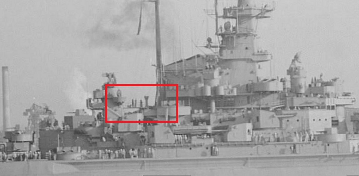

Trumpeter seems to have goofed on another detail. Does anyone have any blueprints of USS South Dakota that shows the "supports" for the 40mm in the picture I added? When I say trumpeter goofed on this, they basically made that 40mm overhang unsupported and the flagship quarters that are supposed to be there, are not.
That is an interesting photo, as it shows the SoDak with the older style Mainmast, rather than the newer that was right next to the Stack.

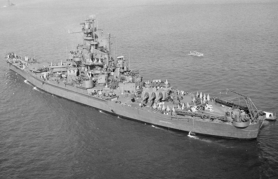

this is the original photo. pulled it from Navsource and its dated February 1943

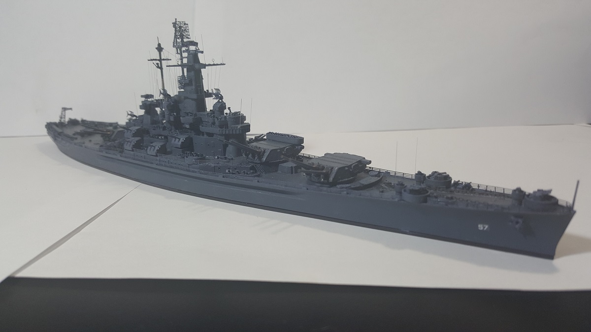

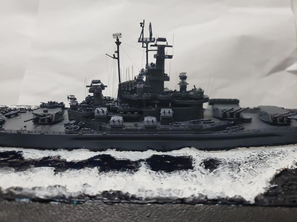

Correct, the kit is actually of the South Dakota in her final layout in 1945. I predated mine to just before that but after Savo Island. I pulled this from my review of the kit. Nothing catastrophic, but some big errors that can be fixed with scratch work.
So for accuracy on the overall model: there are actually several insistence that scratchbuilding and modification was needed to be accurate to the true South Dakota.
1. It is missing the forward 20mm location behind the 40mm Bofors at the bow of the model.
2. The kit is completely missing the yardarms so had to scratch build them.
3. The area around the officer quarters (where the missing 5" would be located) actually is not accurate in the sense that the 40mm 'overhang' is to low and should be a level higher.
5. A wall should be just behind the 20mm which was the officer quarters rather then it being empty space.
6. Missing platform extending out from the director structure towards the aft mast.
7. Spot light overhang is to high and needs to be lowered slightly.
8. 40mm director platform on the aft main battery director structure is to large and needs to be shortened

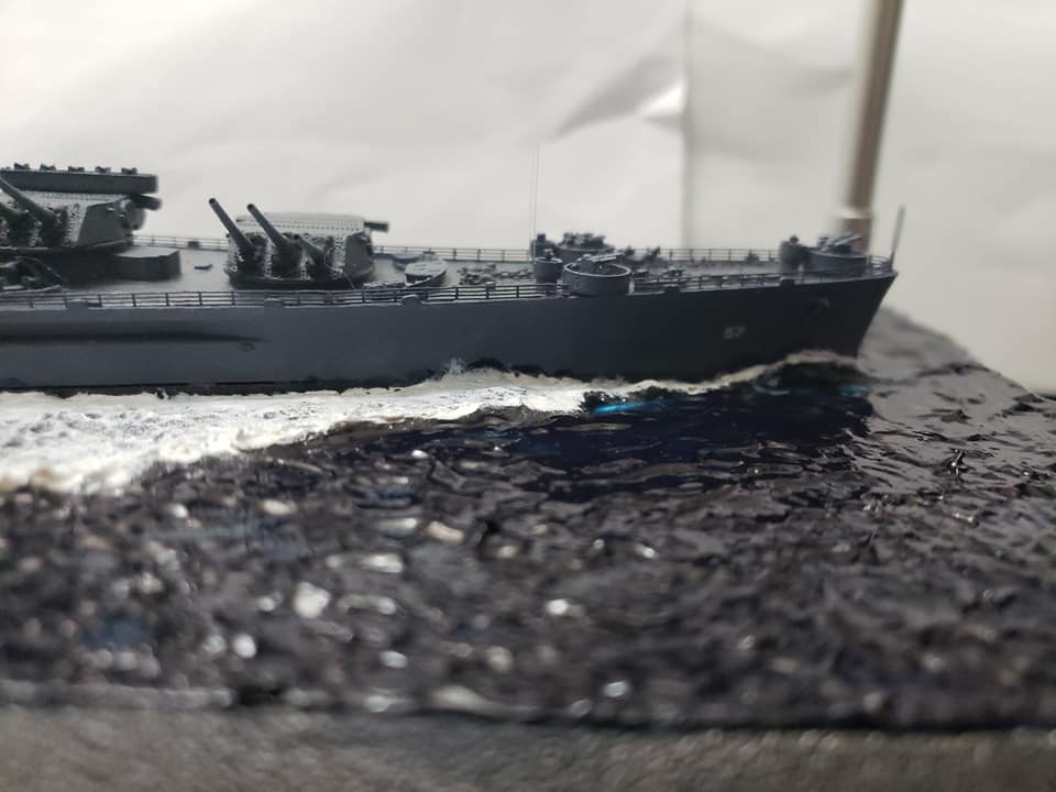

Some images of the completed build
Complete:

The Trumpeter 1/700 South Dakota kit is strange. I dont know what exact date the kit represent but I guess mid 1944 and onwards.
Did USS South Dakota had 4 (like the Trumpeter kit is depicted)or 6 40mm directors in late 1944 around the funnels near the MK 37 directors. ? In some close up pictures of early and mid 1945 it has 6 tubs instead of 4 like the Trumpeter kit(3 on each side) with 40mm directors, did she receive an upgrade sometime late 1944 early 1945 ? Thanks in advance.
Betelguese90: Great build !

Atma wrote:The Trumpeter 1/700 South Dakota kit is strange. I dont know what exact date the kit represent but I guess mid 1944 and onwards.
The Trumpeter kit is supposed to represent the South Dakota in her last refit in 1945. She had a refit in August 1943. than another in August 1944 following the damage she received at Guam in July 1944 than her final refit in late 1945. But to answer your question, it's an inaccuracy with the model. There were 3 on either side just below the MK 37 directors.
