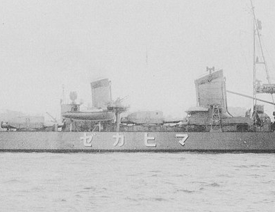

That depends on the timeframe you wish to model. The Kagero kit is early war fit, and, with some mods, can be used to model various fits up through sometime in 1943. After that, it would be best to switch to a Yukikaze kit, which is a very late war version.
If you want to use the hiragana writing on the sides, then you need the early war Kagero kit.
And, to be more specific, mid to late 1941 is the window of time in which these ships carried both a degaussing cable and the hiragana writing. Going further, Nowaki's degaussing cable pattern was the same as Yukikaze's (and that of the Kagero kit, since both kits use the exact same hull tooling.) Arashi's pattern is undocumented, AFAIK.
HTH.
HTH.

Re: Calling all IJN Kagero class fans!
I was looking at the time of Midway 1942, when both were escorts of Nagumo's task force.Dan K wrote:That depends on the timeframe you wish to model. The Kagero kit is early war fit, and, with some mods, can be used to model various fits up through sometime in 1943. After that, it would be best to switch to a Yukikaze kit, which is a very late war version.
HTH.
- Posts: 9042
Then use the Kagero kits, with no hiragana writing. No other mods are necessary.

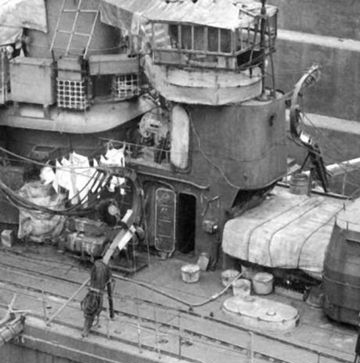

Do any of you have an idea about what the protrusions on both sides of the searchlight tower in the 1/350 Tamiya and Hasegawa kits are (I've circled them in red)? From the drydock photos of Shiranui there obviously isn't anything on the port side, and there doesn't appear to be anything on the starboard side either from the photo of Maikaze. Also the photo of Shiranui shows that the rear of the searchlight tower was quite rounded compared to both of the kits which depict it as square with rounded corners. I can't find any photos of Kagero from that angle, so I'm not sure if different ships had differing searchlight towers or this is simply a mistake by the kit manufacturers.
- Posts: 9042
They appear to be air intakes, similar to what actually appeared on the bridge superstructure and aft deckhouse. While I see hints of them in some plans, I haven't found a photo to verify them. They could have been a late war tweak, but I'm not sure of that. There is one postwar photo of Yukikaze where something MAY be visible; too blurry to say what it is, and the angle of view poor. The perspective is too oblique.
Thanks Dan, that would certainly explain it seeing as there appears to be little other ventilation on the tower apart from a single porthole in the rear. I guess I'll sand them off my early war Kagero as I can't find any early war photos of the class that display them. I'd agree with you on them being a late-war addition, there appear to be hints of a shadow in that area on some long distance shots of the ROCS Tan Yang.

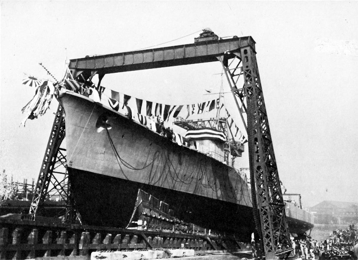

On another note, do you happen to have any information on the hull plating pattern, especially on the areas under the waterline? I've seen some launch photos of the class which give me an approximate idea of the side plating, but so far have found absolutely nothing regarding the keel. Any details in this area would be greatly appreciated.
- Posts: 9042
Sadly, there aren't any photos that I'm aware of that show the keel and surrounding plating clearly. This is true across all the DD classes. Most everything is too dark, distant, or indistinct.
That Shiranui photo in drydock is probably the best view of a keel, but the plating is obscured by the amount of hull fouling. The photos of Nowaki in drydock, or Isokaze launching, clearly shows alternating bands of plating, but only up forward and above the keel.
It doesn't really ever improve over this Natsushio photo.
Though I sort of expected this will be the case, it is indeed unfortunate as the Kagero and Yugumo classes were such important workhorses for the IJN. I can probably make an educated guess on parts of the keel plating by figuring out the locations of the hull framing from the side plates. I think I've also seen some hull section drawings somewhere, those can probably add a little bit of realism to my guesswork if I can find them again.

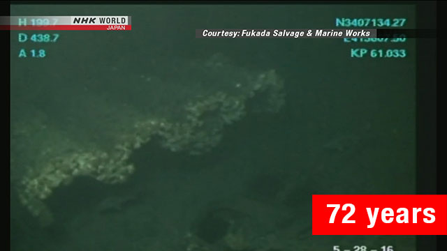

Apparently, the wreck of Isokaze was found back in May, 2016, but just announced last week:
https://www3.nhk.or.jp/nhkworld/en/news/20180208_09/
