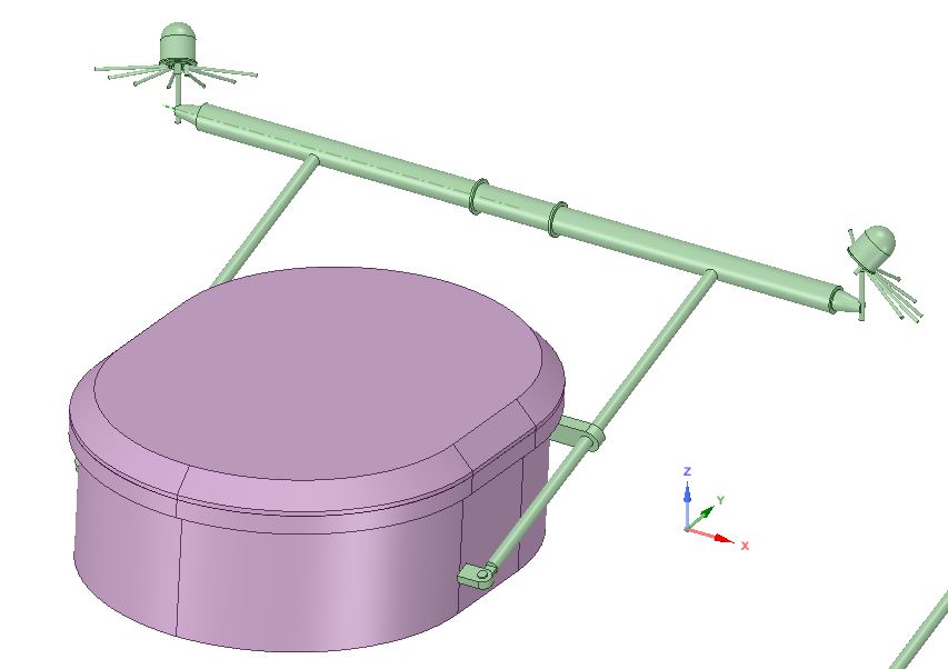

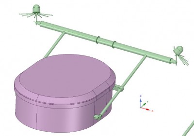

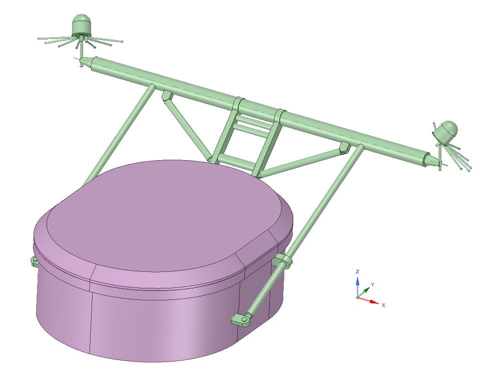

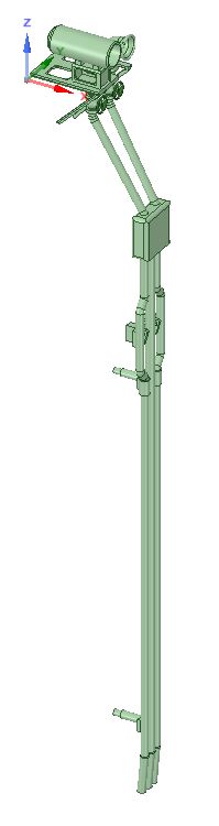

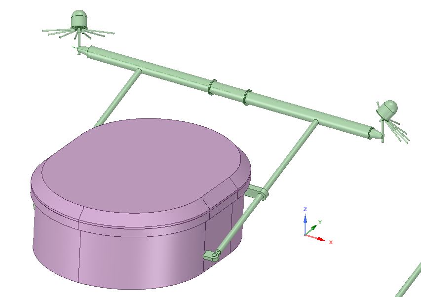

So, today/tonight I've been working on designing the after stack AFT yardarm, antennae, and supports. Here's a progress shot -
The object in purple is a rendition of the after stack & bottom of stack cap from the kit parts for sizing, etc. I've actually gotten a bit further but haven't made an update photo as yet. I had already created/printed the two NT66131 antennas separately, but decided to go ahead and add them to the yardarm and print everything together since I had good luck doing the same on the forward yardarm. Can't argue with success, right! :thumbs_up_1:
The printer is currently in the maintenance shop for minor overhaul (sort of like pier-side availability in the real NAV!!! :heh: ). I hope to have it up & running in a day or so. Of course, this is as long as The Admiral & her Cat are not out cruising to give me a bruising :bash_2:

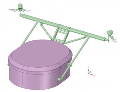

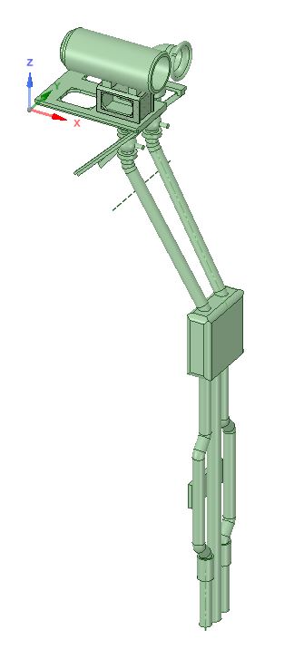

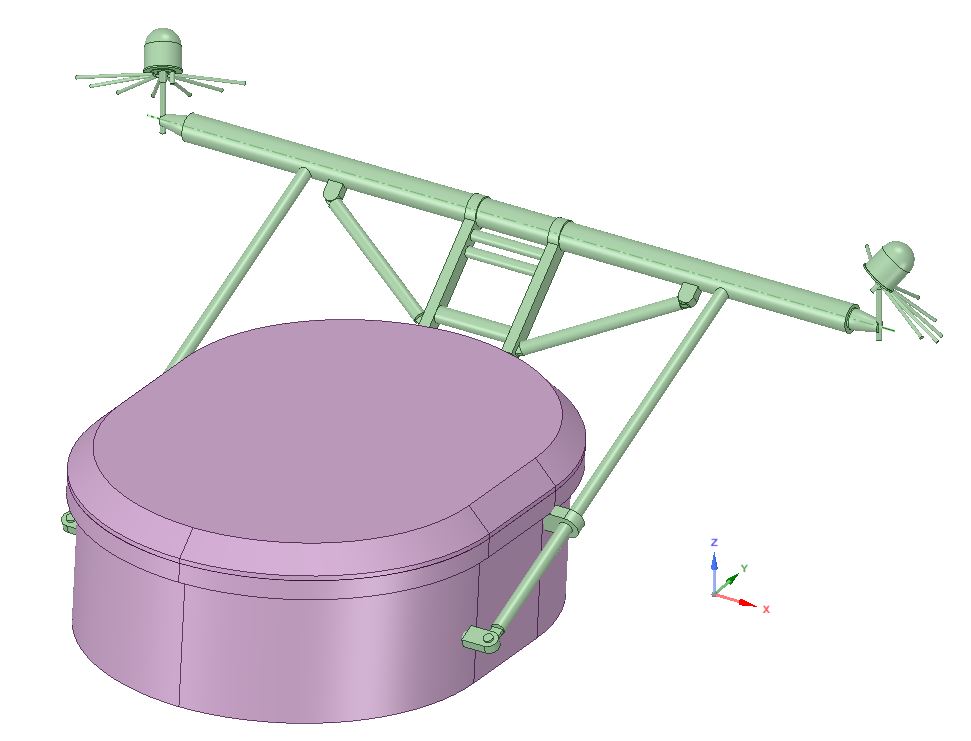

OK, so here is the final version (at this point, that is!) -
The purple objects will not be printed (obviously :doh_1: )
See what happens in the next day or so - printer is still in maintenance mode.

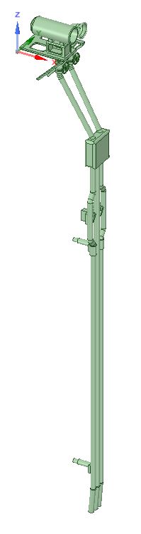

Currently working on designing the Steam Whistles & piping for the Forward Stack -
This is incomplete but shows the basic unit - to modify the kit supplied part to the 1960s version would probably end up with several broken pieces and I, like Willie, prefer to make my own and include a few things the kit parts don't. Whether these all print out is another thing, but I'm adding the steam valves and so forth so we'll know soon enough whether they print or come out as a blob :huh:
I may get this finished in time to add it to the print file with the after stack aft yardarm, etc.

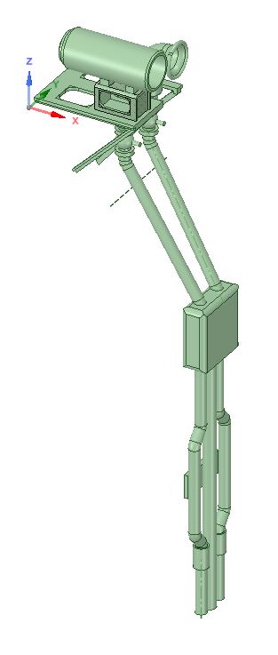

I've finished the design for the Steam Whistle & piping -
It's been added to the Chitu print file along with (3) of the Aft Stack After Yardarm Assemblies and perhaps I'll get the printer back online this weekend and see what happens. always an experiment at this stage of the game!

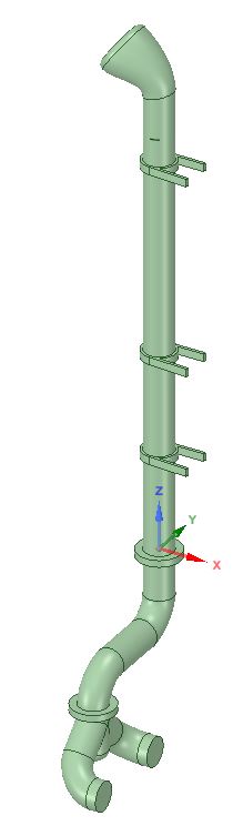

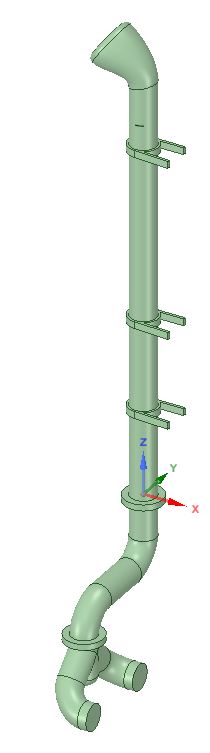

While looking for one of the sprues to the kit for only one part, I realized that I've either lost or misplaced it. However, after reviewing a couple of photos that I and Ens. Shutte took of STODDARD in 1968 that showed the after stack from the back, that the kit part would not be correct, so it wasn't all that much of a problem. So, tonight I designed the corrected vent pipe that has an offset that wasn't there in the '40s. So, one more part to be printed; don't know if it will fit on the file I've got ready with two other parts aforementioned -
Of course, I have no doubts about it printing, but it may need some tweaking on the angled legs at the bottom. This was a pretty easy part to design, unlike a lot of them that are real bears.

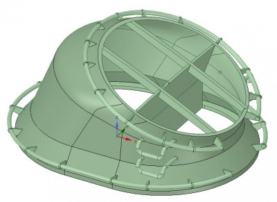

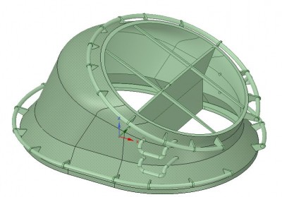

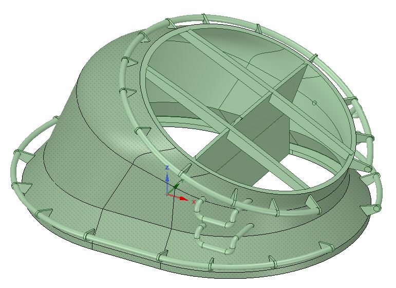

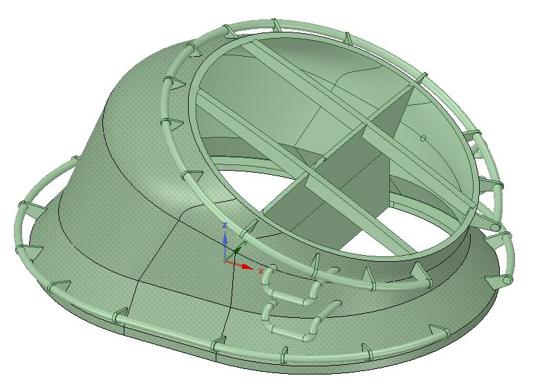

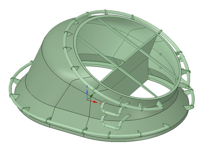

While contemplating the further construction of the stacks, it occurred to me that using the Edward PE sets that I have for additonal detailing would involve "iffy" at best locating and cementing of miniscule parts to the kit stack cap - and I decided to go ahead and design/print them myself including the hand grabs and rings that would need to be added as a one-piece unit. So, here is the effort that is now on the printer -
This will be typical for both stacks so no need to do a 2nd one. If this prints out ok, then I may go ahead and add a couple other additional details that will differentiate the fore & aft caps. Having the actual parts handy to take exact measurements from certainly helps in designing so that the cap fits the top of the stack as neatly as the kit parts fit together. Adjusts can always be made!
BB62vet
Posts: 3174
Location: Mocksville, NC
Re: 1/144 Scale USS STODDARD (DD-566) - Kitbash, Revell FLET
Post by BB62vet »

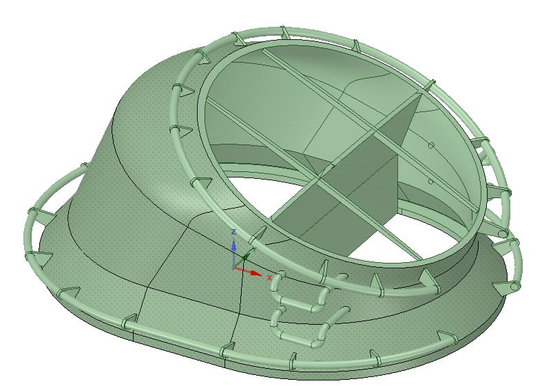

The stack caps printed with only a minor adjustment to be made on the 2 curved frames at the top. I've made the adjustment -
And the new version (2) are now printing. I also beefed up the antenna support rods on the aft stack after yardarm and it is printing, as well.
Should know in a couple hours how these came out. As I've mentioned before, this is a trial & error development project - nothing is guaranteed.

As a note, the rails and hand rungs as seen in Design Spark mechanical look quite hefty, but in the actual printing come out quite fine and airy. Should look good Hank!

Tom,

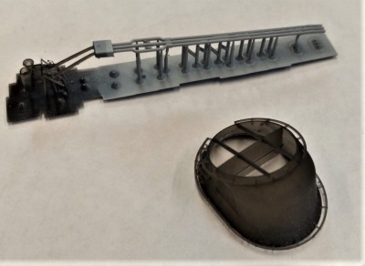

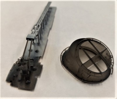

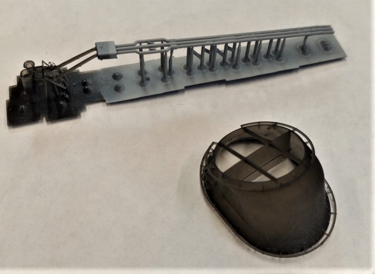

Yes, they come out ok - however, the last print run (2) the lower rings came out "sort of" - so, I've slightly increased the diameter, reoriented at a slight angle from dead flat, and will now print the 4th rendition (2.5 hours).

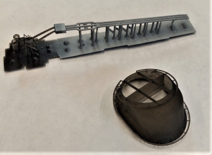

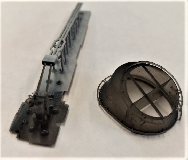

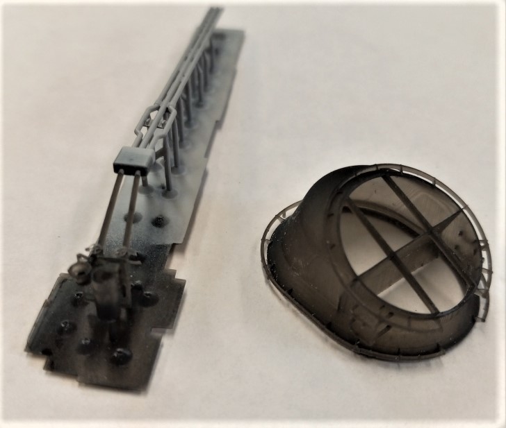

Here's a shot of the existing cap and steam whistle -
I've got six on this next print run, so I should have more than enough - the one I've got may work but doesn't have the front break in the lower hand ring which may be necessary.
