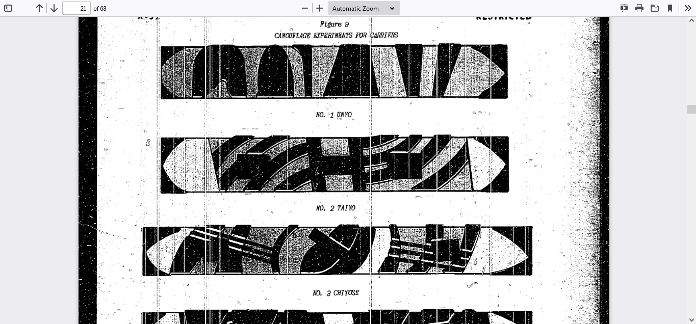

http://www.fischer-tropsch.org/primary_ ... 20X-32.pdf
I'm sorry but I haven't posted much and don't know how to take a page image but this is the url to link to the report. Taiyo is listed in the carrier section of experiments with a really fun swirl pattern. I think I will use it for my build.This report says the painting experiments began in March '44, and Taiyo was in port at that time until May according to Combined Fleet's tabular movement record.

This is the page from the report on experimental camos done in the summer of '44

Ok, that makes it a lot more plausible that she was camouflaged already in august '44.
No way to be absolutely sure without photographic evidence of course, but that camouflage certainly makes for a fun painting exercise and a good looking model.

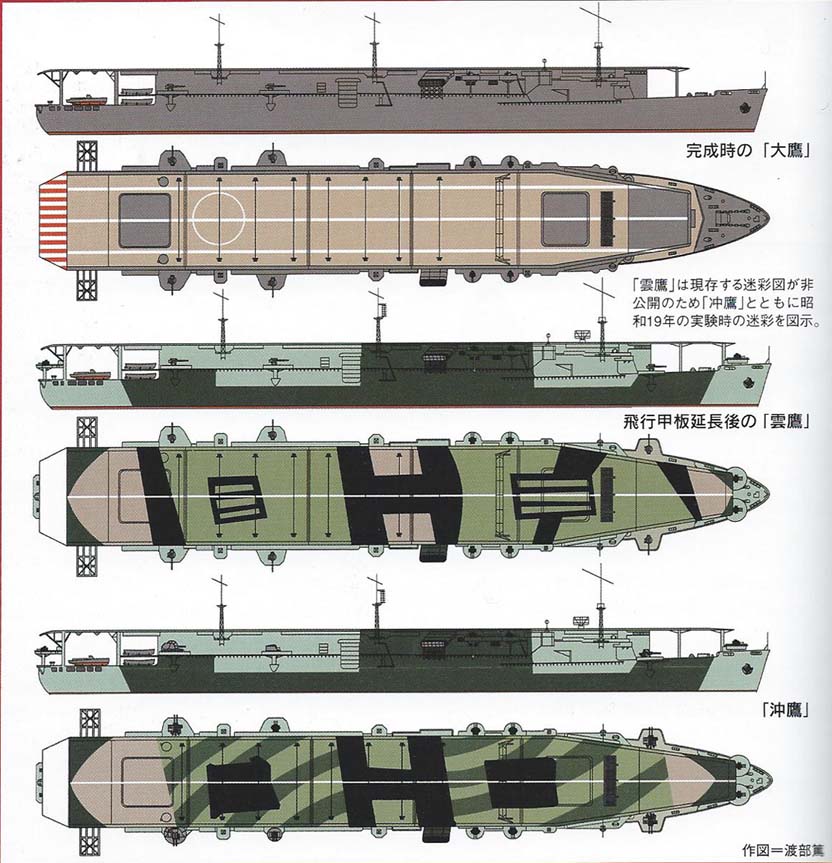

This illustration from Gakken comes up in lots of searches. I think the bottom scheme is mis identified as the Chuyo, since Chuyo sank before this type of camo was instituted, and since the pattern strongly resembles the Taiyo camo in the US intell document, I believe it is the Taiyo. But it causes me some question as to the colors. On the side, the lighter color is something like IJN grey green used on aircraft or the Tamiya color XF 76. The flight deck light and dark greens dont match, and seem to have a more yellowish or olive hue. The end color which appears to be a light tannish grey is probably the color of the linoleum or whatever they put on the deck of these carriers. Any clue what it was? And lastly, as the top illustration seems to accurately portray the Taiyo at some earlier point in its career, I notice the flight deck being shorter than her sisters, so was Taiyo's flight deck lengthened?
- Posts: 9063
Re: Calling all IJN Carrier fans
I don't know what this color is, because there is variation between color plates of not only these sisters, but other carriers. I've always assumed it was wood deck planking left unpainted, or maybe washed some how.The end color which appears to be a light tannish grey is probably the color of the linoleum or whatever they put on the deck of these carriers.
It's a good question. Even the Japanese WIki article on her points out there is contradicting information. Supposedly, the flight deck was lengthened by 10m during the late 1943 refit, but an eyewitness officer states otherwise.And lastly, as the top illustration seems to accurately portray the Taiyo at some earlier point in its career, I notice the flight deck being shorter than her sisters, so was Taiyo's flight deck lengthened?

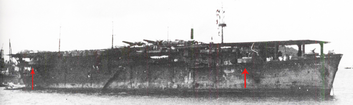

Dan, I am not sure you are both talking about the same points. Yes, Chuyo carried twin 5" mounts, but they did not have the same shields as the ones on Mogami. They did have the enclosed control station on the side of the mount, like the ones on Takao and Atago (and most of the other carriers). The box art for Chuyo appears to show a full Mogami type shield, which is what I think Bayuro is referring to.
I have one other observation. The photo I have seen with Chuyo carrying twin 5" mounts does not have them located where the box art depicts. The after ones match, but the forward ones are on the fore deck, just forward of the hangar structure.

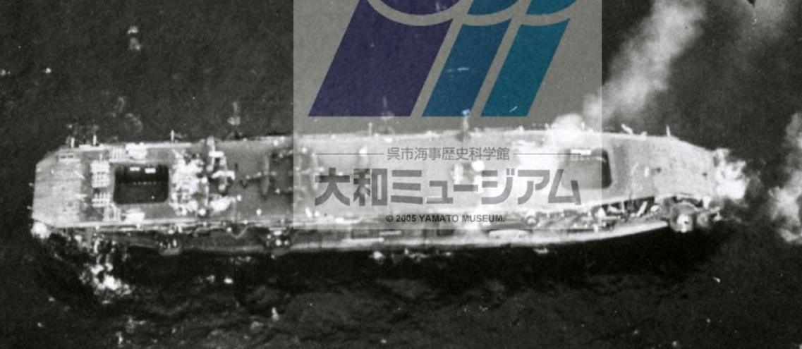

You might be right, Dick. I took it to mean different cruiser classes with the same 12.7cm mount, though, yes, with different shields. Nor did I reference the Chuyo box art until now. The presumption ( which I endorse) is that the semi shielded mount as seen on Takao/Atago, and virtually all the fleet carriers, was the same as installed on Chuyo and Unyo. Truthfully, there's no close-up or photo clear enough to actually verify that. But, it seems highly unlikely these mounts would be more fully shielded as on Mogami/Myoko/Tone.I am not sure you are both talking about the same points.
The photo below has been cited as being either Chuyo or Unyo. For these purposes, it doesn't matter. The larger 12.7cm emplacements do seem to be in the same position as the box art. There is another set of bandstands at the bow that are carrying something. Normally, I would have said 25mm mounts, but these look like single somethings. I know some line art illustration place the other set of 12.7cm mounts up forward, but that's not what these look like. Bit of a mystery, really.The photo I have seen with Chuyo carrying twin 5" mounts does not have them located where the box art depicts. The after ones match, but the forward ones are on the fore deck, just forward of the hangar structure.

Dan, I presume you have Maru Special #38. The photo of Chuyo on the bottom of page 54 shows a sponson forward with a twin 5" and only one apparent large sponson aft. Some sources indicate that Chuyo and Unyo lost their twin 5", replaced by the 6 single 4.7's, to use the twin 5" to upgrade more "frontline" combatants. If you want to contact me off line, I might have a slightly lighter copy of the photo. dick_jensen_44@msn.com
- Posts: 9063
I did find a copy of the this photo and, damn, great eyes, Dick. This positioning of her main battery is definitely not in any of the literature. Just hiding in plain sight.
I went back to research the Chuyo/Unyo photo post above. After reviewing both the Japanese Wikipedia entries, Tony Tully's notes on Chuyo on the Nihon Kaigun site, and the Shizuo Fukui drawing of Unyo's AA armament fit in mid-1944, I am now certain that it is Unyo. Apparently, the English literature on Unyo's armament is also incorrect. Unyo was armed like Taiyo with six 12cm single mounts. Only Chuyo had twin 12.7cm mounts.
