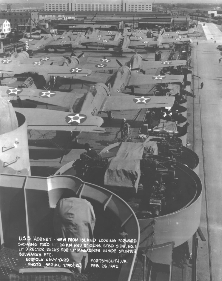

Wildspear -
I have done a bit more looking and found some additional info that may contradict what I said above. Here's a website of interest for starters: http://www.navweaps.com/Weapons/WNUS_5-38_mk12.htm
What it says is that HORNET was not fitted with the identical 5" 38s fitted to her sisters. YKTN and ENT were fitted with Mk 21 Mod 16 5" 38 open mounts, while HORNET received Mk 24 Mod 2 5" 38s. Looking at some line drawings of the two guns (but no front-on drawings), it APPEARS as though the Mk 24s do, in fact, have the front shields I mention. Crap! If you Google Mark 24 Mod 2 5" inch you'll come across a listing for a 'catalogue' type Navy manual showing line drawings of the guns. I also Googled ENTERPRISE 5" gun gallery and came up with a couple of pictures of the bomb damage I described.
Sorry to lead anyone astray. Hope this atones.
Oh, and by the way - where did you get the perforated stock you are using to support the flight deck (the longitudinal beams, not the transverse truss girders) in your earlier picture? Is that l'Arsenal's P/E version? It's White so it looks like plastic. Jes' wundrin'

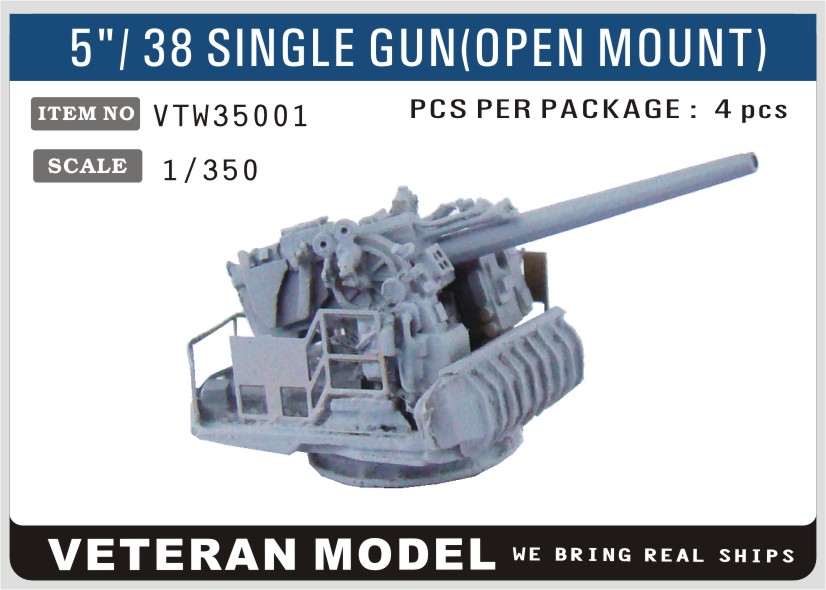

So then the Veteran Models guns would be more accurate for CV-8?John W. wrote:...it says is that HORNET was not fitted with the identical 5" 38s fitted to her sisters. YKTN and ENT were fitted with Mk 21 Mod 16 5" 38 open mounts, while HORNET received Mk 24 Mod 2 5" 38s.

Martin -
Yes, that is my conclusion. You beat me to the punch - here's what I found.
First off, thanks Wildspear for the info and for triggering some thinking.
I had always assumed the CV-8 5"/38 open mounts were the same as the sister ships YORKTOWN and ENTERPRISE. When I found the website indicated above, I realized that my assumption was not correct. The Mk 21 mounts on the first two ships were replaced by the Mk 24 mounts - all were pedestal mounts - on CV-8. Likewise, the early ESSEX class ships also had the Mk 24 mounts. As I looked through the Internet searches I did, I found a line drawing of both the MK 21 and Mk 24 mounts. The latter appeared to have a shield low down on the platform that the Mk 21 lacked. Lo and behold, I found a picture of a 5"/38 mount on HORNET CV-12 on the 'other' site - pictures of CV-12 in Alameda which are pretty recent. A couple of pictures show the mount from various angles from behind. One does show the shield, or at least part of it from behind. Some of the newer 5"/38 open mounts (e.g Mk 30) have a shield with vertical stiffeners which wraps partly around to the sides of the gun platform. The MK 24 shield stops at the corners of the platform and doesn't wrap around. Crap! The picture on the front of the Veteran Models 5"/38 open mount (#VTW35001) shows the wrap around shield. I opened the box to see how hard it would be to slice off the wrap around corner and got a surprise. VTW35001 comes with both shields - the wrap around (which I assume is for the Mk 30 open mount) and what looks to be the correct shield for the Mk 24 - no wrap around corners. Unfortunately the l=Arsenal 5"/38 open mounts (of which I have carefully assembled and detailed fifteen with brass barrels) have front shields that are way too high and do not resemble the Mk 24 or Mk 25 shields.
So, yes, it is my conclusion the Veteran Models 5"/38 is the correct (or, at least the most correct) aftermarket part for HORNET CV-8 and probably many of the early ESSEX class when fitted with the shorter width front shield.
Disclaimer: Opposing points of view are welcome since I haven't attached anything to my HORNET and so can be magnanimous in the search for truth. If any one wants to suggest the MK 24 from the Veteran kit is actually a Mod 6 instead of a Mod 2 - be my guest if you can prove it. I couldn't find any differentiating pictures of the various Mk 24 Mod XX mounts.

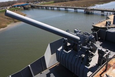

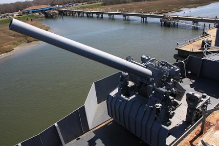

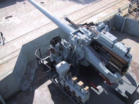

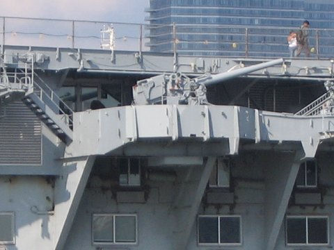

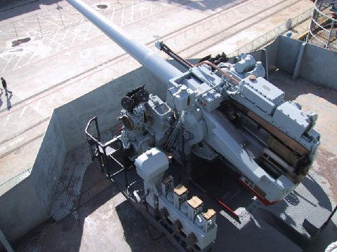

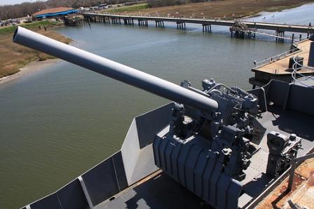

Mike -
Yes, I found a bunch of interesting information there. There is a link toward the top of the page "click here for additional pictures" that shows the Mk 21 and Mk 24 pictures a ways down in the list as well as line drawings. Good stuff.
I'm looking for the version of the 5"/38 open mount that l'Arsenal used for its model. It seems to me to be a post-Mk 30 mount since the front shields are taller than those of the Mk 24 or Mk 30.
Here's a picture of the Mk 24 mount on CV-10 at Patriot's point. Finally a good view from the front to show the shield and how it differs from the Mk 30 with the wrap-around corners. John

Pocket -
Thanks for the offer. That would help us.
Now, I have to say here that I think I was wrong about the l'Arsenal 5"/38 open mounts not being correct for the Mk 24. I looked at a picture of a review sample and based my conclusions on that. Just now I pulled out some of my samples and looked at them under a magnifier and I feel that I need to correct my earlier conclusion. It does look as though the front shield is correct for the Mk 24 and it resembles the Mk 24 shield in the Veteran Models model as well. The Mk 21 had no shield, so the l'Arsenal model would not be correct without some modification. The Veteran model would seem to be correct if neither shield were applied. The l'Arsenal model does have a large handwheel on the right side over the trunion. I am not sure if the kit came that way or if I applied there according to the instructions. In either case, that wheel is not correct - or is at least way too big - for any of the pictures I have seen. There are two gauges at that location which the Veteran model does show.
Hopefully this correction is merely academic in that no one was drawn off-sides by my original comments.
There were several variations of this mount as the original was upgraded and automated. Some of those changes are easy to spot - the shield for example. Others are a bit more subtle such as the addition of electric motors. Still others change the way the mount functioned though not necessarily how it looked outwardly - for example the change from pedestal mounts requiring ammo to be hand fed from ready ammo lockers to base ring mounts which featured ammo fed up directly from an ammo handling room one deck below the mount. I have learned a lot since wildspear's first almost offhanded comment. Hopefully I have it all in one sock now. HORNET presses on!

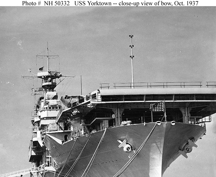

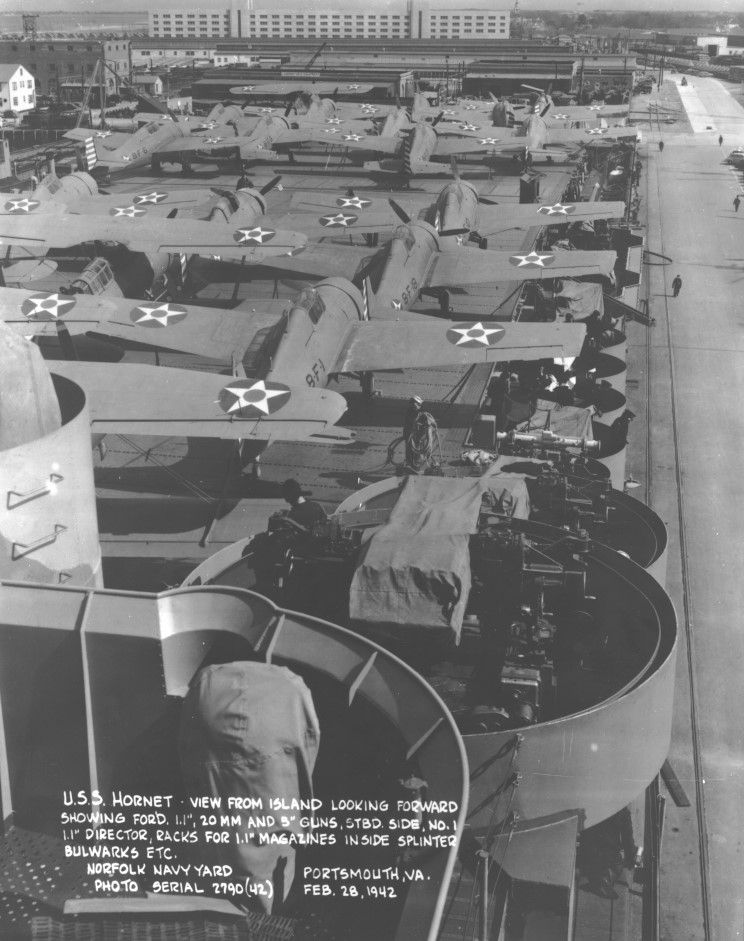

Wildspear -
Assuming you are interested the catwalks inside the hangar up in the crossbeams for CV-8, both the Webb Warships and Maryland Silver plans - especially the latter - have all of their locations shown. The MD silver plans, since they are shipyard blueprints for construction, also show the detail drawings of most of the various platforms all over the ship, including the external ones at various locations. Knowing this information can be a double-edged sword I'm afraid. I realized, for example, that the platforms in front of the pilot house on the island are all perforated metal, not solid (and, therefore, easy to build on the model). Photos such as this one confirm this. Notice the perforated decking in the lower left corner of this famous shot. This is the floor of the roughly rectangular platform one deck below the pilothouse. The platform that wraps around the front of the pilothouse one deck higher is the same material, most likely used for drainage and weight reduction. I haven't seen the CV-5 MD Silver plans, so I don't know if this is class-wide or not. I'm planning to use material from the perforated catwalks in the WEM or GMM P/E sets to do this job since it is in a visible (for my HORNET) location.
Be VERY careful what you ask for . . .
- Posts: 8561
Re: Calling all USS Hornet CV-8 fans

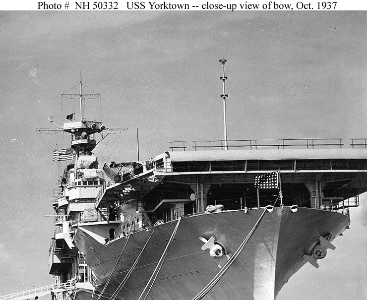

John...John W. wrote:Notice the perforated decking in the lower left corner of this famous shot. This is the floor of the roughly rectangular platform one deck below the pilothouse. The platform that wraps around the front of the pilothouse one deck higher is the same material, most likely used for drainage and weight reduction. I haven't seen the CV-5 MD Silver plans, so I don't know if this is class-wide or not. I'm planning to use material from the perforated catwalks in the WEM or GMM P/E sets to do this job since it is in a visible (for my HORNET) location.
Is that completely perforated like the catwalks on the side of the ship, or is it a "riser" to keep feet dry, etc?

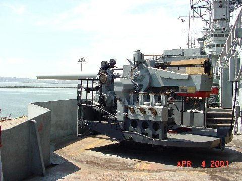

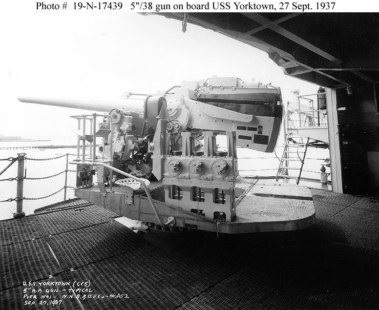

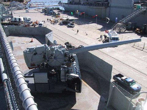

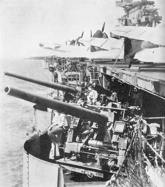

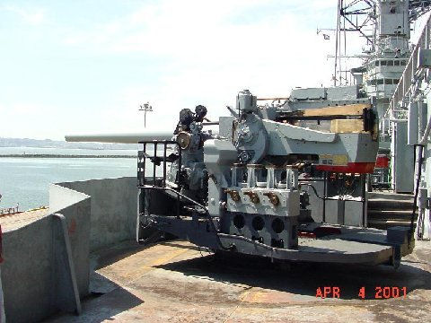

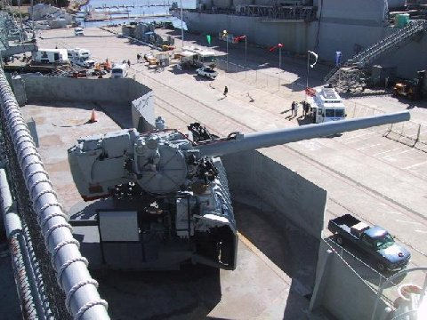

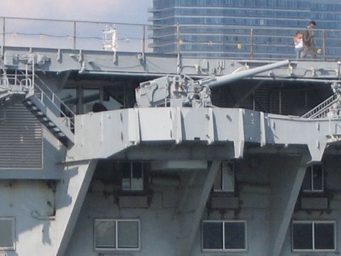

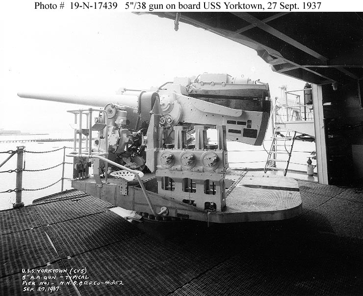

Regarding the discussion above about the 5 inch guns, here are some photos of 5 inch guns, via Freb B. They are from Essex class ships, but may be helpful to some.
- John W.
- Posts: 518
- Joined: Tue Mar 27, 2007 12:34 pm
- Location: Smithfield, Virginia
Martin -
Unfortunately for us modelers, yes it is perforated all the way through, and yes the entire deck surface is made of the material. The plans call it out as "6# PL Perforated" which I assume means 6 Lb. plate - perforated. This same material is specified for the catwalks / external decks on the island including those along the sides of the funnel, and the deck in front of the pilothouse and that the larger exterior deck below it on the front of the island. I could not find a callout for the gallery walkways at the edge of the flight deck, but those are clearly perforated too as seen in several photos, so I am assuming it is the same material there as well. Here's a shot of YORKTOWN where you can make out the perforated gallery walkways (if you click on the picture to blow it up): Those are good shots of the 5"/38s - Mk 24s though I wouldn't hazard a guess which Mod. Here's a shot of the Big E's Mk 21 5"/38s. And here's a side view of YORKTOWN's Mk 21 as well. No front shield on either gun. Finally, here's the picture of the Veteran Models model - looks like the Mk 30 to me with that lower shield that wraps around the front of the platform.
