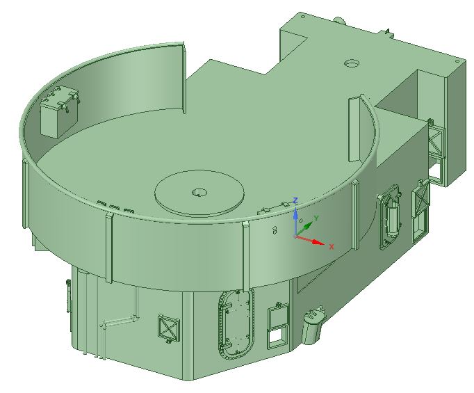

Well, small deficiencies in the caps required further design and new printing - I now have basically 4 stack caps that can work - I'll pick the two best and go with them. I've also resized the stack vent pipes as they were too long - and added a slight angle to the after pipe that I had missed in the photo. It doesn't vent straight back, but slightly to port. These will be printed later today.

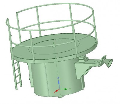

The weekend and yesterday were spent (on a whim!) designing and now printing the 01 Level After Deckhouse & Mt. 33 gun tub. I also designed & printed the Mk. 56 barbette and platform - these items I already had scratch built last year but was a bit unhappy with their appearance. So, last Friday I began working on DSM to create the deckhouse and then the rangefinder assembly. Here are design shots of these parts:

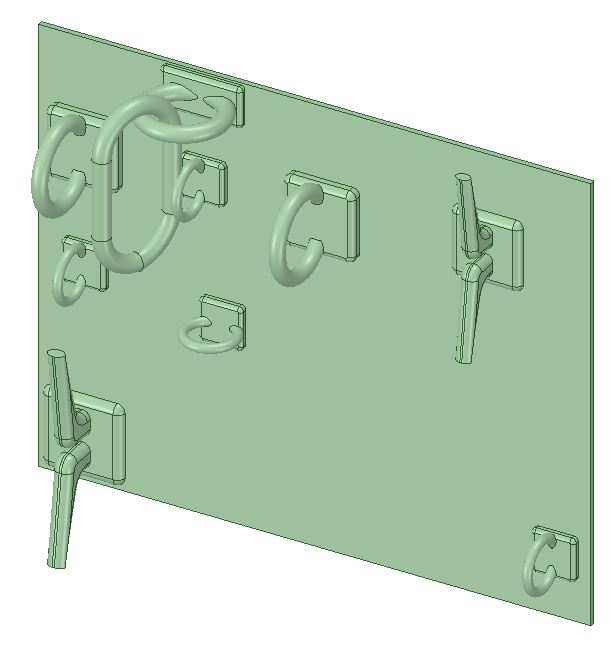

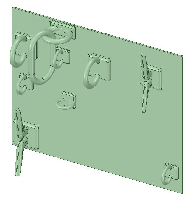

I've also designed/printed the comm. antenna that sits on the fwd. platform in front of the Mk. 56 barbette. One of the problems with the original handmade item was the small cleats/rings on the sides of the deckhouse and for this I designed a separate 8mm x 10mm panel that fits into a similar sized recess on each side of the deckhouse -
I only designed the stbd side and using the MIRROR command, created the port side item in Chitubox (slicing program). These are printing now with the deckhouse.
So, around 1pm today I should know if the deckhouse printed and if it's useable - always a question as Tom & I have found out - this is NOT a push button hobby!
Now I'm thinking about design/printing the 2 different sized vent grating that will be needed for the small bulkhead vents on the deckhouse. At this scale it's hard to get very fine wire to print without usiing some sort of background - so this is how I'll do it and then use a thin black wash for the painting before inserting from the backside of the openings. At least, that's the plan.... :huh:

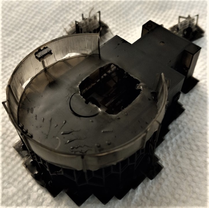

Well, 1st edition of the deckhouse didn't come out so well - the tub walls and deck were too thin -
It looks like it took a hit from a Kamakazi Troll :doh_1: However, it did show me that my details printed all very well and there doesn't need to be any correction to those. So, not an entire loss! :thumbs_up_1:
The two replenishment panels likewise did not print well and I was expecting as much. So, more DSM work to do and then try again. My vent stack pipes are printing now and I don't forsee any hitches as they already printed very well, except for length.

As for today's printing - the 2nd edition gun tub/deckhouse was also to a great extent a bust -
The fwd. section of the deckhouse failed to print so back to the DMS drawingboard!!! The 2 replenishment panels DID print very well (shown on the turntable behind the deckhouse) and are drying now. I made a thickness adjustment to the panel and then oriented straight up on this run. So, I'll begin again by thickening the bulkheads, interior and exterior, and deck, orienting the 3rd edition flat this time and see what happens. If that too fails, then I will take this 2nd edition and cut off the damaged portion and print that part of the unit as a separate part with tabs for joining. That way, the gun tub portion won't be a total waste.

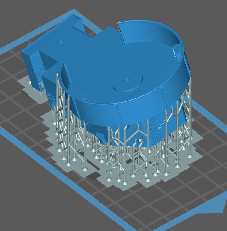

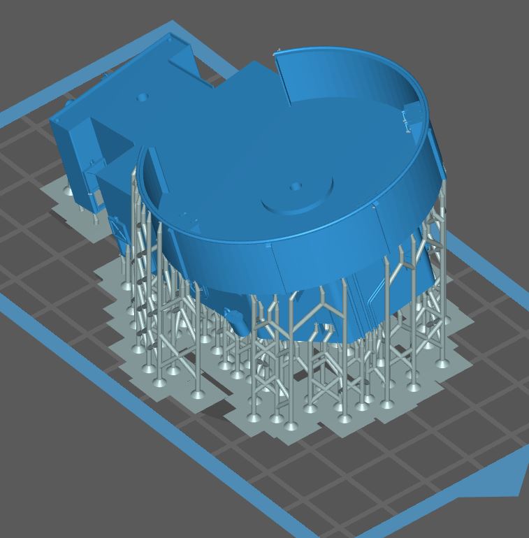

Your gun tub may print better if angled. Might save you the trouble of having to thicken features. The design itself looks superb.

ModelMonkey wrote:Hi Hank, Your gun tub may print better if angled. Might save you the trouble of having to thicken features. The design itself looks superb.
Steve,
:doh_1: - Now, you tell me!!!! LOL!!! I actually thought about that, but we'll see shortly how the 4th Edition comes out. I did angle it (fore/aft) at 10 deg. from flat, but did not cant it either left or right at an angle. It should "hatch" in a few minutes or so, so I'll follow this up with the results.
Thanks for the great comment on the design - much appreciated!!! I do have the 2nd/3rd edition available if needed + the forward portion I printed specifically as a replacement, so there WILL be a part finished coming Hell or high water :Mad_6: :yeah:

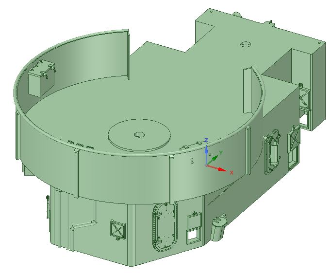

Well, printer's back running the small parts and I've followed you & Steve's advice and reoriented the deckhouse in both X/Y directions -
144 scaled DD566 01 Lev After Deckhouse & Mt. 33 Gun Tub 4th Edition Reoriented.JPG
So, this increased the print time to 5:50 hours (was 5:15 hours) and that will occur tomorrow a.m.

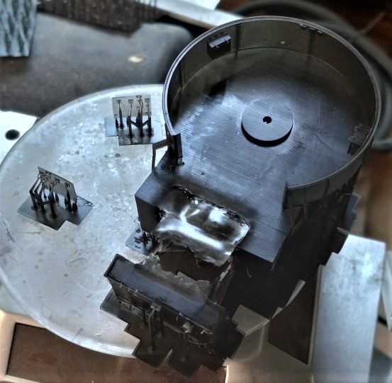

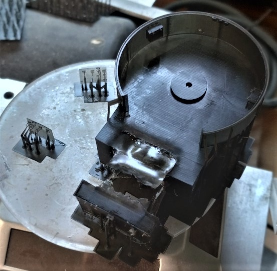

If you haven't guessed, my last print (at angle/tilted) didn't fully print, so I sent the file thru the ether to Tom and he's attempting to run a good version for me. Otherwise, I do repairs on one of my prior editions and go with that.

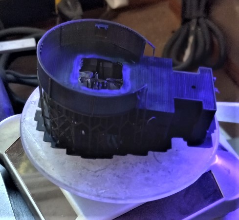

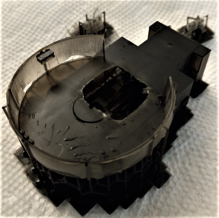

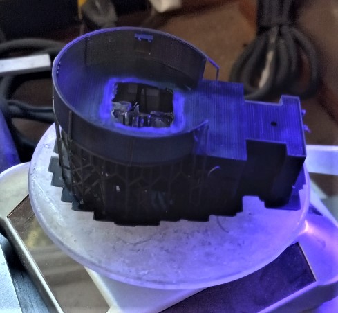

As for the status of the after deckhouse Mt. 33 gun tub - 4th Edition printing resulted in the same sq. "bomb" hole in the tub deck -
So, I have designed a 33mm x 33mm deck replacement part to fit into the opening in the deck once it's been cleaned up and sized for the part to fit. Simultaneously in Tom's shipyard in Fairbanks, he was able to successfully print the revised file I sent him and has 2 fully formed parts out of gray resin. So, I'll have a choice of 3 different ones to decide upon once the supply chain delievers these optional choices!! :thumbs_up_1: my repair part is printing now and then we'll see how this comes together. Still have no explanation for why the tub deck failed. At least everything else on the part came out excellently!
