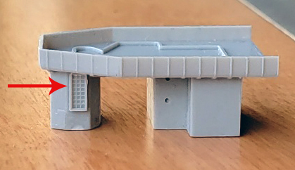

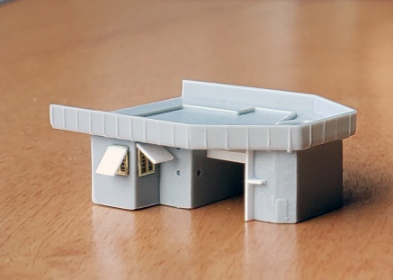

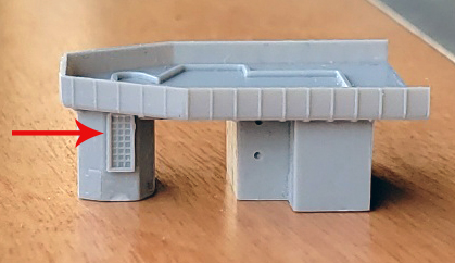

If you look at every pre-war Big Five kit ever produced to date, no matter the scale or manufacturer, you will see the representation of bolted on metal deck plating on the main deck positioned on either side of the Main Cage Mast.
Here is an example of what I am talking about on the latest release by Trumpeter.
I have never been able to find a single picture or set of plans of any of the Big Five with these metal plates in that place. This is a tough area on the ships to find good pics of but there are a few out there that shows NO metal plates.
USS California:
USS West Virginia:
USS Maryland:
So I decided to do a little digging to see where this feature first appeared on Models.
What I can find so far is that it started with the very first kits produced in the mid 1990's. In 1/700 scale, appears that it started with either Classic Warships version of USS California or Naval Works version of USS California. I'm not sure which came first. I believe Naval Works version was released in 1995. Not sure if Classic Warships version pre or post dates the Naval Works version but I believe Classic Warships kit was listed as a "Craftsman Kit".
Here is a look at both kits.
Classic Warships:
Naval Works:
In 1/350 scale, I'm unsure who produced the first kit, many came around the same time in the mid '90's. Classic Warships, Tom's Modelworks, Bluewater Navy, Commander Models all released versions of either USS California or USS West Virginia. All of them also represent these metal plates and they look exactly like the version that Naval Works created on their 1/700 kit.
It appears that this feature is simply "copied" whenever a new manufacturer produces one of the Big Five kits.
Ugh!!!
USS California:
USS West Virginia:
USS Maryland:
Classic Warships:
Naval Works:
Ugh!!!

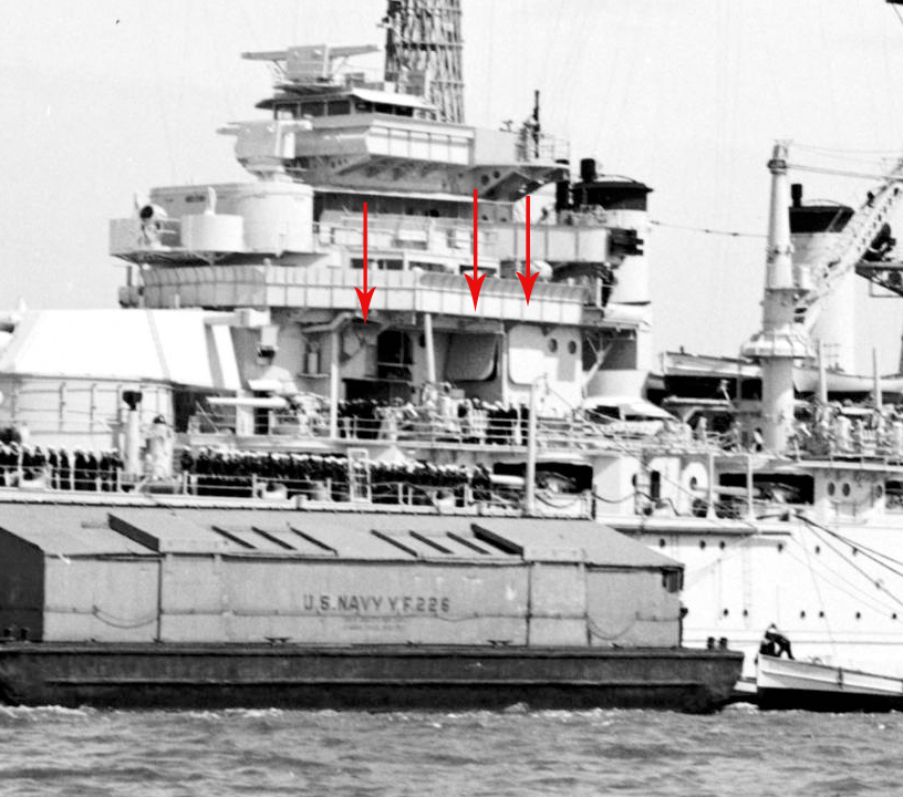

So, for the record for California, as I don't think it was ever posted on this thread (and I'm not looking back).......

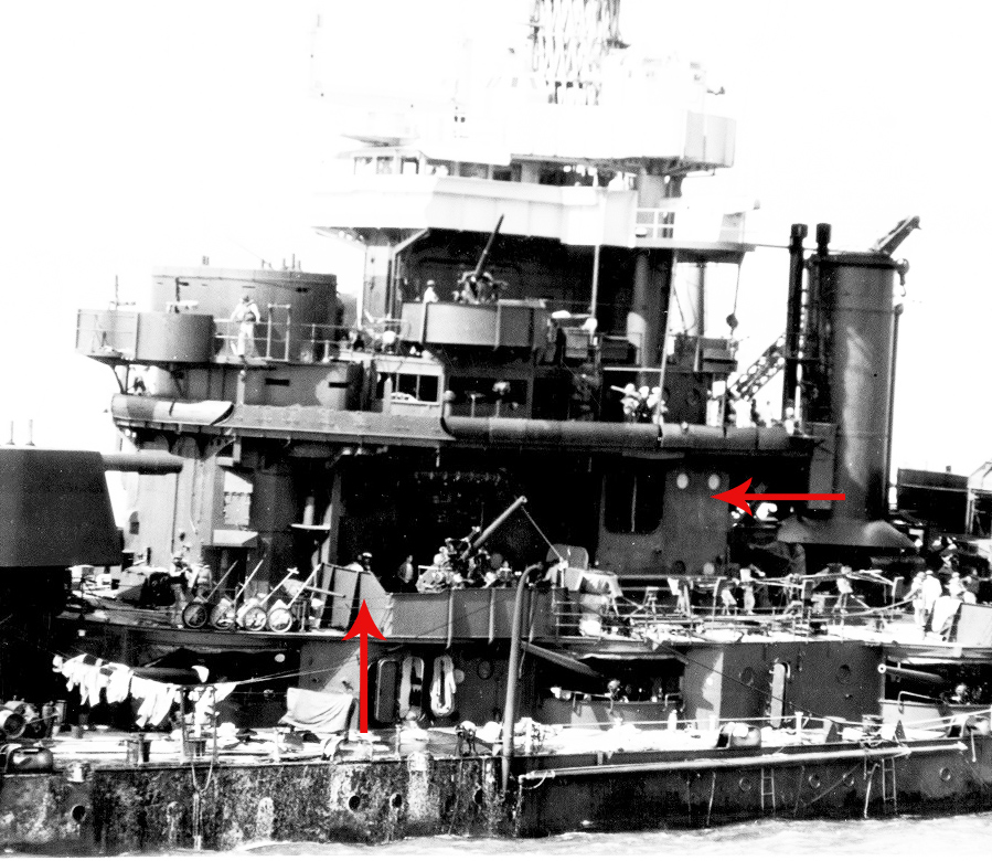

Jeff Sharp
- Posts: 1056
Re: Calling all Pre-war "Big 5" (TN/CO class) fans
Agreed! No looking back on kits already built! But for me, the next one will be an improvement over the last.

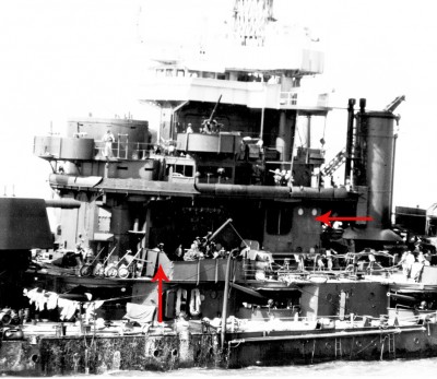

Here is a little more detail in that same area. Notice the placement of the portholes. Two that face out, just like the two that are higher up on the bulkhead. There is also a porthole visible on the backside.
