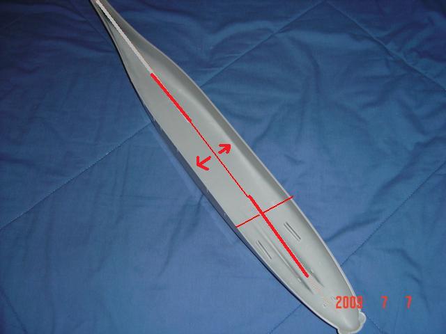

Montana 2.0
After I finish my Project Habbakuk model this summer, I think I'm going to start on a second Montana this Fall, only it'll be as it was originally designed with the boat cranes, boats, etc. amidships in 1943.
I have an extra 1/350 Missouri hull to use and will be making that longer and hopefully wider to be truer to the Montana's dimensions. I also just bought from a modeling friend today a 1/350 North Carolina to rob extra parts from as some of the parts in that kit look better for a Montana. Making the Missouri hull longer is easy. But widening it is what I'm not sure about and do not know how to do? Using instructions that a friend gave me long ago which are found in one of my posts on Page 1 of this thread:
"To confirm, the Montana is 921' long and 121' wide, thus at 1/350 scale it will be 31.577" long and 4.149" wide. The Iowa is 887' long and 108' wide, thus at 1/350 scale it will be 30.411" long and 3.703" wide. The difference is 1.166" in length and 0.446" in width. To simplify, 1.125 is exactly 1 1/8", thus 1.166 is close enough to use 1 1/8. 0.500 is exactly 1/2", so 0.446 is close enough. Simply lengthen the TAMIYA hull by 1 1/8" and widen the hull by 1/2" (1/4" on each side.)
.........and also using instructions/references from a May 1992 FSM article:
http://img.photobucket.com/albums/v216/ ... mmont2.jpg
http://img.photobucket.com/albums/v216/ ... mmont1.jpg
.........I'll be making a lateral cut across the Missouri hull about 21" back from the bow as shown by the red line in this pic:
.........which after careful consideration seems to be the best spot/choice for making a cut to lengthen the hull.
Widening the Missouri hull is what I don't know how to do. In the FSM article, Phil Raver says that after he made the lateral cut, he then cut the two hull sections down the center line as shown in this example pic:
.........and then spread the four pieces to fit the dimensions of the Montana.
After very carefully looking at the FSM article and the aft sections of the Iowa and Montana side by side, the space/distance between the 40mm tubs at the aft end by the aircraft crane on both ships appears to be the same. If Phil Raver had completely cut the hull sections down the center line like he said he did and spread the pieces to fit Montana dimensions, then wouldn't the space between the 40mm tubs on the Montana be slightly wider than that on the Iowa? Somehow, I don't think Phil cut all the way from bow to stern.
Anybody got any better/new ideas how I can widen a Missouri hull to fit the dimensions of the Montana?

Posts: 12489
Re: Calling all USS Montana class fans
Possibly you can just make a cut in the middle of the hull, and push that out a little and add a stiffener to keep the hull spread out wide.
I've attached a photo of what I'm thinking:
Basically, instead of cutting all the way through from stem to stern, start somewhere behind the stem and end somewhere before the stern, so that you can widen the hull at whichever point most accurately portray's Montana's girth.

Wow. Thanks for the fast reply, Timmy. :thumbs_up_1: The pic you showed is what I strongly suspect Phil Raver must have done in order to widen a Missouri hull. I suspected it for a long, long time, but was never really sure. Now the only trick left is to plan and figure where exactly to cut. How far back from the bow, and how far forward from the stern. Hmmmm. *lost in thought*
So like, what would be good? Dremel with cutting disc, perhaps?

I followed that same article several years ago to build my Montana. What I did was 1st cut the hull entirely in half using a fine razor saw from stem to stern. Then I took a piece of balsa sheet stock 4" tall and super glued the two hull halves to it (I remember I had to slighty reduce the thickness of it towards the bow to get them to join correctly. Any stock sticking up above the hull I cut off. Next I cut the hull in half at the location cited in the article so that I only had two pieces to work with. I then added a section of built up balsa stock to make the addtional length and glued the two halves to it. I then sanded all of this to shape and covered the exposed balsa with Squadron putty. Then it was sand, putty, sand, putty and sand some more. Finally I primed the whole hull and applied the final color. It turned out fine. I too couldn't figure out the article and knew there was no way I could cut the hull into four pieces, add length or width to each section and then get everything to align right. My way I only had to align the hull when I lengthened it. I hope this helps. I later bought the Toms resin Montana which is an as built configuration but have never tackled it yet.
Michael Lacey

Interesting technique you have there. :cool_2: Did you have any pics of the construction process that you did? If so, I'd love to see them. :)

Well, one would surmise the use of balsa would be helpful with regards to adding strength to the hull - if you use a modest width of stock, you can use it to hold the spaced pieces apart. Leaving part of the bow and stern intact would let you wedge it. If you go ahead with the widening pieces first, you could put the strengthening slats in first on the vertical, which you could use from that part, to cut a single piece balsa bottom plate which could cover not only the extended length, but the adjusted width. From there, you can build the vertical slats in place to accommodate and support the hull sides when you install those next. Sand, putty, paint, she's all gravy.
Just my thoughts.
