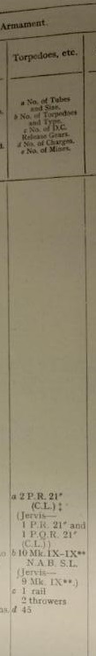

Here is the relevant column for the J Class in the half yearly return CB 0815B dated April 1941 (theoretically correct as at 31st March 1941):

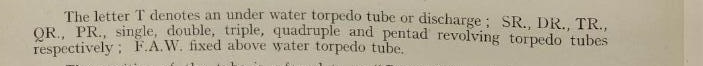

Re a. PR means pentad, QR means quadruple so "PQR" is a slight typo by the staff officer compiling this list!
But a distinction is clearly being made between Jervis and what the rest of her class were supposed to have.
Re b. the number of torpedoes carried on Jervis is clearly shown as 9 not 10.
Then at the bottom of the page confirmation of what we see in photos, that Jervis did not at that time have one set of TTs replaced by a 4" as she is not listed:

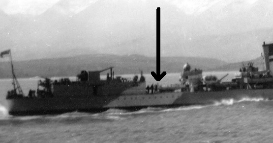

The previous image of Jervis at Alex shows the forward 5 set TT trained to beam strbd, the torpedoman splinter enclosure may be there, but the aft quad set has no enclosure, the previous strbd image I posted shows no control position on the aft set.
Her IWM image for mid 42 shows no enclosure on either TT set.
As with all equipment these primary control positions may have been repositioned spanning time, the small useless image in Langtree`s book Pg 91, shows what could be a change of primary control to the aft set? but very had to distinguish.
For early/mid 41 it would appear the aft set had no enclosure fitted.

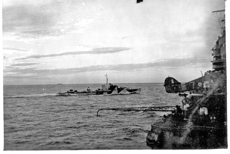

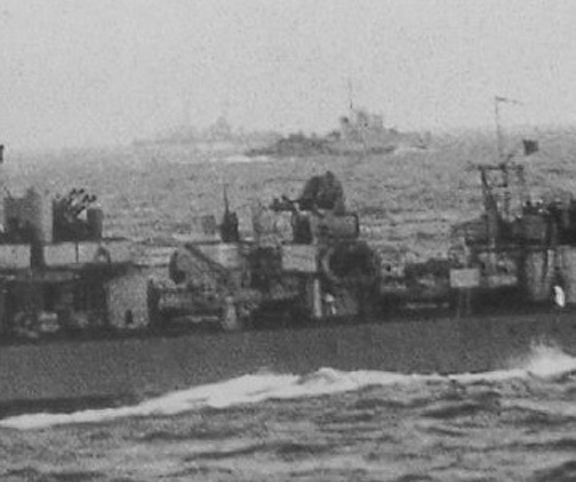

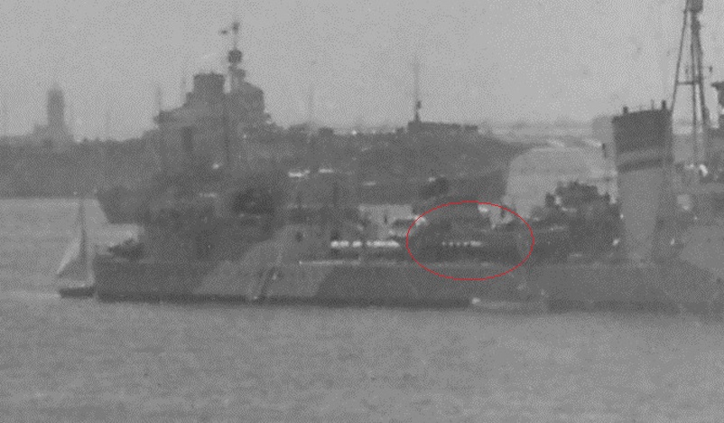

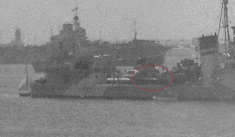

I think that these two photos show what we may all have been looking for: photographic evidence that the aft set of TTs on Jervis was a PQR.
In the first (looking forward) the outermost tubes on both mountings are in line ie the aft mounting was no narrower than the forward one:
In the second (looking aft) there is an obvious gap where a centre tube would have been:
Also visible in both photos is what I interpret as the (largely unprotected) local firing control position at the edge of the PQR which I think is in fact also visible in Brett's photo:
This overheard view shows it in the same position on a PQR on an I Class destroyer (Icarus):

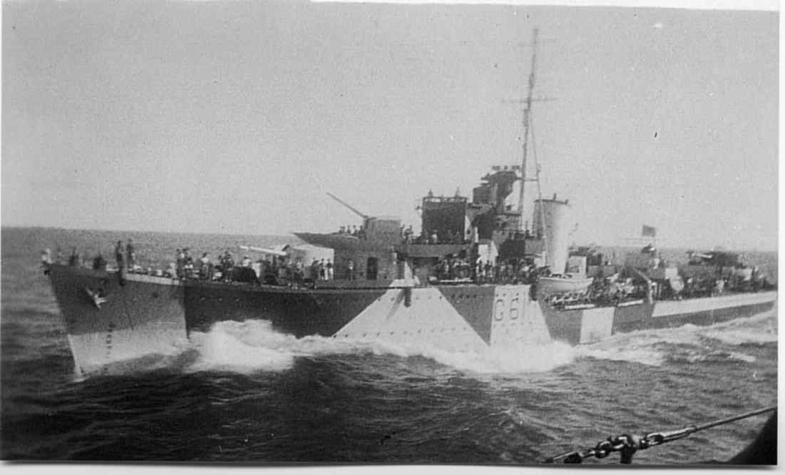

Re: https://www.iwm.org.uk/collections/item ... /205124863

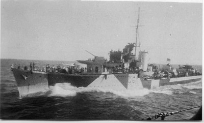

This very late 1941 and early 1942 scheme on Javelin was not the same both sides (beware of some photos on the internet which are simply the starboard side reversed).
I have a hunch what the portside looked like in a general sense but the photos I have do not show enough of it to tie it down.
I suspect Javelin wore the late 41/early 42 scheme until about 22nd April 1942, ie when she joined 14th DF and repainted to this scheme:
There are a number of photos showing Javelin during Op Ironclad at the beginning of May 1942 looking like this. This is the scheme that comes with the kit instructions.
As you can see this scheme was symmetrical both sides:

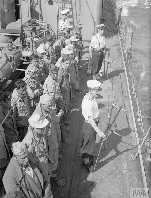

This was the scheme she was wearing when rescuing Nestor survivors 15/16 June 1942 (by then with Flotilla bands on her funnel).
This photo shows Javelin at that very time:
https://www.iwm.org.uk/collections/item ... /205144526
Best wishes,
Richard

Richard:
Nailed it! Sincere thanks for your response!
Indeed, if you look at the first photo of survivors from HMAS Nestor taken by the aft deckhouse of HMS Javelin (the link to which I provided in my post), you can just barely make out that that the port side of the aft deckhouse is painted in a alternating light gray/black geometric scheme that in places looks like an alternating checkerboard pattern. The second photo in your posting shows that same pattern on the starboard side of the aft deckhouse. As this was a symmetrical scheme worn on both sides, that makes perfect sense.
So thanks for resolving that riddle!
Now if anyone could shed more light on the port-side pattern worn by Javelin when she was painted in her "leopard stripes" scheme (at least on the starboard-side) in late '41-early '42, that would be dandy. And agree, I have seen many examples in books and online of the incorrectly reversed photo image of Javelin's starboard side that makes it look like it was a symmetrical scheme.
Thanks again Dick, and stay healthy!
