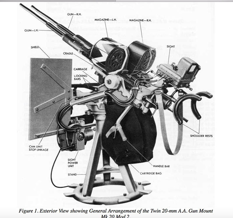

Re: 1/200 USS Pamanset (AO-85) Tanker T2-SE-A2
Posted: Wed Oct 07, 2020 7:01 pm
by Fliger747
This is the USN 20 mm twin, barely larger than the single. These are the mounts I made for my APA. Some of the compactness was by having L&R magazines.
HNSA has a good reference on them: http://archive.hnsa.org/doc/gun20twin/index.htm
They also have a manual for the 3"50.

The twin 20 mm had a single cover slipping over the paired barrels, which are quite close together, so it is possible that the one's in the photo are twins. A matter of small import as either could be true on any particular date.
