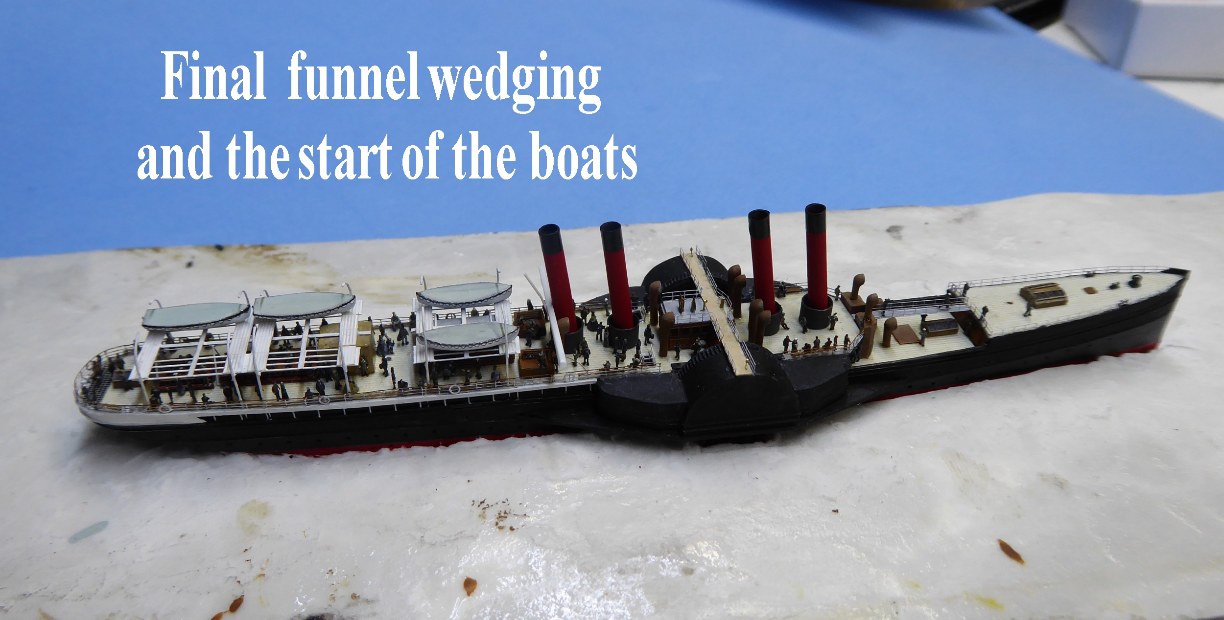

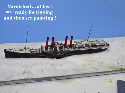

meanwhile progress is afoot!

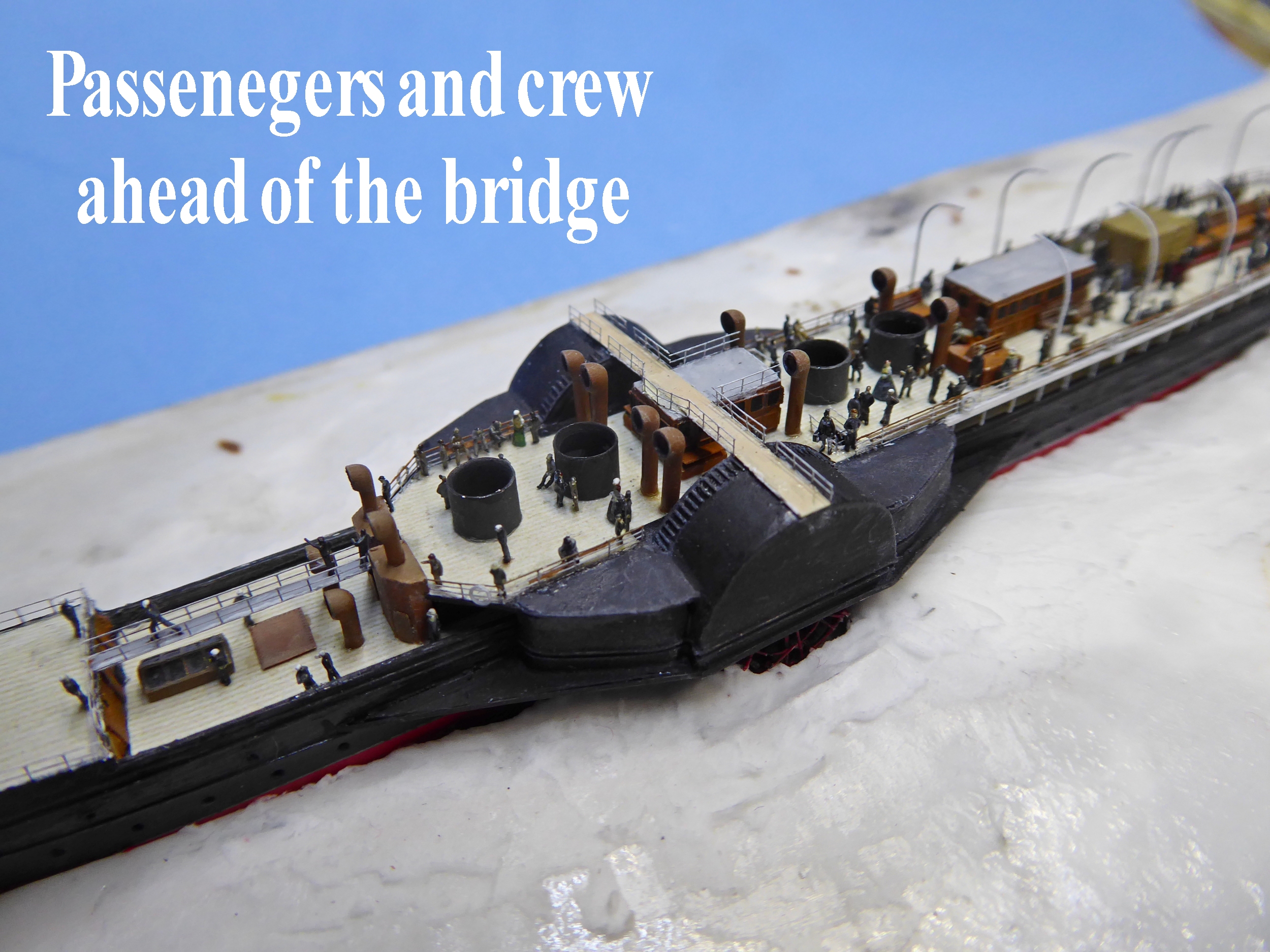

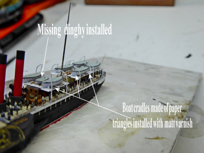

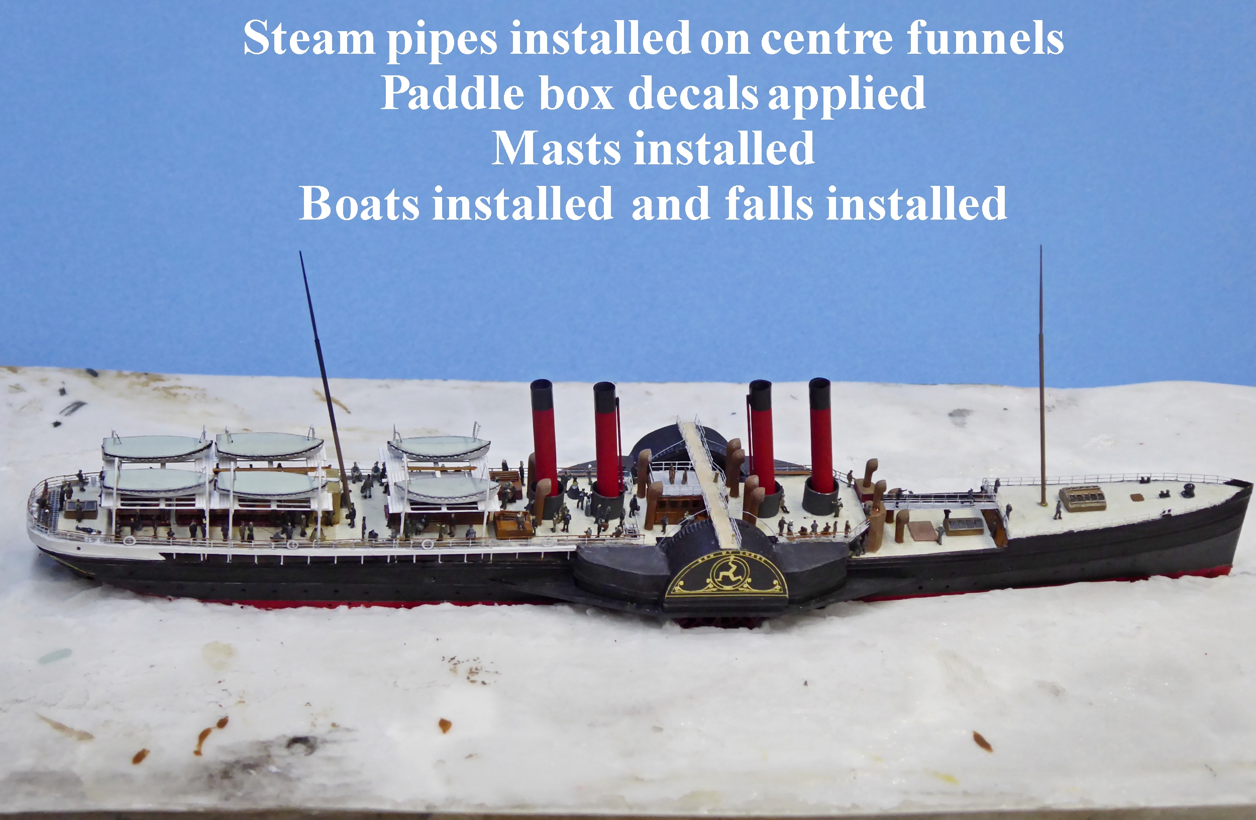

more passengers -now fwd of the bridge with the odd crew-member amongst them

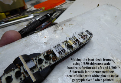

with the davits now installed , and seated and standing passengers installed below the boat deck--
it was time to create said boatdeck
from the few images I have I could ascertain that there were longitudinal members and athwarships intermittent ' gapped' planking
where the boat chocks were--thereby allowing light, drainage and access to boast below--without an enclosed deck
These decks had a slight camber athwartships --- and interestingly the longitudinal members had a slight deflection
I implied/ modelled the former camber and ignored the latter sag!!
Using assorted elderly ' scrap' PE from my boxes
I was able to construct something in the 'spirit of...'
at laaast... I could install the funnels that I made months ago !

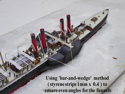

however... interestingly the funnels an masts do not have the same rake
--I noticed that before when I built the Normandie--the funnels and masts had disparate rakes !
so I double-checked side elevation images
getting the funnels to align was tricky!
meanwhile-after endless eyeballing the funnels-and double checking the model in a mirror
( a sure-fire way of dispelling any doubts about alinement's!) an awaiting the slow set glue to set...

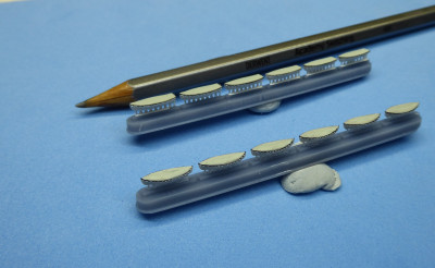

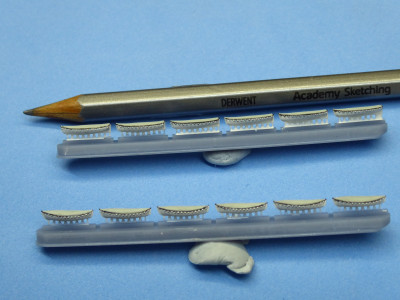

as the custom 3-D printed boats had arrived
need 2 x 29 ft whalers and 4 x pulling lifeboats ( and a skiff--I am carving that at the moment!)
said boats were painted
and installation could begin

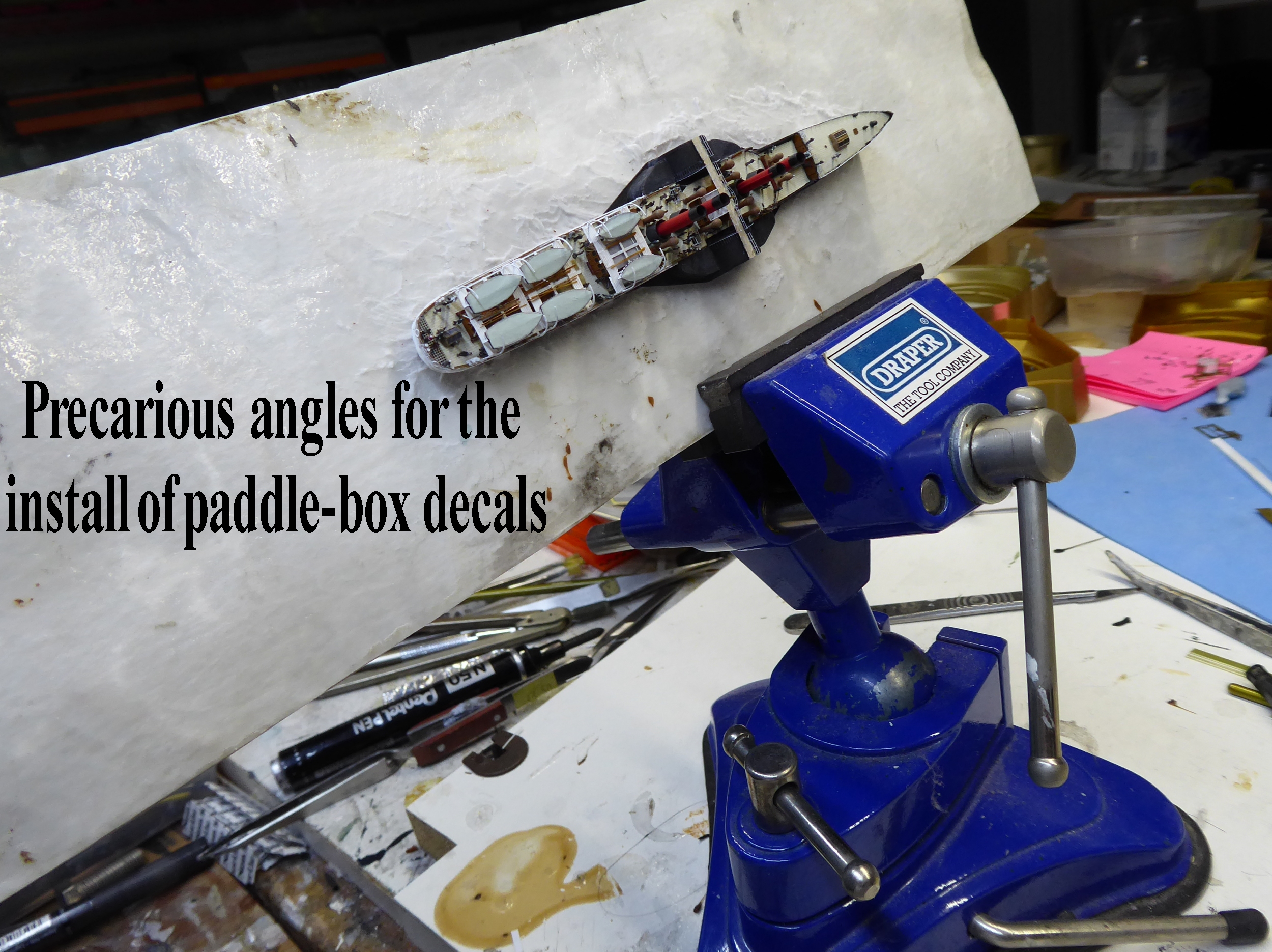

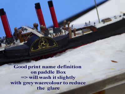

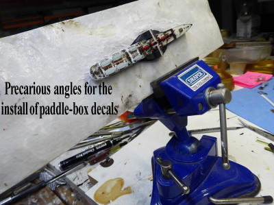

The time had come to install the- previously custom made paddle box decals
for that I needed the paddle boxes to be near horizontal-- and steady
a hand holding the baseplate would not do!
Phew !!!
it all came out well!
now for final installation of bridge furniture, additional crew, additional small bollards,
stowed gangways, making anchors , chains fairleads and many many more small parts !
before the more interesting parts of the build; the rigging and finally sea colouring!
More soon

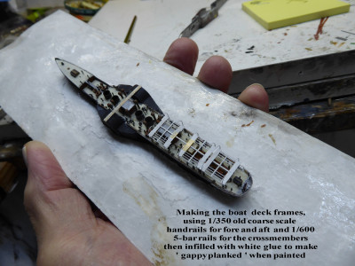

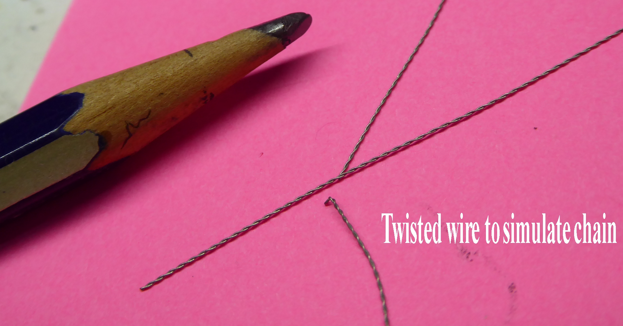

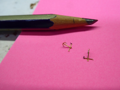

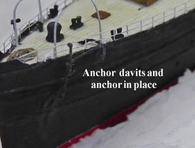

here is a small self-explanatory image based update !

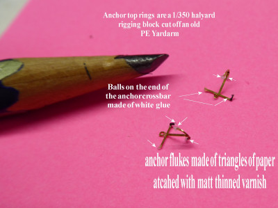

The only clear image of the anchors is this one; I cropped and zoomed in on the image and lighted it brutally
in order to discern the size and layout
The 2 x anchors were cut out of 1/350 handrail fro the stock and cross-bar,the curved base was thin curved PE strip
and paper flukes
chain was made by twisting wire
anchors installed
and paper flukes
anchors installed

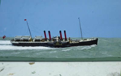

Re: Isle-of-Man 1875 Paddle-steamer BEN-MY-CHREE 1/700 scratch

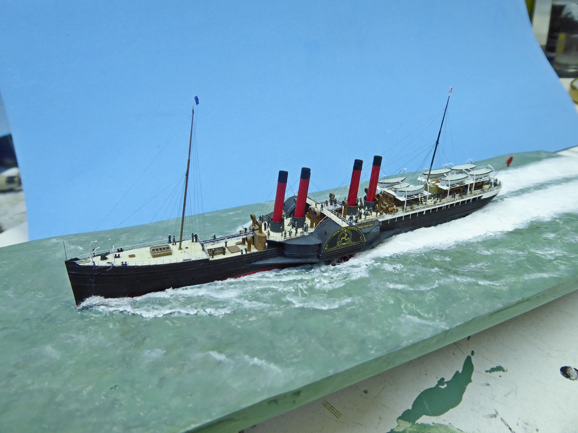

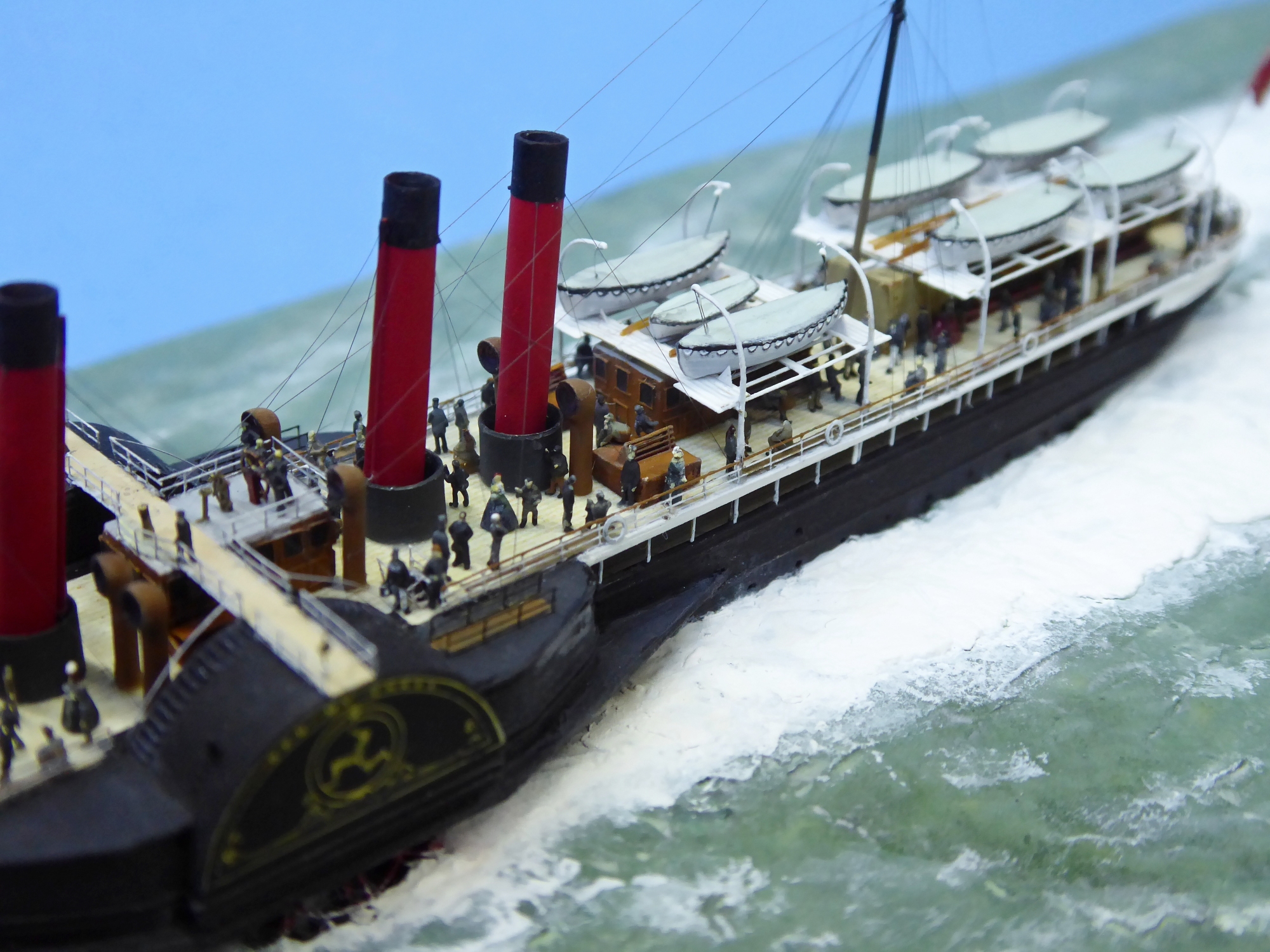

Hello Gentlemen ( and anay Ladies ?)

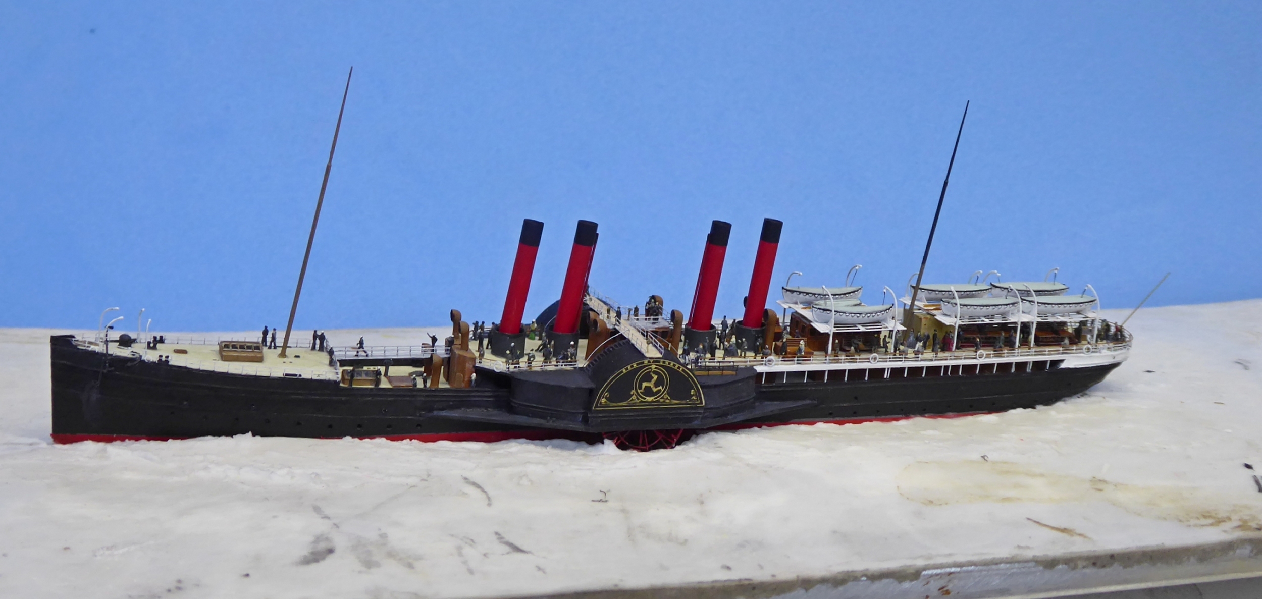

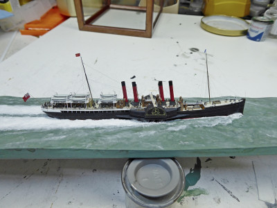

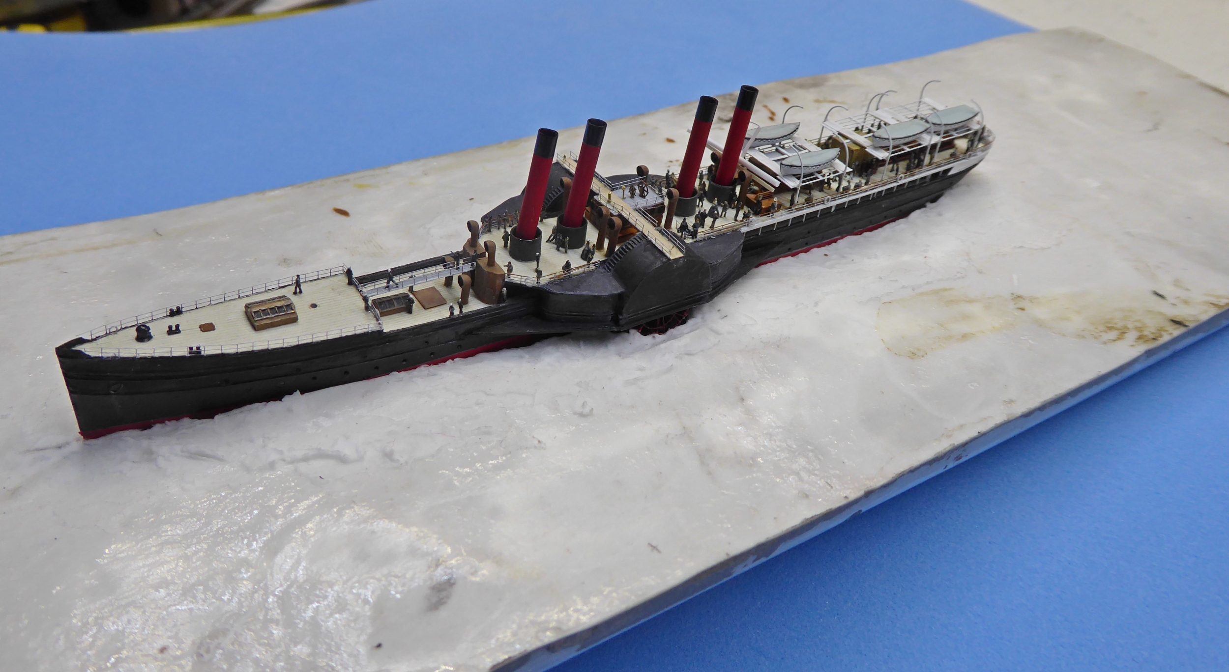

so with some long evenings at the bench the model is essentially completed
herewith 4 x " work-bench-snapshots "
formal proper SLR photos
( without the distortions of the point and shoot and with depth if field ! )
will be taken in near future
Hull length is 135mm ( 5 1/2 inches)
Humbrol pint tinlet gives a scale
herewith
Kind regards
JIM B
herewith
Kind regards
JIM B

She is magnificent. Well done.
