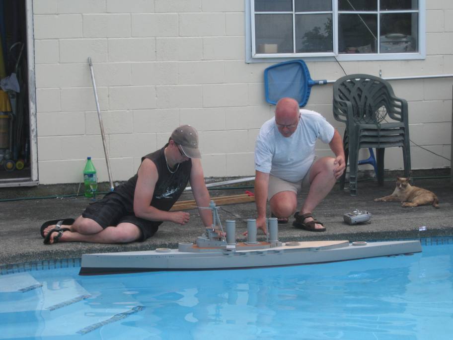

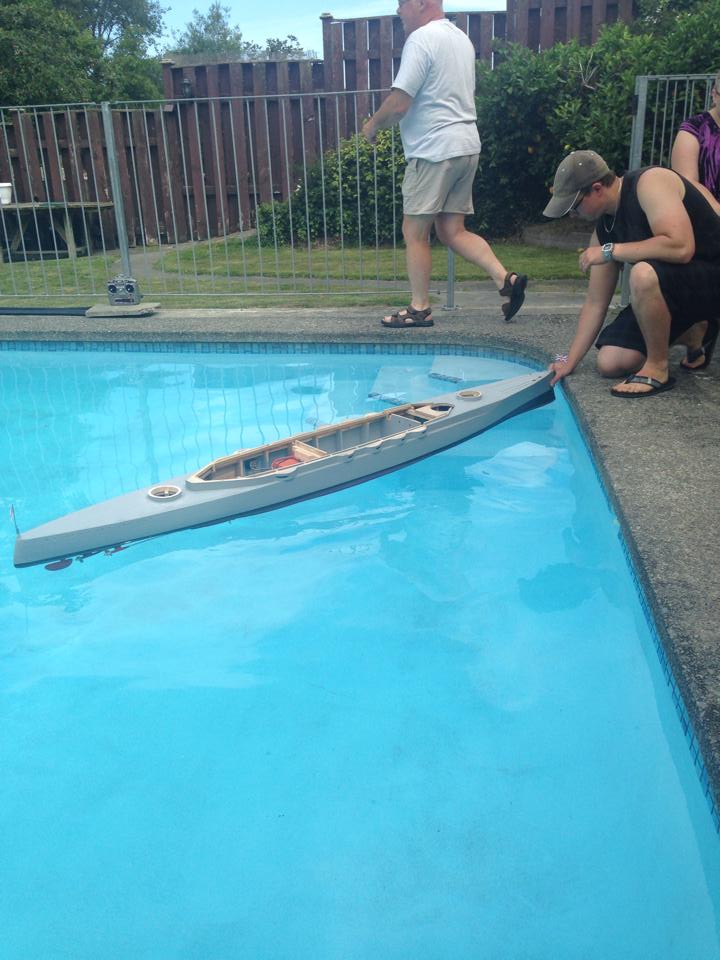

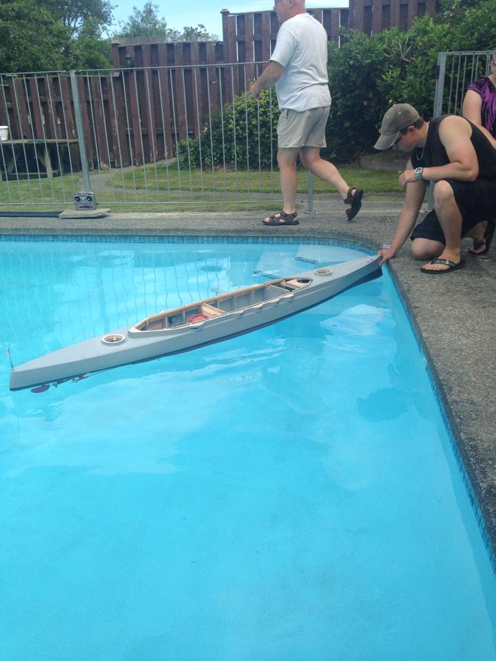

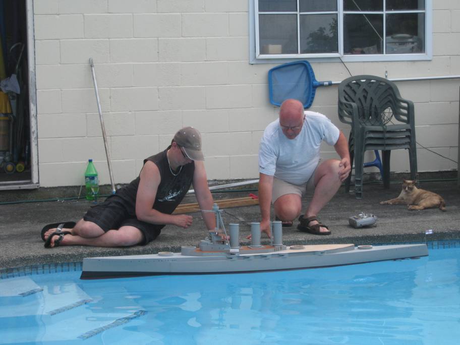

I did it! Tiger was launched in our swimming pool on Sunday, 15th December, 100 years after the original.l Her first "wetting" was in this form as the ship was pretty much in this state when launched.
The hatch was then fitted

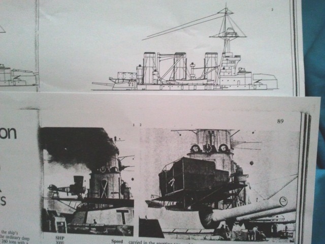

Yes the kit is "as built" particularly in the rig. There are a couple of errors
Have a look at the photo of my Tiger that shows the close up of the conning tower. I believe that shape is correct. The round tower in the kit diagram is not correct. I make this statement based on very close study of the photos in the book "Clydeside Battlecruisers" (see previous posts for description). It's quite a feature of the ship (BTW, the director which is on top of the tower, is not yet fitted to my model). The bridge structure looks mostly right for this phase of the ship's life, later on a considerable amount of structure was added. I feel from the diagram the compass platform is too big.

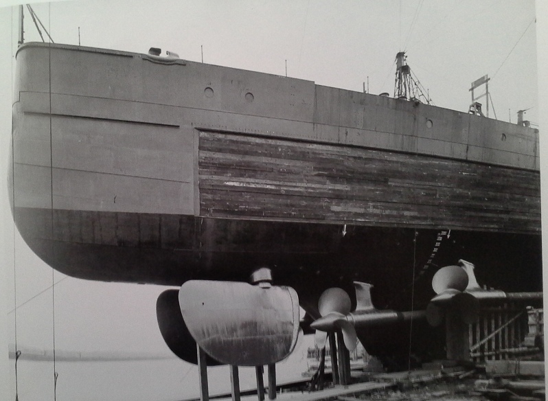

The other thing to check is the props are shown in the drawing incorrectly. They should both turn the same way on each side of the ship; ie on port they both turn clockwise looking toward the stern. The drawing has one going each way. Tiger also had two rudders inclined at 12degrees (my calculation) from vertical. This seems to have been common in battlecruisers (see discussion above) but the kit drawings and parts shows only one.
I am very interested in watching your model develop, to me 700 is such a tiny scale to work in, so I envy your fine touch.
This photo from the book shows the props and rudders, it was taken the day before launching. The wood area is the recess for the armour

Quick question, did HMS Tiger(as built) had a stern anchor ? Combrig model in 1/700 a small hole that looks like a place for an anchor on the stern.
Thanks in advance. :big_grin:

As built a hawse pipe was fitted but as shown in the photo appears to be plated over( looks like a dent). I have one photo that seems to show a capstan and the deck opening. Later when the stern walk was removed it seems the stern anchor was completed. I have no idea why it happened this way

So, I shall plate it over ? Or leave as it is just without an anchor ?

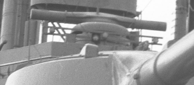

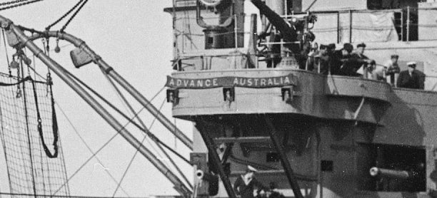

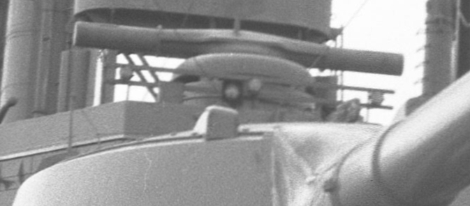

So far I'm finding that an image of her 24in twin searchlights are really hard to find. I'm looking for them on others ships of that era for my own 'big cat' and what complicates matters is there was at least 3 versions of the twin 24in mount (no doubt each by a different manufacturer). Lion class & Tigers may be the same?
I will fit and wire nav lights, but I suspect from my reading that she would never had shown lights while in this configuration; True or false?

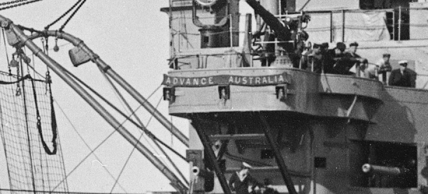

She'll have had the red & green navigation lights on a bridge platform. She'll have had white lights on the mast(s) and somewhere on the rear structure facing aft will have been 3 lamps arranged horizontally, such as: x.....x.....x
I don't now their colour nor their purpose [maybe positional for the next astern?] but have seen them on several classes of capital ship. I did look through what images I have of Tiger but can't see them on her so I've included images of the first 4 ships I found that show them clearly. I marked Courageous's with blue to make them clearer.
Any interior 'fighting lamps' were blue shaded.

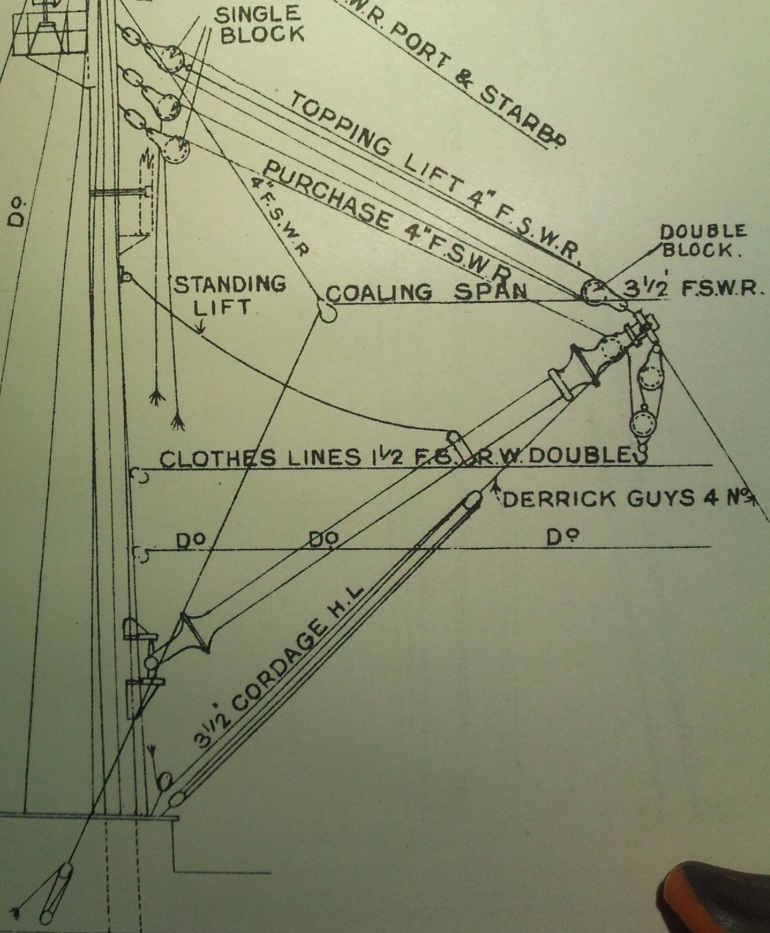

p.p.s. may be able to help with the main derrick rigging scheme. I will look into it. That for the small boats should be easy to transfer over from the shorter radial davit. IIRC, Tiger has high davits.
Courageous Fighting-Positional Lights.jpg (104.27 KiB) Viewed 6609 times
R-Class battleship Fighting-Positional Lights.jpg (35.76 KiB) Viewed 6606 times

DavidP wrote:TCC, wouldn't the 3 horizontal lights be red, white & green?
Hello,
I have no idea what they are beyond guesses. That would suppose you have an idea what they are?
Maurice
The arrangment to rig a main derrick such as the Lion class & Tiger.
4" F.S.W.R - 4in flexible steel wire rope
Cordage H.L - cordage hemp line?

Stern anchor
So, I shall plate it over ? Or leave as it is just without an anchor ? It should be plated over per the photo if you are depicting the ship in her original rig. The sternwalk was landed and the rig had its first change in 1915.

Maurice
I found out what thos elamps are. Tiger didn't have them.

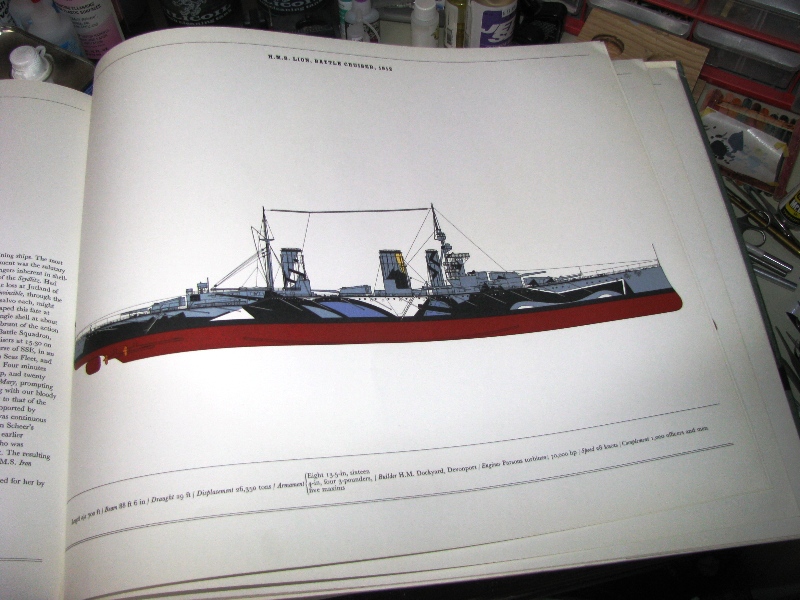

IIRC, this comes from a book of RN ships (I have a copy). This was proposed, but never applied, to Lion.

MartinJQuinn wrote:IIRC, this comes from a book of RN ships (I have a copy). This was proposed, but never applied, to Lion.
REALLY. What book would that be? Does it have profiles from both sides of the ship? I'm about to order a Lion from FreeTime and would love to do her up in this.

Re: Calling all Lion-class, QM, & Tiger ("Splendid Cat") BC
Here you go...
