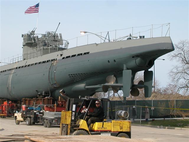

The railing looks to be a rather delicate challenge,I would like to understand the moulding technique used for the various lower hull vent? openings,they just don't look right,unless intended for photoetch additions,or removal.Most all else looks pretty good.I would love to hear from folks with more Type IX knowledge,can some experts please give their assessments for us ?

I'm no expert but, aside from perhaps not being recessed enough, I'm not sure what might be lacking. Do these help?

Thanks Dan!
My U505 book does not have that view...had no idea they were so prominent.Feel better about Revell's moulding now.

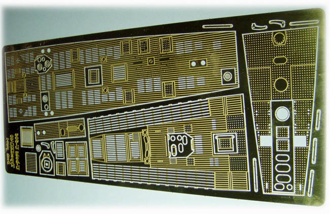

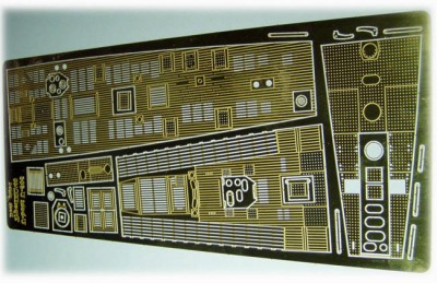

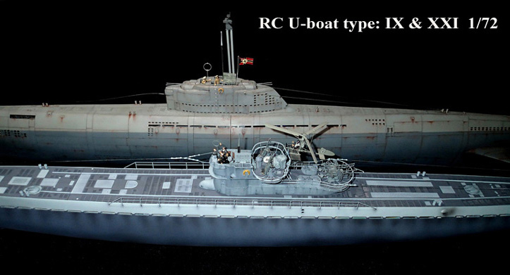

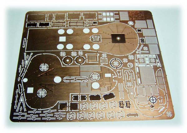

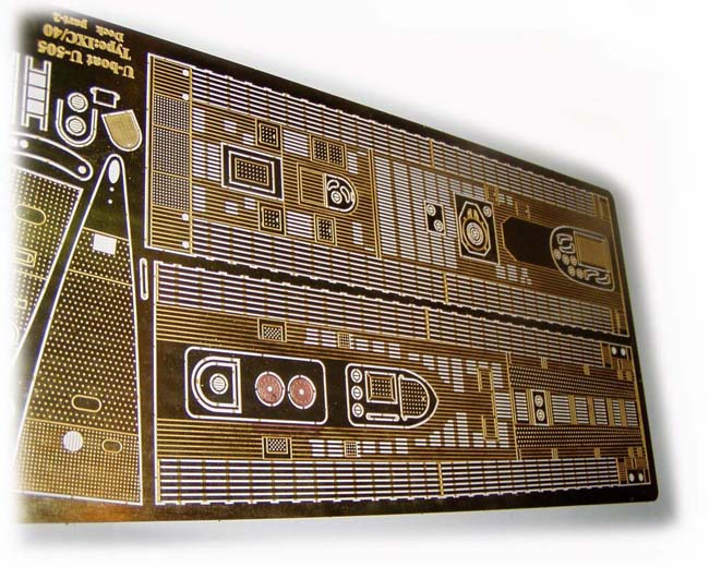

I found this yesterday, and sent Oto an email about buying the deck and PE fret, as well as the R/C running gear. Here's the web address http://www.rcsubs.cz/, and some pic's:

I saw that awhile back. I thought there were questions about weather that would fit the revell kit? Please let me know if you find out anything...

The picture I posted is a ROG kit, with Oto's deck with a type 21 behind it. to builds RC ballast tanks and drive systems, and offers one for the IXC kit.

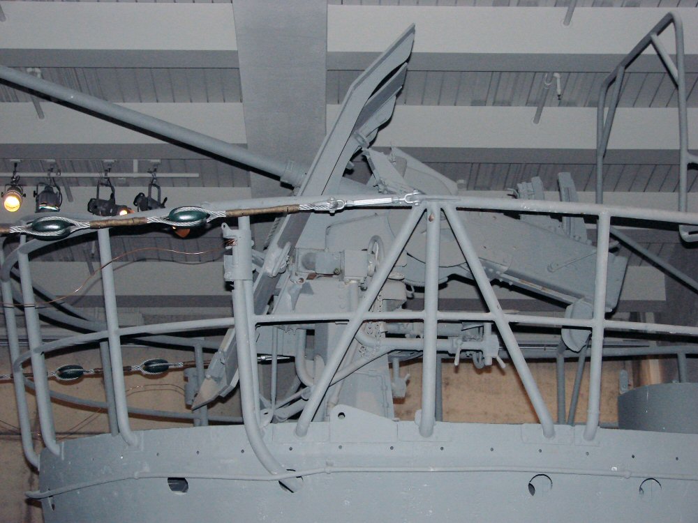

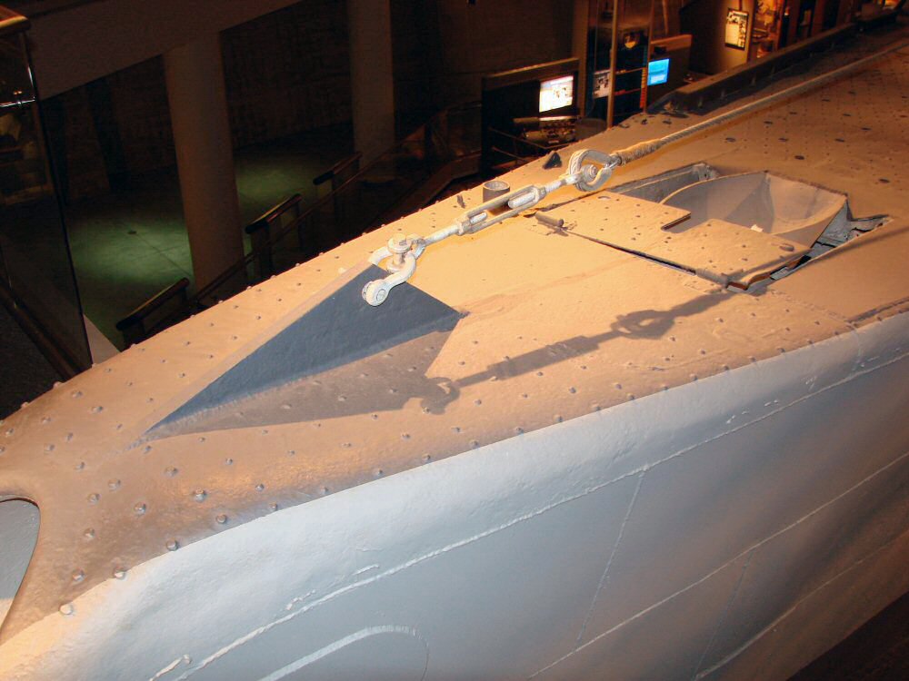

I'm wondering if anyone might know someone making this type of ship fitting? Its a shackle with a bolt closure, through the deck fitting, a open ended turnbuckle at each end, a wire thimble with the single steel jumper cable that runs up to harness that then splits in to three the front of the tower. On the U-505, it actually splits into two tension wires that replicate the attachment hardware, shackle, turnbuckle, thimbled cable up to the attachment point on the tower side. The aft jumper cables begin on the aft wintergarten top rail attachment brackets, again with shackle, turnbuckle, thimbled cable, and run to the stern deck casing, over the stern support frames.
The kit supplies nothing, nada for running these cables and expect the builder to use a knot to secure the cotton line. That, IMHO sucks. So anyone got a source? I do have some brass turnbuckles for a model ship fitter in Great Britain, and I have 0.3MM braided wire for the cables, but the problem are miniature shackles and thimbles and turnbuckles with threaded bolt fittings to secure to the shackles. The jumper cables require eight sets of this hardware (seven if you use only two attachment points on the tower). Anyone got any ideas?

What about 1/72 armor accessories? I know in 1/35 there are lots of cables, turnbuckles with threaded bolts and other such items.thomcmdchief wrote:The kit supplies nothing, nada for running these cables and expect the builder to use a knot to secure the cotton line. That, IMHO sucks. So anyone got a source? I do have some brass turnbuckles for a model ship fitter in Great Britain, and I have 0.3MM braided wire for the cables, but the problem are miniature shackles and thimbles and turnbuckles with threaded bolt fittings to secure to the shackles. The jumper cables require eight sets of this hardware (seven if you use only two attachment points on the tower). Anyone got any ideas?

What about 1/72 armor accessories? I know in 1/35 there are lots of cables, turnbuckles with threaded bolts and other such items.[/quote]
Great suggestion, I'm now on that quest!
