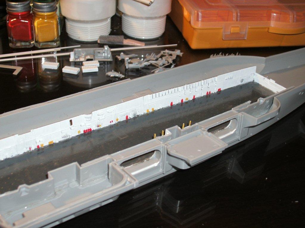

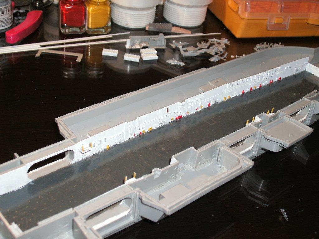

After way too much quality time with the 1:1 scale helos I've finally gotten back to work on the boat. I've started working on the island and airwing - photos to follow in the next few days. I've also started picking off some of the details in the hangar. I'm taking a little artistic liberty with the lockers and fittings - I'm not planning to light the hangar deck so I've got a few extra yellow and red items which seem to stand out well enough.

Sorry for the general lack of focus, I'm using a Canon Powershot A650 digital that doesn't like to take close up pictures of small items. The hull painting is half done, and the flight deck needs to be darker. I have yet to add detail to the elevators, which is why they don't match the flight deck. Ignore the markings on the aircraft, the only "finished" ones are those with gold canopies. The others were painted for the Forrestal originally and are slowly being re-done. None of them are glued down, and most are on the hangar deck in the pics. I still have a lot of cleanup to do all over, and the GMM set is still planned. The pics don't show the hangar deck well, but it uses a strip LED mounted to the overhead to illuminate the length. The flight deck is still unattached so I can work on the hangar deck. I want to add detail like Redlion above, just not sure if my skills are quite that far along to do so.
