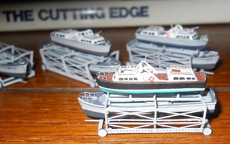

Well, I have painted the rest of the 3D printed deck equipment that I bought from Shapeways.com. All of the items you see in these photos have been designed by Greg (gjholmes77), who is a member here on modelwarships.
I will be detailing and painting the 40' and 50' personnel and utility boats next.
For the most part, painting is fairly straight forward with 3D printed stuff. I have used enamel paints, Tamiya paints, and some other acrylic paints. I haven't had too many issues with any of them. I think with enamel paints it seems like the drying time is a lot longer and the piece remains "tacky" for some time, but not always. I have read and also witnessed that this material if not fully cured and smooth can absorb a lot of paint. This usually happens where the "rougher" areas are. I have been experimenting with sealing with future floor wax. If you notice on the personnel boats that are the bare 3D printed material, I did some prepping and added several coats of future (made them shiny) to them to see if that might help aid in a smoother finish and keep the paint on the surface rather than being absorbed. I will let you know how it turns out.

I finally finished all of the personnel boats and got them all painted. These seemed to take a while to complete. I added a bit more detail to them in the form of handrails for all vessels, life preservers, antennae, and ships wheels for the 40 footers. I also painted the Captains gig with a wooden deck which I hope is convincing enough. I may or may not add some more detail to them, but I'm not sure yet. Anyway, here are some photos for them....

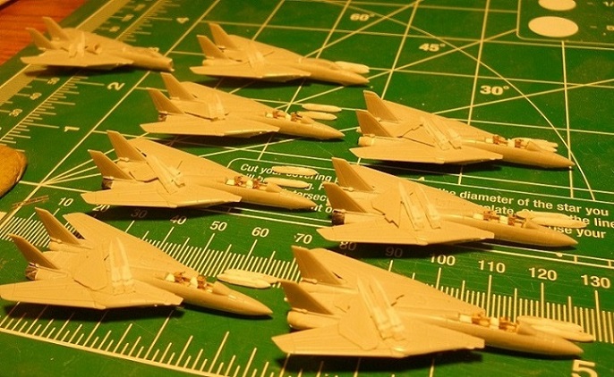

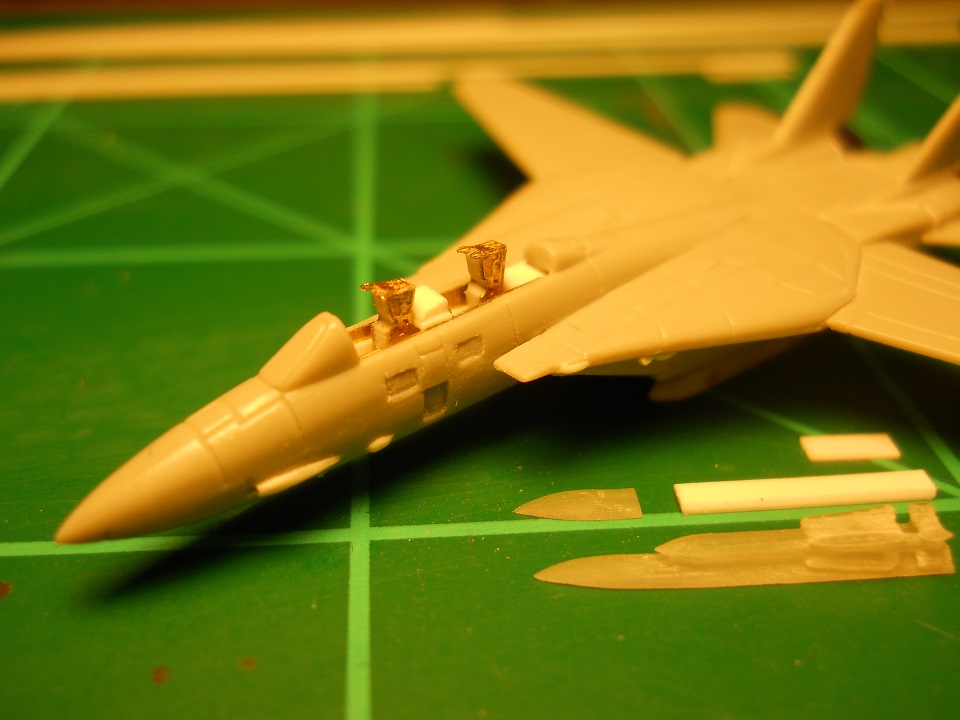

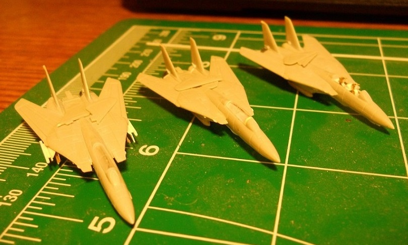

Well.......it's been a while since I last posted, but I have been doing some work so I figured I'd post some progress. I am once again working on the Tomcats. I have added some partly scratch built and photo etch cockpits and ejection seats (1/350 White Ensign F14 Tomcat) and used some 3D printed materials from Shapeways to aid in constructing the Phoenix missile racks. I've got 20 Tomcats in various different stages of construction at the moment. I still have the tailhooks, canopies, and landing gear to construct for each........but until then, here are some current progress photos.
