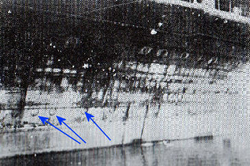

If covering the port holes on the Zuikaku would the molded on eyebrows be removed?

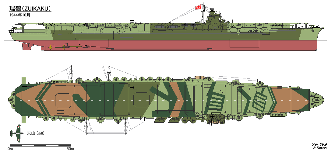

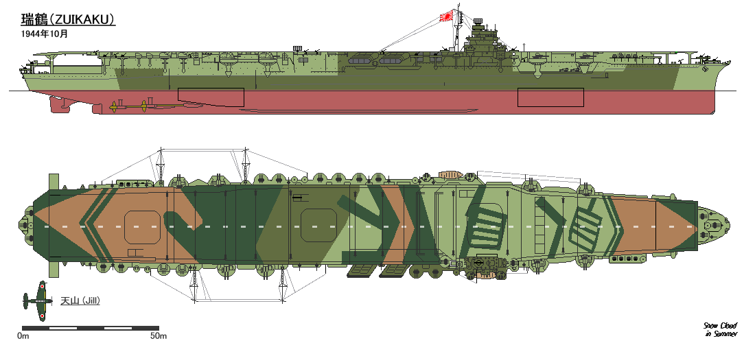

Was also looking at the camo and was wondering if this would be more correct?
Colorized from B@W.
Drawing from the Maru 8 (?). I would guess this was envisioned from the original B@W photo.

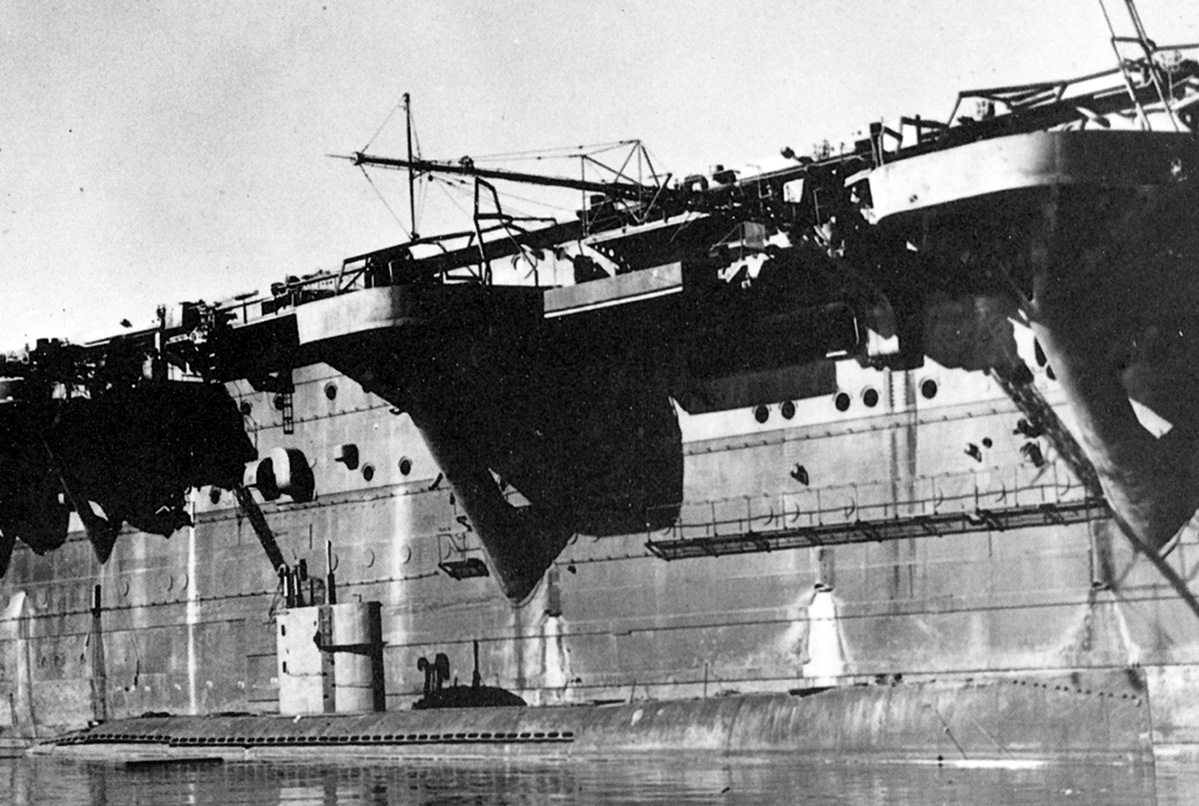

The eyebrows were removed. The Junyo photo below shows this particularly well, with good contrast between the open and sealed portholes.
The camo color plate from Maru Special #6 is probably close, though the green too bright and the brown flight deck too dark, IMHO. There are countless interpretations; another is below. (The turret outlines had mostly disappeared by the time of Leyte Gulf.) Fyi, the original film clip is in b&w; this cell has been colorized.

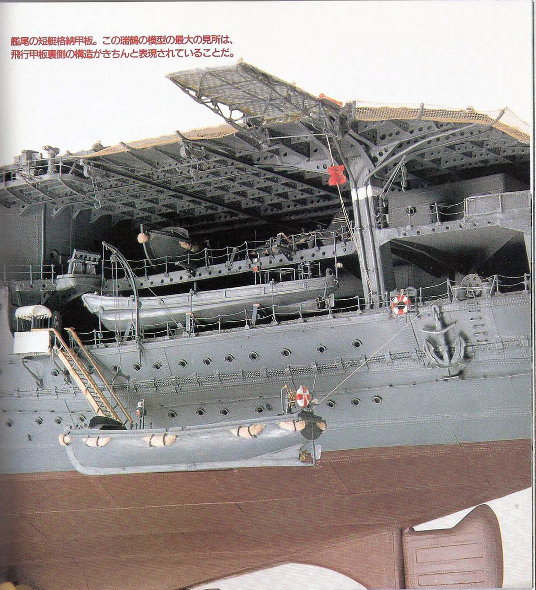

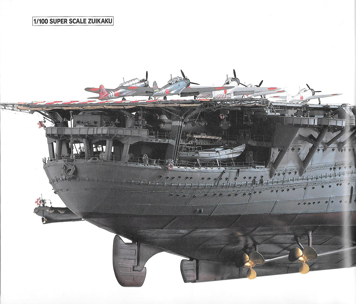

Hey there everyone, first time posting here. I'm working on a Fujimi 1/700 Shokaku with the PE upgrade set. Question about the accomomdation ladders. Are they down all the time, or were they stowed during operations? If stowed, where & how? Also are there supporting cables/pulleys for them?

Question about the accommodation ladders. Are they down all the time, or were they stowed during operations? If stowed, where & how? Also are there supporting cables/pulleys for them?
The ladders were stowed during operations on either side of the upper boat deck. I think these photos of the 1/100 Zuikaku 1942 in the Gakken dlxe volume does a good job of illustrating their usage and stowage accommodation. A stowed ladder can be seen aboard Shokaku on the previous page of this thread.
