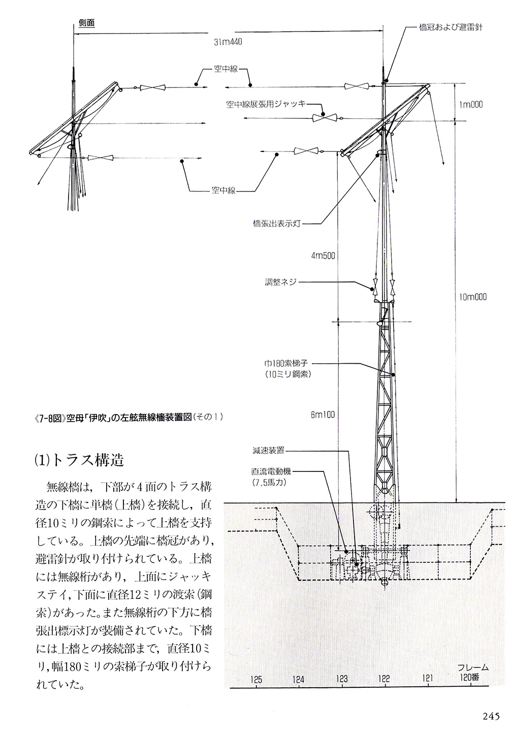

It would be interesting to know their length.
The illustration below is of the masts aboard Ibuki. Measurements of other vessels is, AFAIK, pretty non-existent, but the assumption has been that most masts were close to this size and distance from each other. There may have been some variations, particularly among the earlier carriers, but solid numbers are hard to come by. The rigging schematic might be simplified.

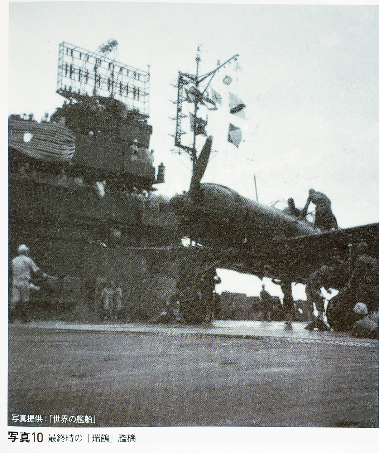

Oh! That reminds me, her upper mainmast configuration was changed due to damage there. Her main yardarms were angled back and slightly upward, like the Unryus. So, I think you'll need to alter the kit pieces for those as well. And she gained the AA rockets.
