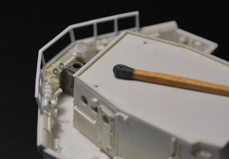

Posted: Tue Dec 20, 2022 4:49 pm
by Willie
Howdy Mr. Davis, Tom and all modelers.
Thanks once more for your always very kind remarks and useful advice.
Tom, of course the big hole will be covered, but I will have to finish all the wiring up the mast first.
In the meanwhile, the next step was further detailing in the commander cabin.
The vent on the stb. side is clearly there in Jorge Juan, but the details are very blurr in every picture that I have. Anyhow I found this one, which is exceptionally clear:
Making it was easy, using some scraps of rod in three calibers. I think that more or less I got it:
The next thing was the deck. Jorge Juan had what seems to be two lockers virtually off board on both sides, with one more in the middle of the deck. The pics are again very blurr, but they are there.
The same section onboard sister Alcal� Galiano shows these interesting details:
The two lockers hanging off board are there, along with the one in the middle, as well as another one on the very back of the cabin.
The same section onboard DD544 USS Boyd shows how the forth locker �or whatever it was� was attached to the bulkhead:
Making the lockers was easy, even though they are a guesswork in most of the details.
And over to the next post.
Brgds,
Willie.[/size]

Posted: Tue Dec 20, 2022 8:55 pm
by BB62vet
Willie,
Very nice work - as usual! I think you've nailed the lockers and exhaust vent pipe very well! I'm not sure what those lockers were used for - it's possible that they may have been pyro lockers or possibly boat deck tool lockers or something entirely different. Just a guess.
Obviously where our two models differ as STOD did not have the commander's cabin added. Your tripod mast placement looks real good, as well!
Posted: Tue Dec 20, 2022 10:25 pm
by Fliger747
Willie:
Yet another small model (Commanders cabin) to be place in the over diorama that will be the ship. A busy, detailed and convincing whole!
Best regards: Tom
