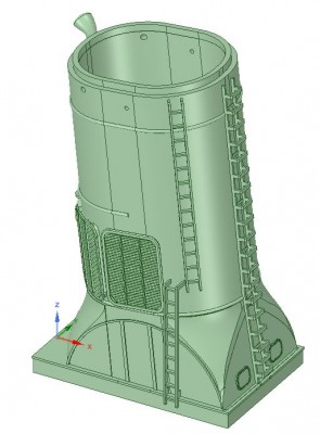

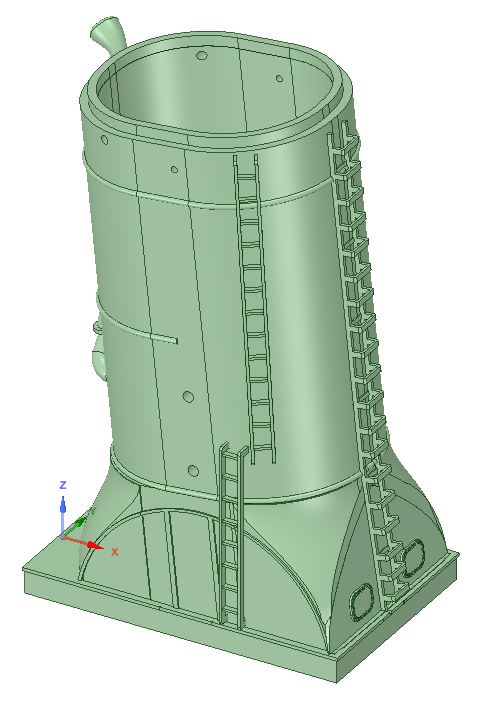

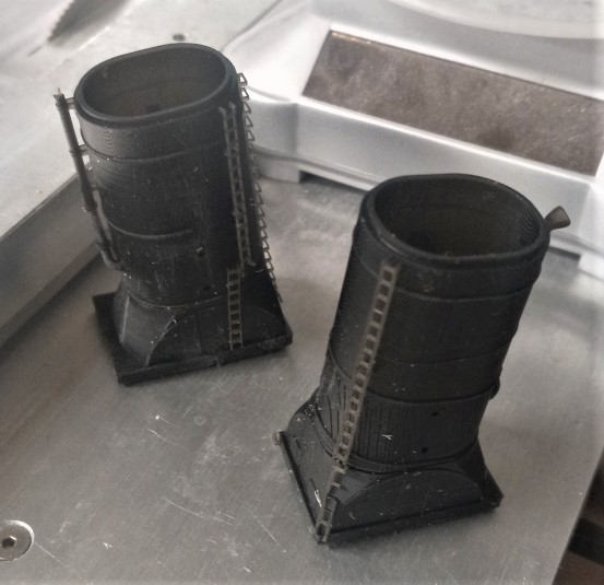

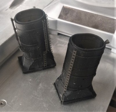

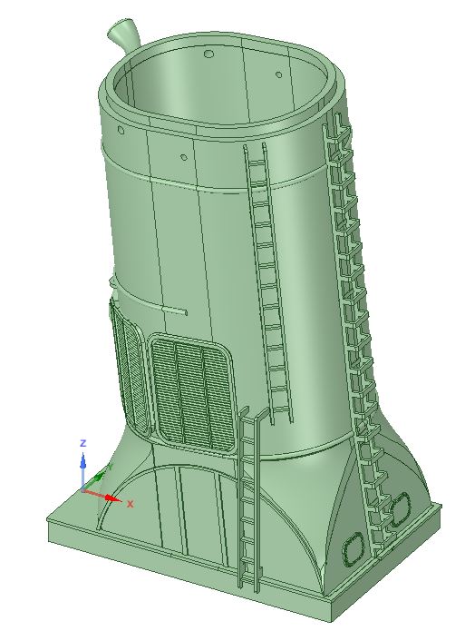

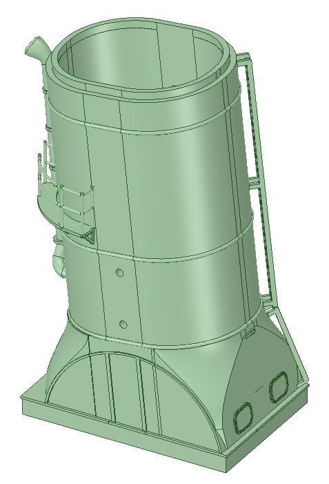

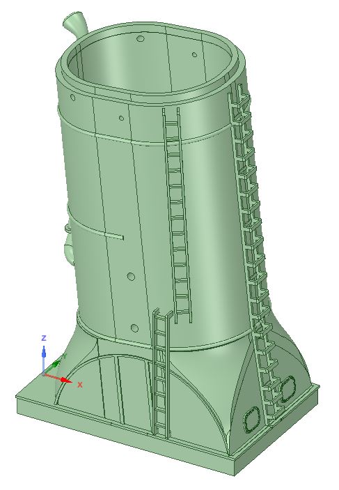

After comparing my 3D printed stacks vs the kit stacks, I realized that mine were about 1 deg. off on the setback angle and were not to scale. After all the work & printing & painting!!!
Well, that's part of the game - back to the computer to redraw and size!!! So, I made one stack body correct and then mated it to a scaled down base unit and after some hammering/welding/grinding and so forth, came up with both stacks as 2nd editions - These stacks are the correct size and setback angle so they should work well - we shall see....
I now have a print file set up with a new set of stack vent covers and some deck fittings ready to print tomorrow a.m.

Wah Hail! An unsung advantage of printing is we CAN re do items. A hand constructed item, wha hail! To paraphrase Barry Goldwater: "In your heart you know it's right".

Re: 1/144 Scale USS STODDARD (DD-566) - Kitbash, Revell FLET
Tom,
Ah yes, nothing like making it yourself!!!
The stacks came out ok - I was surprised a bit. One has a missing upper end to the vent pipe (stack on the left in the photo) so do I reprint or remove and use one of my spare printed ones??? I may reprint as the bottom of the stack bases (both) had a very slight rounding on the corners, due to, I suspect, the way I had them supported. If I do reprint, I'll print directly on the build platform and that will solve that issue. Here be da stacks: And my current stock of stack caps will fit without having to reprint those. Nothing like small favors along the way
If I do use these, both of these parts have to be cleaned up a bit - they both had some of the "fuzzies" that I had to scrap off with either my fingernail or a small chisel blade X-acto. Again, not sure why those are showing up, but just a small aggravation.

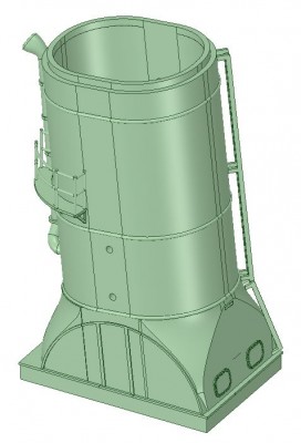

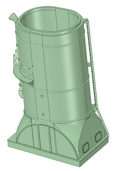

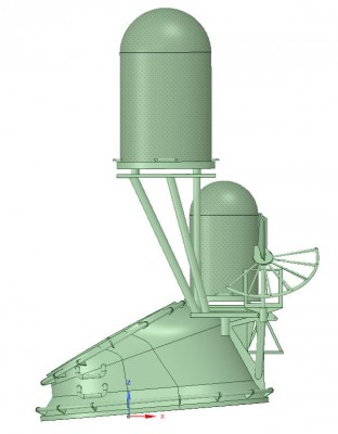

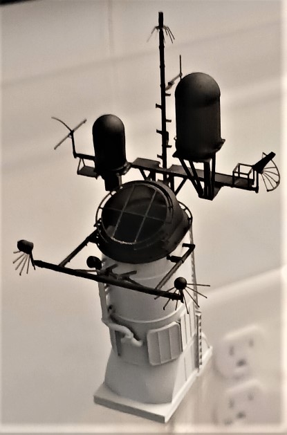

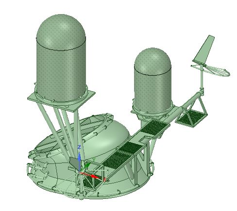

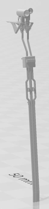

While working on the Fwd Stack, I realized that the current design for my steam whistle & piping didn't quite fit properly. So, after another design change/print and then a 2nd one, I think I have one now that will fit and look fairly accurate -
I pulled both the stack & stack cap into this design file, assembled them together, and then redesigned the piping runs and platform to conform to the angle & shape of the front of the stack & stack cap. This was key to the whole thing.
Printed a few of these items last night and after curing this a.m. will paint and see how they fit!
- BB62vet
- Posts: 3161
- Location: Mocksville, NC

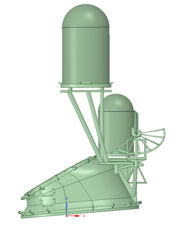

After assembling the after stack with the new stack cap/fwd. yardarm assy., I realized (too late) that I had not taken into account the angle of the stack when I designed the cap/yardarm - thus everything looked like it was bent backwards, even though there's only perhaps 2-3 deg. of tilt to the stack (lookng from the side).
So, this morning I was fiddling around with the part wondering how to correct it and it fell out of my hands on the floor - breaking off the stack cap & yardarm and thus, solving that part of the problem. The cap, etc. is not usable, but it doesn't matter - has to be redesigned. This was an all-day challenge as the parts did not want to "move" so I was forced to create a new file, copy the stack cap alone into it, then copy the yardarm assembly into the new file. The yardarm assembly didn't want to copy as a SOLID, so it came across as a SURFACE which meant I spent all day redrawing the yardarm, instruments, platforms, grating, and both RADOMEs - finishing about an hour ago. I'll reprint a couple of these tomorrow morning and hope that one comes out usable. As usual, I make improvements where possible, and this is in the area of the RADOMEs which tend to collect liquid resin and can be messy. So, hopefully the new design will allow this to drain after printing while drying under the fan. I was able to make a 5.5 deg. angular change to the orientation of this yardarm in relation to the stack cap. I had also pulled in the after stack into the new file to make sure the cap was angled correctly. Here is a side view of the completed part after the SHIP-ALT was completed: Next, I'll see about fitting the TED Mast to the stack cap - I've got a couple of these printed and this will be a small job in itself getting it located properly. I may actually get it located & cemented in place and then spray the entire stack cap/yardarm & mast flat black at one time - just needs a light coat as the black resin saves on using a thicker coat of paint.

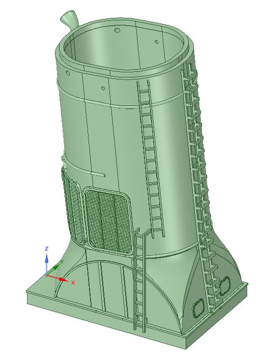

"Luck" is the key word here! Since my last post I've redesigned both the after stack, stack vent covers, and the stack cap/fwd yardarm assembly at least once, making structural changes to ensure that the print comes out as it should. I've now got 2 very good stacks being cured and 2 very good stack cap yardarm assemblies drying. I only need one each, but the spares could always come into play due to clumsiness. One other thing is that I included the intake vent covers as part of the stack itself rather than separate add on parts. This simplified and assured that they would be located correctly. Here is a picture of the stack as it is now configured: When redesigning the intake vent covers, I went to the dimensioned drawing in the TFD FLETCHER Class Plan Book and made sure everything was sized correctly rather than rely on the original Revell kit part which I had done prior. I think this produced a more correct part in the long run.
I also discovered that my custom decals for this model had the draft marks backwards and also a couple sets that I never had made that would actually be needed, so I've reached out on that end of things. I have got the hull numbers in place now, so that's a small area of progress. Once the hull decals are ALL in place, I can move forward with adding main deck houses and equipment - as well, I need to get the display board completed so the hull can be mounted in an upright position.

Excellent progress again. The pieces you have designed for your yardarm are IMO perfect, and the effect will be supreme.
I have to say that after reading this, I ran to my vitrine to check my own yardarm set fearing the worst, but it was not the case. As I had made the stack with cap from the beggining this problem did not arise; had I done the set with the cap alone, I am afraid I would have made the very same mistake.

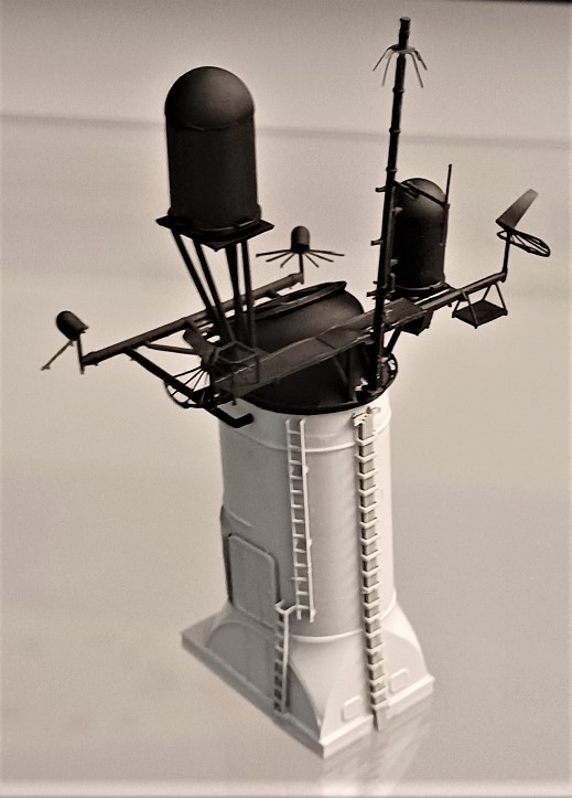

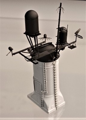

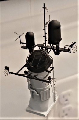

After several print runs and a couple more revisions to the designs, I now have both stacks completed and painted, ready for installation at the proper time. I've intentionally left the whip antennas off in order to keep them from being broken. Here is the after stack in its current state:
I may spend some time using extremely thin dia. styrene rod to create the various curved parts of the cables to their various terminations on the front of the stack - this will be rather tedious work, to say the least!
I forgot to make photos of the fwd stack but will do so tomorrow and post them then.
Currently, I'm waiting for proofs from my new decal vendor and hope these arrive early next week as I'd like to get this phase of the hull work completed and get back to completing the display board & keel blocks as the kit stand is rather flimsy and not all that useful. I've also started cleaning up the new 01 Level 3D printed after deckhouse & Mt. 33 gun tub & Mk. 56 director platform in preparations for painting. So, progress is slow, but moving forward.
