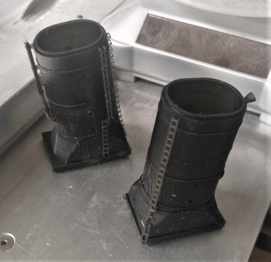

The stacks came out ok - I was surprised a bit. One has a missing upper end to the vent pipe (stack on the left in the photo) so do I reprint or remove and use one of my spare printed ones??? I may reprint as the bottom of the stack bases (both) had a very slight rounding on the corners, due to, I suspect, the way I had them supported. If I do reprint, I'll print directly on the build platform and that will solve that issue. Here be da stacks:
And my current stock of stack caps will fit without having to reprint those. Nothing like small favors along the way :heh:
If I do use these, both of these parts have to be cleaned up a bit - they both had some of the "fuzzies" that I had to scrap off with either my fingernail or a small chisel blade X-acto. Again, not sure why those are showing up, but just a small aggravation.

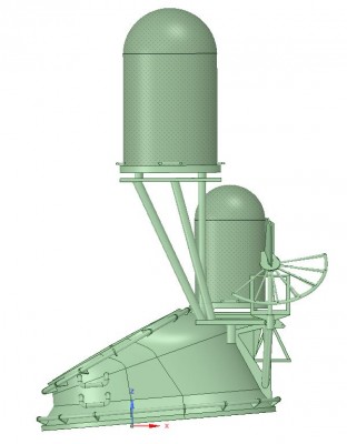

While working on the Fwd Stack, I realized that the current design for my steam whistle & piping didn't quite fit properly. So, after another design change/print and then a 2nd one, I think I have one now that will fit and look fairly accurate -
I pulled both the stack & stack cap into this design file, assembled them together, and then redesigned the piping runs and platform to conform to the angle & shape of the front of the stack & stack cap. This was key to the whole thing.
Printed a few of these items last night and after curing this a.m. will paint and see how they fit!

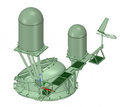

After assembling the after stack with the new stack cap/fwd. yardarm assy., I realized (too late) that I had not taken into account the angle of the stack when I designed the cap/yardarm - thus everything looked like it was bent backwards, even though there's only perhaps 2-3 deg. of tilt to the stack (lookng from the side).
So, this morning I was fiddling around with the part wondering how to correct it and it fell out of my hands on the floor - breaking off the stack cap & yardarm and thus, solving that part of the problem. The cap, etc. is not usable, but it doesn't matter - has to be redesigned. This was an all-day challenge as the parts did not want to "move" so I was forced to create a new file, copy the stack cap alone into it, then copy the yardarm assembly into the new file. The yardarm assembly didn't want to copy as a SOLID, so it came across as a SURFACE which meant I spent all day redrawing the yardarm, instruments, platforms, grating, and both RADOMEs - finishing about an hour ago. I'll reprint a couple of these tomorrow morning and hope that one comes out usable. As usual, I make improvements where possible, and this is in the area of the RADOMEs which tend to collect liquid resin and can be messy. So, hopefully the new design will allow this to drain after printing while drying under the fan. I was able to make a 5.5 deg. angular change to the orientation of this yardarm in relation to the stack cap. I had also pulled in the after stack into the new file to make sure the cap was angled correctly. Here is a side view of the completed part after the SHIP-ALT was completed:
Next, I'll see about fitting the TED Mast to the stack cap - I've got a couple of these printed and this will be a small job in itself getting it located properly. I may actually get it located & cemented in place and then spray the entire stack cap/yardarm & mast flat black at one time - just needs a light coat as the black resin saves on using a thicker coat of paint.

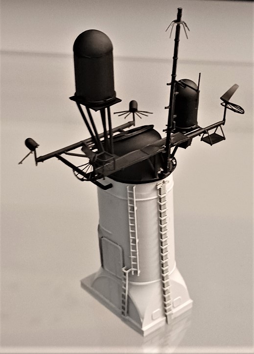

After several print runs and a couple more revisions to the designs, I now have both stacks completed and painted, ready for installation at the proper time. I've intentionally left the whip antennas off in order to keep them from being broken. Here is the after stack in its current state:
I may spend some time using extremely thin dia. styrene rod to create the various curved parts of the cables to their various terminations on the front of the stack - this will be rather tedious work, to say the least!
I forgot to make photos of the fwd stack but will do so tomorrow and post them then.
