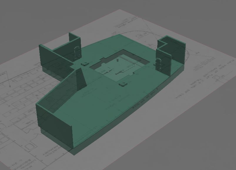

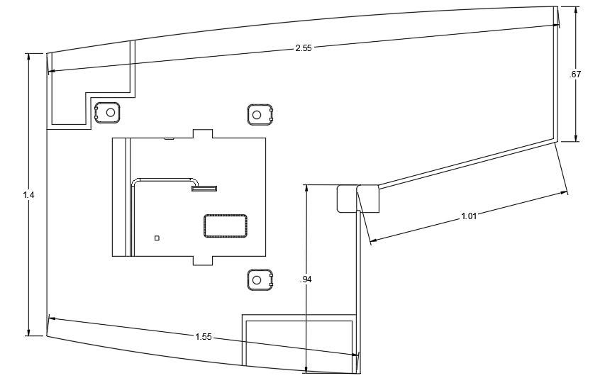

David,
Here is some info from a stalled project that I was working on for the VF kit. These dimensions are based on 1/350 BOGP's, not dimensions of the kit and are in inches. Have not acquired one yet to see how it would fit into the hull.
HTH

Matt, thanks for the reference to the Miami CL89 Booklet of General Plans. I took your six dimensions and converted them into millimeters for the VF Cleveland:
1.4 = 34 mm
1.55 = 39 mm
.94 = 23 mm
1.01 = 25 mm
.67 = 16 mm
2.55 = 63 mm
with bulkhead height from 3rd deck to main deck = 16 mm
These measurements are rounded off, but close enough to construct a hangar bay below the hangar hatch.

Keep in mind that the Miami was a second generation square bridge Cleveland class ship. There were a number of modifications from the original Clevelands, especially in the superstructure, forward and aft.
I think the hanger was enlarged from the original Clevelands somewhere along the line, but I don't recall when right now.
