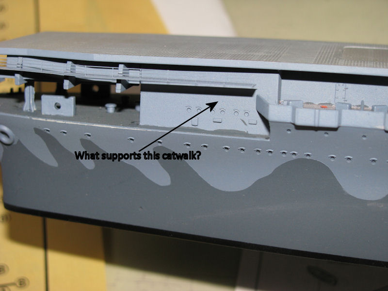

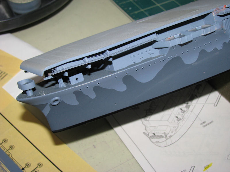

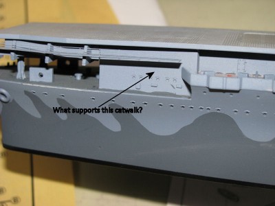

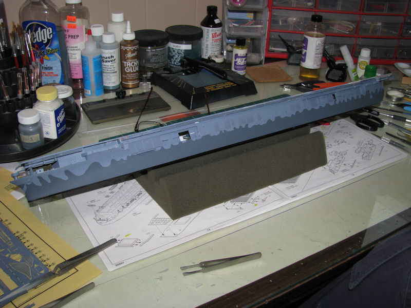

While my King Edward VII pre-dreanought waits to be painted, I started doing some more work on the Trumpeter Hornet. I've most of the catwalks on, but I have a question about the two catwalks at the bow - the Gold Medal photo-etch replacements dangle out into the air between the bow and the forward 5 inch gun emplacement. What holds these up on the real ship? I've dry-fitted the port side catwalk but don't want to fit it until I figure out the answer.
TIA...

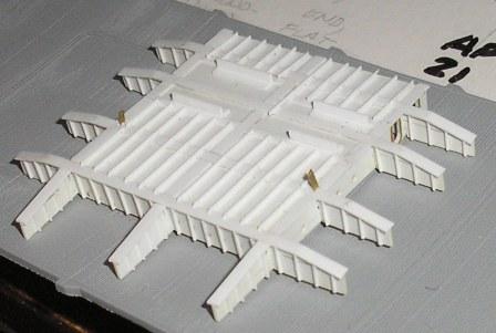

Here's a picture from Navsource of CV-5, best I could find.
The ends of the big deck frames have those interesting looking triangular plates with lightening holes. It looks like the walk goes under them. Theres also more of them (maybe five of six) than on the model.
I wish I knew more as eventually I'll be faced with it too. Does the model walk fit against the hull? It almost seems to me, and it would take a picture of Hornet to show, that the big beam ends on the model, if that's what they are, are too deep and are holding the walk away from the hull. I'd like to see, too.

After combing through Wipers Yorktown class book and the Warship Data book on Hornet's loss, it looks like Yorky and Enterprise had posts by holding up the catwalks where they terminate at the forward end of the 5 inch gun galleries. For Hornet, it appears (to me) from photos that the catwalks ended right on top of the splinter shielding. However, in the Trumpeter kit, they don't reach the height of the splinter shields, they are higher. I've decided I'll put some plastic strips under the catwalks to give the appearance that they are attached to the hull.

MartinJQuinn wrote:After combing through Wipers Yorktown class book and the Warship Data book on Hornet's loss, it looks like Yorky and Enterprise had posts by holding up the catwalks where they terminate at the forward end of the 5 inch gun galleries. For Hornet, it appears (to me) from photos that the catwalks ended right on top of the splinter shielding. However, in the Trumpeter kit, they don't reach the height of the splinter shields, they are higher. I've decided I'll put some plastic strips under the catwalks to give the appearance that they are attached to the hull.
Martin, the catwalk structure, aside from the wider squared off corners at the front ends, was very similar to Yorktown and Enterprise. There are several support beams along the way that connect to the main flight deck girders, which are missing on your model. You'll need to build these out to the edge of the flight deck and then do some scratching for the catwalk support beams. This shot should help. Note the shadows and sunlight that reveals it is not connected to the hangar deck bulkhead.

MartinJQuinn wrote:While my King Edward VII pre-dreanought waits to be painted, I started doing some more work on the Trumpeter Hornet. I've most of the catwalks on, but I have a question about the two catwalks at the bow - the Gold Medal photo-etch replacements dangle out into the air between the bow and the forward 5 inch gun emplacement. What holds these up on the real ship? I've dry-fitted the port side catwalk but don't want to fit it until I figure out the answer.
TIA...
Martin, where did you come up with that foam form your Hornet is resting on? That looks to me like just the trick for steadying a larger 1/350 scale ship while you work on her. The vise I use for DDs and other smaller ships isn't practical for something like Hornet or North Carolina. Did you cut that out of stock foam yourself or find it pre-formed?
Bob
Posts: 8648
Re: Calling all USS Hornet CV-8 fans
Pre-formed, from Micro Mark. It's made for railroad stock!

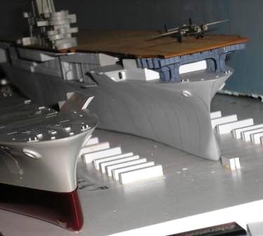

John W.
Posts: 518
Post by John W. »

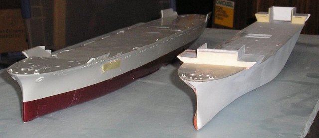

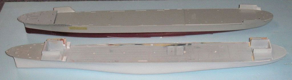

rtwpsom2 wrote:Can you compare the 2 when you are done so we can see whats wrong on the trumpy kit?
Here's a quick look of pictures posted earlier in this same thread about page 11 or so. Believe it or not, the angle of these photos makes the Trump hull look much closer (!!!) than it is.
Unfortunately, as many have said many times, the hull is only the beginning, not the extent, of the problems. Some are blessed with the ability not to sweat the details as much as I and some others (and you know who you are . . .). More power to those who press on and do a good model of a great ship. I can tell you that being a stickler for detail on this particular ship model has probably made the work at least fifteen times as hard, maybe more, than just going with the kit and the directions. Still, though I must put it down sometimes for months on end, I continue to pick it up and get back on it when I'm ready. Wait until you start doing the flight deck supports with those freaking steel beams with the stiffeners . . .

MartinJQuinn wrote:Pre-formed, from Micro Mark. It's made for railroad stock!
Martin, thanks for the info. Looks very handy indeed. Appears I need to visit Mirco-Mark. Just got their new cataloge and I saw a couple of other handly looking items as well.
