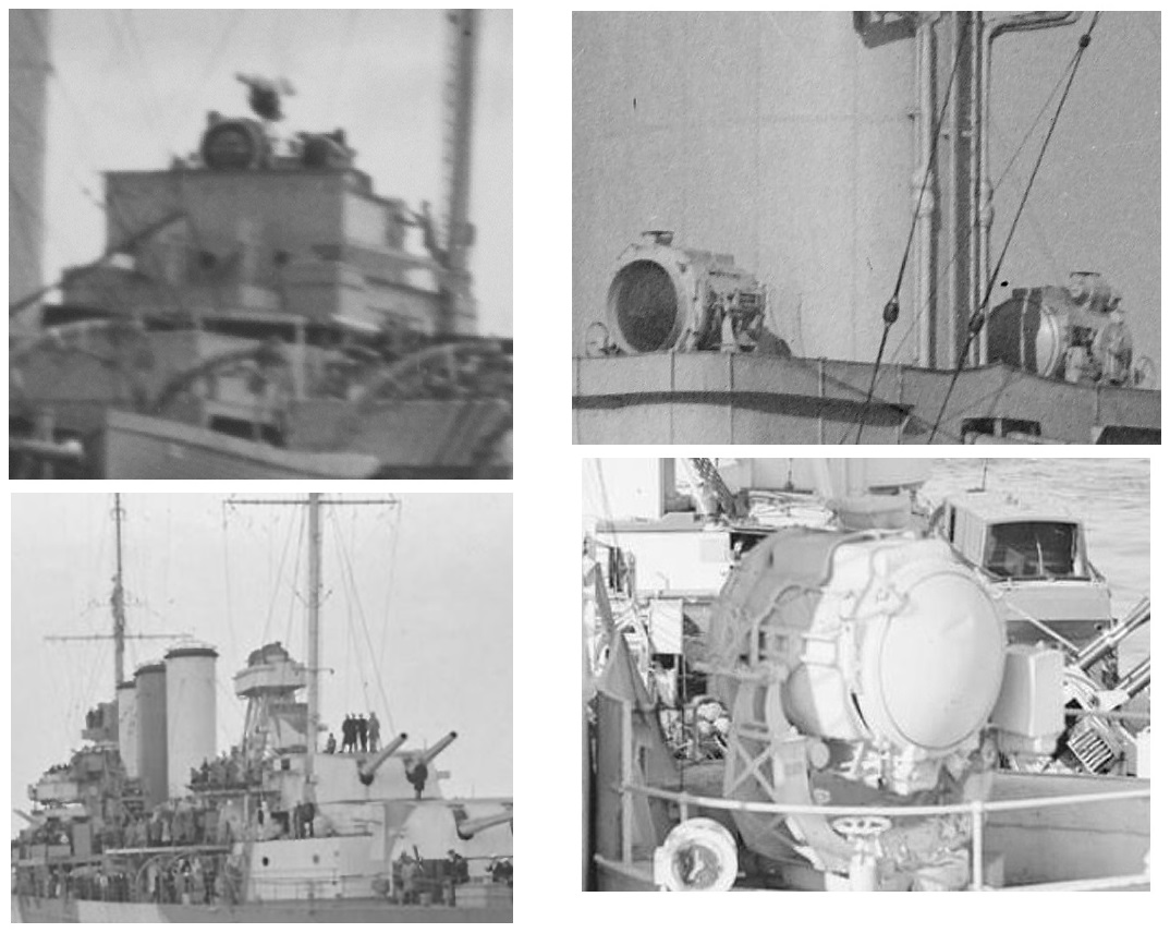

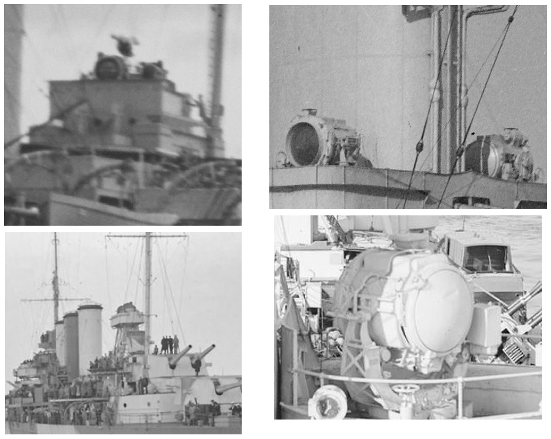

HMS Kent search lights
Gathering ideas for my future Trumpeter 1/350 HMS Kent build, I�m rather excited about the Micro Master detail parts ,thinking of possibly replace the stock search lights with MM pieces. But have no idea which size to use ,I�m seeing 24�36� and 44� the last probably to large,no idea as to where I can locate this information�.Any help greatly appreciated�
- Brett Morrow
- Posts: 346
Re: Calling all RN County class fans
Kent as built was fitted with 36" S.L`s, after refit when the S.L tower was fitted she still carried 36" but they appear to have been a later Mk / or retrofitted with new fan motor assy. When the RDF lantern was fitted/modified platform those S.L`s were repositioned side by side. The position of the cooling fan motor assembly on both Mk`s indicate the size S.L. Unfortunately MicroMaster do not produce this size S.L. (their WWI 36" is not the correct Mk for Kent)
The only manufacturer I know of, producing this Mk in 1/350 is NorthStar. There could be others.

Wish to know what type of DCT�s HMS Kent was fitted with in 1941. Might wish to upgrade the one�s on my TRUMPETER 1/350 during the build with a 3D units possibly from Micro Master if available�.
- Brett Morrow
- Posts: 346
If you were planning to use MM parts, the pieces available/applicapable for Kent 41 would be the Mk XXI DCT (Pg 1) forward (excluding 284 parts) and the 8" refit DCT (Pg 4) aft. Not sure on the HACS turrets, refit plans from Greenwich would suggest Mk I (judging by O/H turret shape) but I neither have these plans in Hi Res nor image reference in sufficient resolution to verify that to be correct. Perhaps someone has a listing.
