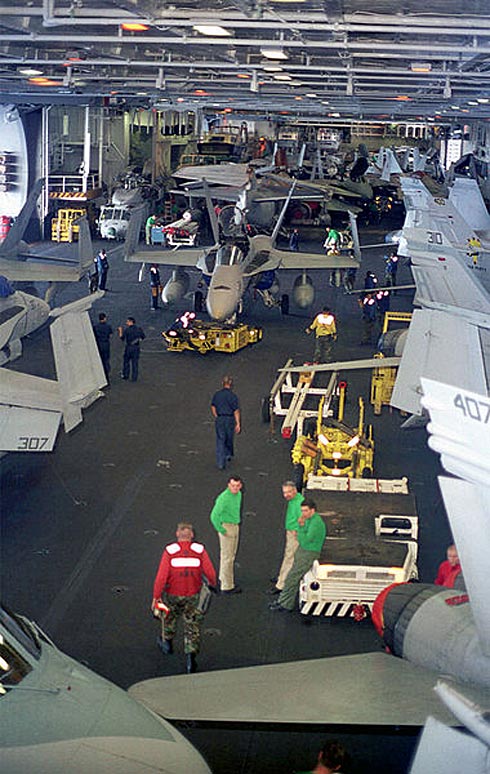

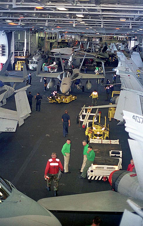

Now I am getting bogged down in the hanger details. I have a bunch of deck tractors on the way. I do not have a lot of data on where the Conflag stations are going to go either. It appears that there is one about half way between the dividing doors and L-4. I guess there is one half way in the forward bay.
I am also building the fork lifts from the MRC set.

Boy does that ever sound familiar!!! You can drive yourself insane trying to find hangar details! I'd comment on the airwing, but whatever server you have the pictures on is blocked from my work computer, so I can't see em!

Hey Mark,Mark McKinnis wrote:Thanks guys!
Mark
Might be able to help you out with the conflag station in the hangar bays, there are two in both bays, Bay 1 has one just forward of Ele. 1, overseeing the GSE area and helo spots in the bay, the second is mid bay 1 directly across from Ele. 2.
In bay 2, there is one just forward of Ele. 3 over the Weapons elevator, and the is one aft of Ele. 4 Overseeing the jetshop area, also, most folks do not realize that hanger deck control is in bay 2 on the O-1 level directly aft of the divisional doors, actually butts up to the steel bulkhead that houses the divisional doors. there is a balcony and straight ladder to the deck from the balcony as well as a window that looks aft toward the jet shop.
Hope this helps my friend, oh, yeah also these conflags are triangle style and can only hold one person inside to moniter the bays, there is only one window on each side of the conflags as well, totally different from the Kennedy and the Nimitz Classes.
Again hope this helps.
Jim

Hey Mark,
The best tip I can give you is for the width of the hangar bay (Bay 1) it is only a couple of inches wider then the wing span of an E2-C HAWKEYE, I know for a fact that it is only 6 inches wider on each side from the center line. I know this is true since I am the only ABH in naval history to do a wing spread of an E2-C in the hangar bay of a non-nuc aircraft carrier, I did this on board the Kennedy in 1997. the hangar bay is 101' wide at the divisional doors. As soon as I complete the line drawing from the weegee board from hangar deck control I will forward you a copy.
