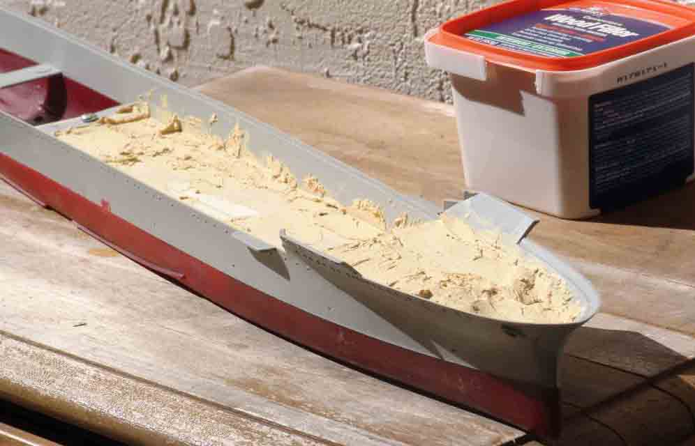

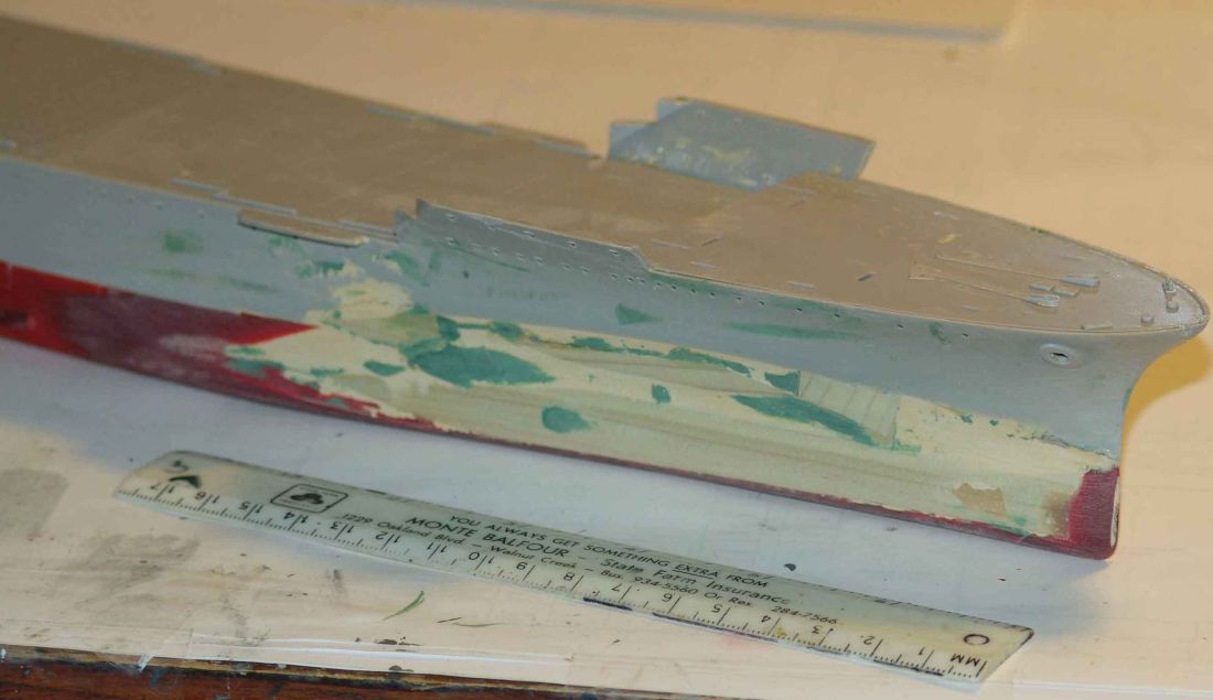

Hi Hornet fans,

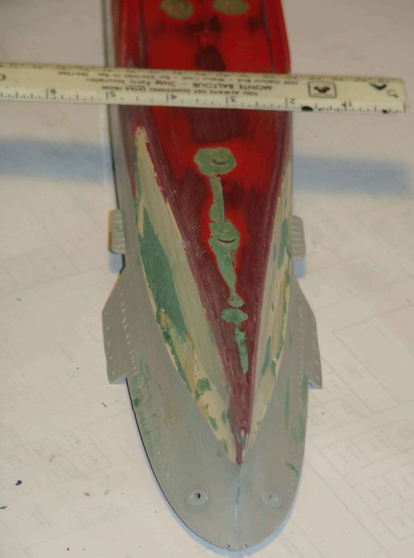

I am nearing the completion of my 1:350 Trump Hornet (after major modifications to the forward third of the hull -- more on that in a subsequent posting) with both GMM photoetch sets and now am turning my attention to her air wing. My model will show the ship as she appeared at the start of the Battle of Santa Cruz in October 1942; I have removed the catapult sponsons and added the bow quad 1.1-in. mount (without rangefinder) with a modified splinter shield. What combination of letters and numbers would I use on the fuselages for the Dauntless divebombers, Wildcat fighters and TBD/TBF torpedo bombers? I have a healthy selection of number and letter decals. Thanks for your advice.

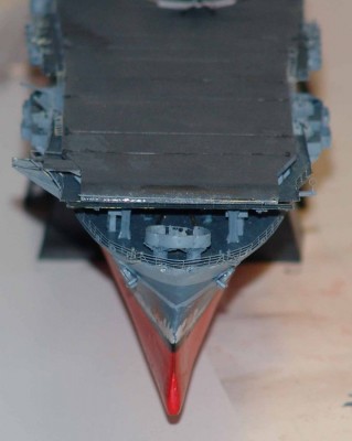

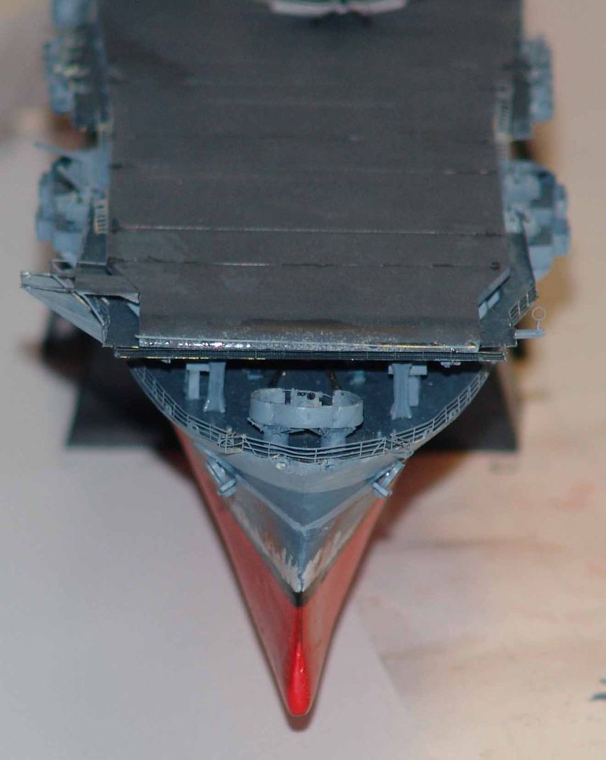

Hi Hornet fans,

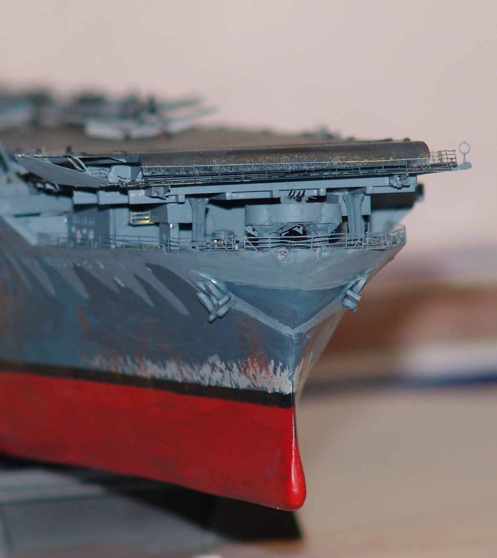

I am about 98% finished with my Trumpeter 1:350 USS Hornet (still awaiting delivery of the last quad 1.1-in. mount and additional 20mm Oerlikons from L'Arsenal USA) but thought I would post some photos of how I solved (or, at least, moderated) the serious problem of the misshapen forward third of the hull. My solution, which did not fully rectify Trumpeter's awful tubby shape, was to cut a slab of solid hardwood (poplar, in this case -- cheap and closed-grain) roughly in the existing shape of the forward third of the lower hull, place a shorter piece atop it for the bow forward of the flared 5-in. gun mounts, and then fill in around between the wood and the plastic (now with the upper hull glued to the lower hull) with Elmer's Wood Putty. This material is cheap and easy to use and can take a high polish when sanding. Once everything had dried and I had secured the lower hull to the wood by a series of screws along the centerline keel, I then proceeded to use belt sanders to abrade away the lower plastic hull except for an eventually much narrower strip along the keel, constantly adding green modeling putty and hand-sanding to assure a relatively smooth transition from plastic to poplar to putty. I was helped by cutting out a keel template copied from the 1:350 diagram in AJ Press' Yorktown/Enterprise/Hornet publication (by Andrzej Perepeczko), though I chose not to narrow the keel as much as I could have since I felt that this would only accentuate the shortcomings of the remainder of the hull, which would have required a major effort to accurately depict. At least this way, I achieved the narrow cutwater, bottom bow bulge and flared forward hull that I wanted. Once it's finished, I'll post complete photos of the model on ModelWarships.com.

Nice improvement!
