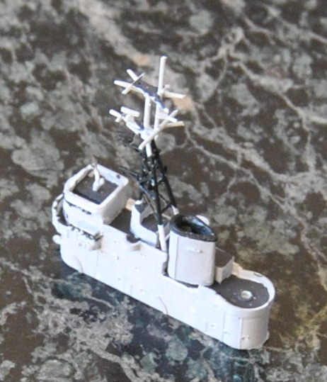

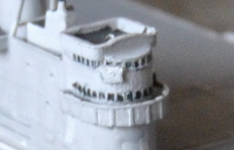

For my korean war HMS Glory the main changes will be to the island. I have glued in the very nice bridge from shapeways to the island structure and I have built the mast and platforms. This mast has some excellent engineering. It is much easier to do than Flyhawk tripod masts and had the carpet monster not taken the all important part C88 this would have been a quick build indeed. As it was I had to replace that part in .3mm brass. I also redid one of the platforms as it had a different radar in 1952.
Conclusion after about three days' work: very nice kit. Accurate according to my drawings of Colossus and Venerable. In terms of buildability it is closer to Bandai than to Flyhawk. I like that.

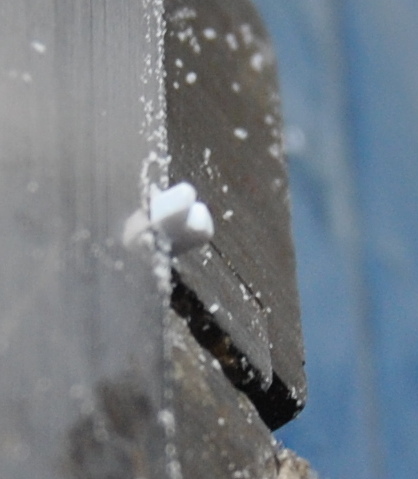

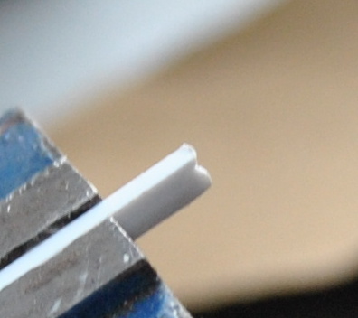

And now the fun part for the day. The youtube videos of HMS Glory mentioned earlier show some really nice footage of small streamlined deck tractors re-spotting airplanes. While I will not be doing that specific scene the deck does need some tractors. Some internet research came up with 'Clarkat B's with broadened wheel bases'. L'Arsenal gives you some tractors which are the right size (2.5mm in length) but not streamlined at all. So I decided to scratchbuild a few. I first sanded a strip of evergreen 8610 into a half-oval shape.
Using a small file I opened the 'driver seat'.
The tractor was removed from the strip using a micro saw.
And back wheels were added using.5mm brass. The front wheels are hidden under the front of the tractor.
So these are my prototypes. I think the right one came out best. I will be doing more of these.

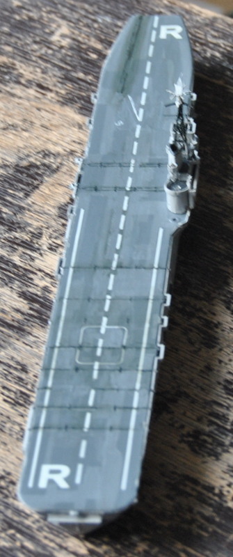

The yard has been smelling of paint lateley. Glory now has its decals on. As some of my old L'Arsenal decals broke apart when applying them you are looking at a combination of IHP, L'Arsenal and Aoshima decals.
Typical of Korean War era British carriers flight decks is the way they weathered. It looks like a combinations of multiple slightly different colored panels. The effect is most unlike the weathered stained wood of US carriers of the period.
In order to 'get' this effect I started with masking off panels on the deck while looking a pictures in order to get the pattern right.
These panels were brush painted in tamiya neutral grey with some drops of white added to it.
After the masks were removed it looks like this.
After this was dry I started adding black washes and painting the barriers and cables. Using thin white paint I re-painted some of the deck markings as this seems to have been happening on the real ship all the time.
This is far from finished, I hope to do more weathering and repainting over the weekend.
