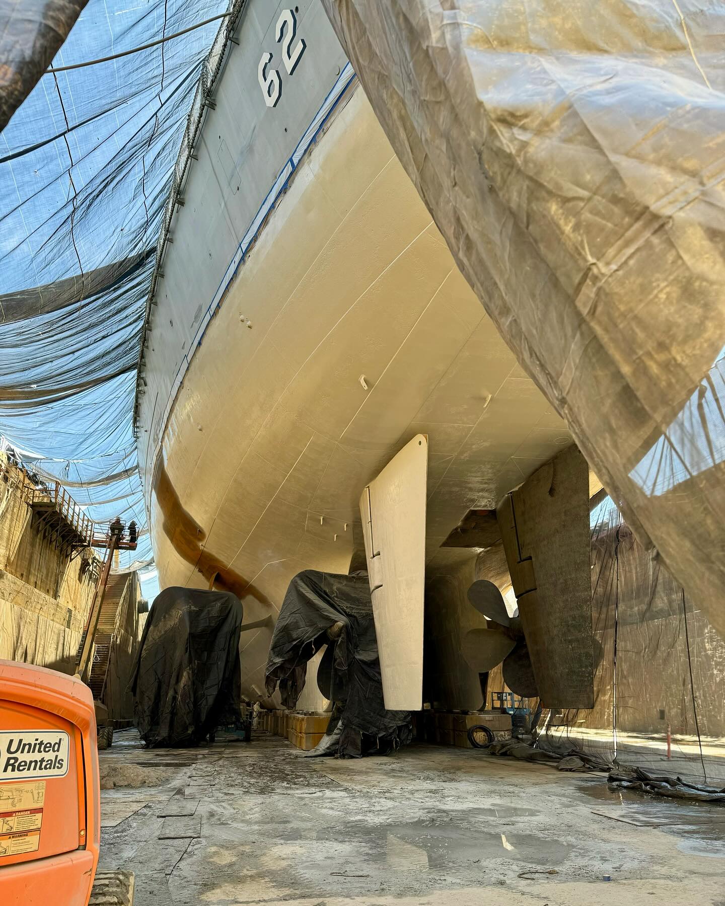

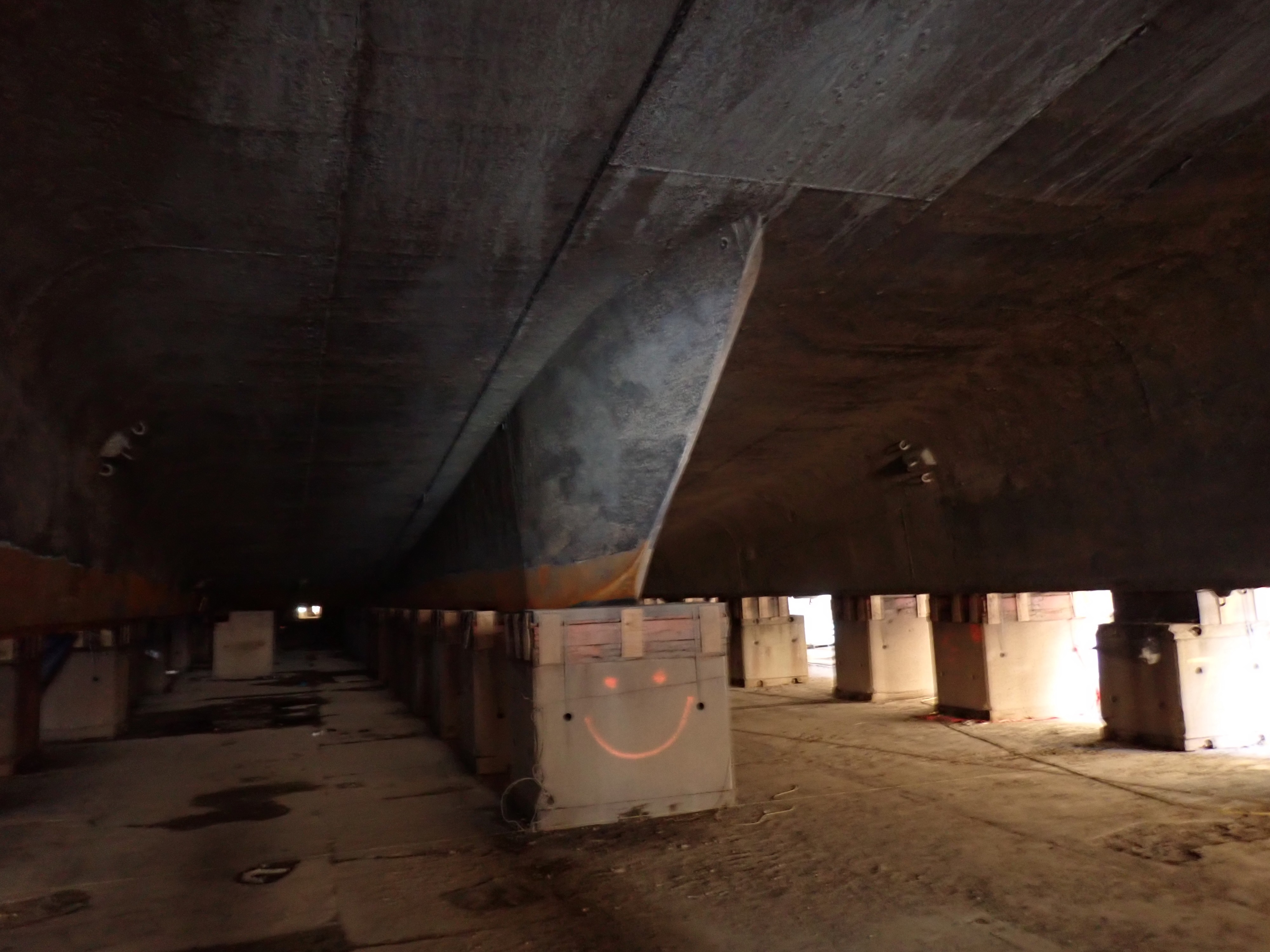

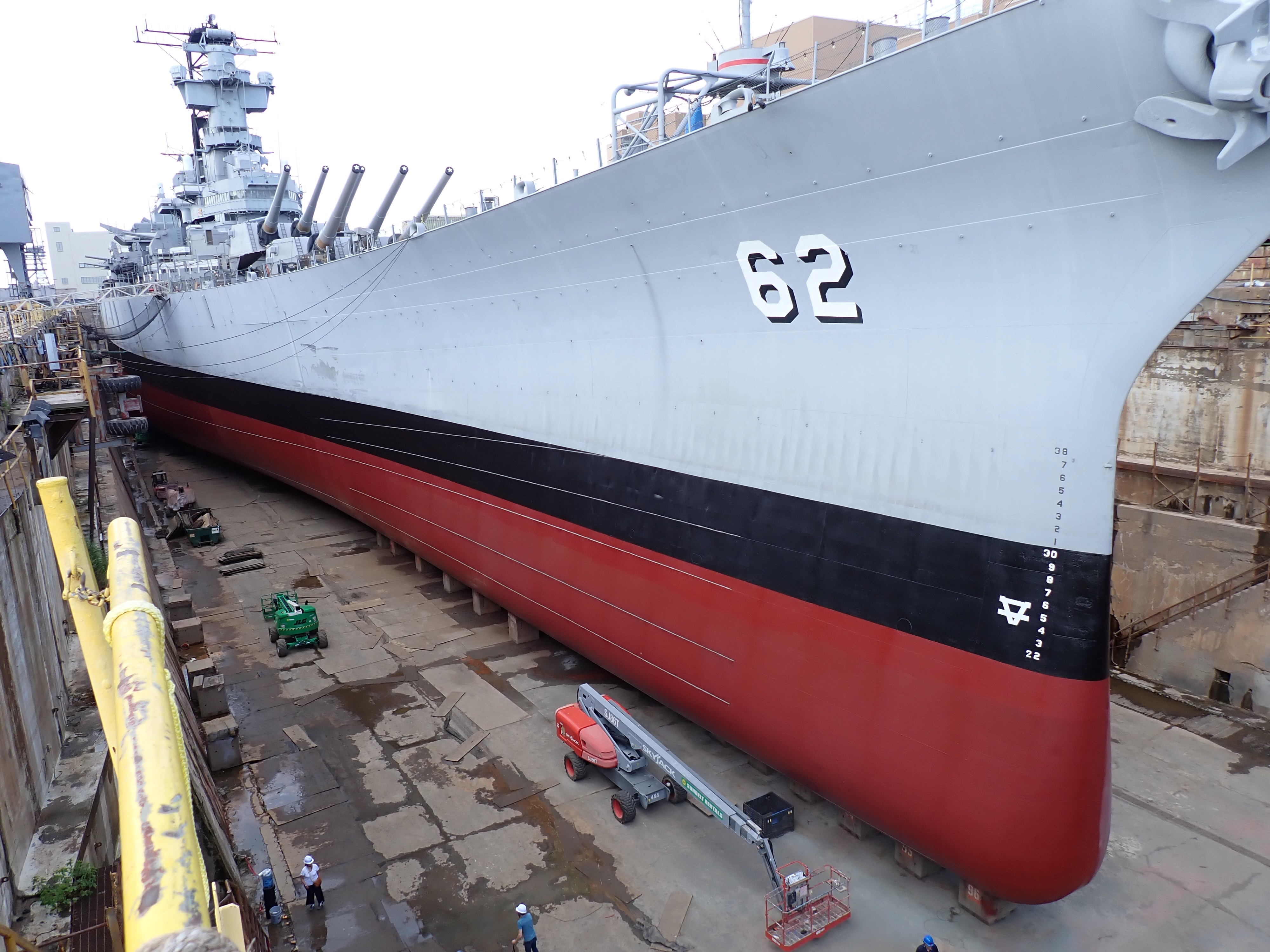

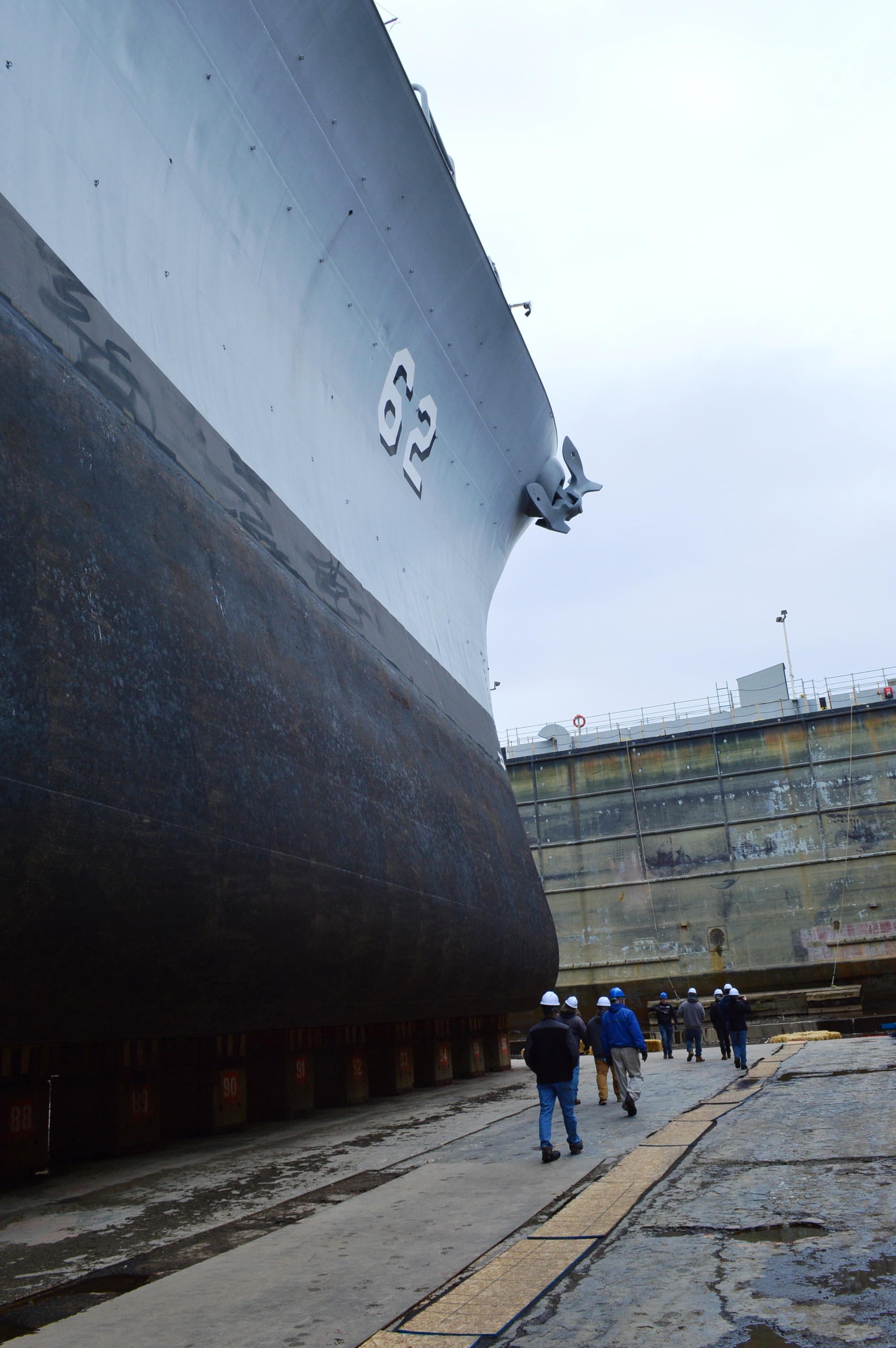

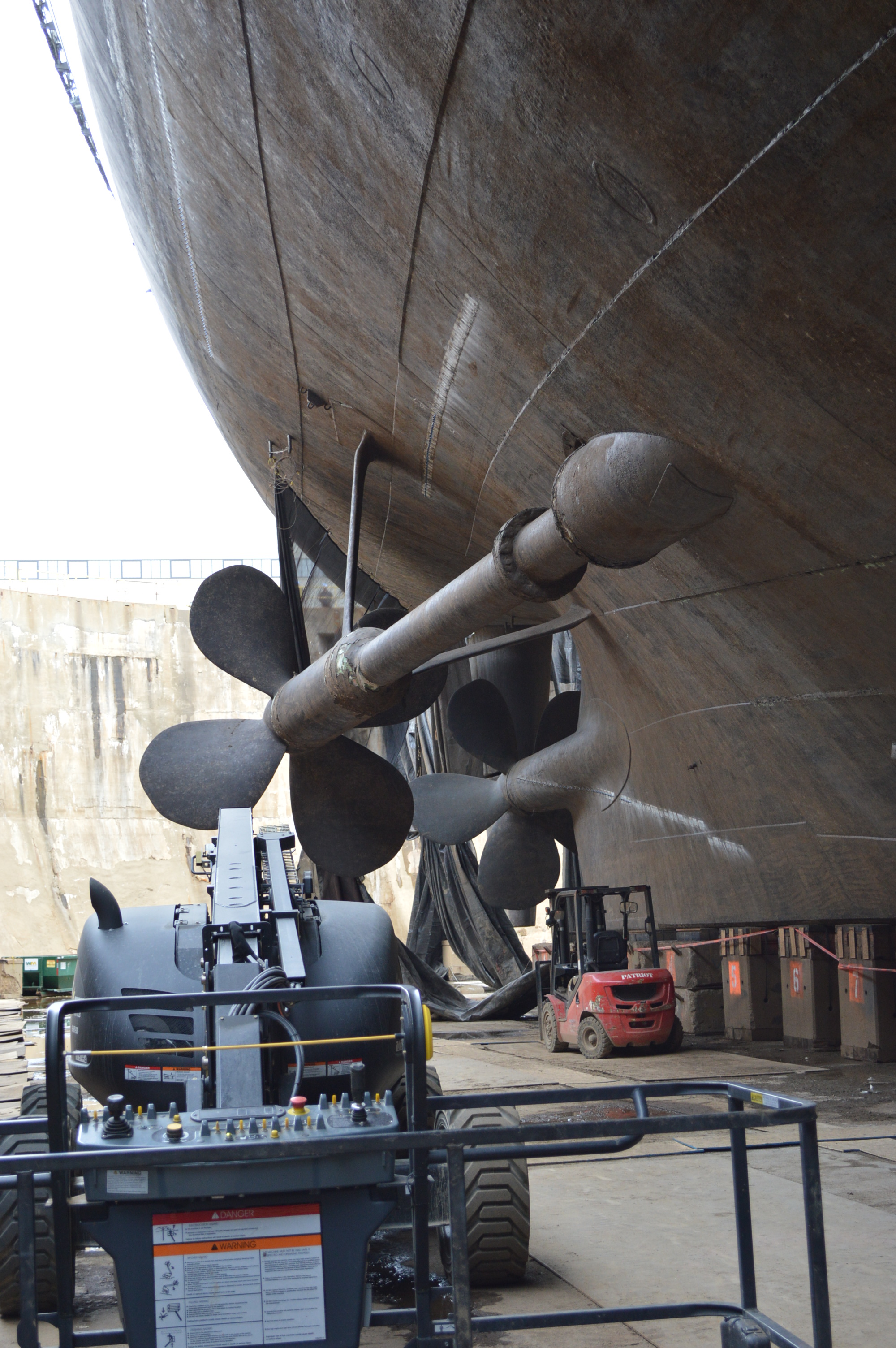

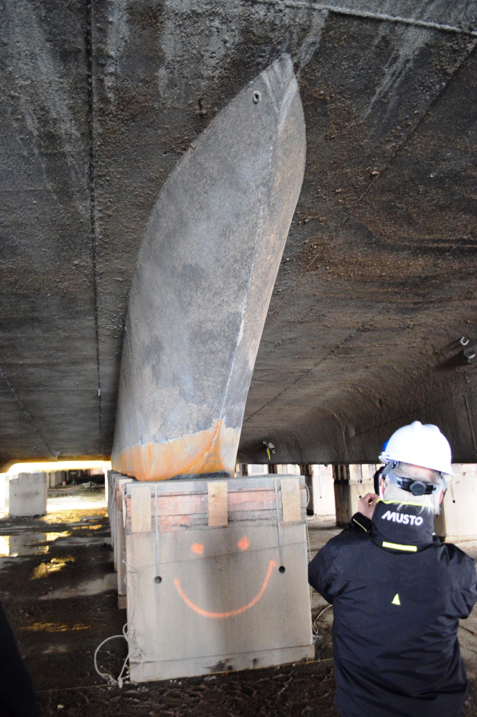

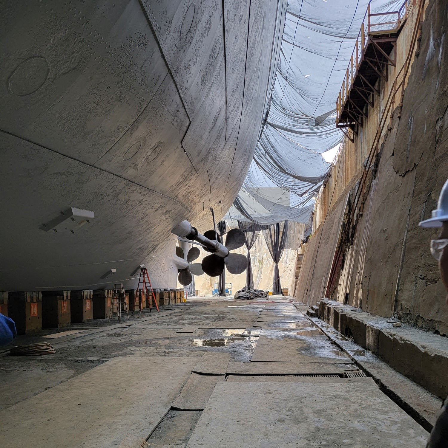

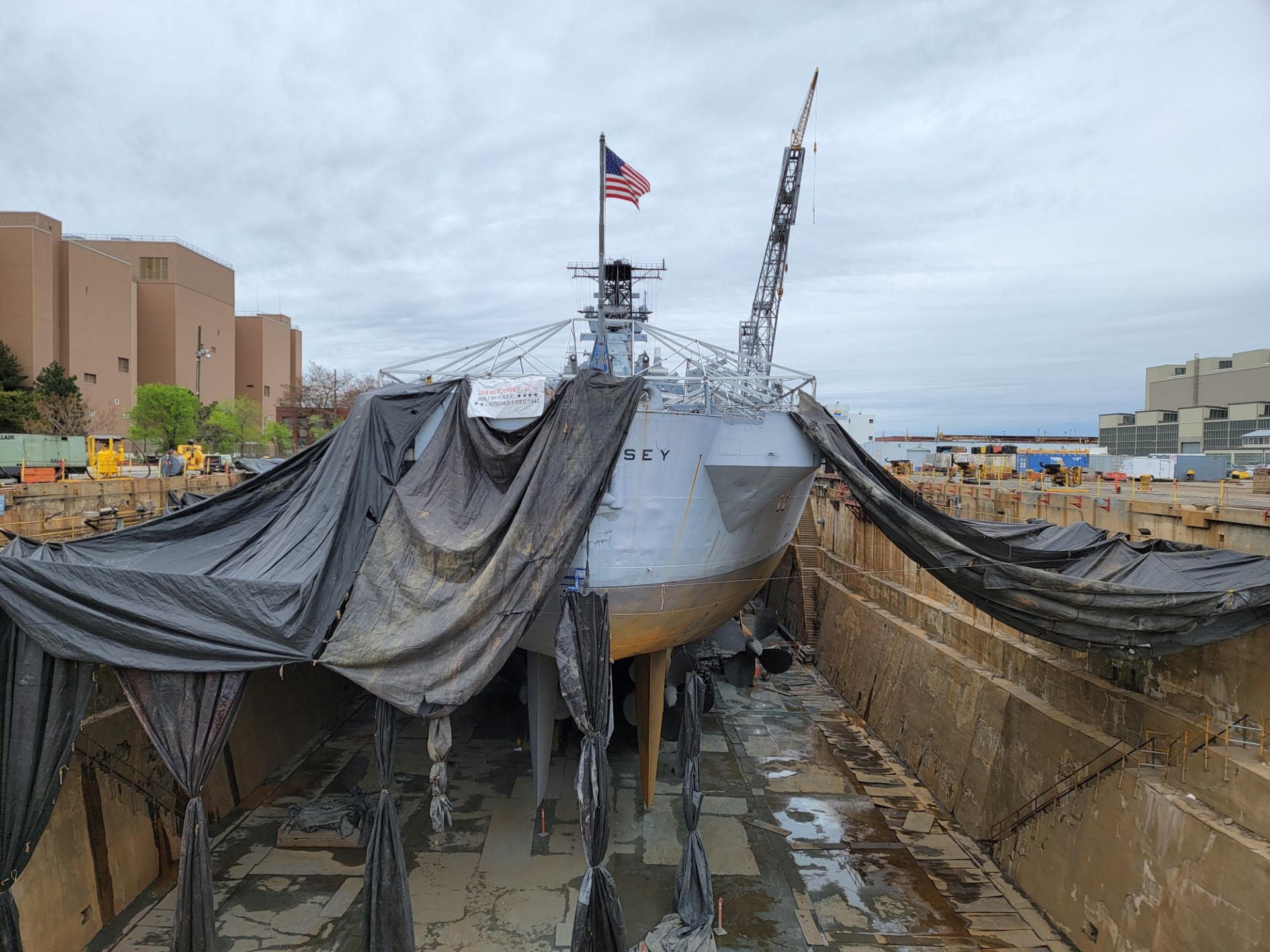

Drydock tour photos posted on the MW FB page. Here's a few of the photos:
If you can get to the Philadelphia Naval Yard, the tour is well worth it!
- BB62vet
- Posts: 3162
- Location: Mocksville, NC

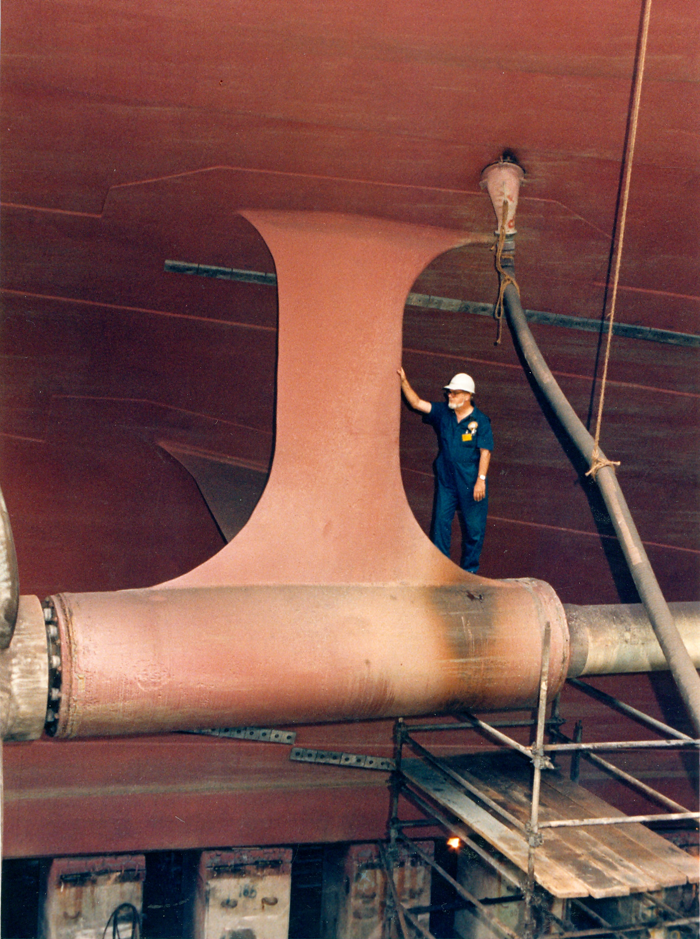

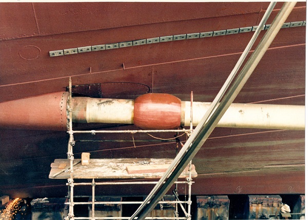

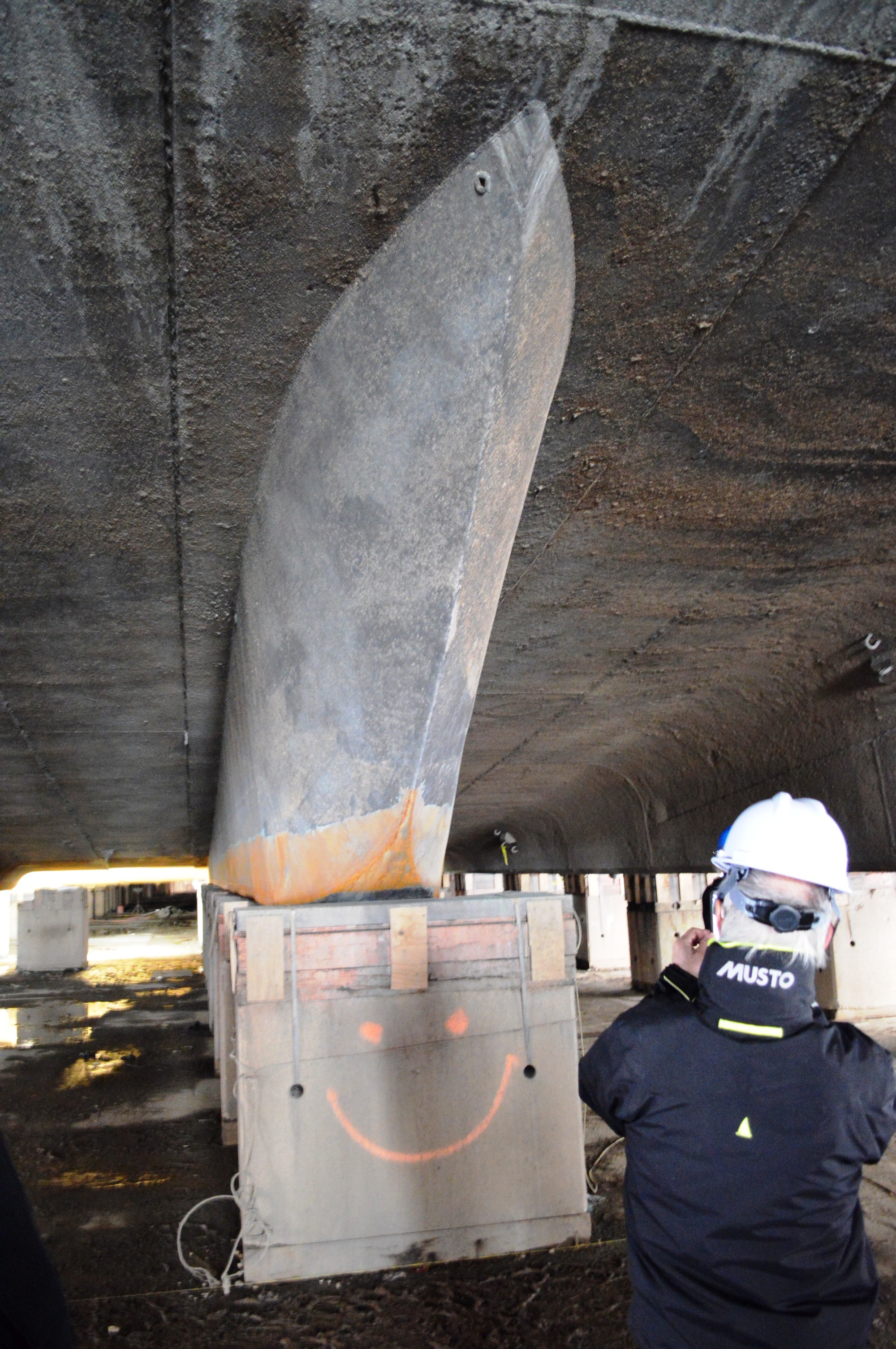

Martin,

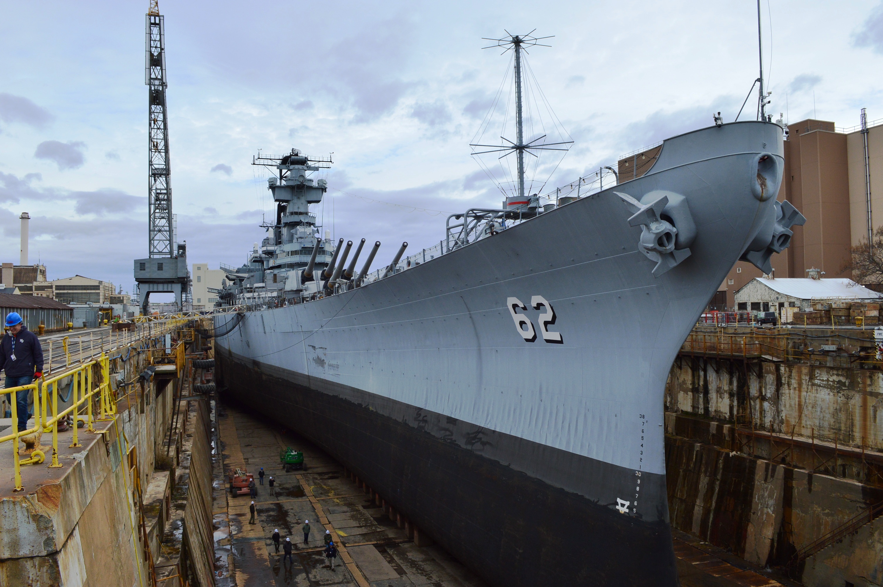

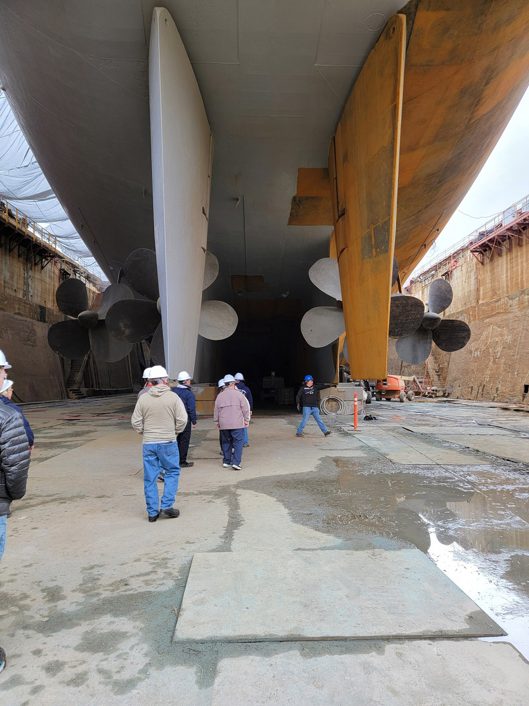

Thanks for sharing!! Great Photos! I'm glad you included a shot of the ever elusive Docking Keel - that obscure item that befuddles most modelers.

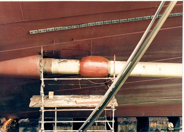

For comparison, here's a couple photos of BB-62 in drydock in 1981 (Long Beach) - my friend Richard Landgraff (now deceased) is standing on the stbd. shaft. These also show the corrosion coupons installed on the ship at the time.

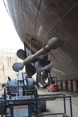

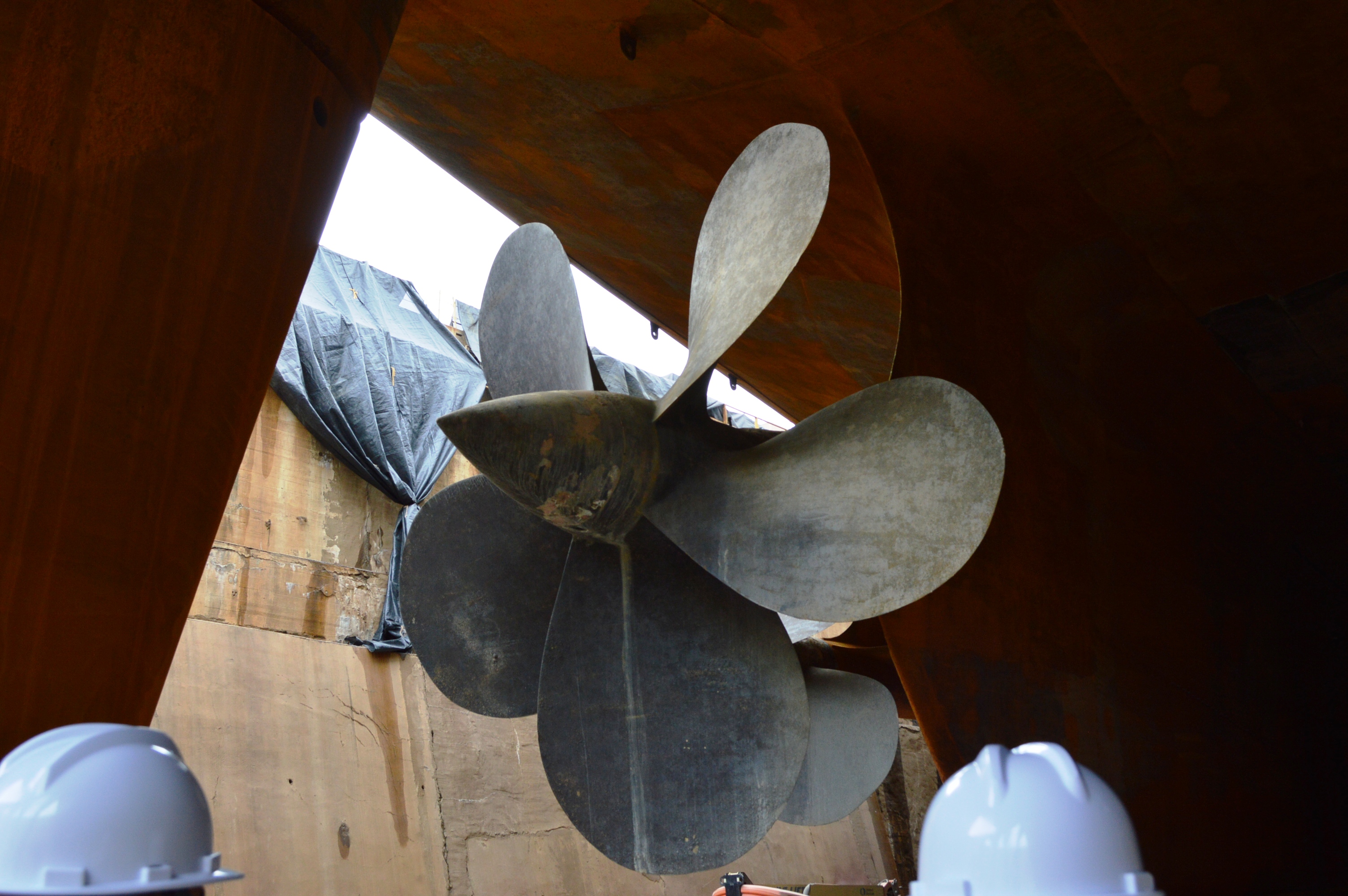

FFG-7

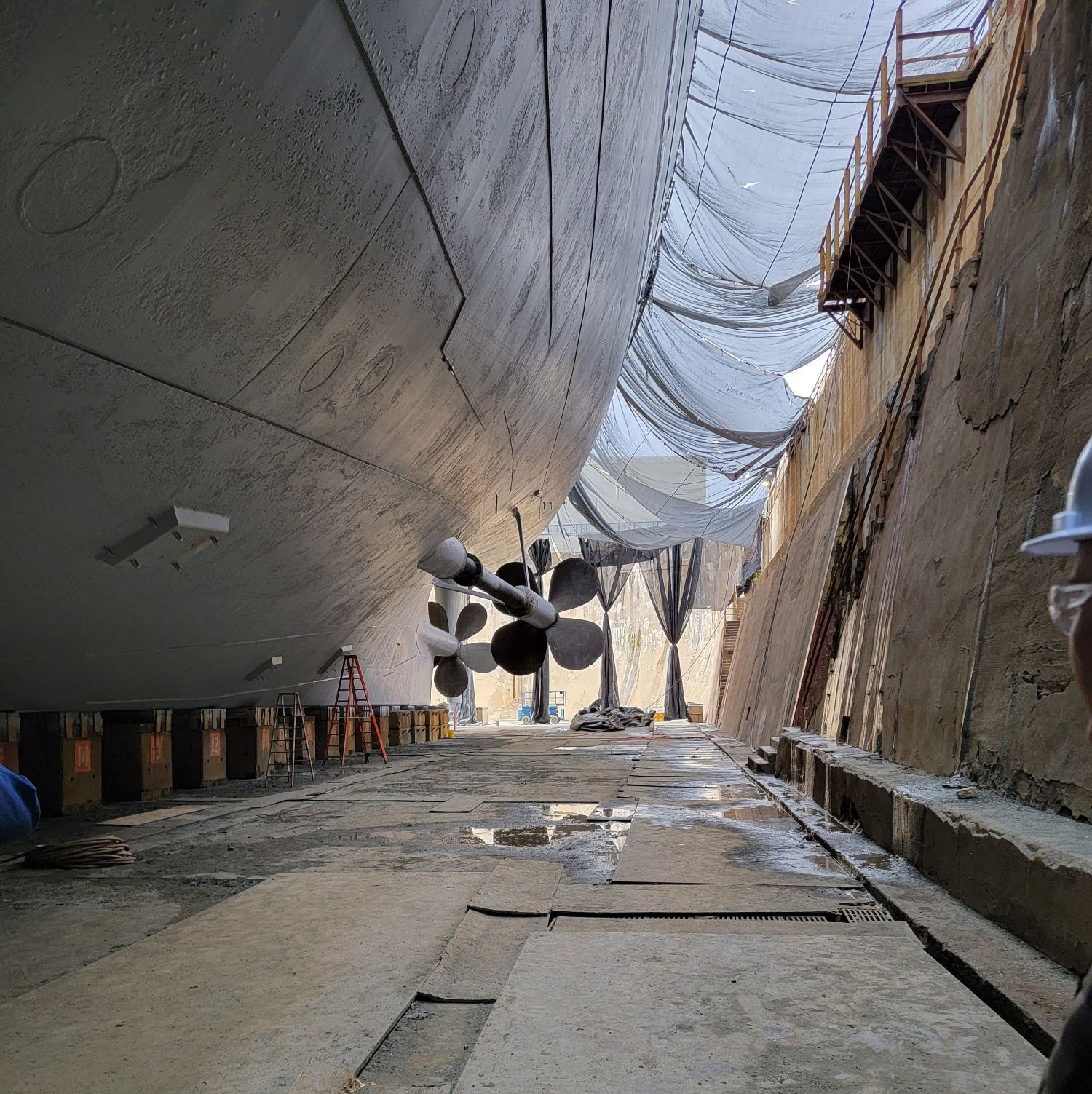

- Posts: 733
why are the prop shafts a different color then the hull as would have thought both would have been the same color?
bigjimslade
- Posts: 463
I suspect the shafts were removed. Documentation shows the bearings in the struts were wood from post WWII to the 80's. Then they were replaced with a phenolic. That would have required removing the end section of the shaft.FFG-7 wrote:why are the prop shafts a different color then the hull as would have thought both would have been the same color?
The fairwaters on the shaft joints are not in place. They may be in storage on the ship.
Brand new camera:
- BB62vet
- Posts: 3162

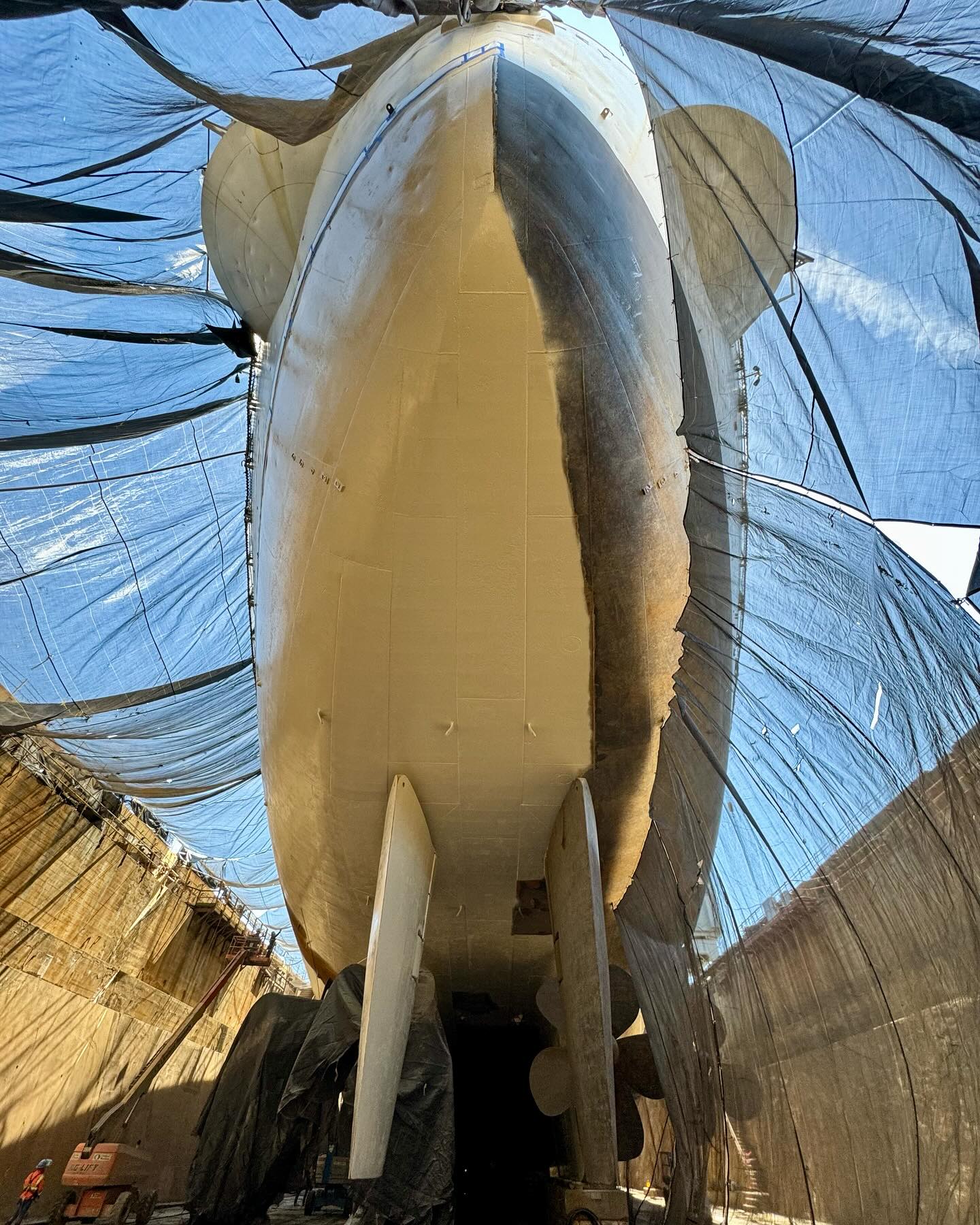

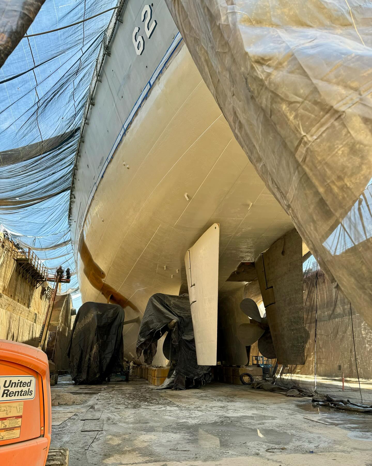

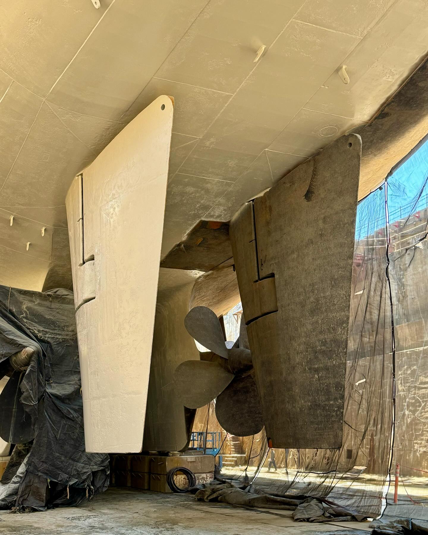

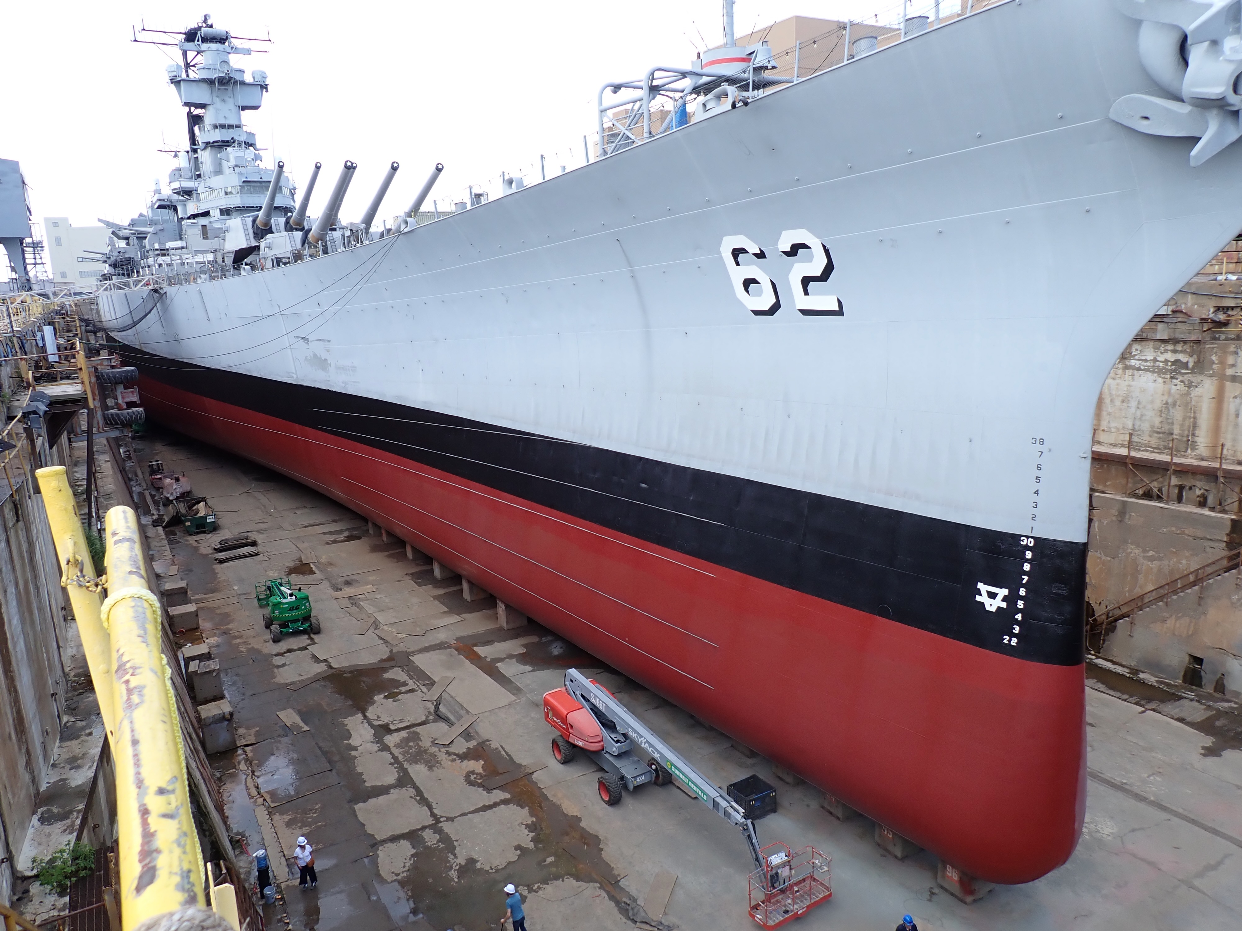

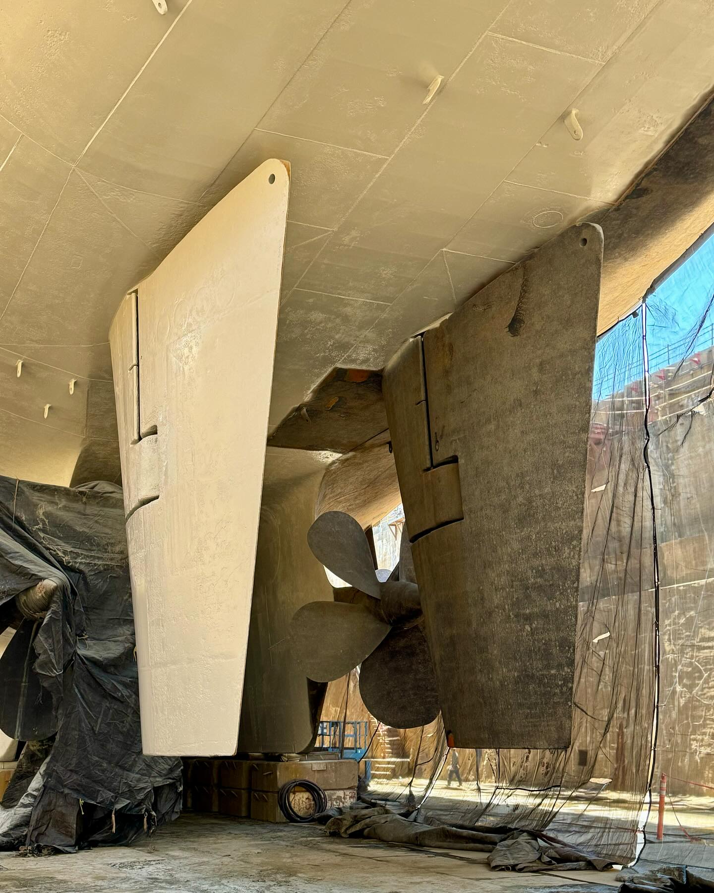

Here are the latest photos of NEW JERSEY's hull with the first new coatings being applied -
I'm sure that Ryan Syzmanski (curator) can better explain what this coating is and why it was chosen. Unless, of course, they got a deal on surplus M1 Abrams Tank Desert Tan from the U.S. Army paint depot.....
My thanks to the USS NEW JERSEY Museum for giving me the "okey dokey" to post the photos
bigjimslade
- Posts: 463
It's a primer coat. Each layer is a different color so that the painters can see where they missed. The last coat is anti-fouling red.BB62vet wrote:Here are the latest photos of NEW JERSEY's hull with the first new coatings being applied -
I'm sure that Ryan Syzmanski (curator) can better explain what this coating is and why it was chosen. Unless, of course, they got a deal on surplus M1 Abrams Tank Desert Tan from the U.S. Army paint depot.....![]()
Oddly, there was no anti-fouling paint perviously. They had just taken the boot stripe all the way down so the bottom was black.
You should get up there and see it!
- Admhawk
- Posts: 959
Prop shafts are covered with a four layer system that includes fiberglass as the final layer.
These coatings are best applied on a lathe in a machine shop, facilitated by the removal of the shafts.
They are designed to last 15 years, so may not be applied at every drydocking.
Anti Fouling and Anti Corrosion coatings are multiple layers as well and consist of grey, black and red coats.
The first coat you see above is very close to a light ghost grey. I've seen it in person. The photos are not showing the true color.

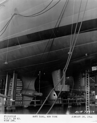

FFG-7
- Posts: 733
what are those small fin like things pointing down from the hull just forward & back of the rudders?
- BB62vet
- Posts: 3162
BJS - I wish I could, but right now time, distance, and $$ are at a premium! Thanks, Brandon!!!bigjimslade wrote: You should get up there and see it!
The small items are tie off points put there when the ship was built - here's a shot of MISSOURI under construction showing those same steel tie-offs - See the small holes in the top of the rudders??? Those are used by Snipes at low tide for attaching tow ropes for water skiing - GM's would ride shotgun in the whaleboat behind and keep an eye out for sneaky snakes!

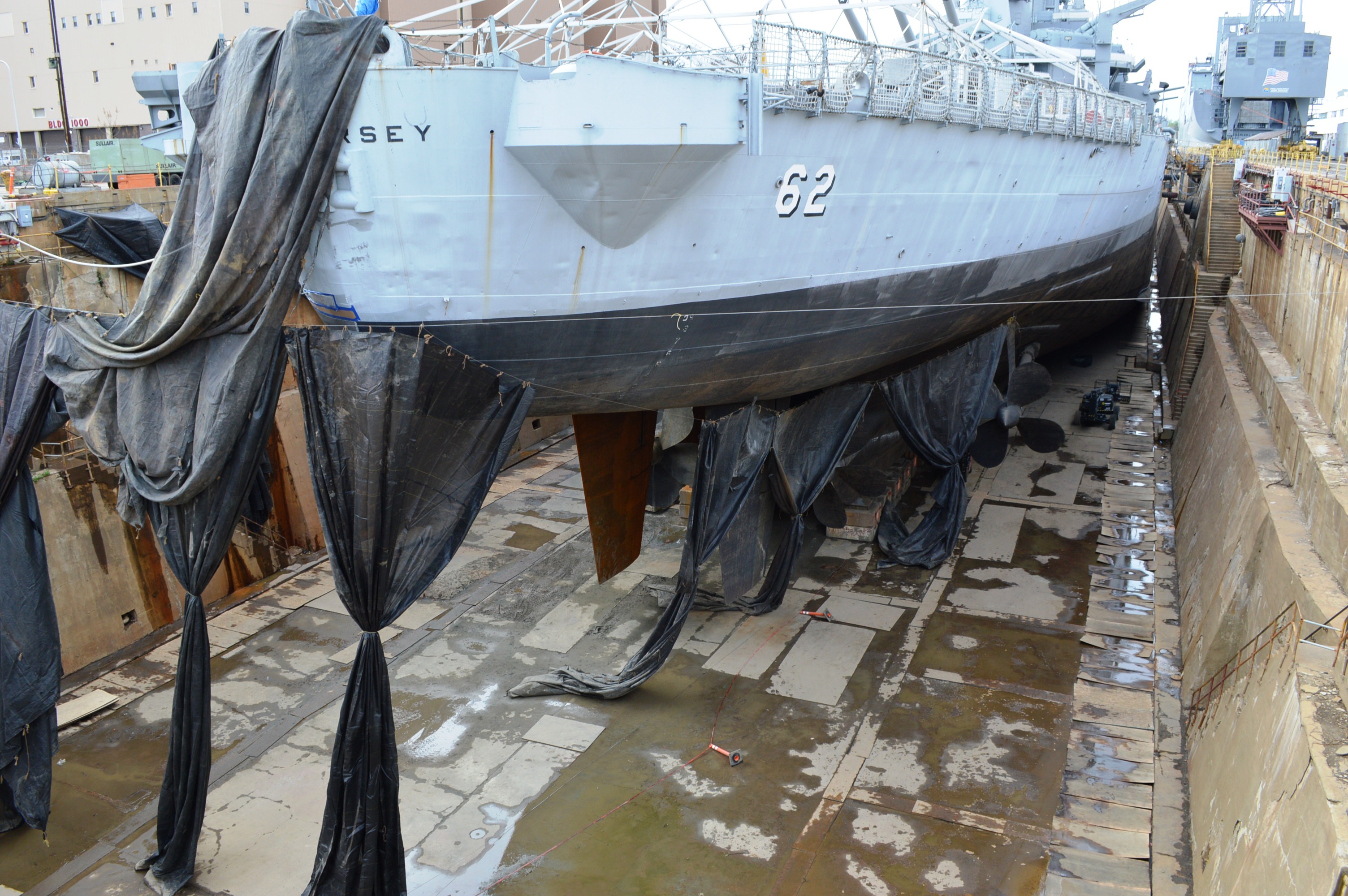

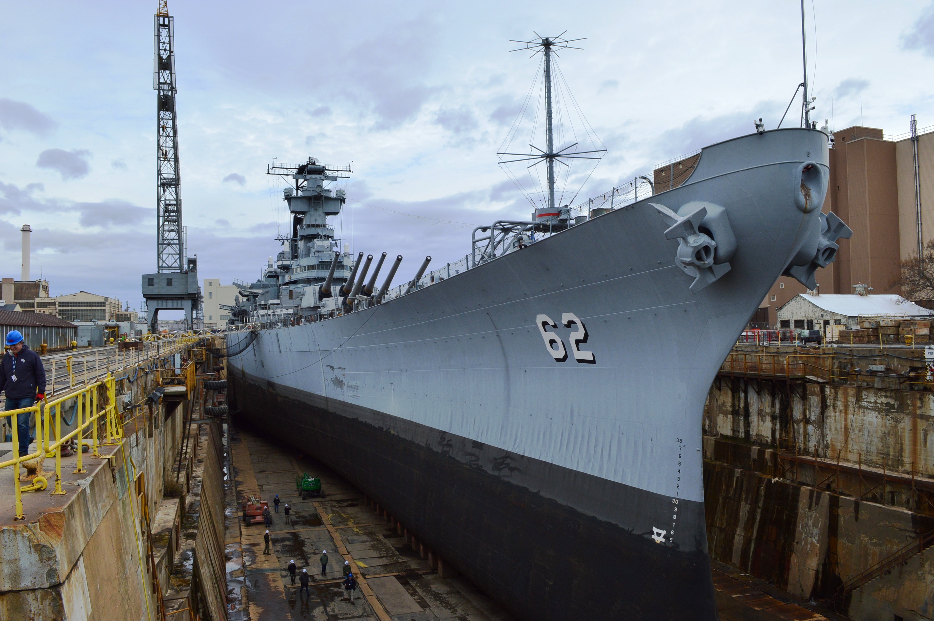

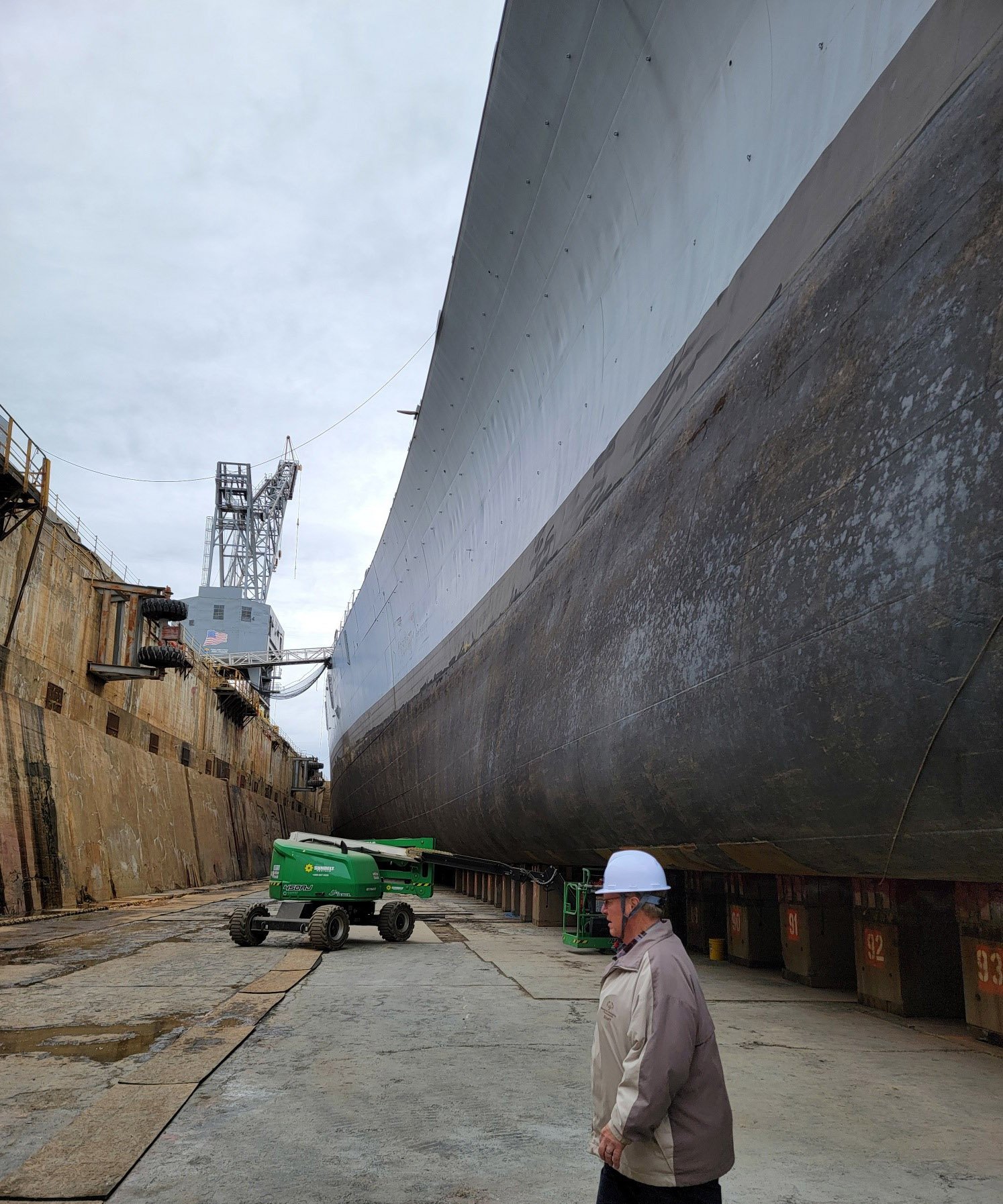

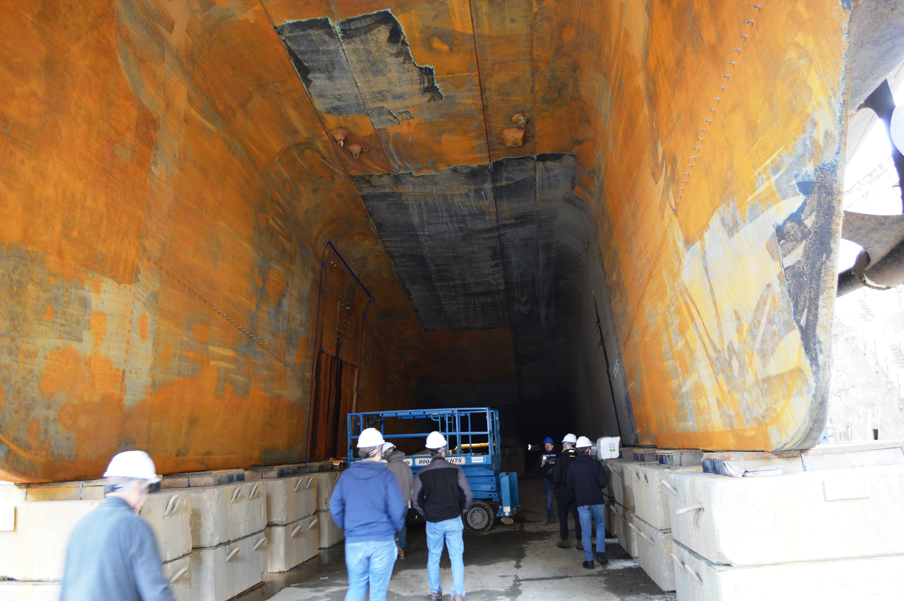

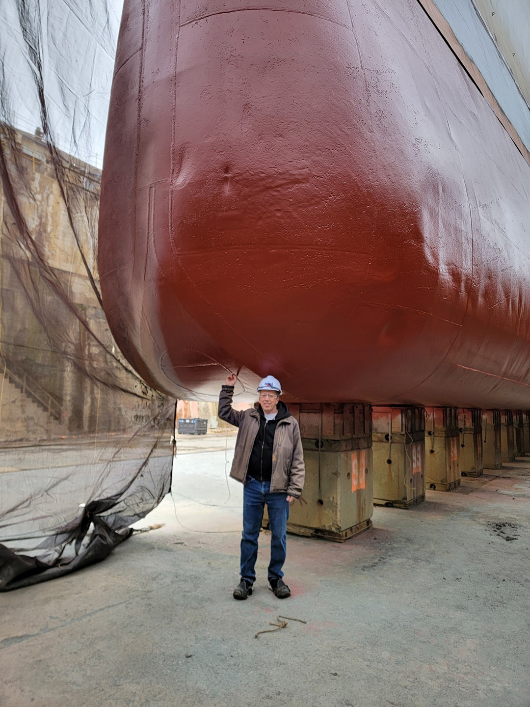

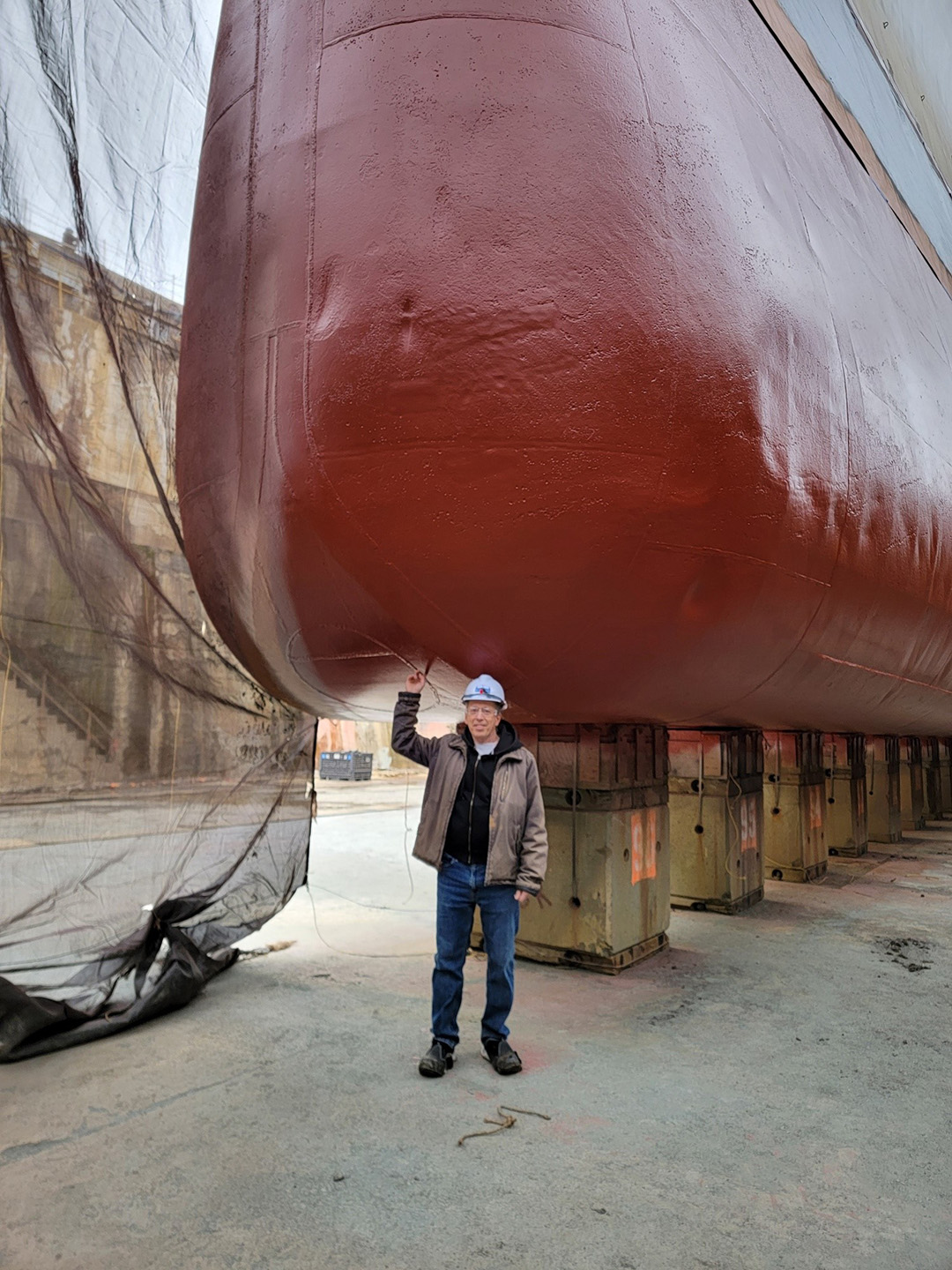

- Posts: 9091

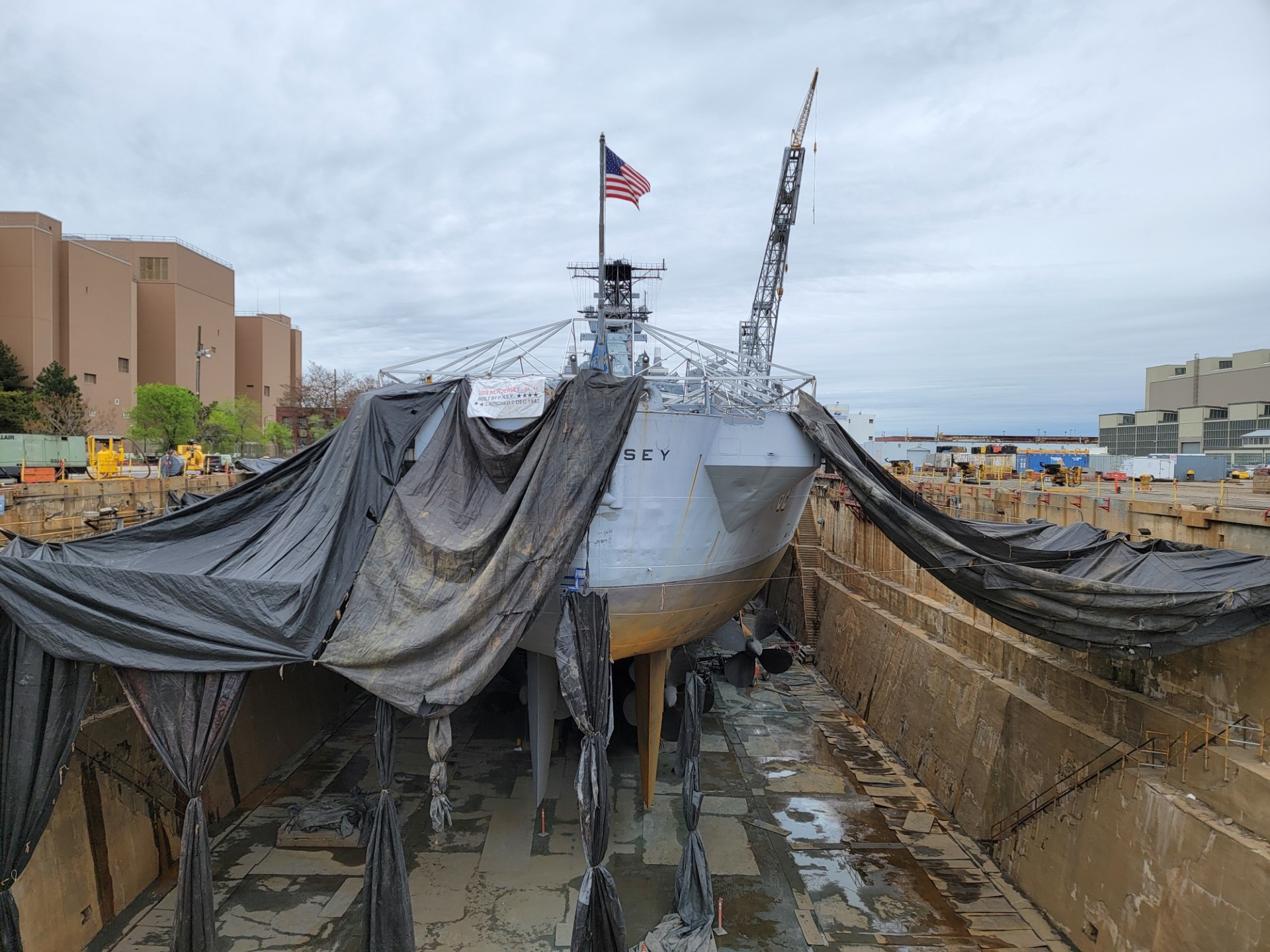

I found the visit well worth it. Certainly unique. The ship is in surprisingly good shape, and the work is proceeding quickly. If I understood our guide ( a very knowledgeable member of the museum staff) correctly, the boot line is being lowered 5 feet to reflect her current, lighter displacement.
It's not easy balancing a 45,000 ton on one's forefinger. Took some practice.

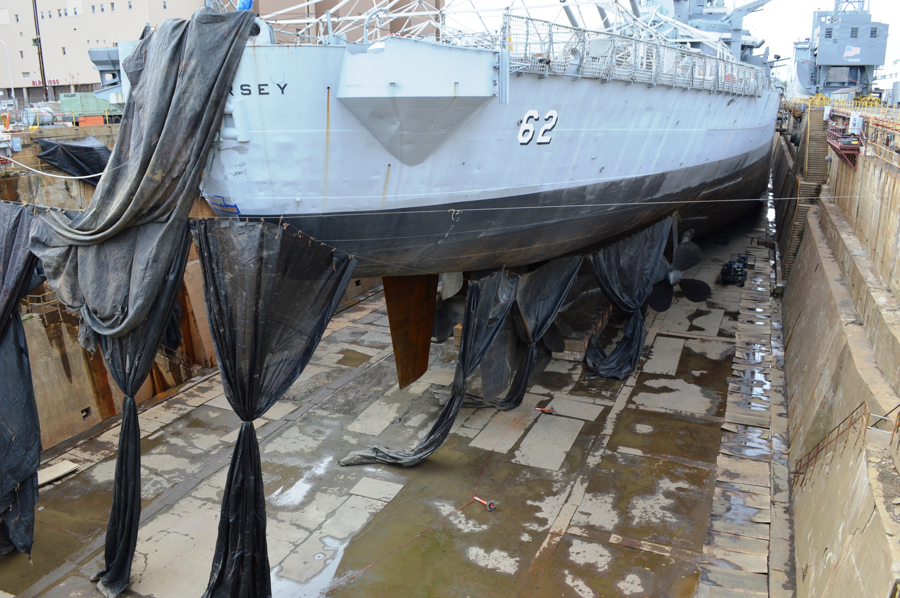

- Posts: 9091
Just the joints
Starboard side has yet to get any undercoats.
bigjimslade
- Posts: 463
In doing research for the next book, a few weeks ago there were no pictures of the Iowa-class docking keel. None. Zero Zip. Nada.
Now, suddenly they are all over the Internet.
- drdoom1337
- Posts: 1161

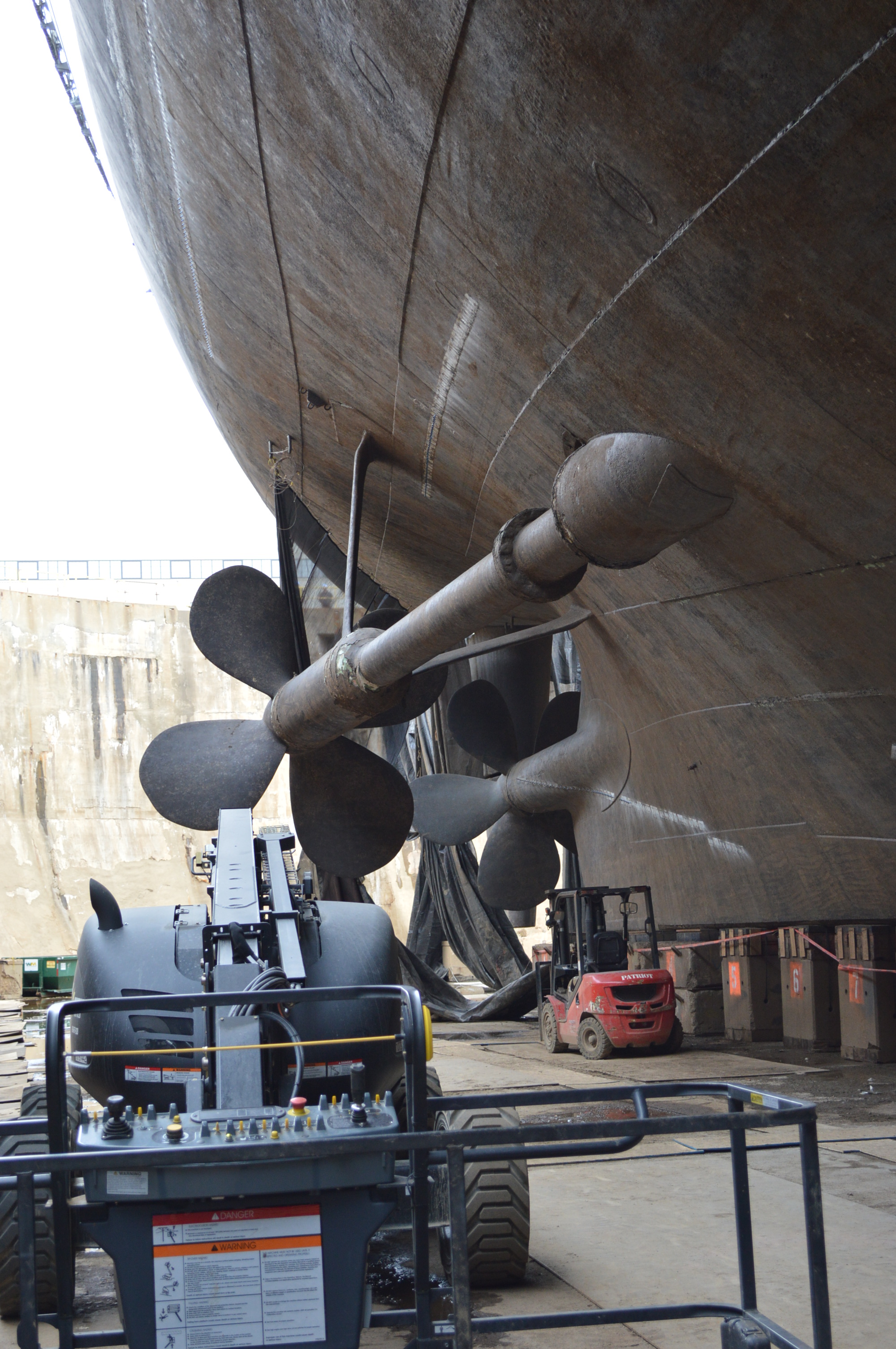

I took the drydock tour in early April as work had just begun. On last nights weekly update, Ryan stated that the prop shafts will be boxed in with a welded structure. Has this been done before on a mothballed or museum ship? Are there any drawbacks to this process.
- BB62vet
- Posts: 3162
BJS - Ryan kindly emailed me a copy of the docking keel and in his email mentioned that you had provided that to him as well as other documentation for the drydock project. As to your comment regarding what suddenly appears online - who knows how this happens...or why! So, consider your visits to the ship and the assistance you've provided in getting the drawings, etc. organized as a true benefit to the preservation of the ship!bigjimslade wrote:In doing research for the next book, a few weeks ago there were no pictures of the Iowa-class docking keel. None. Zero Zip. Nada.
As for boxing in the shafts, I've not heard of that being done prior but perhaps there is a long term reason (such as preventing any sort of seepage into the shaft alleys) for doing this. Has there been an issue up to this point, and if so, is this a possible solution to the problem. I guess from a purist's standpoint it may not suit, but then who's going to see it? And what, another 20 years 'til the next drydock period?

USS New Jersey is painted and looks ready to rejoin the fleet. She is in remarkable condition.
FFG-7
- Posts: 733
what is with the lines in black & red part of the hull as appears to be seam lines?
