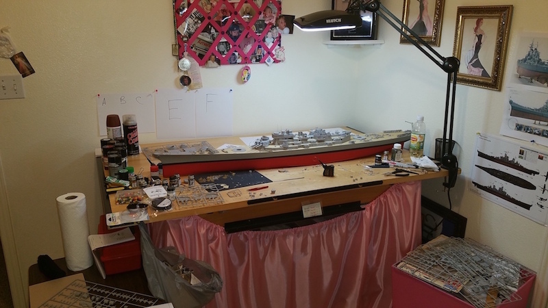

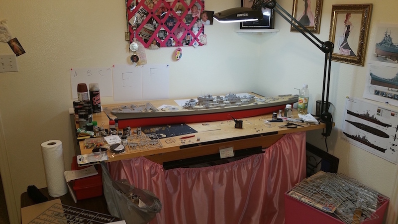

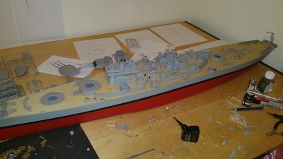

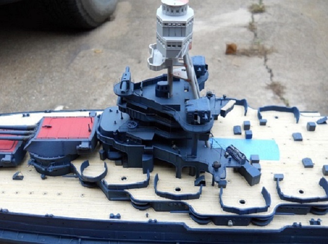

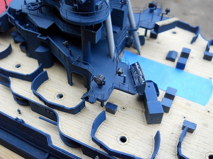

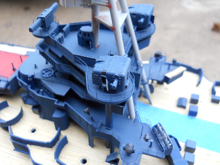

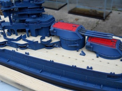

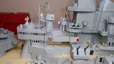

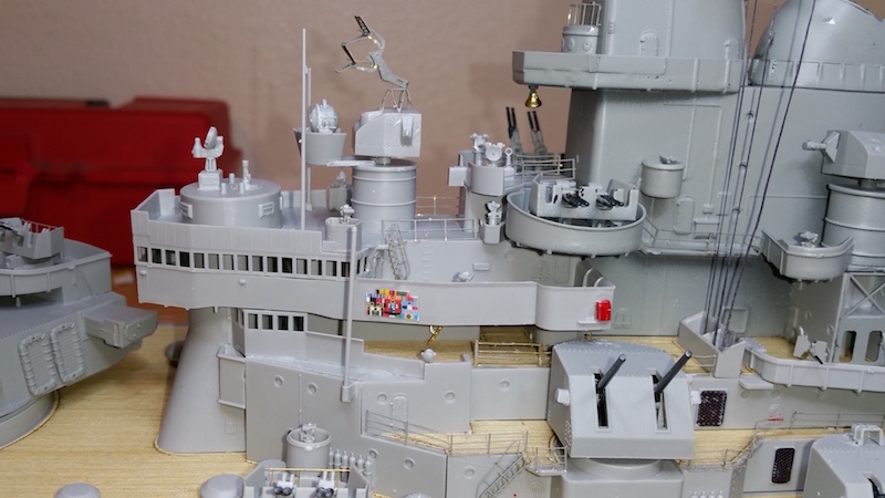

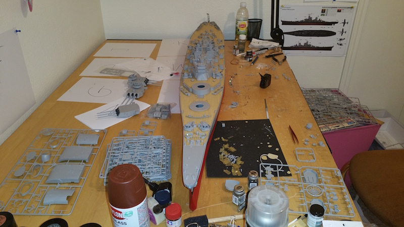

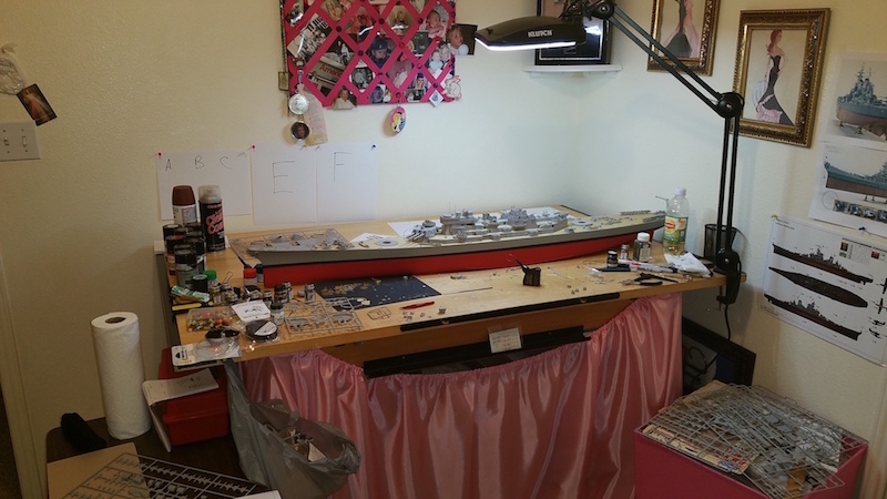

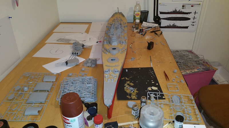

My first 200 scale build, had to use my wife's office hince the pink skirt around the drafting table.

Nice clean work! Note that in 1945 there was a vertical ladder between the 02-03 levels below the bridge wings, which after the war was replaced by an inclined ladder, in that recess behind the 51-52 mounts.
Keep up the good work! T

747, thanks for the info and encouragement! I've been toying with this model for about 3� months, my video production company keeps me pretty busy, 33 weddings in 28 foreign countries this year 2015.
I googled the Missouri for the ribbons the ship had earned during WW2, saved them to the desktop, printed and reduced to what I felt was the appropriate size, cut them out and glued them on, I think proportionately they are the correct size.
Again, thank you for the guidance you afforded me on this build.

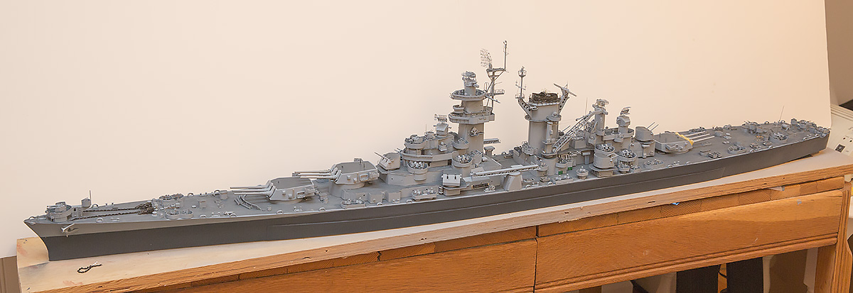

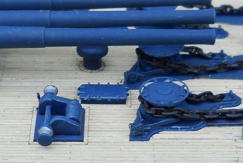

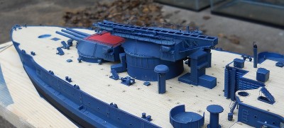

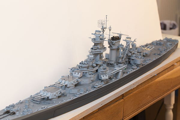

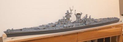

Couple of photos of CB1 in 1:192 as of today. The "paint job" is hand mixed Golden Acrylics, matched to Snyder & Shorts color chips. Measure 22.

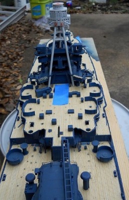

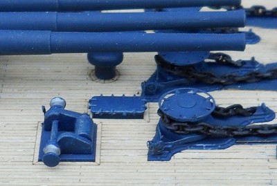

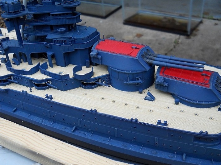

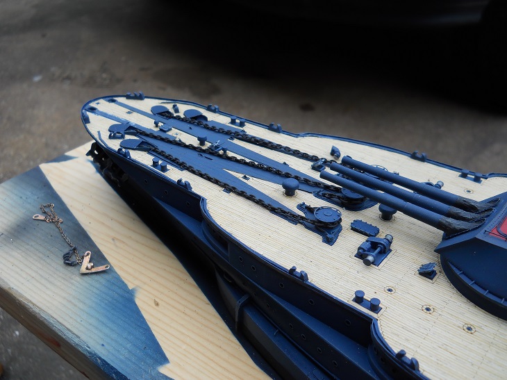

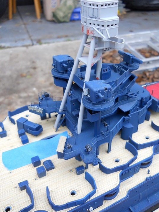

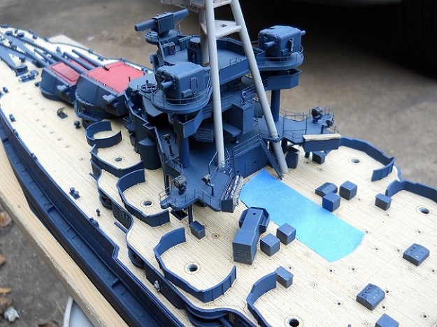

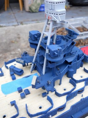

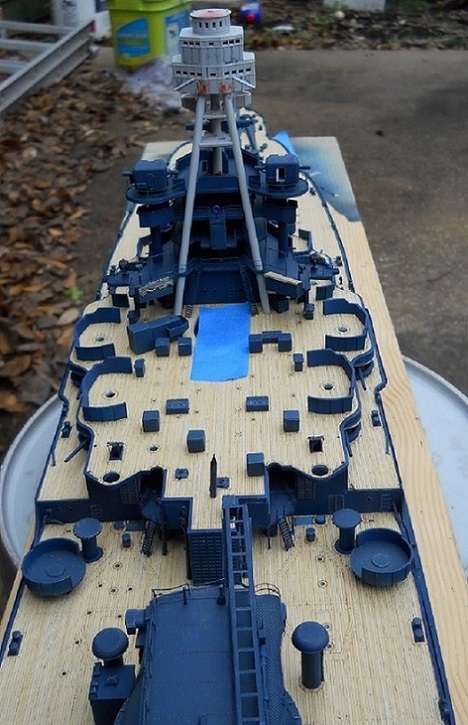

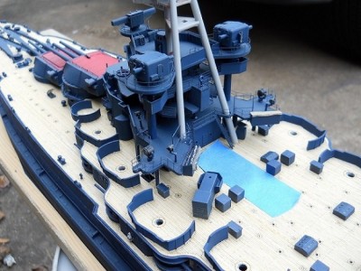

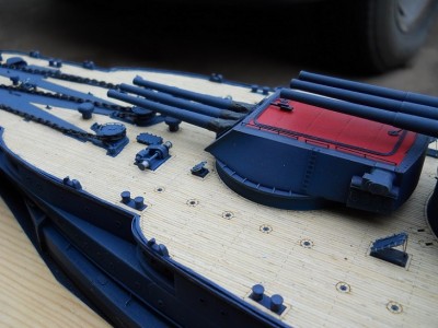

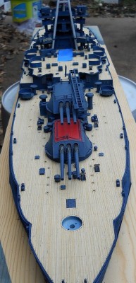

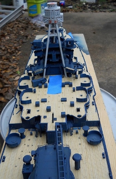

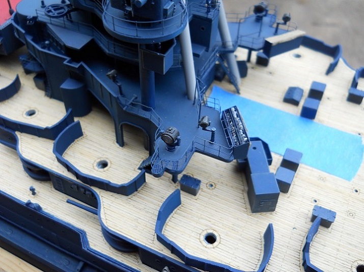

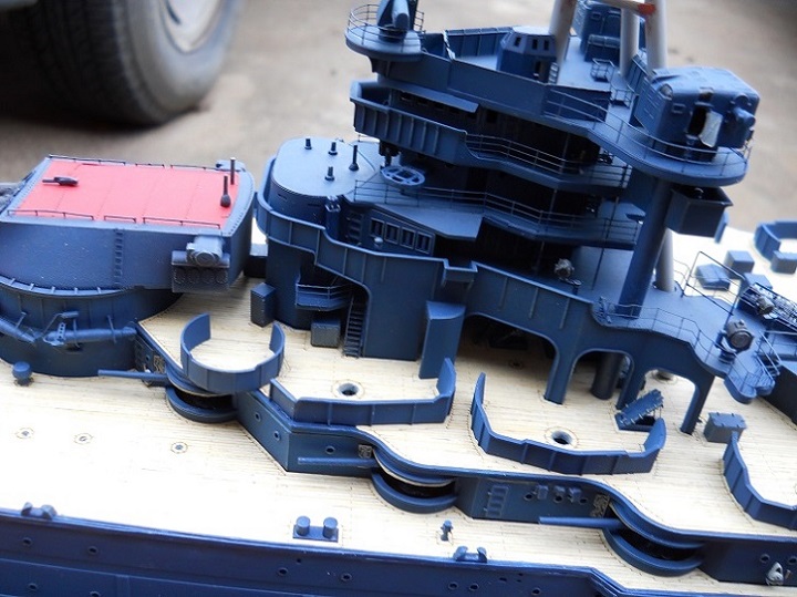

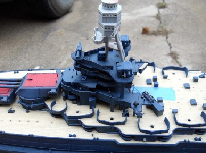

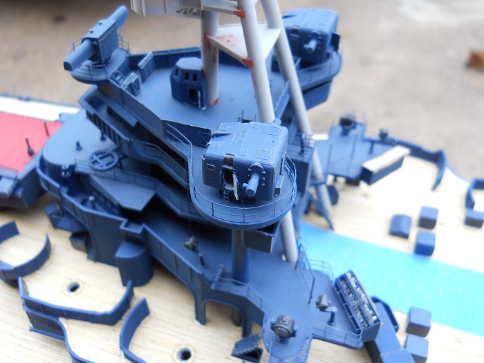

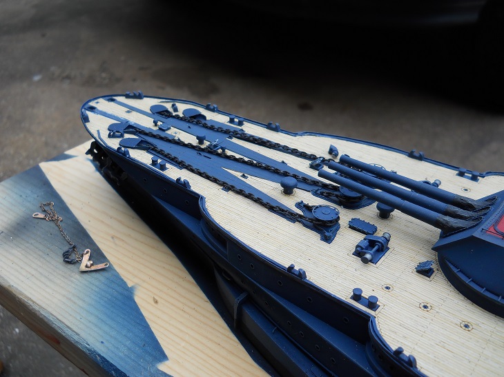

Okay everyone time for an IPR. I have been working on the Arizona model when I can. I had to break away and work on the base for the model. She will be at sea underway. There was a lot of small item/subassemblies I had to do while focusing overall on the main superstructure. It is now basically finished sans some small touch-ups, etc. I must say I recommend photographing your model before declaring it done. It reveals so many errors one misses! Anyway focus on the superstructure went pretty well, most time spent on the signal bridge. I threw some facsimiles of flags in the flag bag and draped a tarp off the back side. The other one I covered even though while underway both would be uncovered. At this point I'm fitting the tripod masts before going in and detailing them further. I'm working up from the hull and form the inside outward; rigging what I can so I don't have to work over the model as much. The took the pictures outside with a slight overcast to see how they came out. My shop is fine for lighting, but it's mostly from above which casts shadows on an already dark paint scheme. The blue tape is just a cover until I get the funnel(which is completed) installed, which will come after the forward tripod mast is installed. This keeps parts from falling down into the model. I still have to do the mod that Jeff has pointed out regarding the port secondary chain plated removal (see his thread under WiP-Arizona Finally). The plates is ripped up waiting to be re-decked. The turrets are placed, not yet cemented down. What a happy day when they are!

more pics

You might potentially consider attaching the turrets with magnets, allows them to turn and be removed, but is very secure.
Could you elaborate on how you did the flags in the bags?
