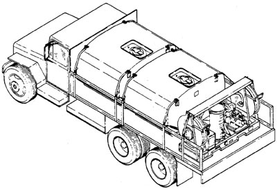

Carl,
How about a thin brass wire painted black to represent lashing cables? The fuel bowser would have had 4 D-rings on the top corners of the tank for lifting into the launch. They also be used for lashing, I'm thinking.
Basically the same idea on a 2 1/2 ton truck. Note the pump unit is separate.
Army Fuel Bowsers.jpg (32.59 KiB) Viewed 2117 times

Russ,
My frame of mind when I put the tie-downs on was that of casting more of them in resin and also having other modelers in mind who may not have the NARA drawings of the AVPs' Bowser tanks which shoes tie-down cables and turnbuckles. I think that I'll remove the thick styrene tie-downs and when I use one, I'll use thin wire to portray the tie-downs.

Makes sense.
