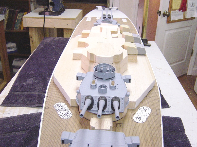

Hello again all! :wave_1: If you've been following this thread, you're probably wondering where I have been. These past Holidays were a bit rough, and I have not been building as much as I should. My concentration level is still a bit screwed up, but getting better. In any event, I am still here and the build continues. When I last posted, I was working on the details for the main deck. I have decided to put those off for now, and get started on the superstructure. A complicated affair, to say the least, with many diffrerent levels. This structure is big, too and will require more time and effort as I originally had anticipated. I have been doing a lot more figuring and studying than actual building! :scratch: Lets take a look..........

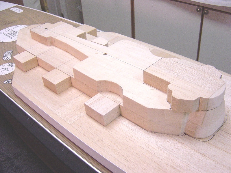

In this first photo notice the first few levels of the structure are "roughed in" and will be wrapped in sheet styrene, with the decks sandwhiched between each level, also made from styrene sheet. Everything is "dry" fitted right now. Stb. side shown here.

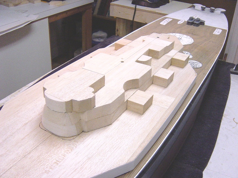

A view from portside. I felt that framing all these levels one by one and then covering them would be way too time consuming. I decided to use balsa blocks for the task. The problem was that the size of balsa I needed was not available from any standard supplier. I then remembered that the Guillow's company offers large balsa workboards which are used to build model aircraft on, or any other project that needs a flat, true surface. Interestingly enough, these boards are 1" thick, ( 8 feet in 1/96 ). Each level of the superstructure is also about 1".I was in luck!!

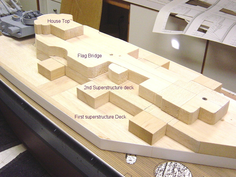

Here's a portside view looking fwd. Each level was traced out on the balsa, using plans from Floating Drydock, then cut out with a bandsaw and scrollsaw, then trued up with sandpaper. If you look at the outside edge of the first deck, you can see I have started to wrap the wood with styrene. Industrial grade contact adhesive used here. I'll continue to "wrap" each level in this way, adding the decks in between as I work my way up. I have noted the first few levels in the photo. Many more to go...... as I said, time consuming if it is to be correct!

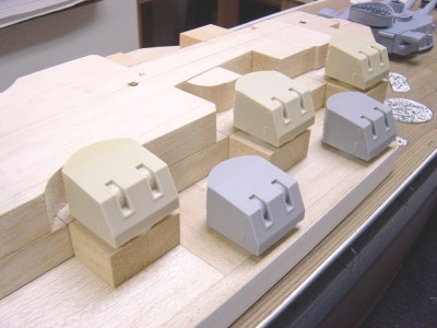

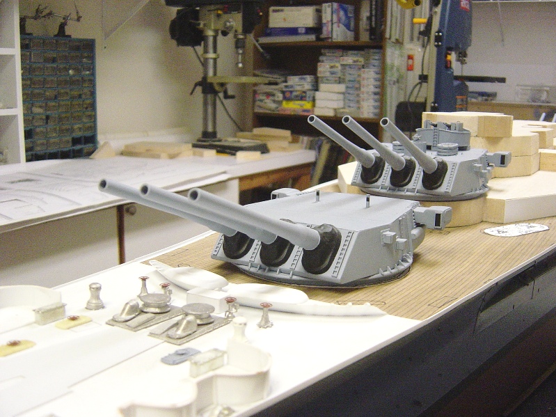

A portside view of the twin 5" gun mounts. These turrents are from J.R.Haynes from the UK. They are very nice but a bit pricey. You get what you pay for, and these are worth it as is all his products. I could have made these, but I am already way behind on this project. When dealing with Museums I do not have a lot of luxury such as time! When these are permanantly mounted, I'll have them pointing in different directions. Sure could use Nuttalls barrels!  Again note the styrene wrap around the 1st level.

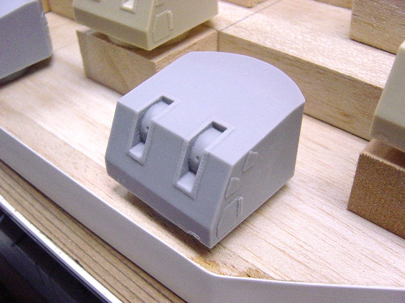

Heres a close up of the 5" turrent. There are 10 of these on board. The turrent comes with the barrels and lots of little details. I'll add a few more! Turrent is resin cast.

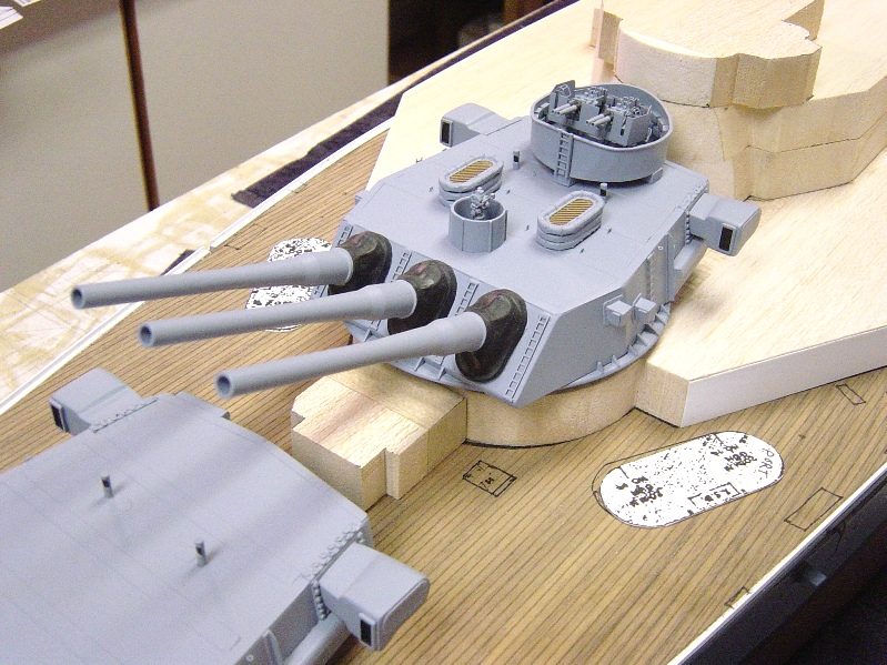

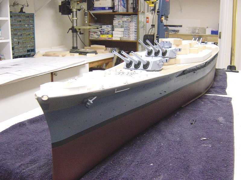

Dead on view here. Note #2 turrent in it's correct position. The superstructure is taking shape! Slowly..... The first deck also gets wood planking. The paper patterns you see will eventually become more parts.
A close up of #2 16" turrent. The structure on deck in front of the turrent is the deck office. Once other details are added, this should look pretty good! Hope so, anyway!
#1 and #2 turrents from portside.
Here's a better view.

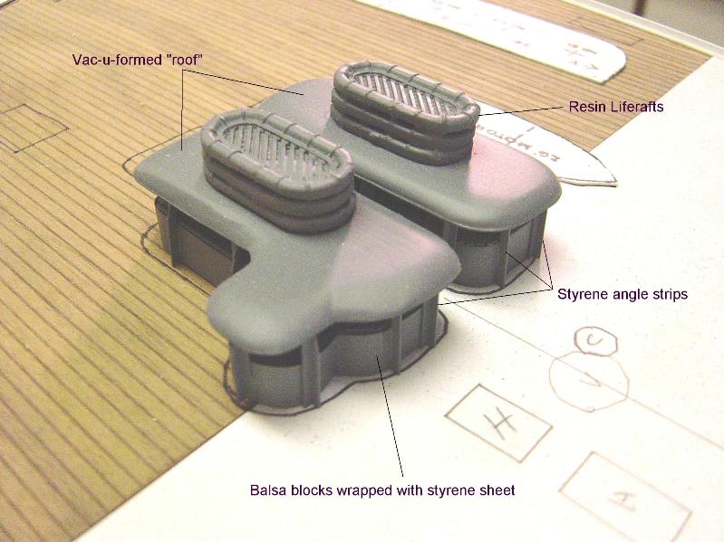

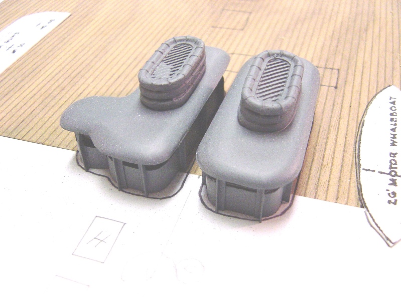

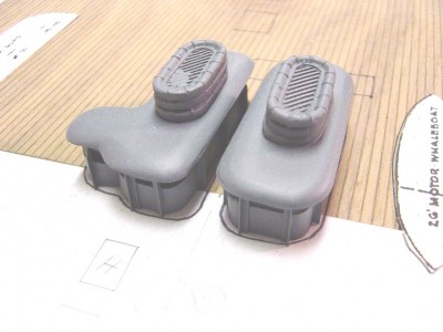

I have managed to make a few other things, such as these vents that are way aft on the main deck. Small items like these are time consuming too! Theres alot of 'em on a BB!
Another view of the aft vent.
