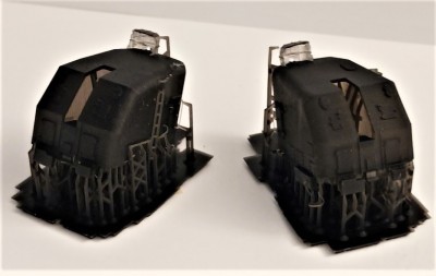

After handling a couple of the printed mounts last night, I saw that I had once again broken a few of the tiny, detailed pieces so those are printing again now. While everything printed very well, I won't know if the overall size is correct until I remove the mounts from their supports and do some clean up. Having the commercially purchased items to make a 1:1 comparison will determine whether I use those in the end or mine. While mine have more detail, I do want to ensure the size is correct and at this point in time, don't feel like redrawing from scratch if this becomes necessary. As I've already mentioned, I have printed side ladders that can be CA'd to the existing mounts and with those added, they would "suffice" in spite of lacking a few of my finer details. I may be able to use a couple of these detailed parts on the commercial items with some patience & care. Here is a shot of Mts. 53 & 54 after drying overnight while still on life supports :doh_1:
I've lightened the photo a bit to bring out some of the details a bit for visual note.

It is frustrating that we sometimes need to go through several iterations to get the final product. Then there is the destruction of small parts!
Persistence pays off and looking very good!

Thanks again for the positive feedback, always welcomed!!! Yes, between removing from the printer, handling and removal of supports, you're lucky if the part remains intact - esp. when dealing with fine details.
I did go in and beef up a bit the parts in question and you can't visually see any differences - but that slight adjustment may keep them intact! I hope to get 4 good mounts to use for comparison with the commercially purchased items.
A couple days ago I got the impression that even though I drew up my mounts precisely as shown in the plan book, that the footprint was slightly off - less than one mm in width at the back of the mount, so as I mentioned in our correspondence, I set the scale in Chitu to 1% more in width - not realizing that the circular distortion effect would come into play. When I go out to remove the first of these mounts from their supports, I will check to see if the round base ring is actually "round" or has any distortion. I guess the answer to this would be to make the mount floor & base ring as a separate part, printing it at the single correct scale and simply have it fit into the mount shell. Again, these differences can't even be seen with the naked eye, so it's so much fluff in the long run. Sometimes, this anal exactness is more detrimental than beneficial to the overall outcome of the model.
