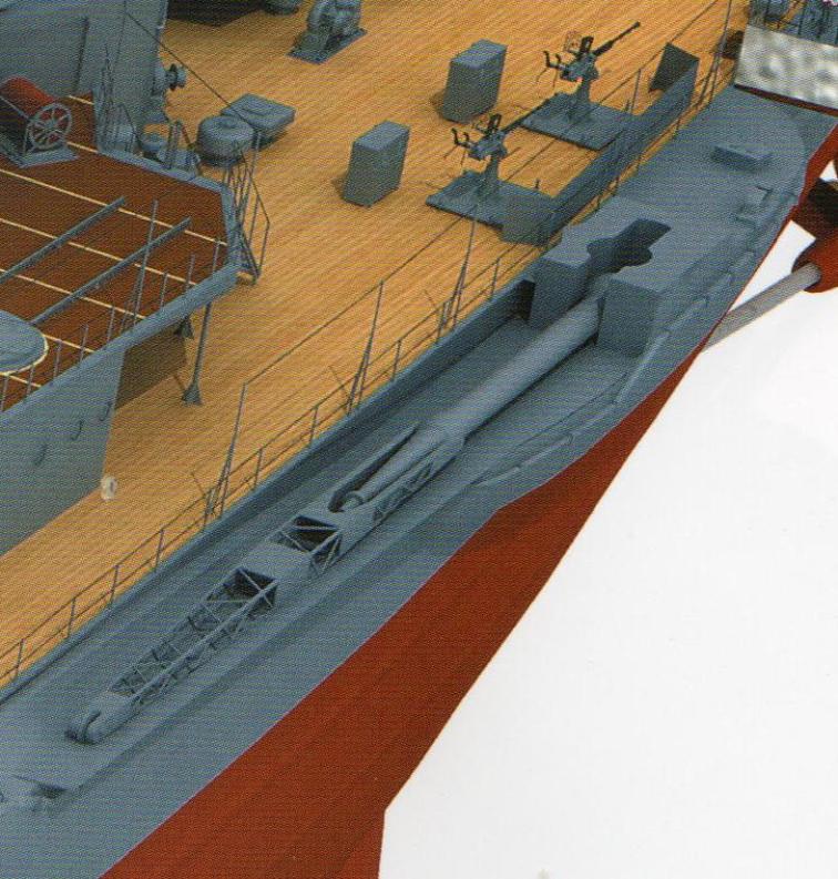

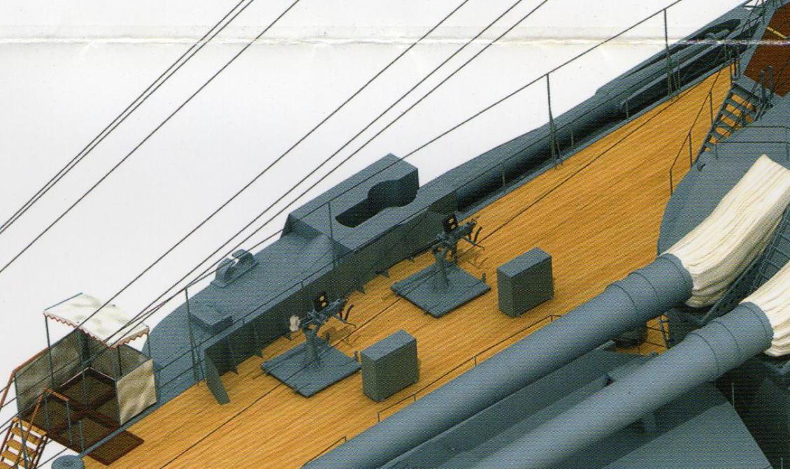

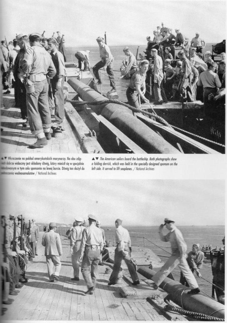

some illustration of folded crane from ajpress nagato vol 2
ciao peppe
ciao peppe

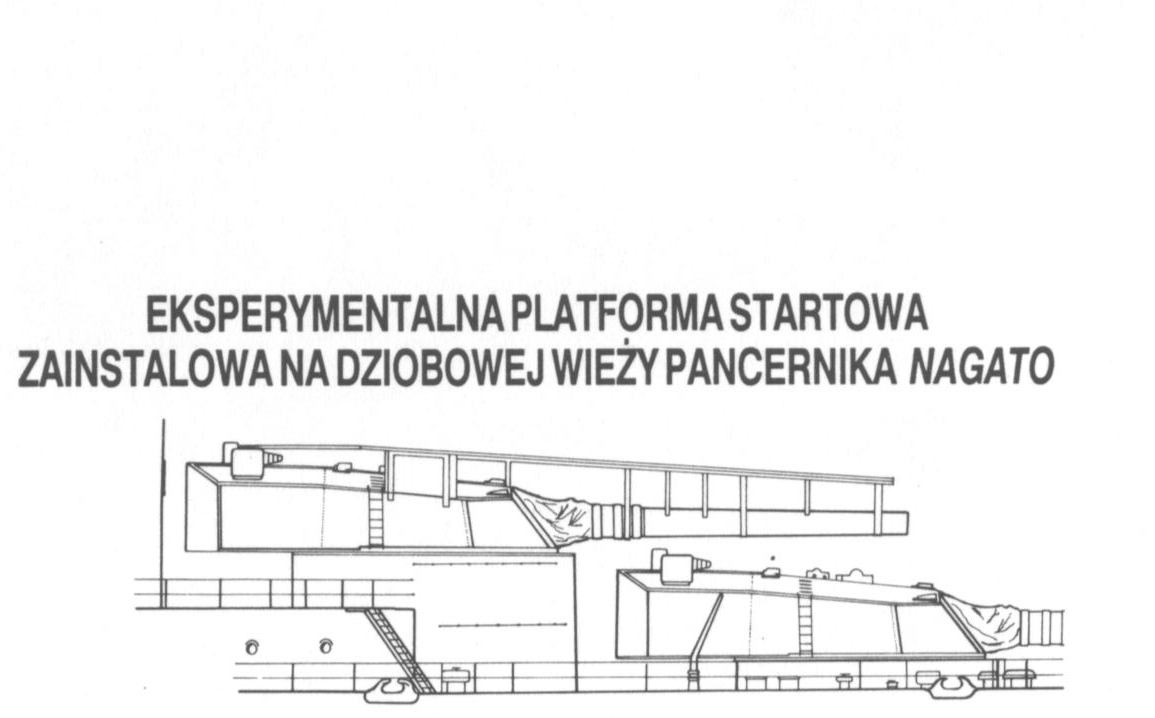

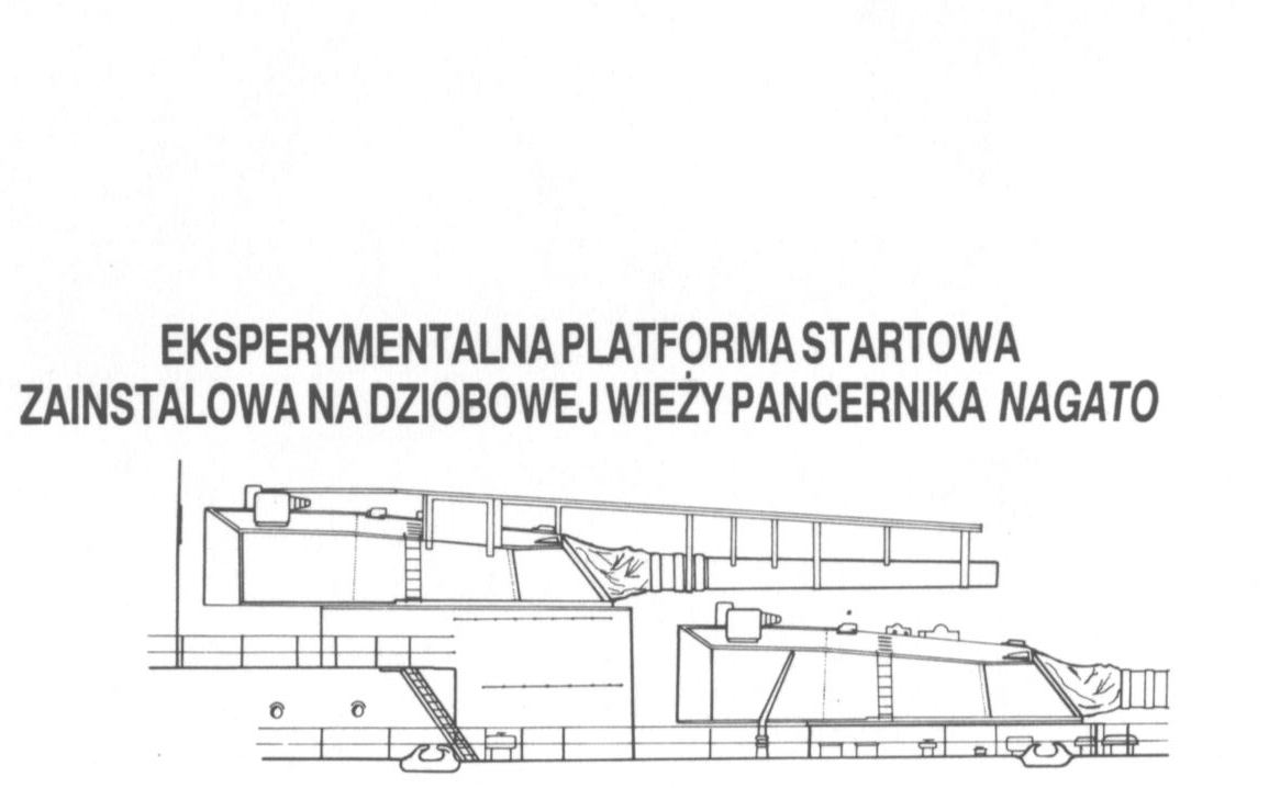

Alright, I did a search and couldn't find what I was looking for, so I apologize if this has already been covered before.
Did either Nagato or Mutsu ever sport a flying-off platform for biplanes similar to the one depicted in this battlecruiser Amagi/Akagi picture?

Re: Calling all IJN Nagato class fans
in 1920 nagato have a experimental platform (from the polish book on the class edited from ajpress)
ciao peppe
ciao peppe
Thanks Peppe. Did Nagato retain this flying off platform until at least 1927? The 1927 fit is depicted in an Aoshima kit.
So Mutsu never had one?
- peppe
- Posts: 352
- Location: roma, italia
from the same book: platform was fitted in late 1925 and removed in early 1926 after some test.
ciao peppe
ciao peppe

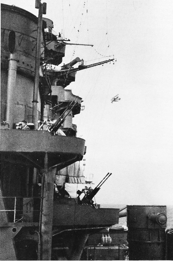

Got a question about AA platforms.
The AA platforms fitted on the funnels of both Nagato and Mutsu during the late 1930s had three main pillars supporting them. On each side there were one vertical, one angled inward, and one angled outward. Most models and reference drawings show no extra supports on them. The Futabasha books for 1941, 1944, and 1945 do agree with this. However, pictures taken of Nagato in 1945 clearly show that there were struts joining the pillars horizontally roughly midway between the deck and the AA platforms themselves, as well as that there were diagonal bracings between them and the upper supports.
The questions are:
1) Were those diagonal bracings there since the platforms were fitted, or were they added later?
2) If the diagonal bracings were added later, when were they added?
and
3) Was this done just to Nagato or Mutsu as well?
TIA for any info!
The questions are:
and
TIA for any info!
- Posts: 9116
Good question. The Model Art Super Illustrated Guide to Nagato shows no additional bracing or cross-bracing. Photos were much tougher, though I finally found this photo of Mutsu's funnel from Oct, 1941. Also no bracing.
