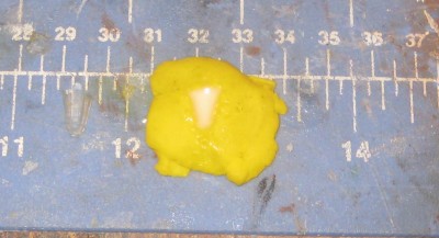

I hope this is the solution to my lantern problem.. I used the one lantern half I have to cast a female mold in clay and filled it with Micro Kristal clear.. This going to take some time to cure !

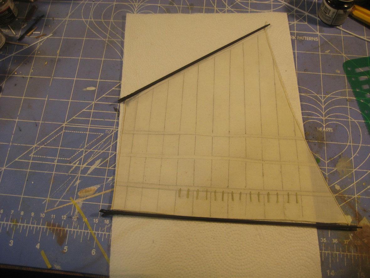

Now that summer is nearing its end it is time to get back to the model bench. Working on Victory's first sail , her gaff.. adding clew ropes before I bend to the mizzen mast..

Hi Bill Code !!
STOP PRESS !!!
just a thought before you finish that sail...
should the seams not run parallel to the leech...?
HTH
JIM B
STOP PRESS !!!

not sure what you mean Jim ??? I would not be surprised if I screwed it up though..

On gaff sails the seams would have almost certainly run either vertically
parallel to the aft edge Leech ) ( the long aft edge)
( whereas the shorter edge( hte luff) is supported along the mast
OR
Horizontally.... with the seams square to the aft edge ( leech)--either way the weave of the cloth has to be square to the loaded aft edge
That way the cloth does not stretch on that unsupported edge
Now then...== its not as easy as I thought to quickly verify if the Spanker sail on Victory was horizontal or vertical ...
- a quick google search was inconclusive-- a longer search needed--or " proper" book/ plan/ illustration /
or ask dafi!!
meanwhile encs a drawing of gaff sail nomenclature and also some photos of gaff sails --with horizontal and vertical seams
to illustrate the need for the cloth weave to be square to the leech either vertical or horizontal
but I will keep on looking to find a period painting that is of use or can be cross referenced...
.... maybe make some square sails in the meantime!! --there the seams are reliably vertical!!!
HTH
JIM B

UPDATE...
Dafis sailmaking says vertical seams--parallel to the leech...

Laughing my head off ...
@Jim, are you sugesting to do a Netflix-Series "Better ask dafi!"?!?
But you are correct, the way my sail is done should be correct with the layout and also the width of the sail-cloth.
And also check, the stay sails have a different layout again.
Cheers, Daniel

thanks for the heads up... I will see if I can salvage this sail..

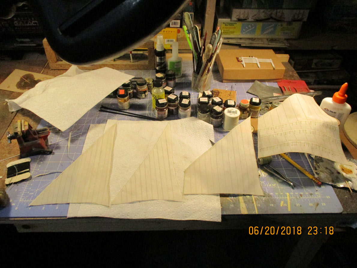

the fore and aft sails are complete... You guys know if these were hung on the standing rigging with small metal eyelets or just rope ?? I have not had alot of time to work on the beast of late

According to 'Rigging period ship models' by Lennarth Petersson:
- The staysails: metal loops are attached with rope to small holes in the sails. These loops slide over the standing rigging.
- The spanker: a rope spirals around the gaff, and is attached to small holes in the sail with small rings (in metal?)
Marijn

Were those incomplete loops for the staysails? I think it was usual practice for there to be a much smaller diameter rope lashed between the stay and preventer stay (for the main and fore masts), forming a zig-zag truss running all the way along between the two, so a full ring would not be able to travel along it. But that also doesn't sound very secure! Maybe it was passed over both?

Good point! The ship portrayed in the Lennarth Petersson book doesn't have this zigzag connection between stay and preventer stay, but Victory does. In the book, the loops are complete (well, omega-shaped, but the opening is at the side of the sail and closed with rope lashing), so this wouldn't work for a stay with such a zigzag truss connected to it... I guess we need someone more knowledgable on the topic... (Dafi!) (Welfalk!)Martocticvs wrote:Were those incomplete loops for the staysails? I think it was usual practice for there to be a much smaller diameter rope lashed between the stay and preventer stay (for the main and fore masts), forming a zig-zag truss running all the way along between the two, so a full ring would not be able to travel along it. But that also doesn't sound very secure! Maybe it was passed over both?
Marijn

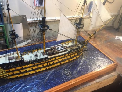

2nd jib sail was the first rigged.. still need to fabricated a pin rail to complete her tie off
